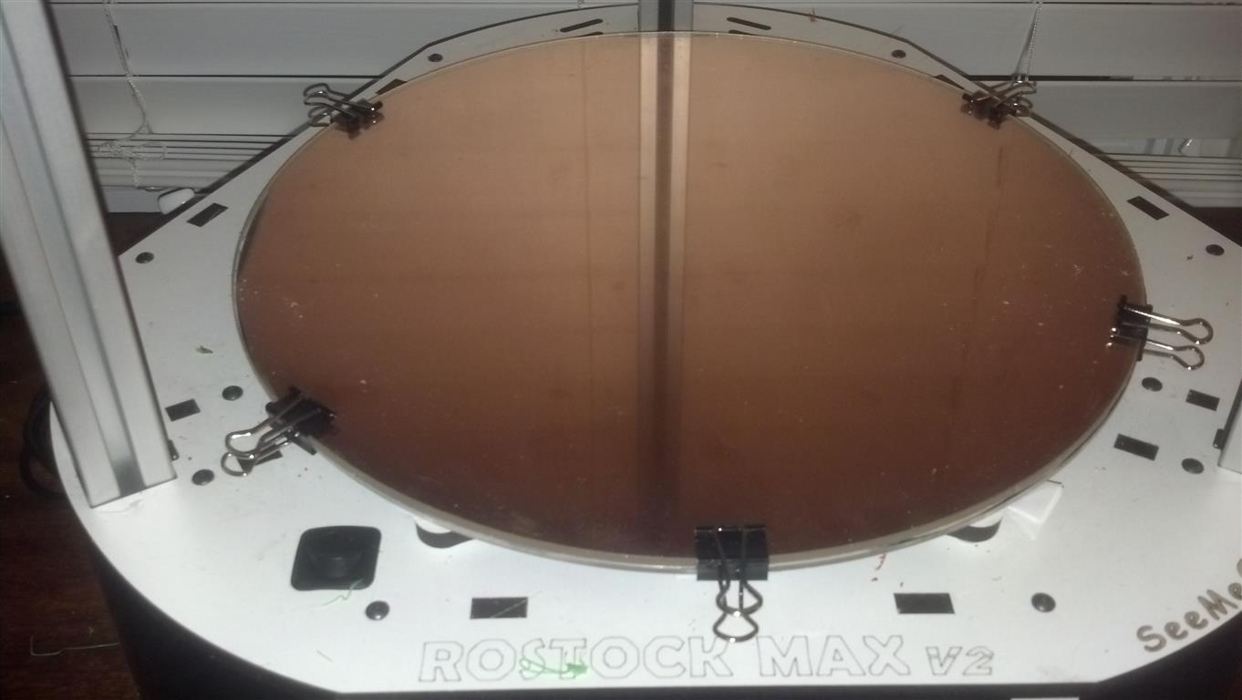

I used Copper plate between the bed and the glass. Spreads the heat nicely and after stablizing, it stores an amazing amount of heat.

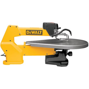

Mine came 12" x 12" square and I cut it on a Scroll Saw. It could also be cut with a manual Coping Saw, it would just take longer and give you Popeye the Sailor Arms.
- dewrdw788r.jpg (18.01 KiB) Viewed 18208 times
- 250px-Coping_saw_2.jpg (5.87 KiB) Viewed 18208 times

I think that 120C is perhaps a little high and heat spreader plates really help make the bed temperature uniform. I use 65C for PLA and 105C for ABS. I think that you want to be near or at the Glass Transition Temperature (65C for PLA and 105C for ABS).
Many people use aluminum, I used copper due to it much higher heat transfer coefficient and ability to store heat but it cost 6x more ($50USD verses $8USD).
