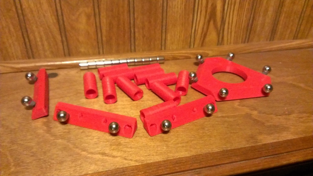

Generic Default wrote: I attached all of the printable parts in this post, except for the magnetic cup joints. I will work on getting several sizes of those for various press fits tomorrow.
If you print the attached files, make sure to do it relatively slowly at small layer heights. I think I'm using #8 (4mm) hex head cap screws to glue my chrome balls to. I'll try to get more installation instructions and pictures tomorrow.

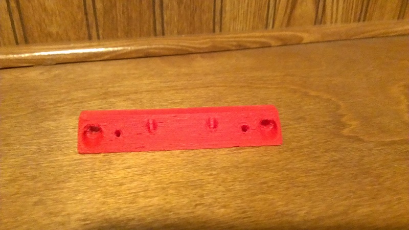

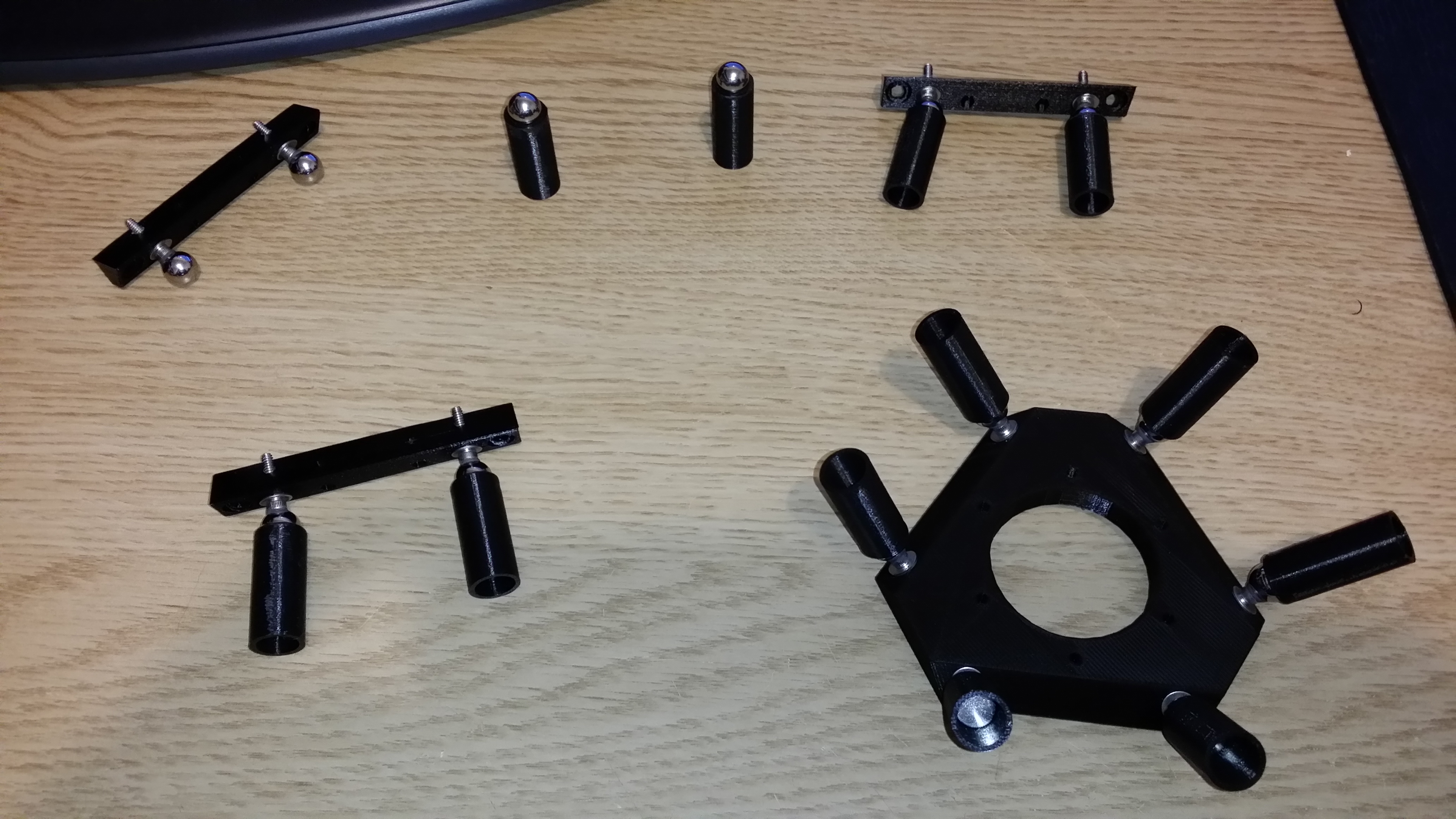

Here is mine with 2 endstop holes
cheapskate_ballends_2endstop_v3.stl
(52.03 KiB) Downloaded 1051 times

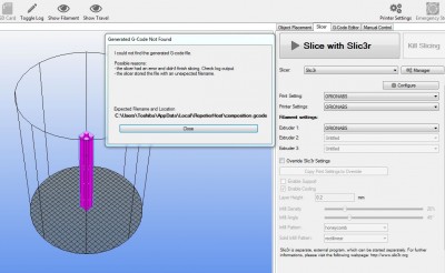

I load the Arms in Repetier Host and when I go to slice it I get this error. Does not matter what computer I use in the house I get the same error.
Now I got the same error on the Arm End but when I resized the file in Repetier Host to 1.05 it worked then.
Anyone have this problem?
Joe

xnaron wrote:Here is mine with 2 endstop holes
It printed perfect, I took off one of the exiting mounts and the stubs on the back fit right into place of the two mounting holes. Great Job.
Joe

Almost Ready to install.
Joe
xnaron
Posts: 165
Post by xnaron »
joecnc2006 wrote:Almost Ready to install.
Looks good Joe! Be careful with those magnets. They crack very easily. Don't let them snap together.

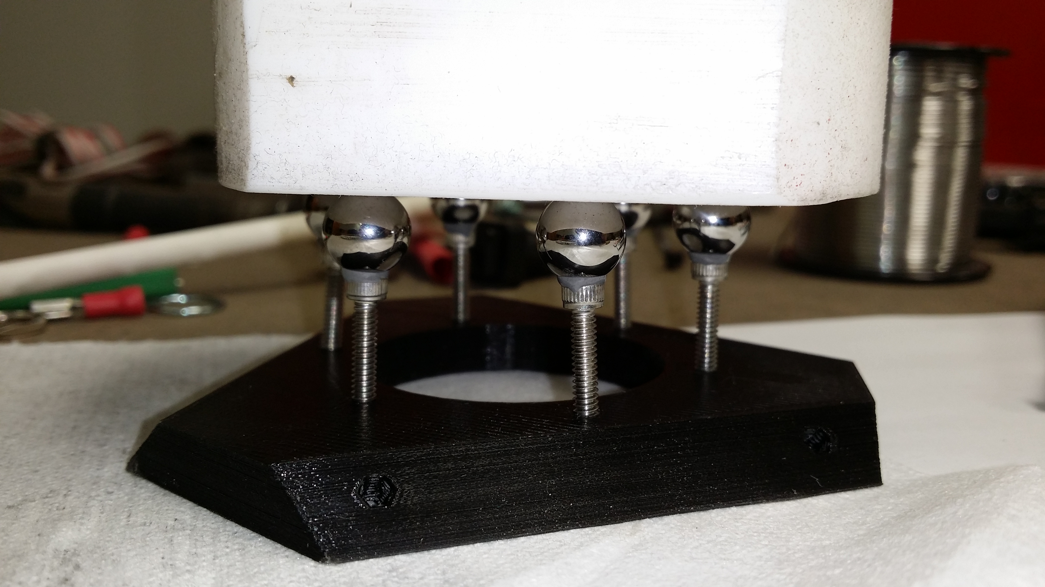

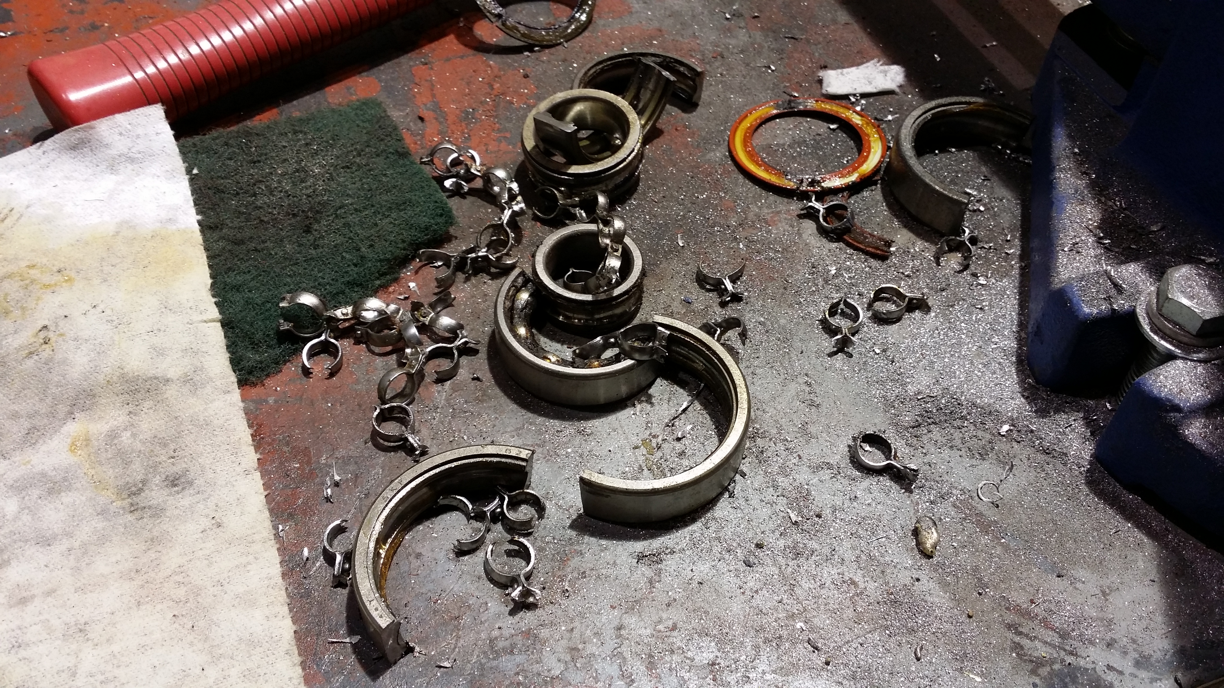

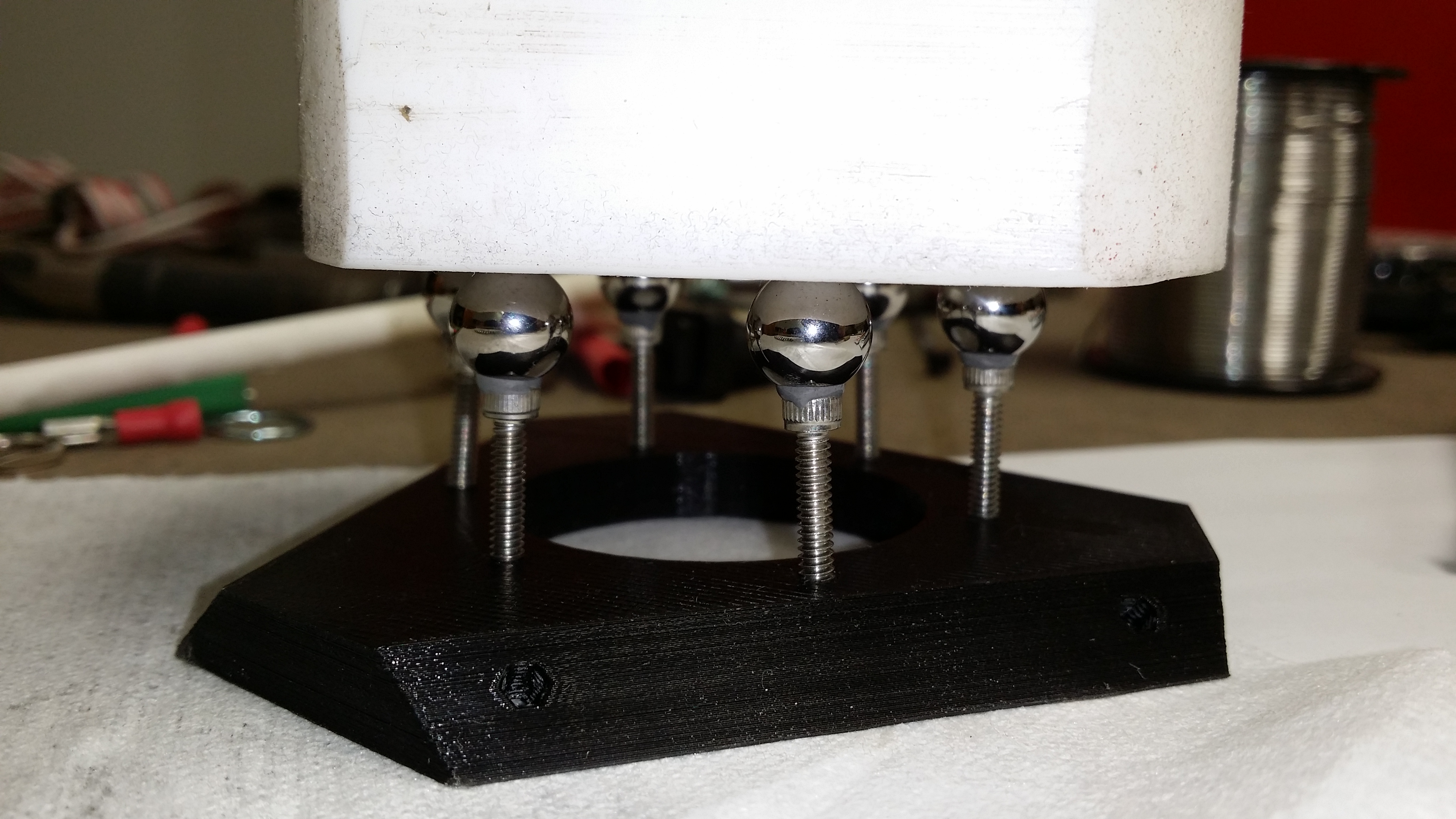

Progress so far on my joints:
Tore apart a few 6206 bearings to get the sweet sweet 3/8" balls within.
Used some JB Weld and added some weight to keep the balls pressed tight.

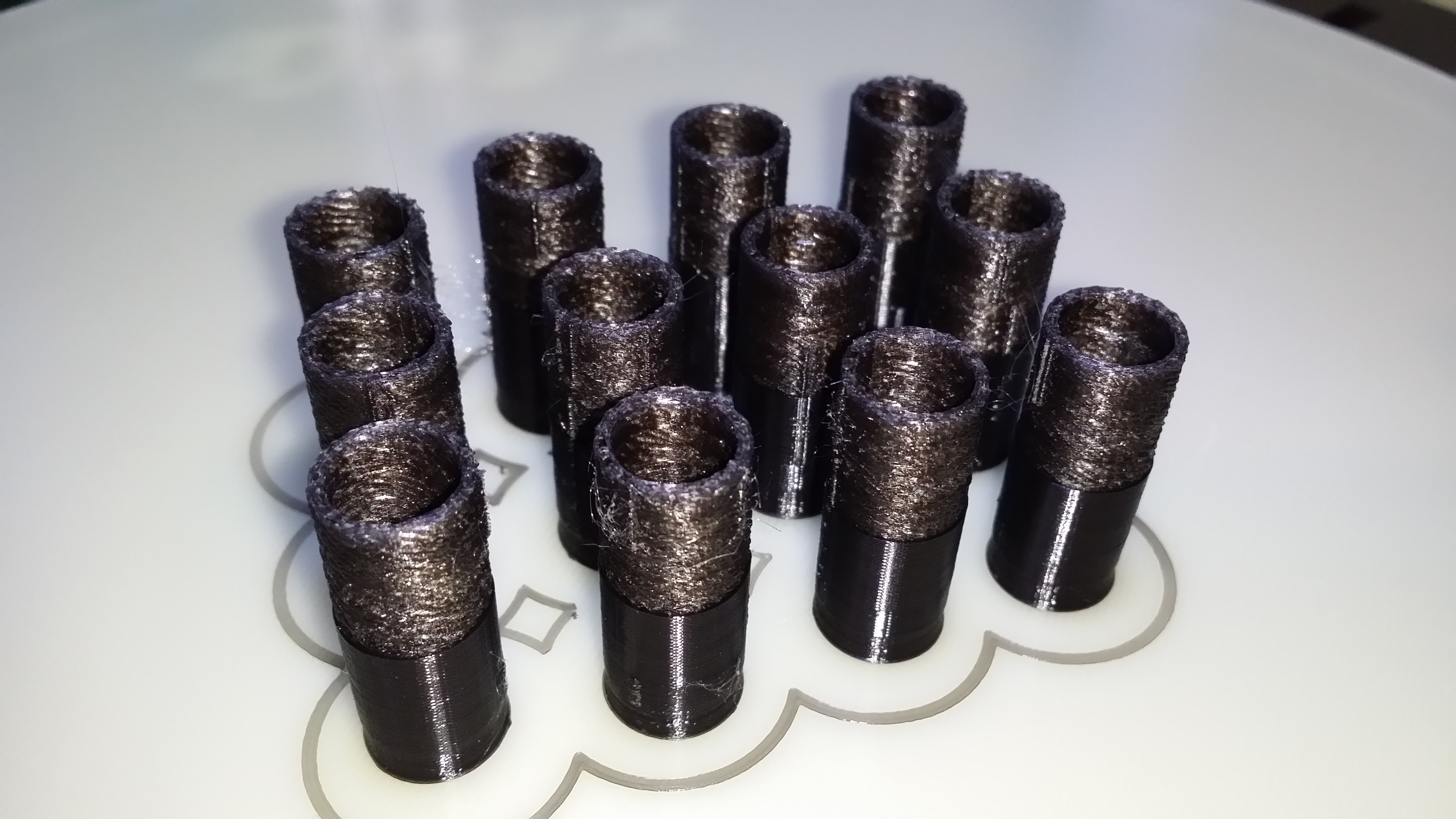

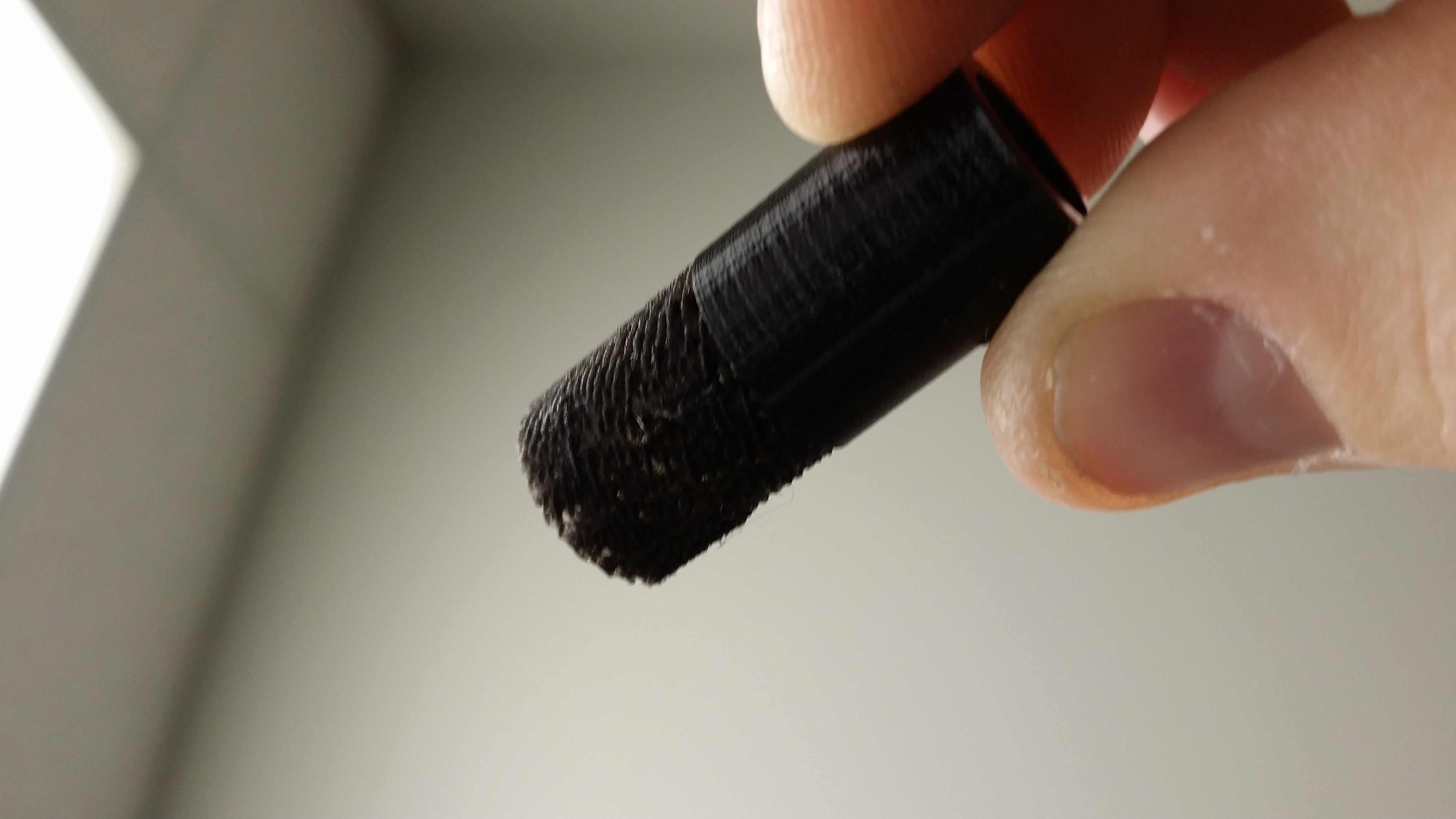

I printed the arm holders... but had something funky happen. Maybe I had my wall thickness to big or something (never had the problem before), but it looks like it decided to only print the infill and not the outer layers!
There was only about 1/2 meter of filament left on the spool when I checked them this morning, so I'm wondering if the tightness of the spool curve was creating so much drag it was starving the extruder, or there was something wrong with my settings.

The key to making sure the balls stick to the screws is to heat cure them. I stick them close to a desk lamp and let them heat up. They probably get to 70 or 80C.
As for the printing issue...I use kiss for slicing. I believe I was at 0.20 layer height and I set the number of loops to something high like 7. With these I try to avoid the infill. They are tricky to print right for sure.

I tried dropping the ball and screw and pulling and twisting and so far I haven't been able to make it budge. It's possible I've been lucky though. I scraped the balls where they're attached and used a dremel to round out the tops of the screws a bit hoping to give a better grip for the weld. I might try and see if I can physically weld a few together too.
Also, what I don't understand on my failed prints, is that the first 3/8" of the 'tube' part printed find. I haven't had a chance to check out your STL, but is the groove for the magnet slightly tighter, giving an ever so slightly thicker wall in that area?

Looks like filament starvation, is that PLA? You should probably use ABS for the joints.

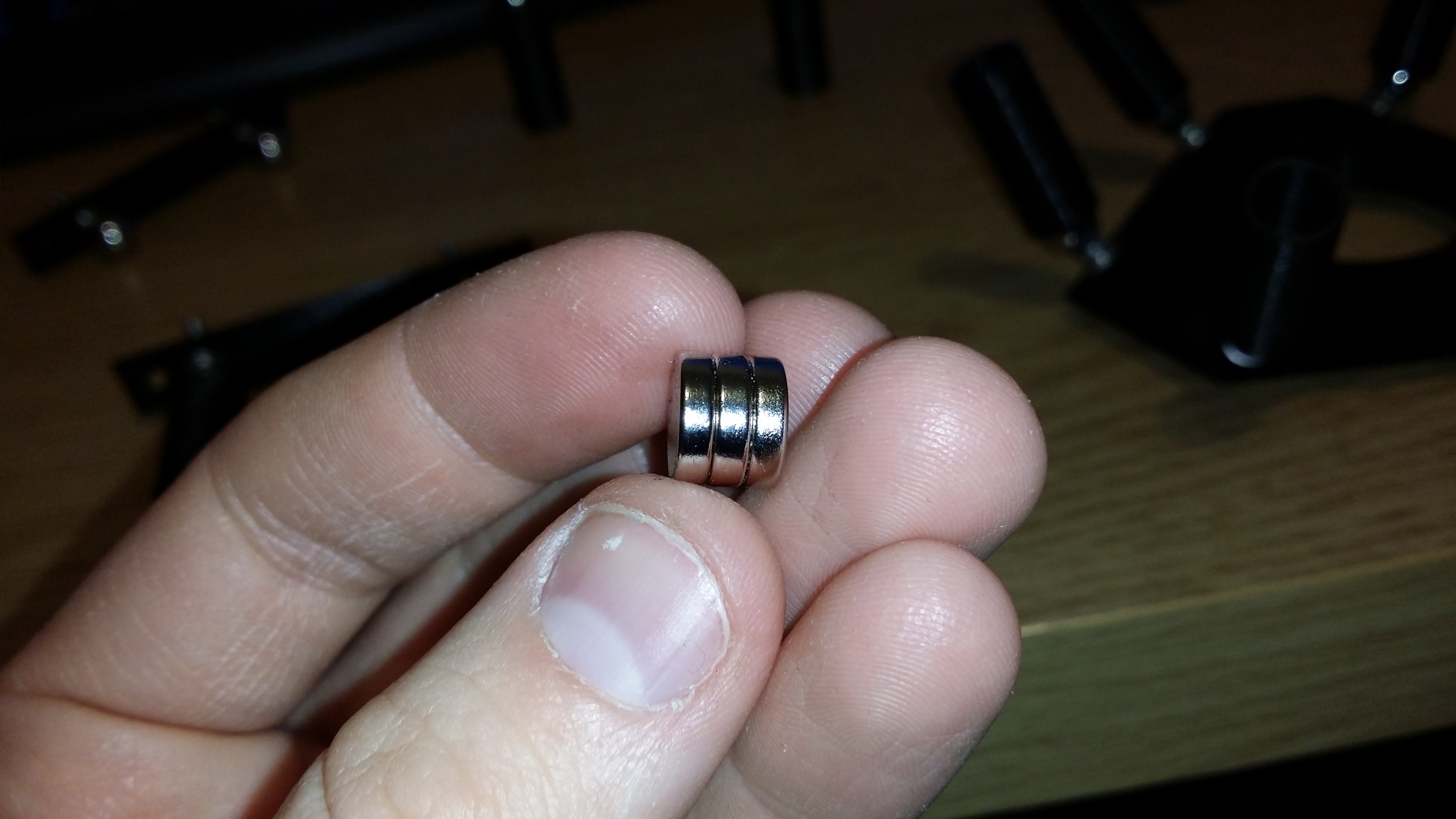

I used the magnets with the Bearings, dipped the head in JB-Weld then attached the screw to the bearings, the magnet held them into place, Looks like you are using stainless cap screws so that would not work.
Then when they set a little bit I placed them in oven on 170° for 30 minutes it cured the JB-Weld then let sit for a few hours more (not the full 24 hrs), I can not pull the screws off the bearings at all.
I also got a 3/8" round nose bit and turned it by hand in the ends of the ABS Rod Ends and this took out any little differences in print and made the Bearings fully seat in the groves.
Joe

Nylocke wrote:Looks like filament starvation, is that PLA? You should probably use ABS for the joints.
Yeah, they're PLA. I'd love to use ABS, but I can't seem to get it to stick at all. I've tried everything except the hairspray as I haven't been able to find it yet.
Any particular reason you would use ABS instead? I find the joint feels smooth as silk with the PLA, and I can't imagine heat being an issue.
It was filament starvation. Sitting there, the PLA would ooze from the nozzle, but as soon as I put pressure on it at the EZstruder... it would just jam up.

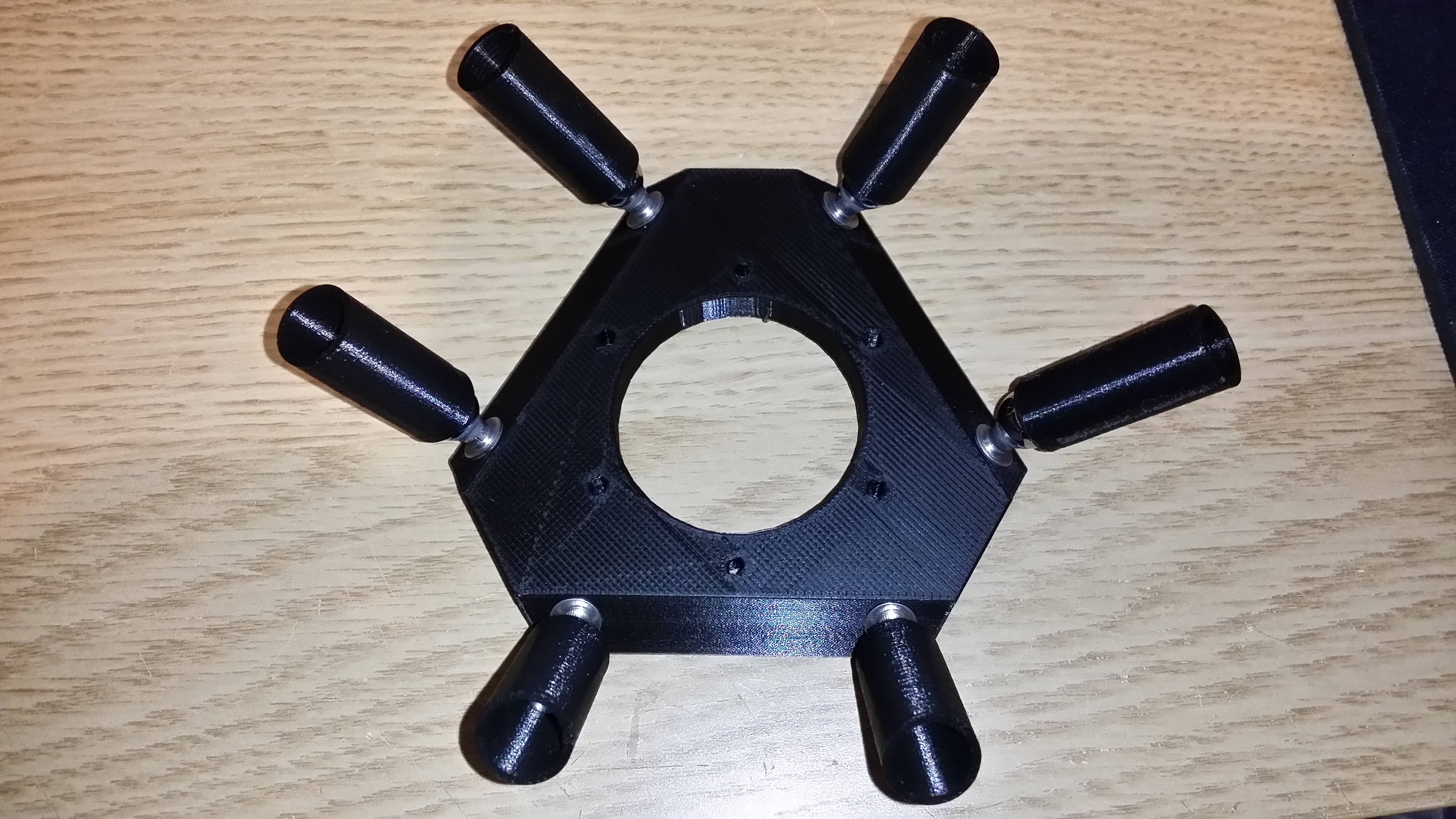

I've almost got my setup ready to go. I didn't have any 3/8 x 3/8" cylinder magnets, so I ended up using 3 x 3/8" short magnets and stacked them together. It ends up being .300" thick altogether, but the attraction feels pretty strong.
My rods are going to be aluminum, but I'm a bit worried about the weight that will be throwing around. I haven't found anyone local that carries 3/8 carbon tube and the ones online are a bit out of my price range. I've seen people use the archery arrow shafts, but I haven't found any that are 3/8. They all look to be around 5/16".

try 3/8 wood dowels, or print the ones in the files.
