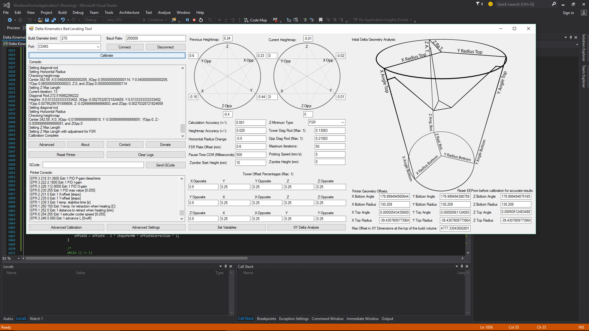

Progress Update:
I have mostly finished the new method which involves iterating step-by-step through each section of the calibration. I need to test, and will not be able to do any testing til next Friday.
For now, I am beginning to implement the correction for XY scaling, using the small amount of data that I have already collected from my printer - barely enough. However, I should be able to get a fair amount of it completed.
Also, I have corrected the UI so it has feedback from the advanced and normal calibration in the more panel. Still need to correct the log.
I may update again later this week on the progress, if much is made. Otherwise, check back next weekend.

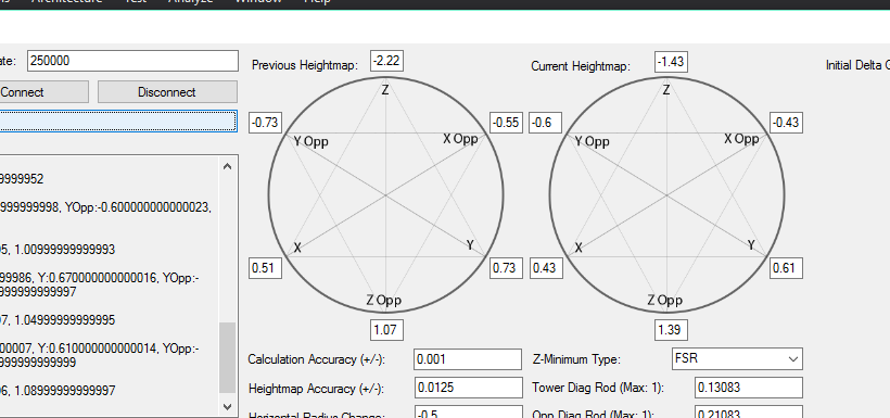

Progress Update:
I have concluded that 3 steps of the calibration Do Not affect the XY scaling, this being said the 2 steps that did affect scaling - horizontal radius and diagonal rod calibration - cancel each other out in the changes they make to scaling. However, there is a slight error though in this cancellation - if a tower is off by 5 degrees there will be a maximum change of 0.1mm across the plate (at the zero height) and will significantly get worse as the angle expands. That is the maximum change that this program will affect the printer in the X and Y dimensions and that is only if your towers are not square.
One other feature that I have added is visualizing the error in the towers - angled inward or outward. This was done through a chain of relations that I've found. I'll over-simplify: use the height at the tower and the opposite of the tower to find the angle of the bed in relation to the towers, and use the angles found there to find the difference in the printers radius at the bed of the printer and the top of the printer. To find this relationship your printer must be set to its default settings. Otherwise the angles will be inaccurate. There's one more thing I should mention; this analysis is done via the first iteration of the program, so it does not take any longer to complete.
Since the XY scaling is no longer an issue that I am able to truly fix at all heights, I do not need anyone to test anymore. If someone still reports there data to me though, it will still be very useful.
I still will not be able to test these changes until next Friday, so this is most likely my last update til then.

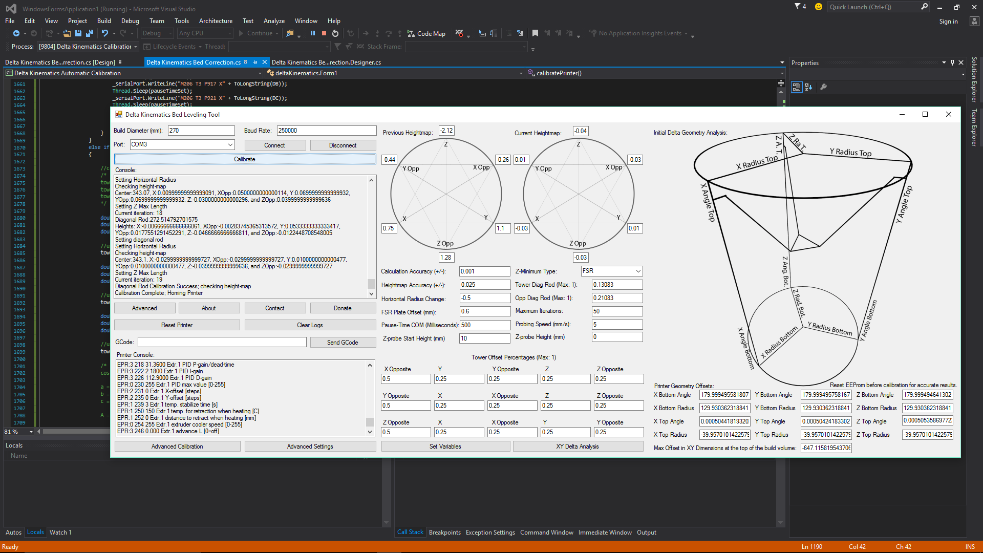

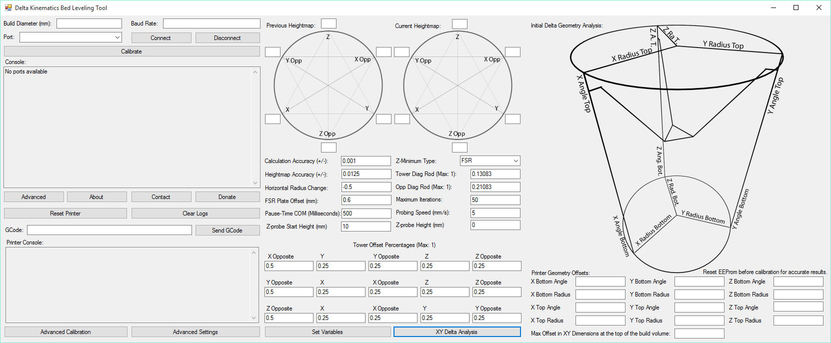

I am improving upon the delta geometry analysis, I want to make sure the math behind it is sound.
Another correction that I am working on is setting the XY scaling - need to acquire a fair bit of data first. This could correct the scaling for printers that have (almost) no error in the angle of each tower(< 0.5 degrees). However, in printers with offset angles in each tower, the scaling would only be accurate on the first layer, then would gradually degrade in accuracy as the print gets higher. There is no non-mechanical fix for this at the moment, this would involve calculating the angle of the tower then modifying the firmware to make live changes to the delta radii - heh.
I've included a screenshot so that it is simpler to show what all I have deemed possible to calculate so far (this information is only coming from the EEProm and height-map values). Having these values opens up other possibilities as well, but for now it will just let you know if your scaling will be off and by approximately how far, when you reach the top of your build volume(in comparison to the bottom). I will add a feature soon that will let you enter a height and figure the scaling offset at that height - not much work, only factor is finding time to do so.
I will be testing and correcting any errors tonight and Saturday.

I am still testing, but figured I would let everyone know the current standing.
I have made a few modifications; one being a correction or seven to the geometry analysis, a fix to actually calibrate the delta radii - allowing for accurate scaling, and I am currently trying to speed up the process/accuracy of the XYZ offset calibration. (There were a ton of minor changes that aren't worth mentioning)
I have included a picture of the two height-maps while the delta radii offsets were being calibrated. As you can tell by the picture, the towers and the opposites of the towers are their exact opposites in the current height-map, while (X and Y towers are on) the Z tower was offset by nearly a whole millimeter. This doesn't affect the outcome of the bed leveling, however, it does correct the XY scaling. After this test my scaling accuracy (at Z=0) in the XY dimensions went from 129.5-130.35 to 129.95-130.05 - about as accurate as I could measure.

Version 2.0.3PA - Tested without error(stabile on RMax V2)
I am going to go ahead and upload what I have so far, the XYZ offset is not as efficient(higher # of iterations) as I would like, but it gets the job done. Also, the printer analysis is not complete either. I have the equations written out over a couple sheets of paper, but need to transfer it to code, so at the moment it will not be correct. I have included two screenshots; one without changing the EEPRom settings, and one with setting them to defaults. Both worked.
-Do not run this if you zheight is off by more than 10 millimeters(without changing settings), your nozzle may crash into the plate.
-Make sure you change the Zmin type before running.
-Use G31 to check your probe.
-The advanced calibration does not differ much from the basic calibration at the moment, use either.
I will be changing the basic calibration eventually, but for now it uses the advanced calibration code without checking the offsets. It works the same, if not better, but it will take way longer.
