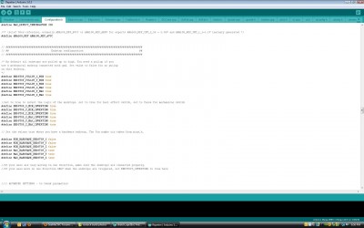

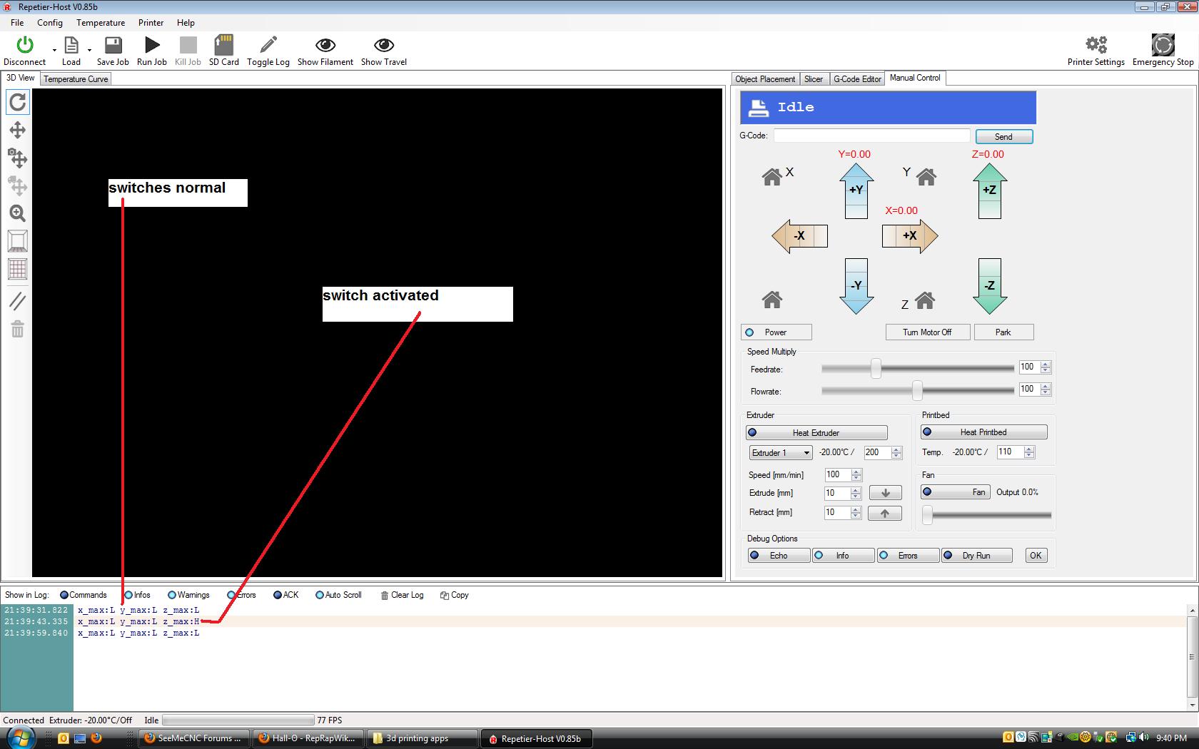

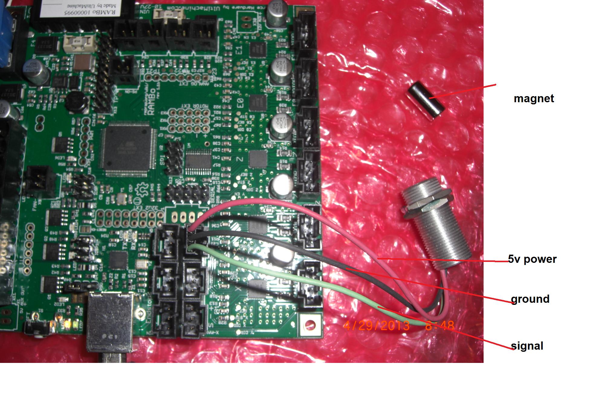

hall effect endstop/home switch testing success
Post by cambo3d »
this is really easy to set up, just change some values in firmware and its ready to go.
testing on the bench
proof

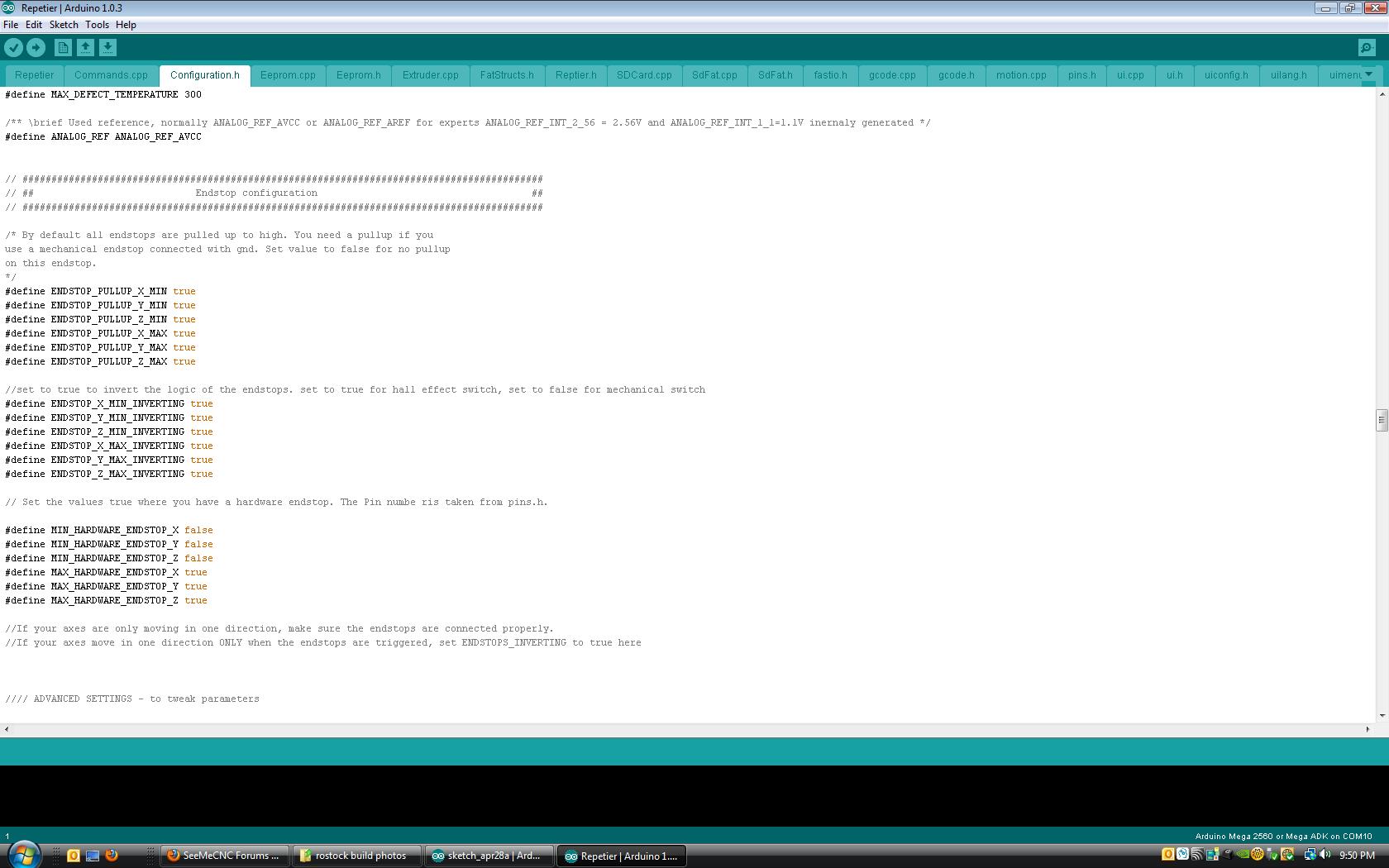

firmware setup

I got them from ebay awhile ago because they were selling them at a discounted price for this particular model. Ive had them in my electronics pile for quite sometime. here is the part number for it. 103sr13a-10.
note though: you can use almost any type hall affect switch, mine just has this fancy metal casing around it.

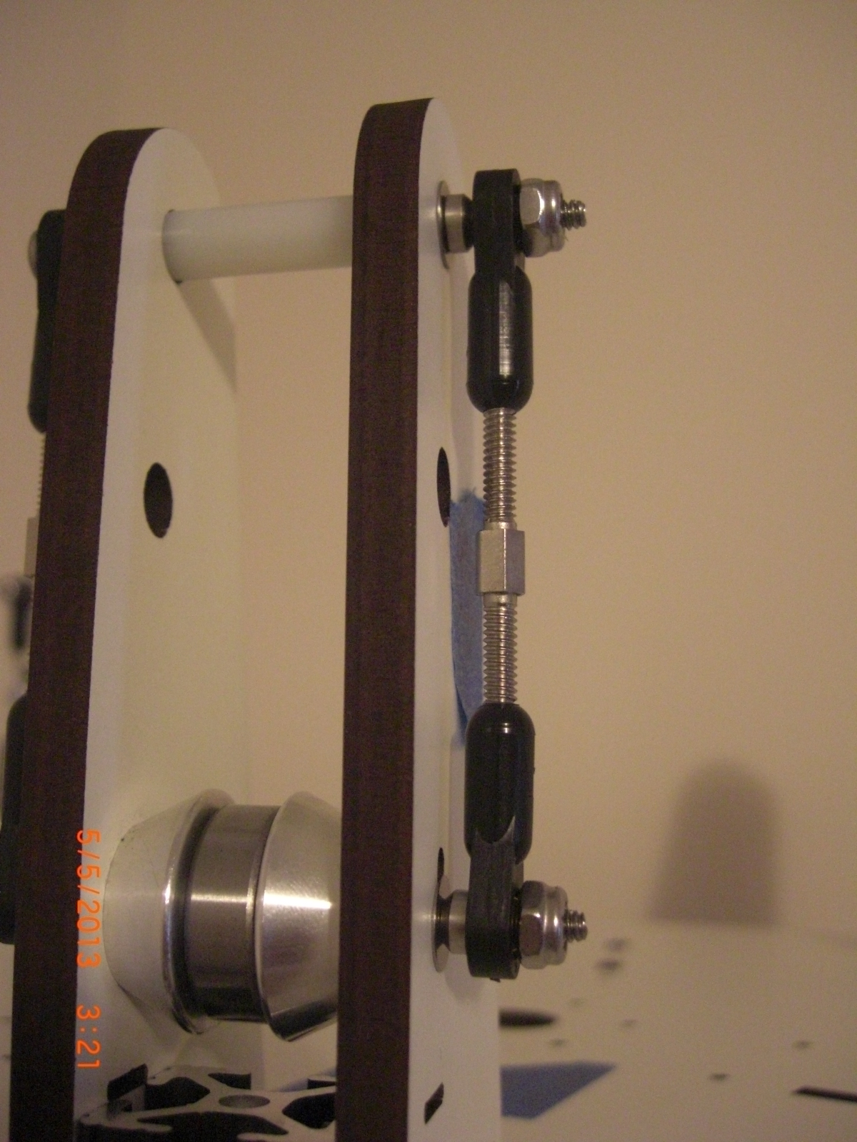

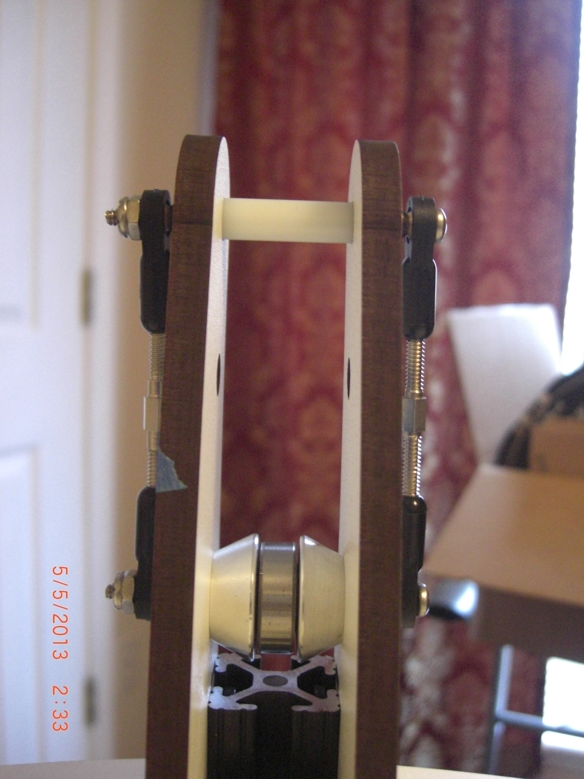

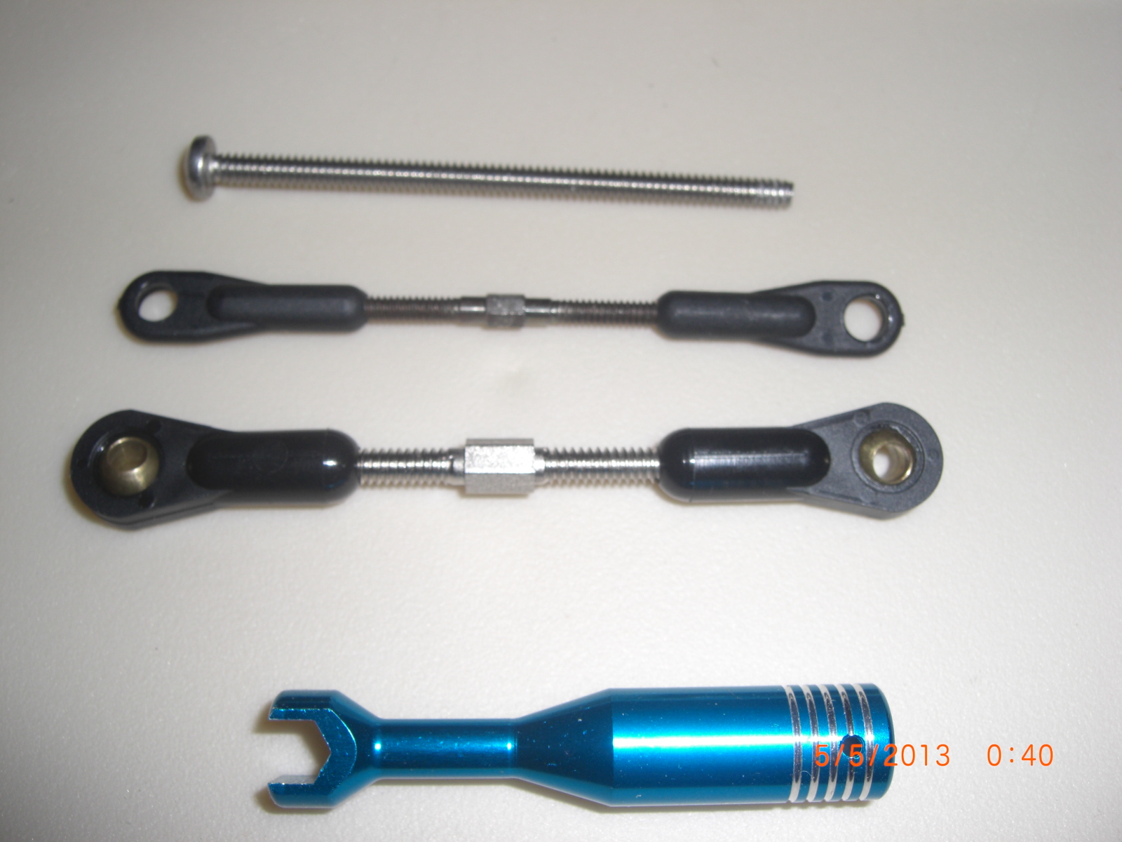

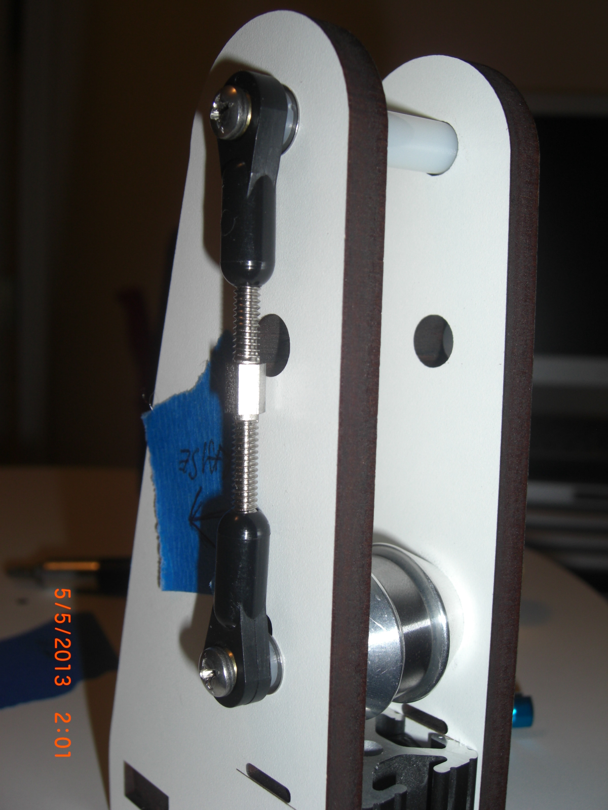

turnbuckle idea
Post by cambo3d »
so i finally found some heavy duty turnbuckles and ball ends that fit the stock screw sizes, here are the pics in comparison.
installed

you can use it either way,

Where did you get you hands on those, hobby store? What's the blue one at the bottom?
cambo3d
Posts: 1057
Location: Florida
Re: Another rostock max build
Post by cambo3d »
Flateric wrote:Where did you get you hands on those, hobby store? What's the blue one at the bottom?
that's my bling bling 5mm adjustment wrench :mrgreen:

cambos T-buck tensioner parts list and files.
Post by cambo3d »
Turn buckle tensioner parts, FOR modified top supports.
I purchased some of these items in bulk, the quantities needed for assembly are in parenthesis ( ).
• (1) Dubro - DUBQ2316 – 12 pack of monster ball links, package has hardware needed for installation so don’t lose the parts
• (3) Packages of Great planes – GPMQ3754- Turnbuckle/pushrod, these come two per package.
• (6) 2.5in 6-32 screws Mcmastercarr part# 91772A161
• (12) 6-32 washers or #6 washers
• (3) 5/16 OD x 1.5in length nylon spacers for #6 screws. Mcmastercarr part # 94639A371
• (1) 5mm adjustment wrench, towerhobbies.com carries an assortment of these, just pick one you like. http://www3.towerhobbies.com/cgi-bin/wt ... 5mm+wrench& search=Go
• (6) Modified top support plates dxf file below.
Notes:
All the turnbuckles will need to be cut down slightly, they are 54mm in length, I removed 4-6mm off each end to give me the adjustment range I needed. If you can find shorter length turnbuckles in the 6-32 size and around 42mm that would be a better fit for the current top support plates. You can also modify the dxf file so that there is more spacing in between the very top and the bottom hole, that way you don’t have to cut down the turnbuckles. My top support plates were already cut so I did the later.
If you need to cut down the 6-32 turn buckle, this can be accomplished with just some wire strippers that have 6-32 bolt cutters integrated, makes quick work of it. Just use a file to remove any burrs.
dxf files for modified top support plates.
top tensioner dxf file metric.dxf
(577.29 KiB) Downloaded 335 times
top tensioner dxf file standard.dxf
(330.94 KiB) Downloaded 379 times

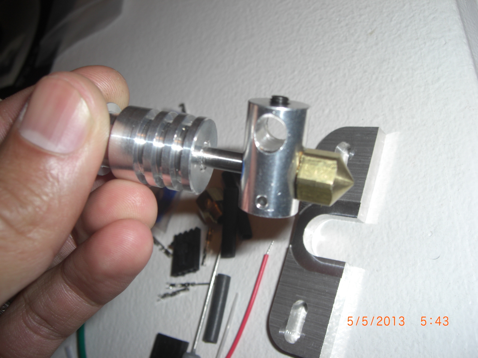

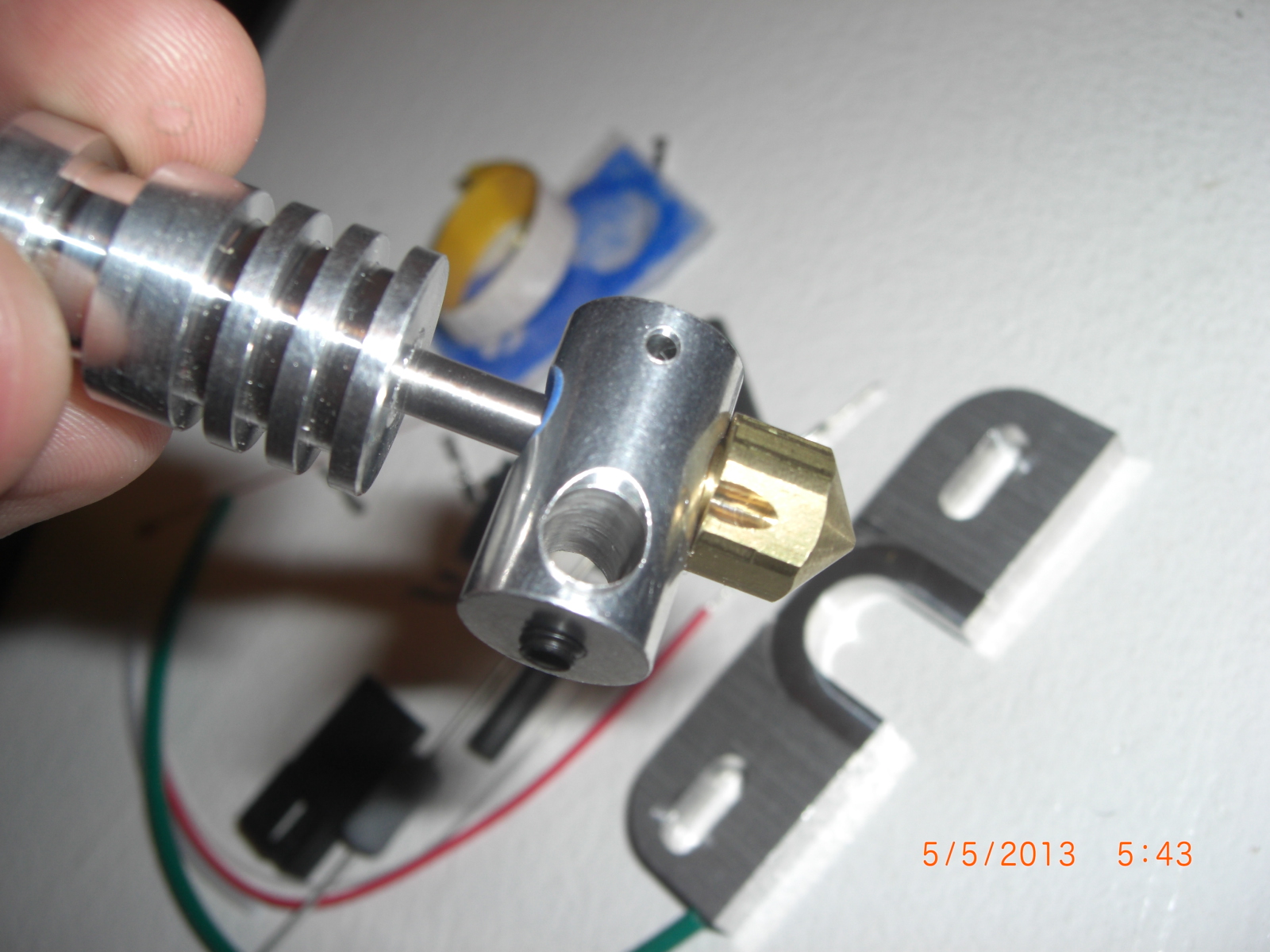

my all metal hotend arrived today also,
looks pretty, this is for 3mm filament so im waiting on some other things to test this out.
Flateric
Posts: 811
Location: Calgary, Alberta
Post by Flateric »
Nice! A trinity labs one, I grabbed one of them too. Shame about the 3mm only so far from them.

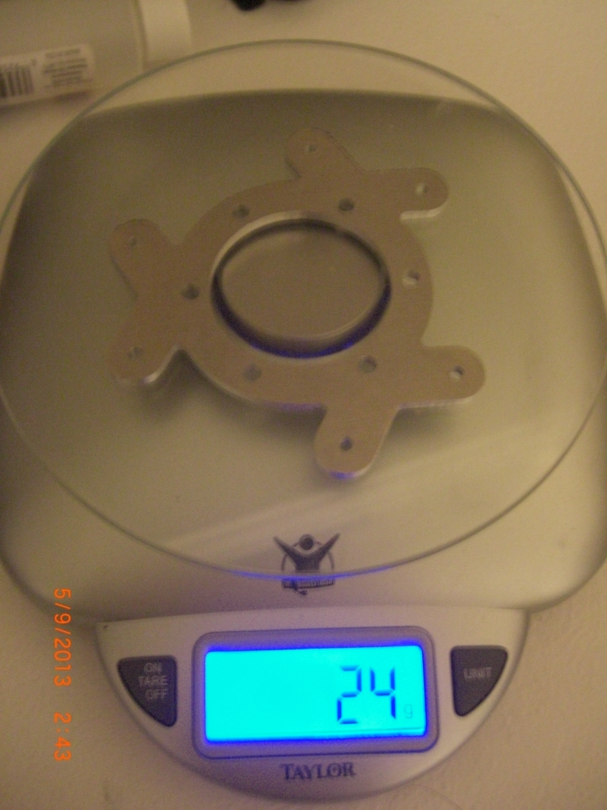

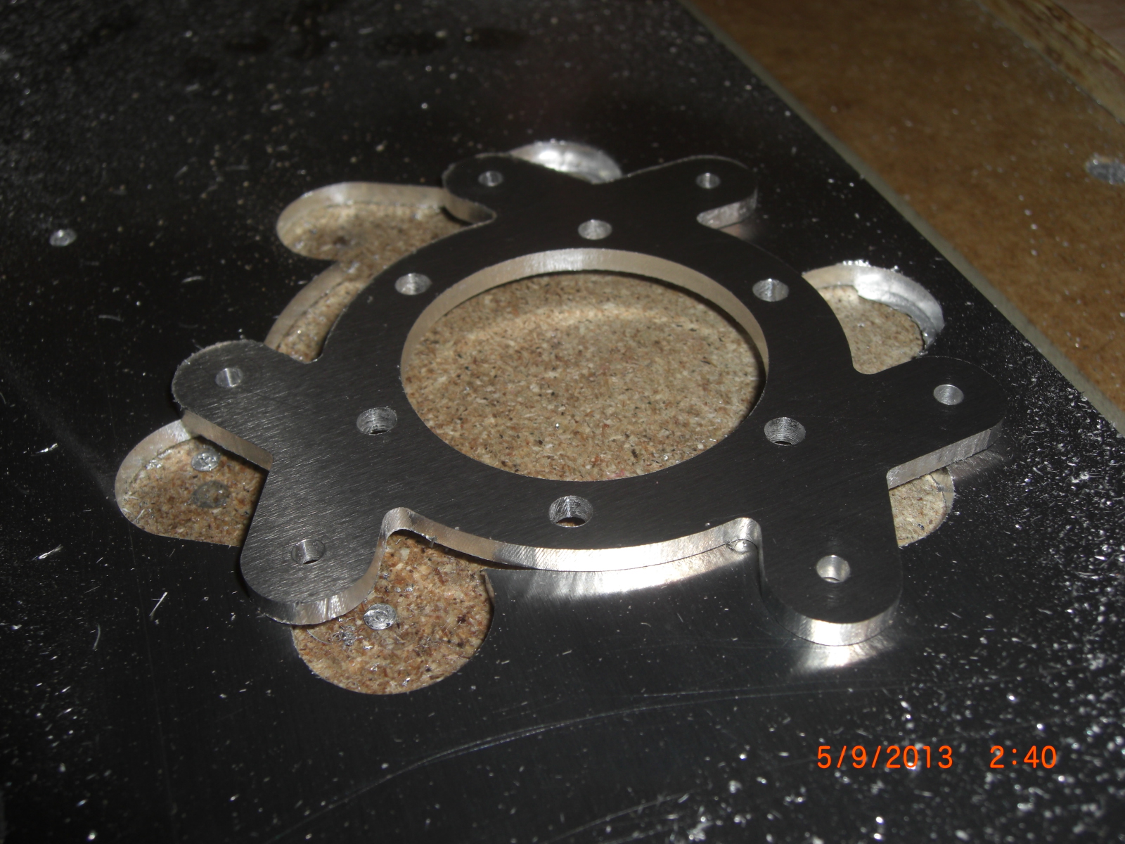

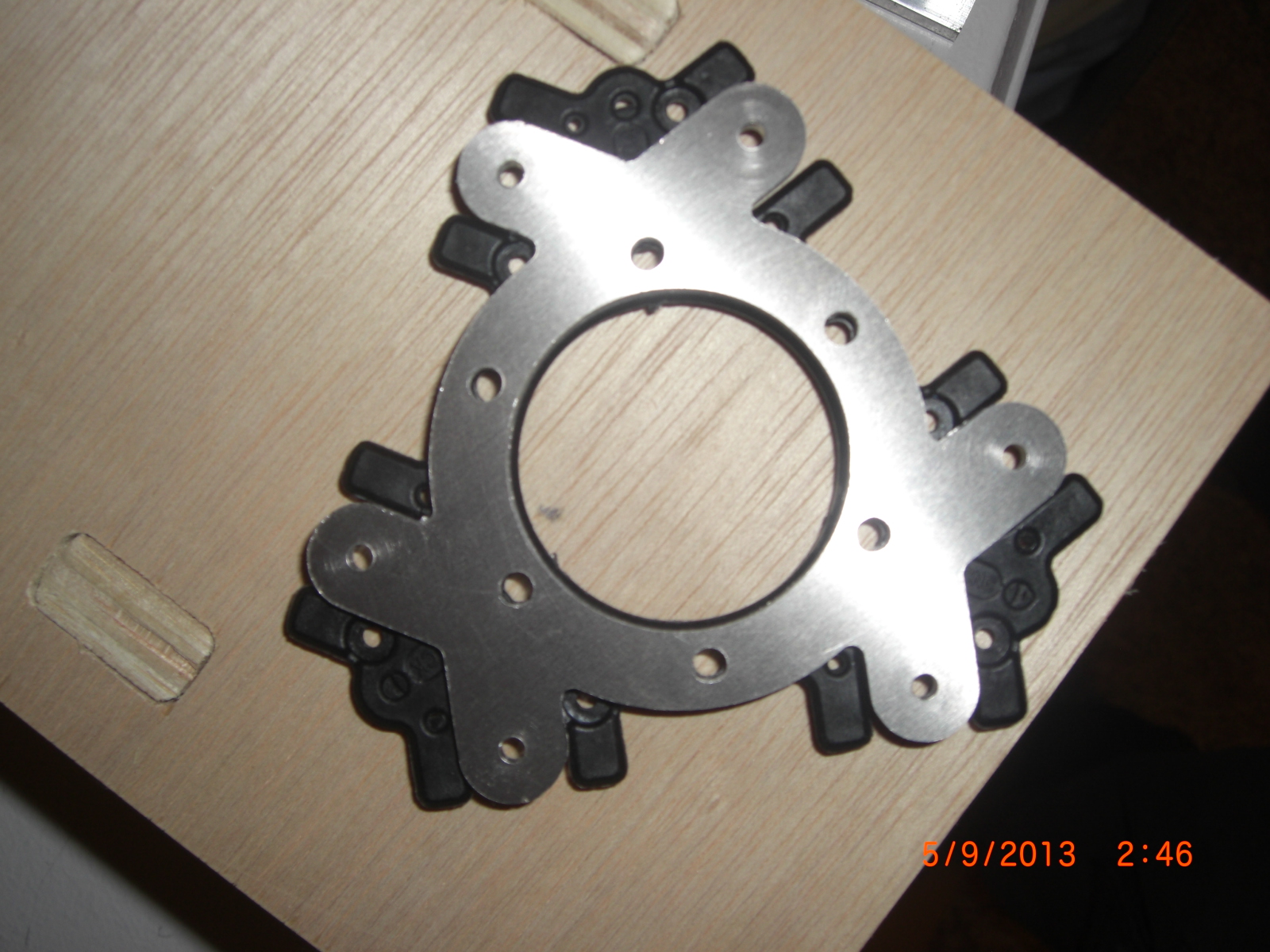

all aluminum platform for magnet ends
Post by cambo3d »
excited to show this off today, made from 1/8" 6061 aluminum. http://forum.seemecnc.com/viewtopic.php ... 300#p10848
off the cnc router
weighs about 24g, don't know if this is good or bad, but seems fairly light to me.
comparing to stock
can use ball studs with magnets ends on the rods or, cup mount for ball bearing, etc.. still working out the design

cambo3d wrote:my all metal hotend arrived today also,
Mine arrived as well, the resistor supplied is too large to fit the hole in the heater block, so I won't be assembling it for a couple of weeks, by the time the heater cartridge I ordered arrives I'll be travelling for business. :/

That's strange mine fits perfect. although i don't know if I'll use it or not. I want to switch to the cartridge style.
foshon
Posts: 600
Post by foshon »
cambo3d wrote:That's strange mine fits perfect. although i don't know if I'll use it or not, I believe its a 24v resistor. I want to switch to the cartridge style.
Be careful, if you put the thermistor in the nozzle it is damn near impossible to get PID right. I had to butcher my firmware to get close.

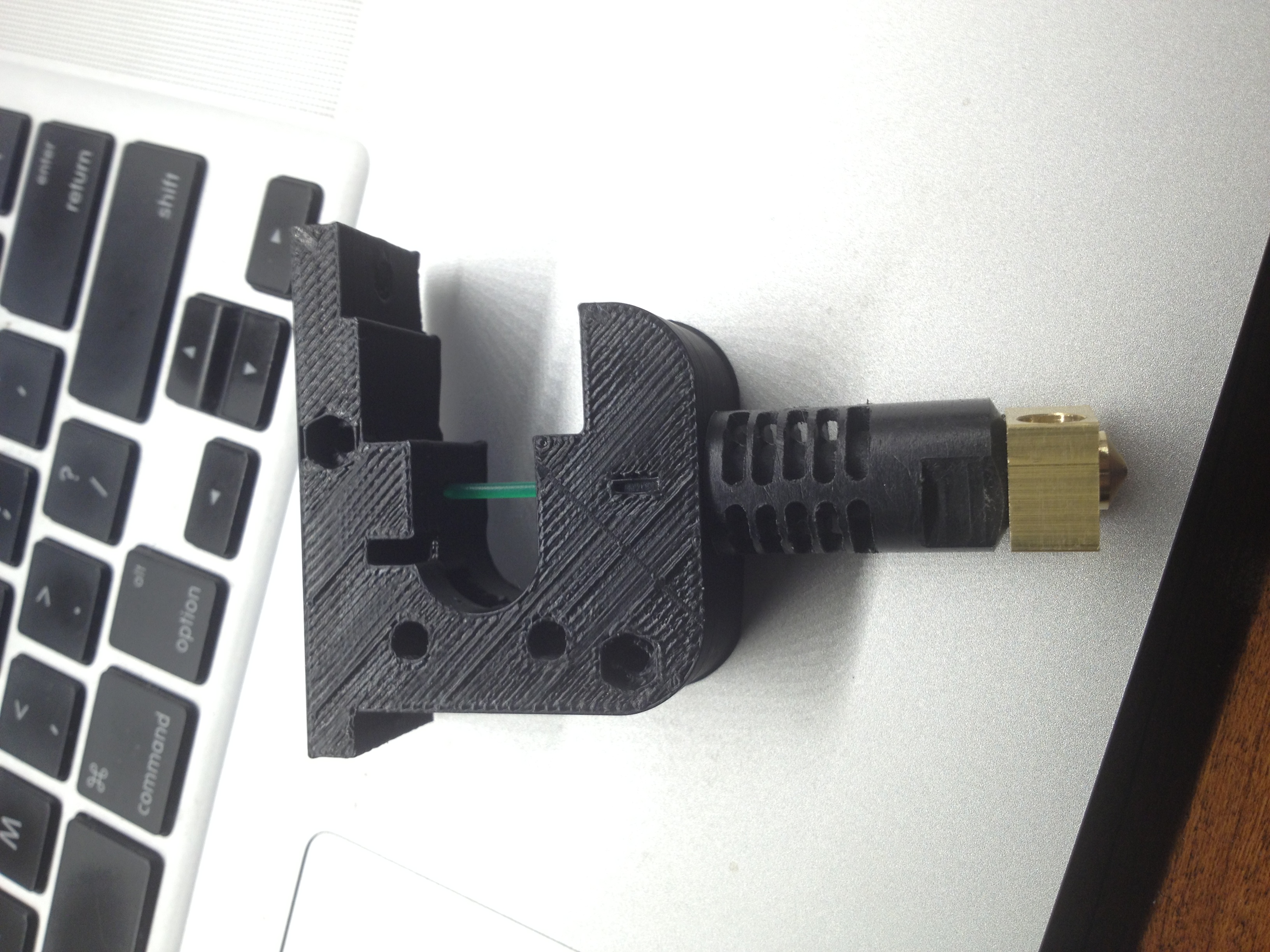

sneek peak at the under mount pg35l direct drive extruder mo
Post by cambo3d »
here is the prototype mount for the pg35l extruder.
This version mounts the direct drive extruder underneath the rostock platform. vs the top as shown on this thingiverse link http://www.thingiverse.com/thing:43457
