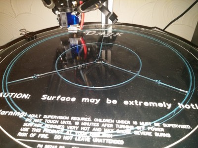

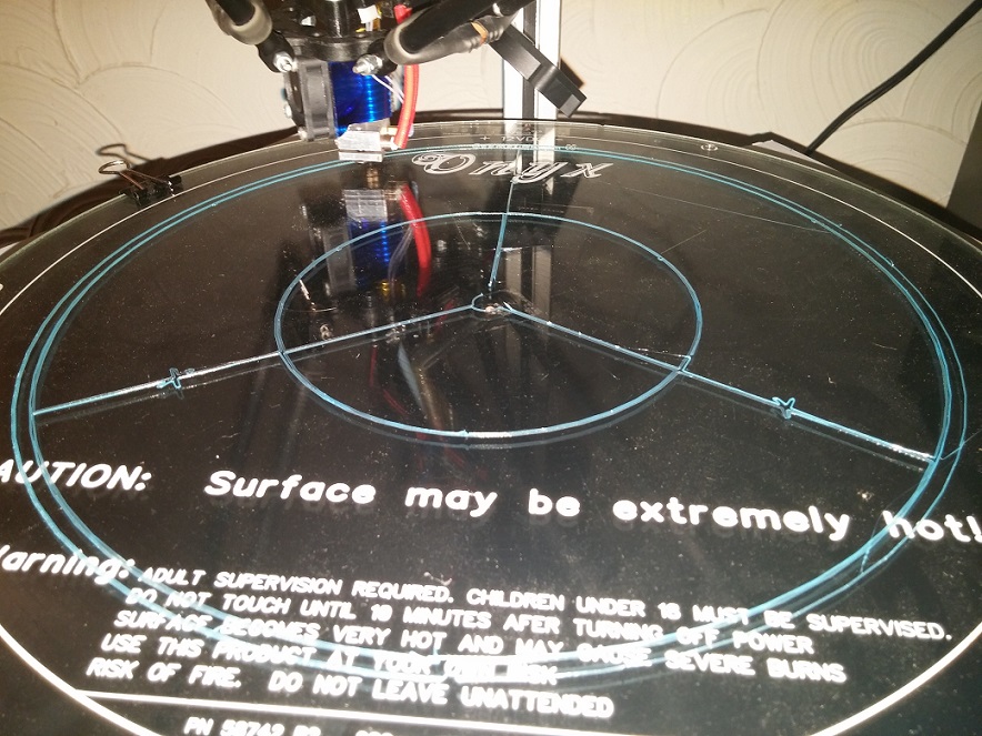

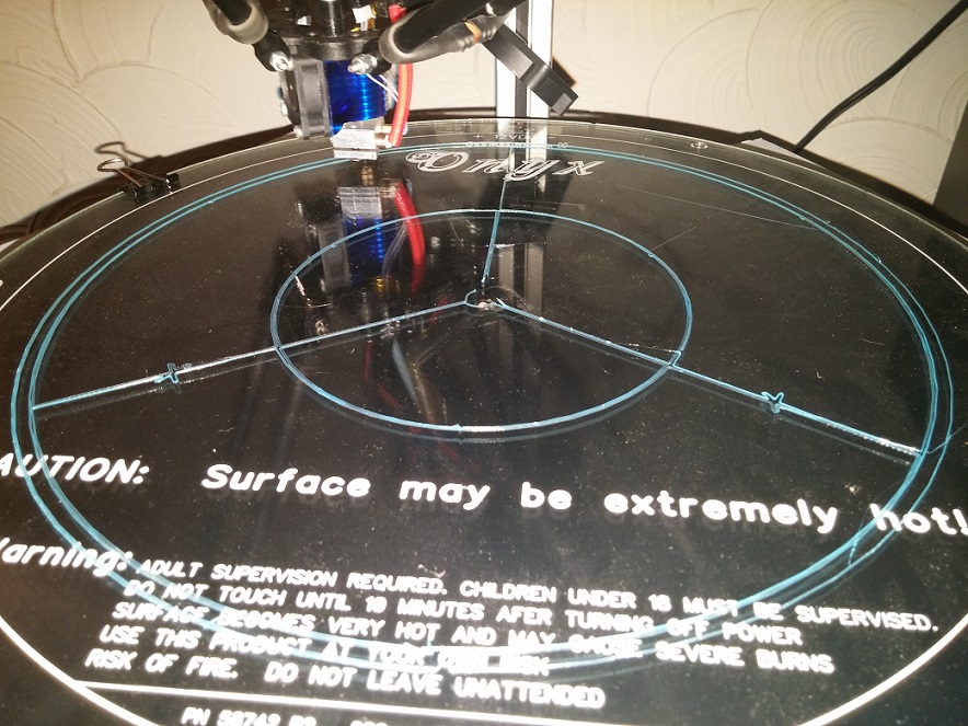

Results:
HTML calibration helped a lot (thanks again Rollie!) Not perfect, maybe due to having to remove the gauge and put in the nozzle.
Nozzle was to close to bed around the X axis, but a 1/8-1/4 turn of the end-stop screw seems to have fixed it.
And, I got all the way out to 279mm and the printer wasn't even sweating!
(Unfortunately, when heating up for the next print, my printer let out a loud electrical "Crackle" and died in a cloud of invisible smoke.
No idea why yet, or what to do about it - it seems totally dead. It's off topic, but if anyone has words of wisdom to offer, I'd much appreciate it!)
Anyway long story short: 325 arms + html calibration + a tiny tweak = a successful test print at the Plate's far outer edge.
I'll probably get the FSRs soon and try to improve results further - if I can get the machine to live again...

It's good to hear that the calibration helped! And the fsrs were definitely worth getting, they are fantastic.
It is dissappointing that your printer may have died though. I would suggest testing the power supply, if that works, then assuming you are still using the stock Rambo, check the fuses on the board. But since you are saying white smoke, I'm assuming it is caustic smoke from your controller or psu. Which would mean something has overheated, not good...

I figured I would upload a picture of the results.
-Default mattercontrol settings (except nozzle size, which is 0.4mm - I have an e3d installed at the moment)
-Pressed print right after calibration, no z-height or any other modification. (Same calibration as the log from the previous post.)
-No bed heat or any form of adhesion - the true test.
Also, sorry I forgot to oversize it to fit the 11 inches, I just used the default size. There is an area in the center where the plastic didn't stick to the bed, I am assuming it is mostly due to the cumulative dust/dirt of 2 weeks - very bad, else just because of no form of adhesion.
Edit:
Thickness measurements of the print
XTower: inner 0.3 outer 0.31
YTower: inner 0.29 outer 0.3
ZTower: inner 0.3 outer 0.32
One more thing, I may need data from different printers for setting correct XY scaling. It is a very tedious task, and requires a lot of patience. However, it will help improve the programs accuracy in the XY dimensions. If you want to help, then let me know. You will need some things: calipers(accurate to 1/100th of a mm), FSRs, several sheets of paper, graphite, and maybe an hour of your time. If anyone is interested, I will write a reply describing how to properly get the data that I need.
