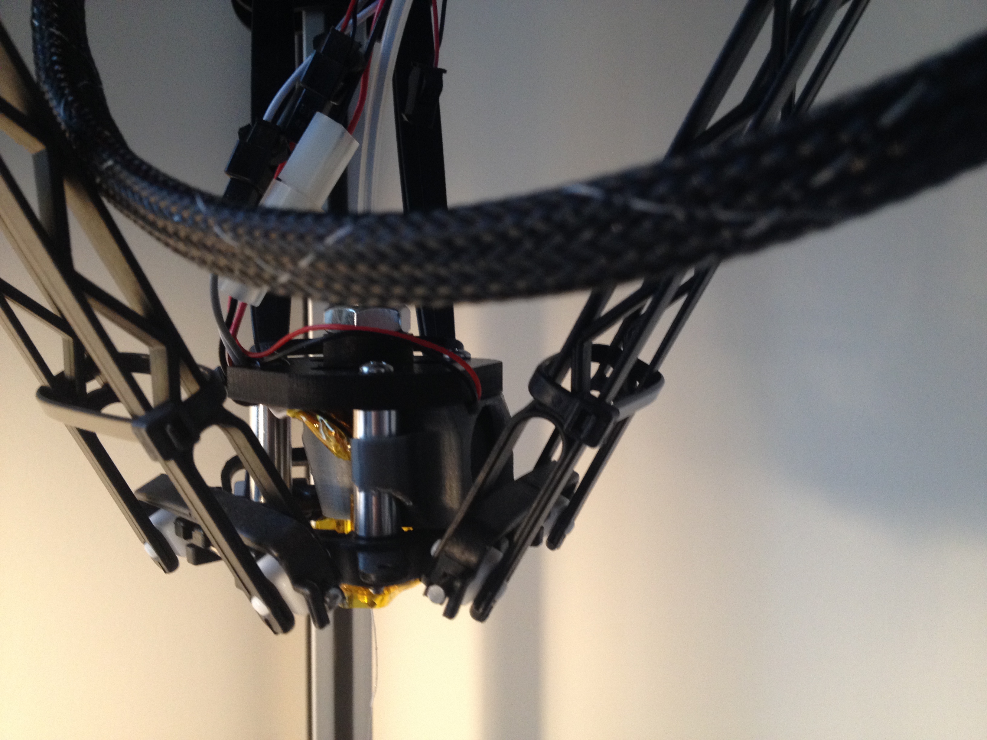

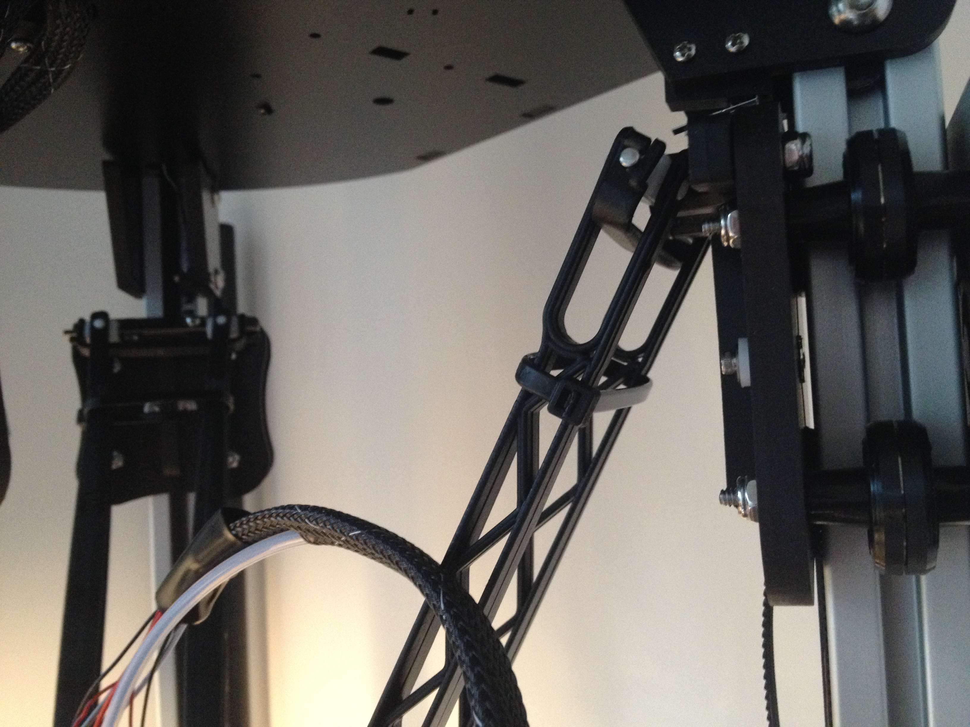

The top plates are physically bigger than the bottom plates, for certain, by about a few mm. The perimeter outline of them, that is. The tower channels line up precisely. (on the revision of the laser cut templates circa Sept 25 2014)
There is a noticeable amount of slack in the u-joint positions on the stock setup. I added some 11" cable ties to add tension to all the arms near the u-joints. It has stiffened up the effector tremendously. Where the effector used to slop and jiggle around before, now it is put firmly in place with no slop. The cable ties bind slightly at times, so a more forgiving solution like rubber straps might be better. (not to say that this is the cause of the "bermuda triangle" effect, but thought you might be interested in removing that as a factor)

Re: Unsolved Mystery. Weird Z0 behavior around build perimet
Posted: Fri Oct 31, 2014 9:55 pm
by bot
There is enough "slack" in the cable ties to allow it to "slip" into place. It sounds like the ridges on the edges of the tie bind slightly on the plastic of the arm as it slides, but it seems to consistently move when it needs to. I was worried of the effect you speak of, pilot. The cable ties were simply an experiment. The issue of the binding only comes about during "extreme" moves, ie, not near the center of the build plate. I haven't yet tested the extremities of the build plate, but for prints remaining in the center the cable ties improved print quality noticeably.
On larger prints, if I notice the binding causing artifacts, I'll look into another solution. For the time being they seem to work great. Like I said, it tightened up the movement of the hot end effector considerably. There is no slop in its placement. It also raised the effector slightly, requiring me to increase the z height. This seems to indicate that the radius HAS been affected, as well (I had to tweak that, too) The cable ties are surprisingly consistent in where they sit. The curve of the arms, combined with the shape of the ends, with one arm's curve protruding from the surface of the length near the end, gives the cable tie a place to sit firmly when in the "centered" position (the position it was in when I installed and tensioned the ties). When it "walks" up and down the arm, it always finds itself in the same place at the end, not riding up the arm like I feared.
![IMG_1389[1].JPG (1.92 MiB) Viewed 20424 times IMG_1389[1].JPG](./download/file.php?id=7178&t=1&sid=3807c32ddd274c57cb55dd0b701c8655)
![IMG_1390[1].JPG (2.35 MiB) Viewed 20424 times IMG_1390[1].JPG](./download/file.php?id=7179&t=1&sid=3807c32ddd274c57cb55dd0b701c8655)
Further testing is required, but it seems to be adequate for now to remove the slack. Also, I have nothing to link this to the problem described in this thread, but it seemed relevant.

Hey I know I'm still new to the forum, but I've been wrestling with this issue myself, and I'm scratching my head at this point. I've squared my towers as best as I can considering the frame design provides no way to adjust or fine tune the tower alignment, and all towers are square within .2 degrees. I've used a dial indicator to perform the bed calibration as described in the manual, though I've changed the points from 90mm from bed center to 120mm, in order to adjust the tower with it's arms as vertical as possible. Next I checked 3 points 120mm from bed center angled between each tower, and 60mm from bed center along the same lines. The towers and bed center are perfect (+- .5 mil), but the other points vary wildly. I know this thread is concerned zeroing close to the build perimeter, but do my measurements appear to be the same issue or a separate one? Measurements are relative to the center of the bed.
The sector between angle Z-C-Y seems to be fairly close and even to the center, but everything else seems to be off significantly. This leads me to believe that most of my error is coming from the X tower, either from the tower's alignment, or the carriage's interface with the tower, or the mounting point of the shaft the arms are attached to. Like I said before though, as best as I can tell, each tower isn't more than .2 or .3 degrees off measured towards the center of the bed, or tangent to the bed.
Any thoughts would be appreciated!
EDIT: In case it helps, I've also gone through a lengthy session of playing with the tower rotation values with no luck, And I have a spreadsheet with those values as well if anyone thinks that data could be useful. Also, what should I be targeting for "Good enough?" Does anyone know how tight of a tolerance all points should be to be considered "level"? I would think 25 microns would be pretty good, but I'm a relative newcomer to this sport.
