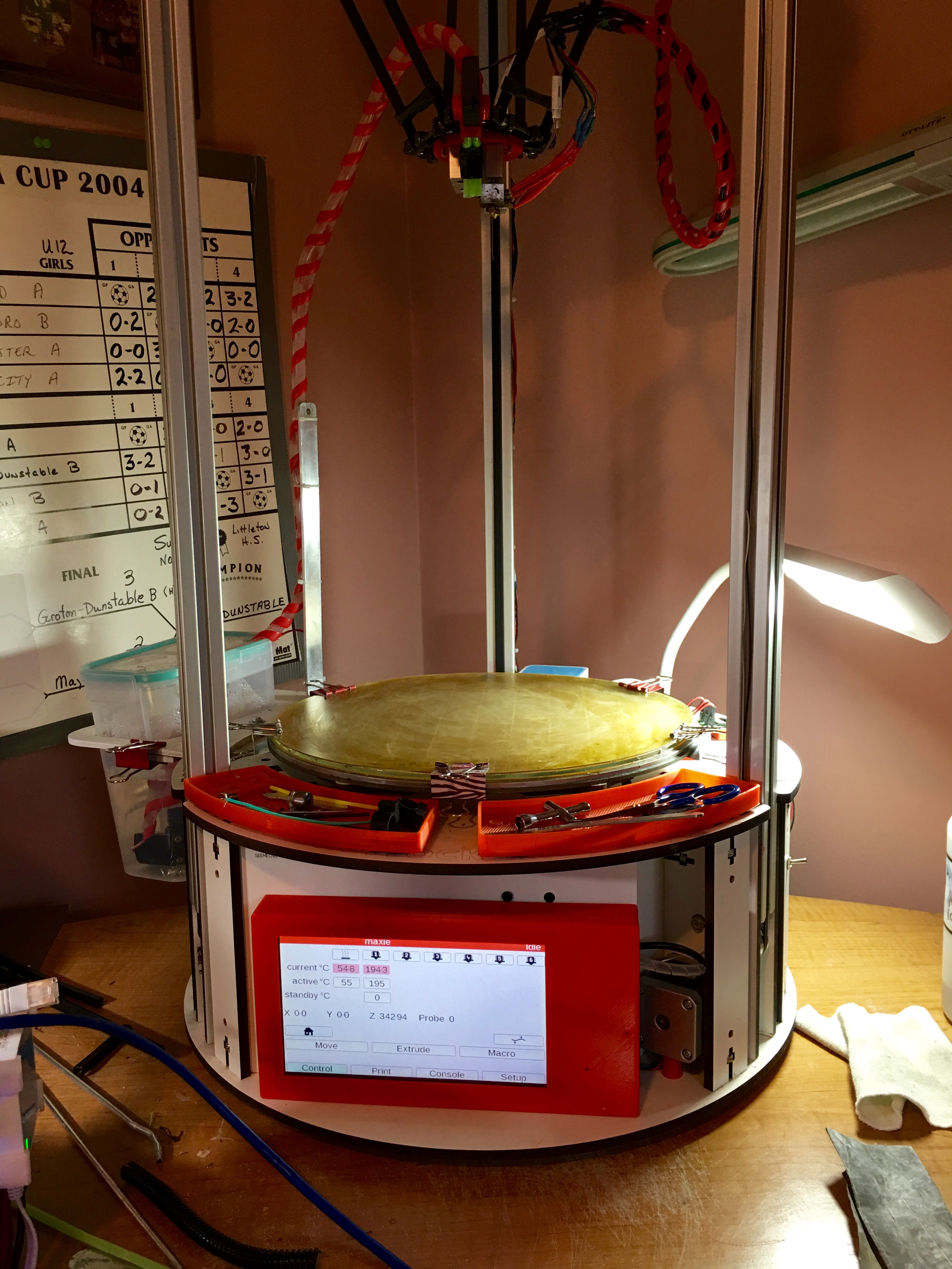

This is what a 7" PanelDue looks like on a Rostock:

Is the PanelDue *required* to be able to use the Duet? I can't see another $100 just for a screen.
Re: DUET and DUE PANEL
Another question for Michael, I am sure that you have seen the V2 Rostocks and wanted to pick your brain and see if you have any idea on how to mount the 7" paneldue on the V2.
I don't think that the box you created for the V1 would work for the V2 and I was curious if you may have any ideas.

No, you don't need a panel for the Duet. You can connect it over USB and use a host software if you really want or it has an Ethernet port and a very nice web interface.

Gene, I'd recommend using the web interface over ethernet and you can certainly live without the panel. The web interface is excellent.
Carl, one option would be just to have the display in a box on a tether and not fastening it to the Rostock. The case I have is actually just sitting there, it is tethered and that is how I usually use it.

Carl, I took a look at the photos of the V2 and it does look like you could mount this panel and box where the GLCD panel is mounted. It might hang over the left and right edges a bit but that would not affect anything. The other option is similar to the way the MatterControl touch panel is mounted.
For a v2 it wouldn't be that hard to just print a new melamine face plate that would hold the display panel and use the original nylon thumbscrews to hold it in place.
