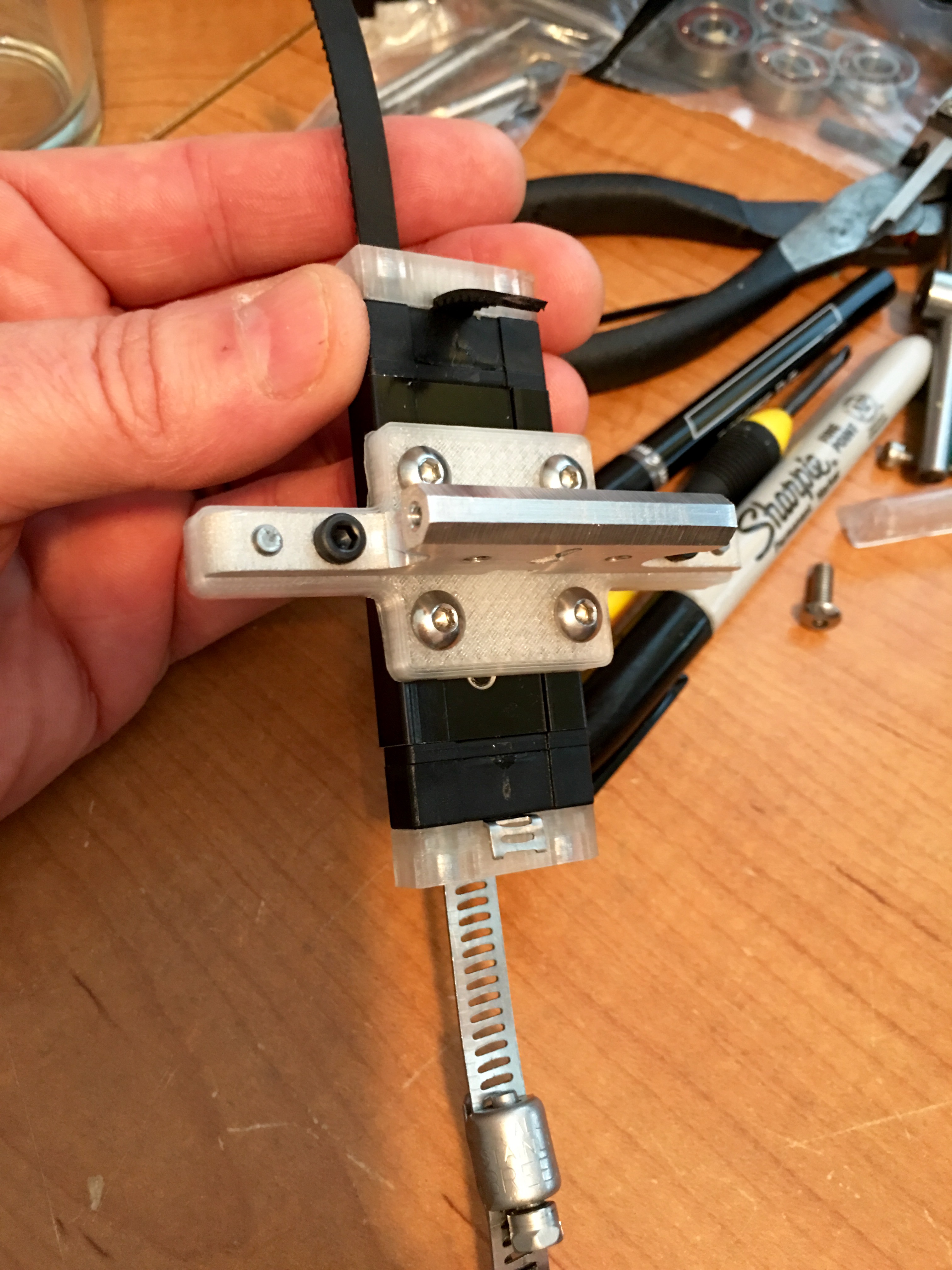

Here is the belt attachment and tensioning mechanism I designed for the carriages. I also printed this temporary mount for the TrickLaser carriage arm mounts. I'll likely cut these in aluminum at some point but may commission the printer with the printed parts as they turned out really nice and are rigid.

I'll be stalking you on this site.....I sort of am confused how you are using a ss hose clamp flattened as a tension-er for the glide, or why it needs to be there. Keep in mind that I have only built an Prusa I3 type machine and my other machine I own is a Cartesian type Wanhao D5S, so I do not yet pretend to understand the dynamics of the Delta yet. I am reading through the Rostock Delta's latest build guide to educate myself a little and of course eating up as much info as time will allow on this and other sites. I love the passing of knowledge and different views.

Re: Trick Laser MAX METAL with Linear Rails
1) you need a way to tighten the belts
2) on the Rostock and Metal Max, the pulley at the top of the tower is slotted so the belt can be tensioned
3) on my build with linear rails, I use 2 pulleys at the top to offset the belt to be parallel to the travel of the carriage on the rails, I prefer to have this securely mounted requiring an alternative belt tensioning mechanism
4) I "open" the hose clamp so you have a 4" long x 1/4" wide slotted strip with the adjustment screw in the middle. One end off this attaches to the bottom of the carriage as shown in the photo above. The other end is attached to the belt. I am making a little clamp that the belt inserts into and folds over for security.
Hopefully that explains things. Your machines must have some way to tension the belts, even if it is crude. I wanted to build a more reliable tensioned for this machine.
the MetalMax frame is EXTREMELY well designed and machined. I have seen none better for either deltas or Cartesian printers. I'm dying to get my build done!
