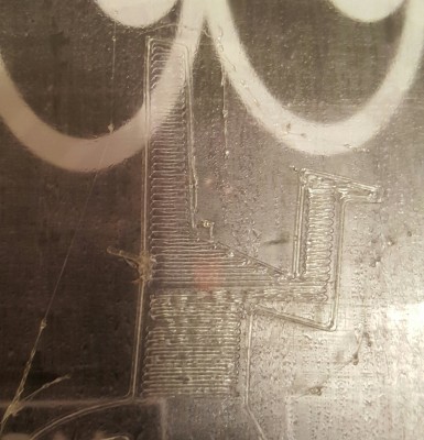

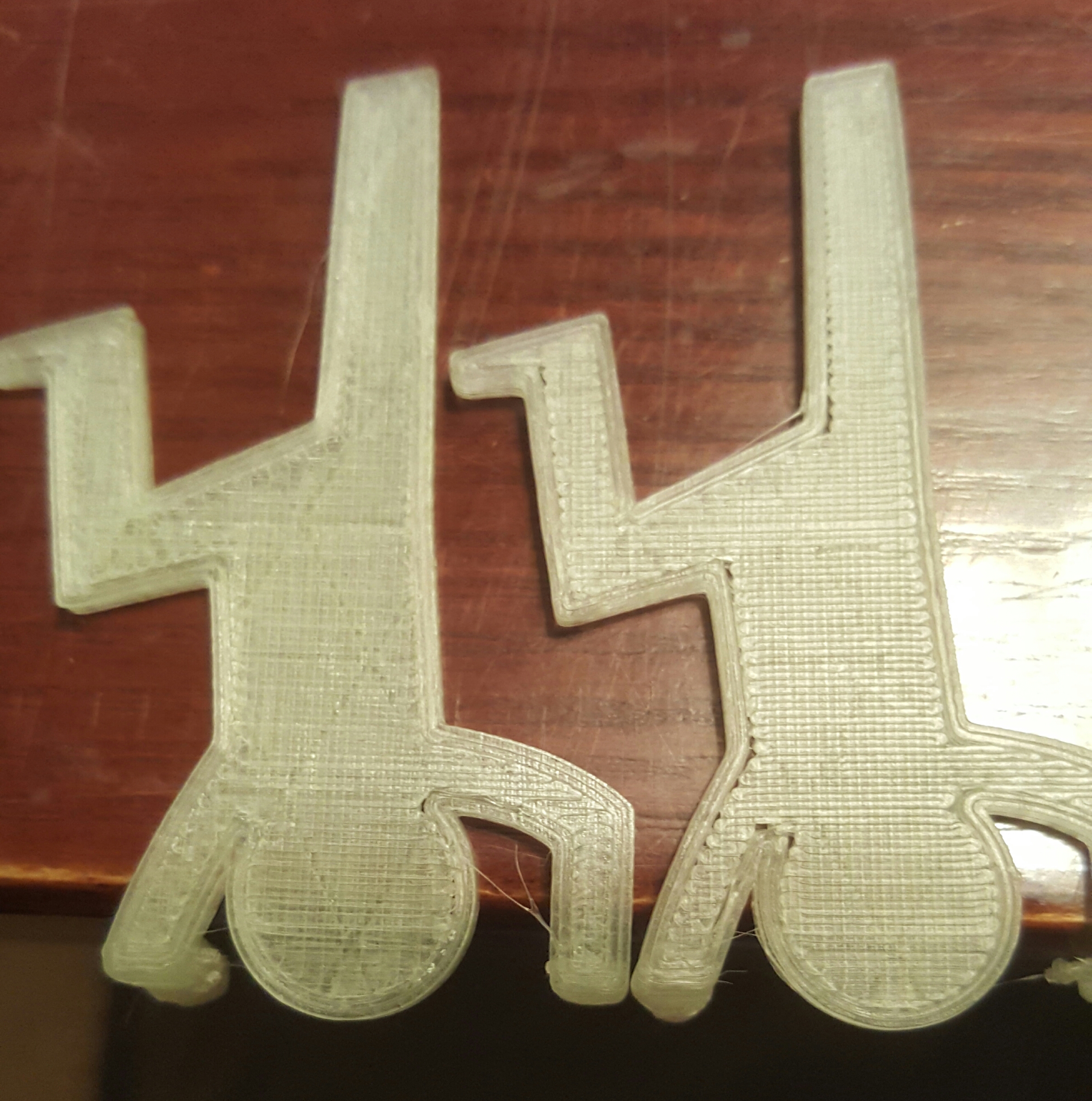

The first one shows the print before the temperature calibration on the right, and after on the left. The next picture is after the first one, but with a tower calibration in between. Since then, I have tried recalibrating, with no good results. I discovered my endstops were the tiniest bit loose, so I took care of that. Recalibration seemed like it would work because there was a noticable change. Alas, i get worse results akin to the second picture. This is ridiculously frustrating.
As a side note, I should mention how I do the calibration. I start at Z tower, do calibration until it's good on a 0.203 mm feeler gauge. Then I go around. After I do all three, I go back to Z and repeat until they all feel the same. Then I do bed center, make adjustments if necessary, and repeat. Is this correct?

I would chalk this up as potentially being a slicer setting issue. Do you mind posting your Gcode and possibly the STL?

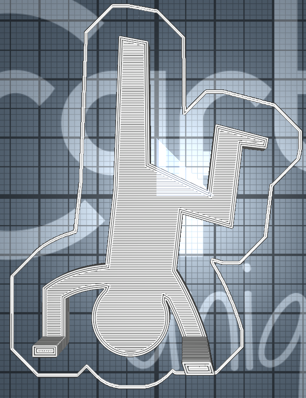

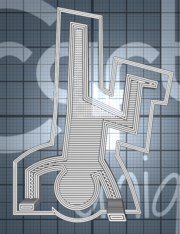

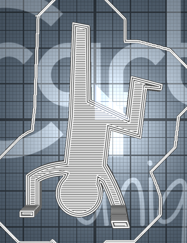

Ok, so here is what I mean by slicer settings...
The first below is your gcode file, unmodified, loaded into CraftWare for viewing.
The second is my file, but also take note that I am printing with a Prometheus V2 using a .3mm nozzle.
The third is a representation of printing with a stock .5mm nozzle using my CraftWare settings.

The main thing that I notice is that your gaps seem to coincide with the small little gaps shown in the screenshot. You can click it to see the fullsize image. Any area that seems to show bed through it, will show bed on a real printer, simple as that.
Try printing the attached Gcode on your printer. I tend to run pretty conservative settings within the printer community, but CraftWare estimates your print to complete within 20 minutes.
The attached Gcode are set to print the first layer at a height of .2mm, at a speed of 10 mm/s and then 30 mm/s for the second layer and on, with a resolution of .2mm. Both are set to print at 230 because I usually only bump my prometheus to 240 to print with ABS. 230 to 210 is what I print PLA. If you don't like the temps, preheat your printer to whatever preferred temps you have found, and start the gcode from either the sdcard or your preferred printer host. Once the printer or host has engaged the Gcode and sets my preset temps, just go ahead and set them back to your preferred temps that you just preheated to. The print will continue at your temps and you will be able to try different temps to your satisfaction.
