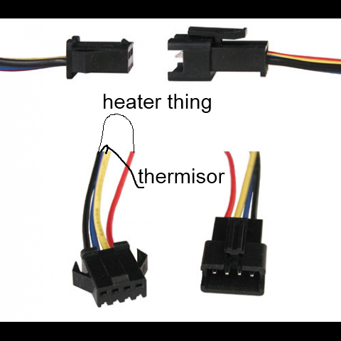

I had the e3d volcano on my orion but it is way too imprecise for my needs currently - I thought I could get away with just switching out the nozzle for one that was a smaller size but that isn't going to work either. So now I am back to where I started with a fully functional Orion with its effector head and nozzle scattered about - I really need to add quick connects to it and I got some from here: http://www.allelectronics.com/make-a-st ... ads/1.html
However, the colors on the connector leads are: Black, Green, Yellow and Red
the colors on the on the hot end wires are: Green (white?), Red, Black and White
I doubt it would be wise to simply connect the black to black and the red to red, should I just go like this?
BLACK - GREEN
Green . Red
Yellow - Black
Red - White ?
Keep in mind I have limited soldering ability but I can get the job done if need be, I'd just like to have some input from some of the more knowledgeable people around here before diving into this. I also have JST connectors for the fans as well. I am thinking of just using JST connectors for everything here, would that be easier or harder?
EDIT: If someone could make a dummies guide for me I would really, appreciate it. I am looking at the guide on page 269 here http://download.seemecnc.com/rostockmax ... -Guide.pdf
but I am still unsure of myself.
Re: HUGE FAIL - had to disconnect nozzle
Posted: Mon Mar 23, 2015 7:33 pm
by KAS
The v2 uses Red/Black for the hotend heating resistor and Green/White for the thermistor per manual.
I would expect the Orion to be the same, although I'm not sure.
When you removed the original did you leave a little extra wire to work with?
maybe something like this:
Hotend:black ->connector:black->main wire harness:black
Hotend:red ->connector:red->main wire harness:red
thermistor:green ->connector:blue->main wire harness:green ( the picture on that link looked blue?)
thermistor:white ->connector:yellow->main wire harness:white
EC3 would be fine and probably better for the hotend power, just make sure you don't mix up the connectors.
Posted: Mon Mar 23, 2015 7:49 pm
by TFMike
Here is a picture to better help anyone (and I guess me as well) to understand what I'm working with:
[img]https://i.imgur.com/NgRXPuw.jpg[/img]
Here are the numbered elements:
1. Heating Cartridge BLACK
2. Heating Cartridge RED
3. Thermistor WHITE (used red coated wire to make up for a shortage)
4. Thermistor WHITE (used black coated wire to make up for a shortage)
Now when I look at the guide from the rostock manual, I get very confused and have no clue where to put these wires into the 4 pronged connectors, any help is appreciated. Thanks
Posted: Mon Mar 23, 2015 7:53 pm
by TFMike
KAS wrote:The v2 uses Red/Black for the hotend heating resistor and Green/White for the thermistor per manual.
Mine are white/white on my Orion, got it November 2013. I was terrified of this day coming ever since I bought it too :/
And no, there wasn't enough extra wire to work with so we used some extra black and white wiring, probably should have grabbed a different color eh? Thanks for the help, I am gonna try to connect all of this and get it working again, wish me luck. The fire extinguisher will be at my side of course....
EDIT: please feel free to laugh but I needed to do this to get my brain around it, me and wires dont get along that well, is this what you would do then KAS?
Posted: Mon Mar 23, 2015 8:01 pm
by KAS
well as long as you know what wires run to the thermistor, that's all that matters. Polarity doesn't matter in this case, for the heater cartridge or the thermistor. As long as you get those pairs of wires matching throughout your connection, you should be fine.
But, that 4 wire quick release connector you linked about might be to small for the heater cartridge. You should use the "EC3" or Deans connectors. I was wrong when I said JST, getting them mixed up but those are way to small.
Posted: Mon Mar 23, 2015 8:12 pm
by Polygonhell
22Ga sounds light to me, I used to run 18Ga. 22Ga is fine for the thermistor obviously.
Though looking at the chassis wiring rating it should be fine.
If it's too light, the wire itself will get hot, since it becomes a significant part of the resistance of the circuit.
Posted: Mon Mar 23, 2015 8:28 pm
by Nylocke
Mhackney told me about those ones. He said he uses them all the time. 18 should be adequate for the heater, the wires for the cartridges use it. I'm going to be buying some of those to do a quick swap Kraken/Volcano thing.
Posted: Mon Mar 23, 2015 8:40 pm
by TFMike
Nylocke wrote:Mhackney told me about those ones. He said he uses them all the time. 18 should be adequate for the heater, the wires for the cartridges use it. I'm going to be buying some of those to do a quick swap Kraken/Volcano thing.
18 or 22? Do I need to pull these crimps out and put new crimps onto 18g wire or am I ok with the 22?
Posted: Mon Mar 23, 2015 8:44 pm
by Nylocke
I would go with 18. You're putting around 3 amps peak current through the 22 if you do run it, not a super huge amount but I wouldn't trust it personally.
