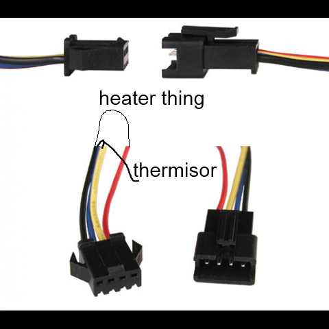

TFMike
Posts: 306
Re: HUGE FAIL - had to disconnect nozzle
Post by TFMike »
Here is a picture to better help anyone (and I guess me as well) to understand what I'm working with:
[img]https://i.imgur.com/NgRXPuw.jpg[/img]
Here are the numbered elements:
1. Heating Cartridge BLACK
2. Heating Cartridge RED
3. Thermistor WHITE (used red coated wire to make up for a shortage)
4. Thermistor WHITE (used black coated wire to make up for a shortage)
Now when I look at the guide from the rostock manual, I get very confused and have no clue where to put these wires into the 4 pronged connectors, any help is appreciated. Thanks

KAS
Posts: 1157
Post by KAS »
well as long as you know what wires run to the thermistor, that's all that matters. Polarity doesn't matter in this case, for the heater cartridge or the thermistor. As long as you get those pairs of wires matching throughout your connection, you should be fine.
But, that 4 wire quick release connector you linked about might be to small for the heater cartridge. You should use the "EC3" or Deans connectors. I was wrong when I said JST, getting them mixed up but those are way to small.

Posts: 2417
Location: Redmond WA
Post by Polygonhell »
22Ga sounds light to me, I used to run 18Ga. 22Ga is fine for the thermistor obviously.
Though looking at the chassis wiring rating it should be fine.
If it's too light, the wire itself will get hot, since it becomes a significant part of the resistance of the circuit.

Nylocke
Posts: 1418
Location: Iowa
Post by Nylocke »
I would go with 18. You're putting around 3 amps peak current through the 22 if you do run it, not a super huge amount but I wouldn't trust it personally.
