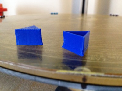

Here you go. Sliced in Cura both ways.
Re: Vertical Banding Revisited
Posted: Sun Feb 08, 2015 7:52 pm
by KAS
bottom shows vertical bands in large print, next shows minor bands printed with same settings in matterslice, next shows about the same with spiral vase with no fill, top is the gcode from Jimustanguitar (standard Cura)
Cura showed more vertical banding but the print in person is much better. I'm going to match the layers in matterslice and try it again.

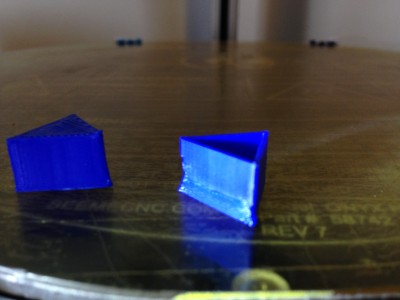

I didn't realize how small this stupid thing was. I was expecting it to be a good 5-10cm per side.
I used your exact g-code. I had to turn off the fan and bump up the temps, but it worked out fine. My results are more of "what good cooling fans can do for a small and fast ABS print"
When I said "I don't get much banding" I was only thinking of the non square parts I had printed. I don't print much square stuff (or things with large flat faces). Looking back on the few things that I have, I realize I actually do. Prime example of this I don't think is a good example, because its suffering from a few other issues (mainly over extrusion) so I think the banding is more pronounced.
The goal was to print on multiple machines to see what effects different hardware has on the same g-code. Since I have 32x drivers and TL arms I was expecting my banding to be less pronounced that someone else's without. Would be interesting to see someone with a smoothie.
The main question I have is how accurate your pictures are to the actual scale of the issue, Jim. Is that just the camera, or does that print you did 4 posts ago really look that banded?
KAS showed the same object sliced in different slicers. I'm wondering if the differences were due to each slicer calculating the paths/speeds slightly differently (assuming you used the same speed settings for each) or if some of them segmented each line into smaller segments for whatever reason? That would have to be checked in a g-code viewer.
After all that, heres my results. Its hard to get enough light to see everything properly.
Really blurry, but the flashlight I shined on it helped show the banding a bit better
Again not the best of pictures. It does show the benefits of ABS cooling on the left part though. Sped up to 300% speed (Cura slowed it down) and so I turned on the layer fan to 50%
(I didn't enable the layer fan until it got around 3mm up so it started mushrooming)
Posted: Mon Feb 09, 2015 3:47 pm
by KAS
I printed your gcode 50% slower and the bands are there but I'm telling you it looks better than mine. They are small uniform, almost reminds me of those 3d cards that you have to move back and forth to see the effect. I cant feel if with my fingernail.
