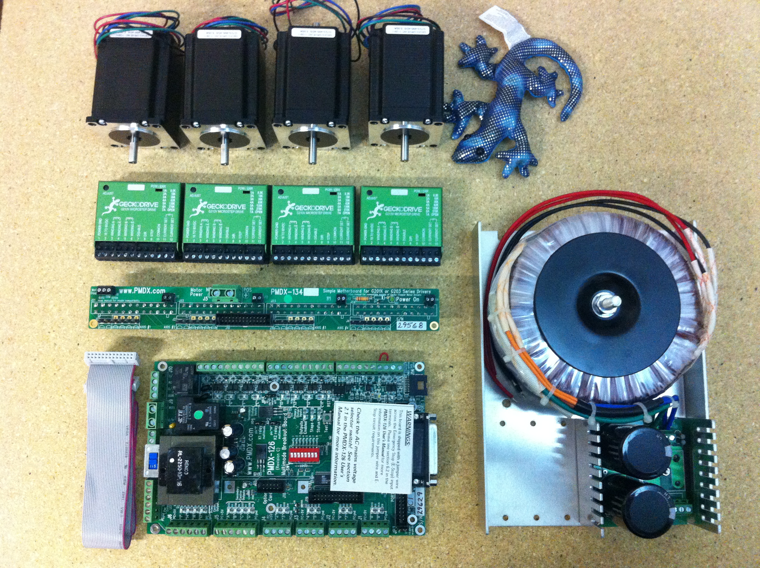

Just a wild shot in the dark, but what about moving to a larger stepper like a nema23?
Now, I'll be honest in my hopes you say " hell ya" because I have 4 of those and geckodrive controllers collecting dust...

Moving to a nema23 wouldn't really help unless you use a larger driver.

Polygonhell wrote:Moving to a nema23 wouldn't really help unless you use a larger driver.
/waveshand someone design something for this... /thread back on topic, sorry :)
all joking aside, I was using this to build a CNC machine but lost interest and picked up other hobbies. I might go ahead and finish it someday.
The parts you have will work fine on a 3d printer. The voltages and current for the drivers will be completely different so you would have to use a dedicated circuit for the motors.
You would also have to figure out how to mount the larger motors. You may want to sell all the parts pictured on ebay then pick up the normal 3D components.
