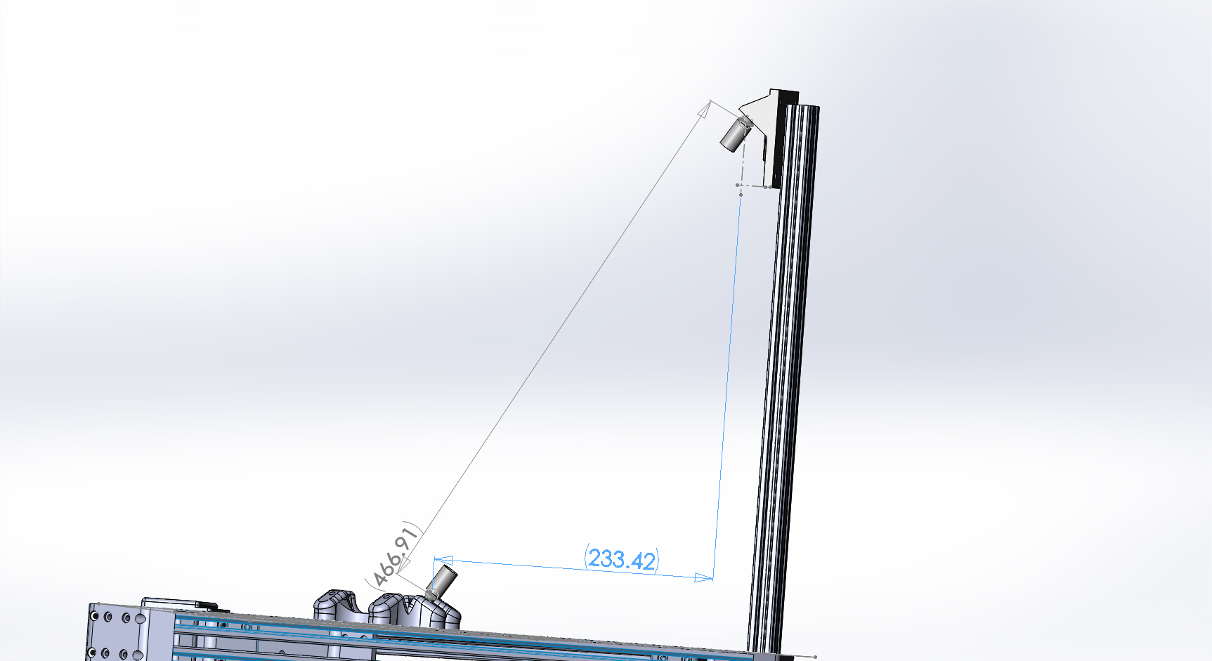

bubbasnow
Posts: 1061
Location: Dayton, WA
Re: man sized
Post by bubbasnow »
important dimensions
[img]https://lh6.googleusercontent.com/-Ji_7 ... 223944.jpg[/img]
all together
https://plus.google.com/112937153117031 ... SpSdjZpi6Q
movement with linuxCNC and BBB w/BEBOPR++

Re: man sized
Post by Demolishun »
That looks awesome dude!
Please give us final dimensions on build area. I might want to duplicate this. Again, awesome work. It looks very beautiful.
