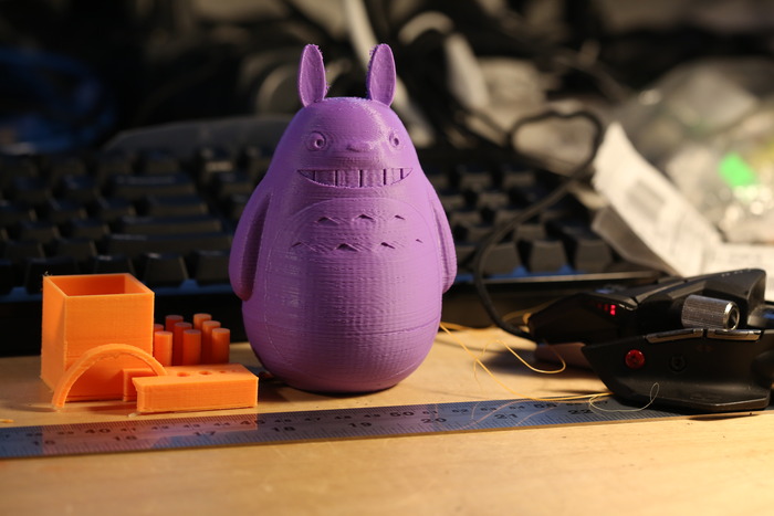

The banding seems about the same on my printer (see part on the right):
[img]http://ironcreek.net/photos/_s/1024/Hob ... G_6080.JPG[/img]
I thought that's just part of the process.
Could be extrusion pressure related patterns or rounding errors.
Never rally bothered me that much. Would be curious if there's a way to mitigate this though...

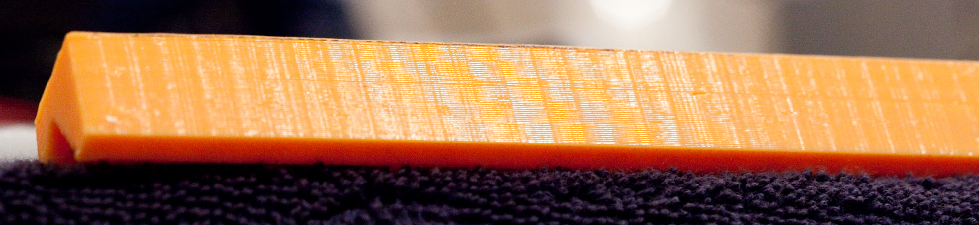

I have seen this banding even before I installed the magnetic arms. You can sort of see it in this post.
(Click the images to zoom in closer)...
This scrabble tile holder was also pre-magnetic arms, but the bands line up with the fill pattern, so I suspected that.
But it can't only be the fill pattern because I always see banding on the single wall test cube.
single wall
single wall
I can't remember ever seeing banding in a spot where the layers don't stack vertically.
no banding
no banding
It's so minor I never tried to fix it. But now I'm wondering what it is. Could it be little nudges in speed from the steppers motors? Or the belt not meshing perfectly with the teeth on the pulley?

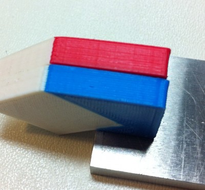

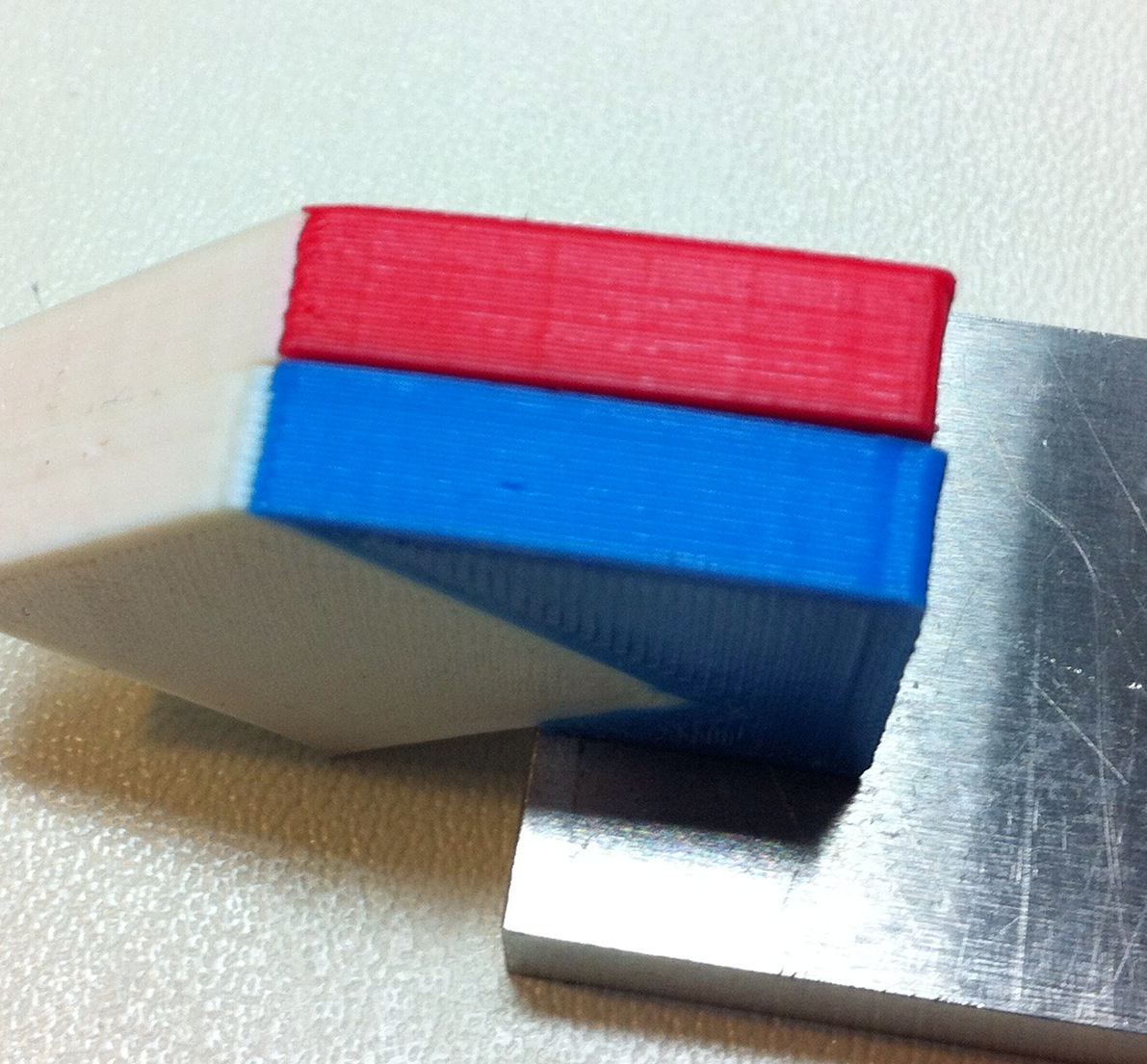

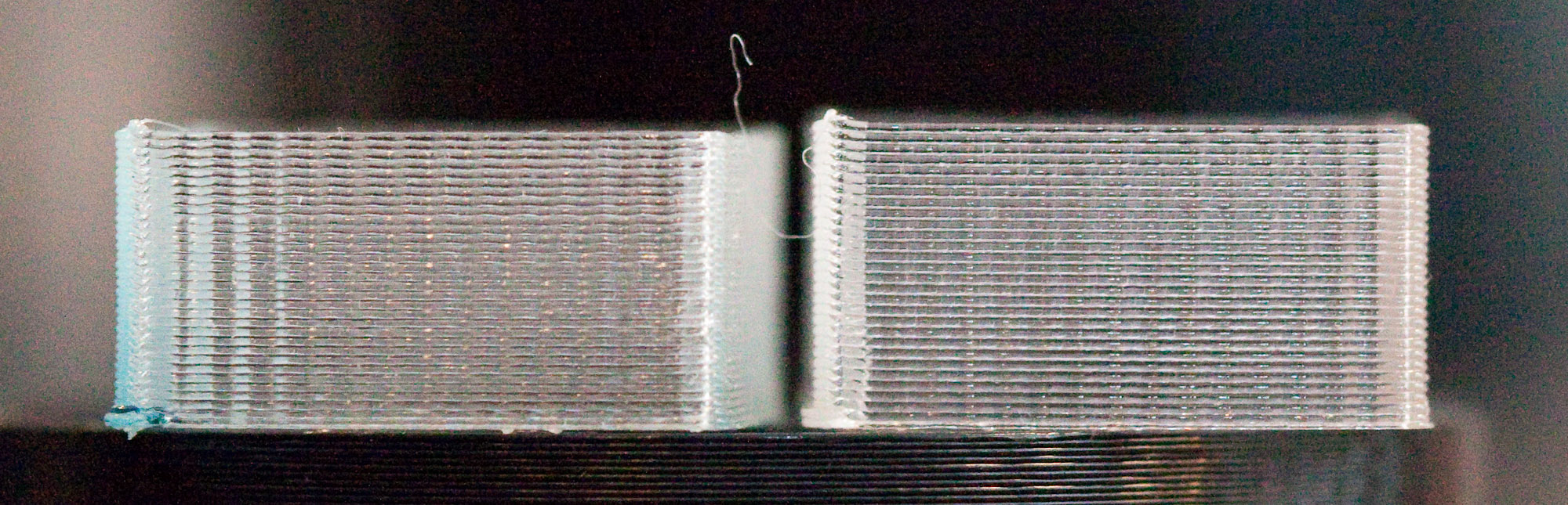

Ok, so I ran a test this morning. I changed the DELTA_SEGMENTS_PER_SECOND_PRINT from 200 to 100. It does seem like the lines are spaced further apart. I tried to mark the lines on each cube and photo them:
[img]http://mhackney.zenfolio.com/img/s10/v9 ... 7393-3.jpg[/img]
The original 200 segment/s cube has a clear 5 lines on the end, the 100 segment/s cube has 3-4 and they do appear to be further apart. I compared it to the others I printed last night. The ones last night were all very consistent in the spacing. I'll print a few more and maybe lower to 50 segments/s.

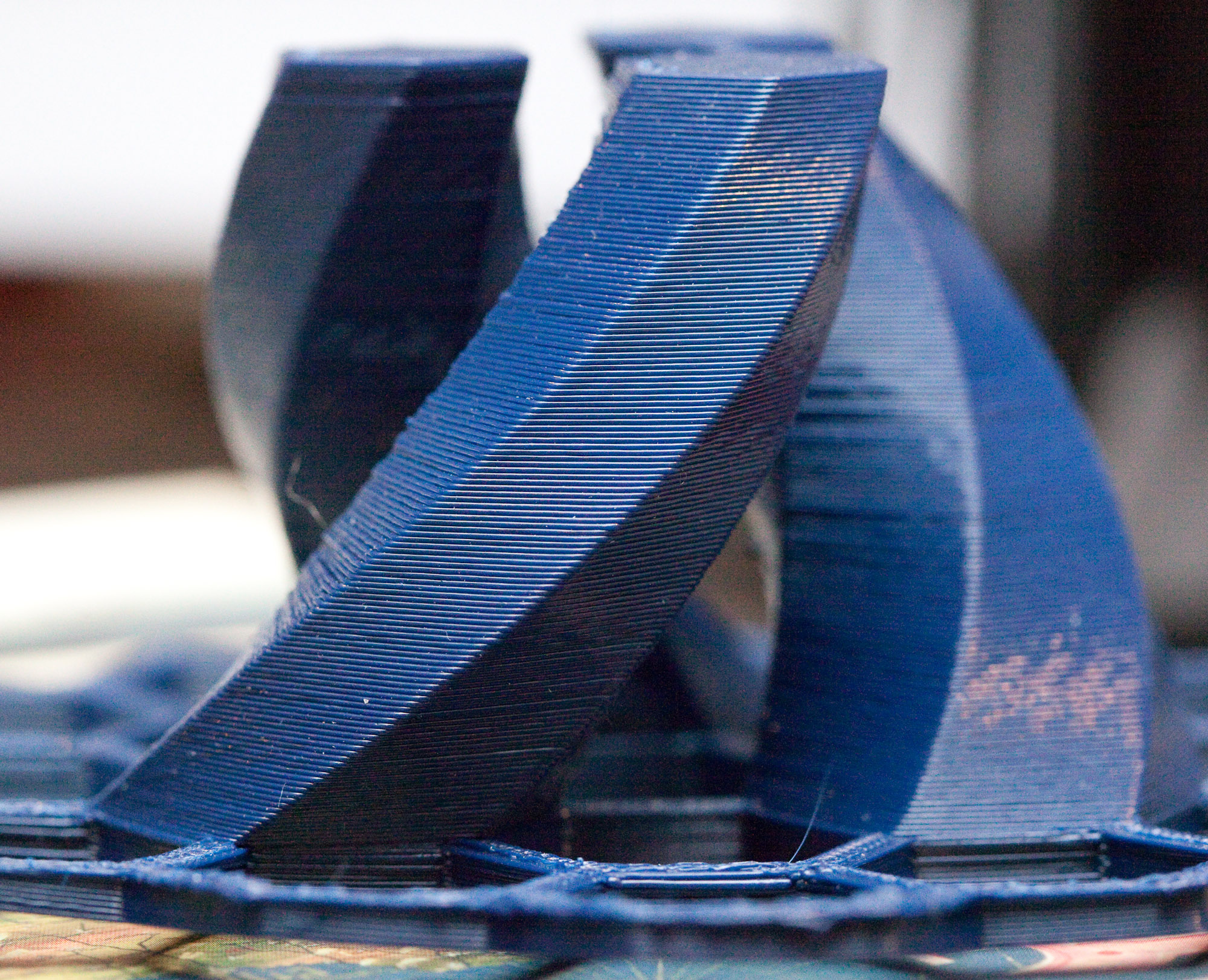

If you need a print that breaks up surface regularities maybe try the khosht snowflake vase single walled (spiral vase)?

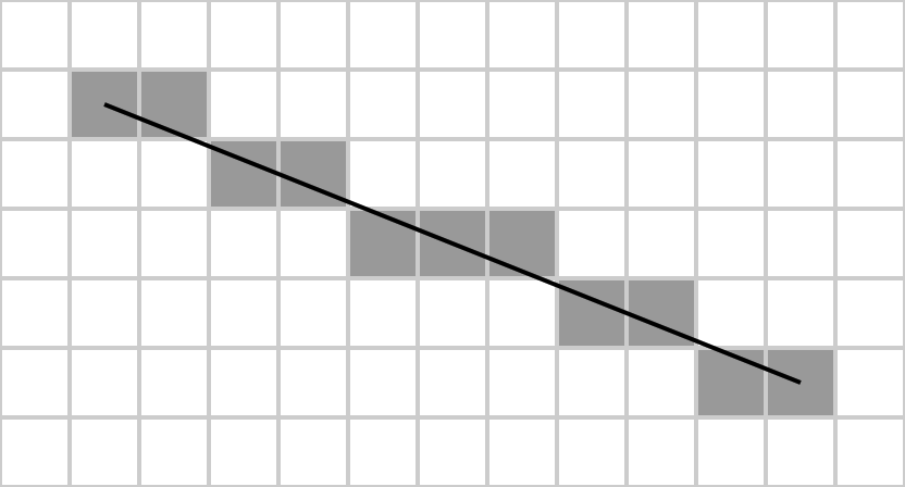

This problem is caused by the stepper motors. 626Pilot got it right with the image on his post. The only difference is that the blocks would have smoother edges.
#define PULLEY_DIAMETER 10
#define PULLEY_CIRCUMFERENCE (PULLEY_DIAMETER * 3.1415927)
#define STEPS_PER_ROTATION 200
#define MICRO_STEPS 16
#define AXIS_STEPS_PER_MM ((float)(MICRO_STEPS * STEPS_PER_ROTATION) / PULLEY_CIRCUMFERENCE)
That means that each full step on our machines is ~0.157mm. Micro-stepping is not linear, and it leaves a gap between each full step that the stepper motor has to 'jump' across. This jump is what results in the vertical banding you see on flat, face type surfaces. The jumps can happen at a resonant frequency with the platform inertia, which is why some of them seem much larger or smaller depending on the angle of the surface, the velocity of the print effector, the position between the towers, and the carriage mass and rigidity.
The magnitude of each wave across the surface is about 0.001 of an inch at 16x micro-stepping. Cartesian machines have a slight advantage when printing parts with geometries aligned along their X and Y axes, since the axis parallel to the surface doesn't step.
