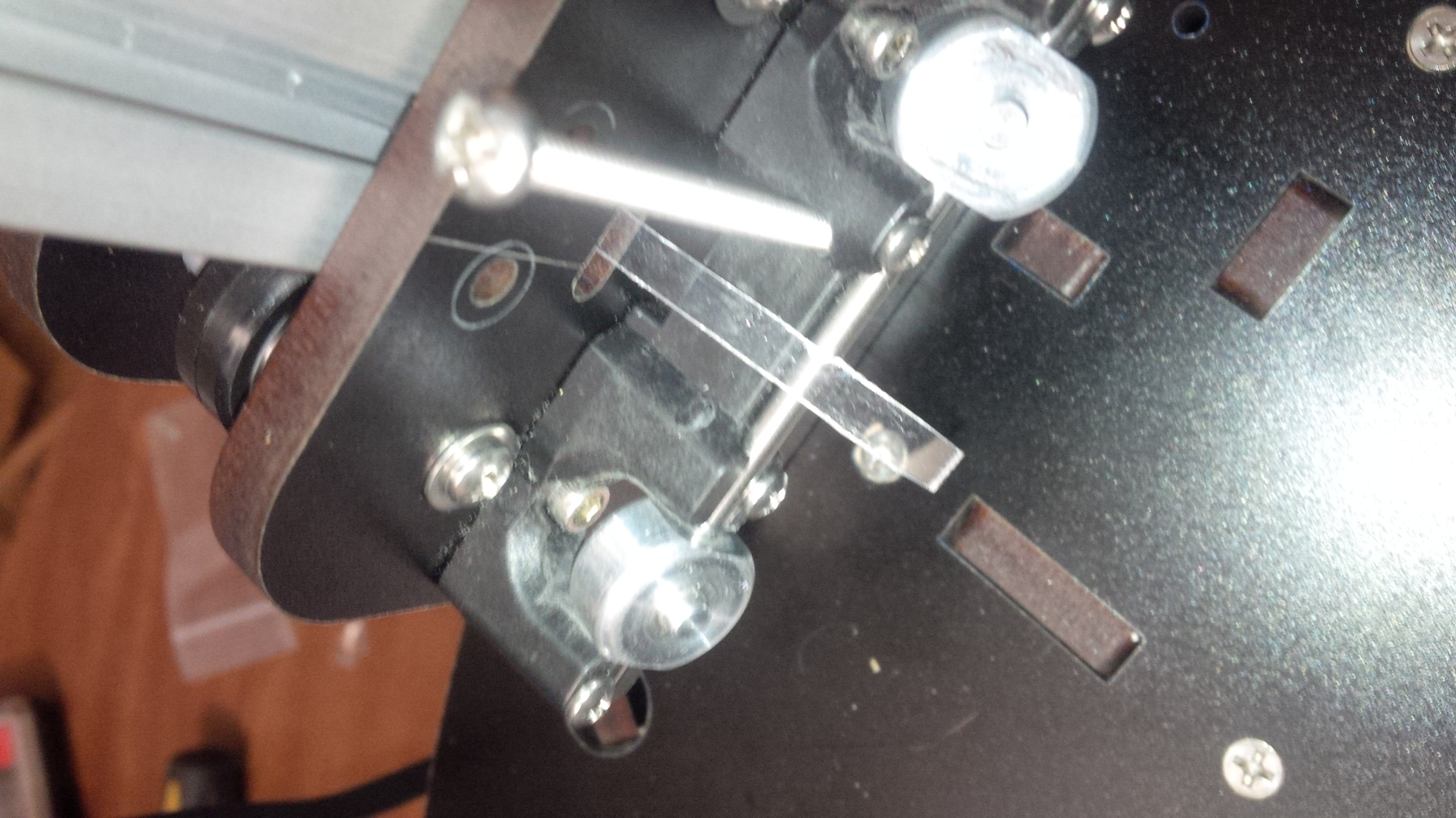

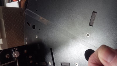

When I align my top plate and my bottom plate I can pretty much get them to match up exactly but one ends up being just a hair off, will I be alright, should I sand or file untill they are level? It seems to me that it would be ok but I want to make sure.

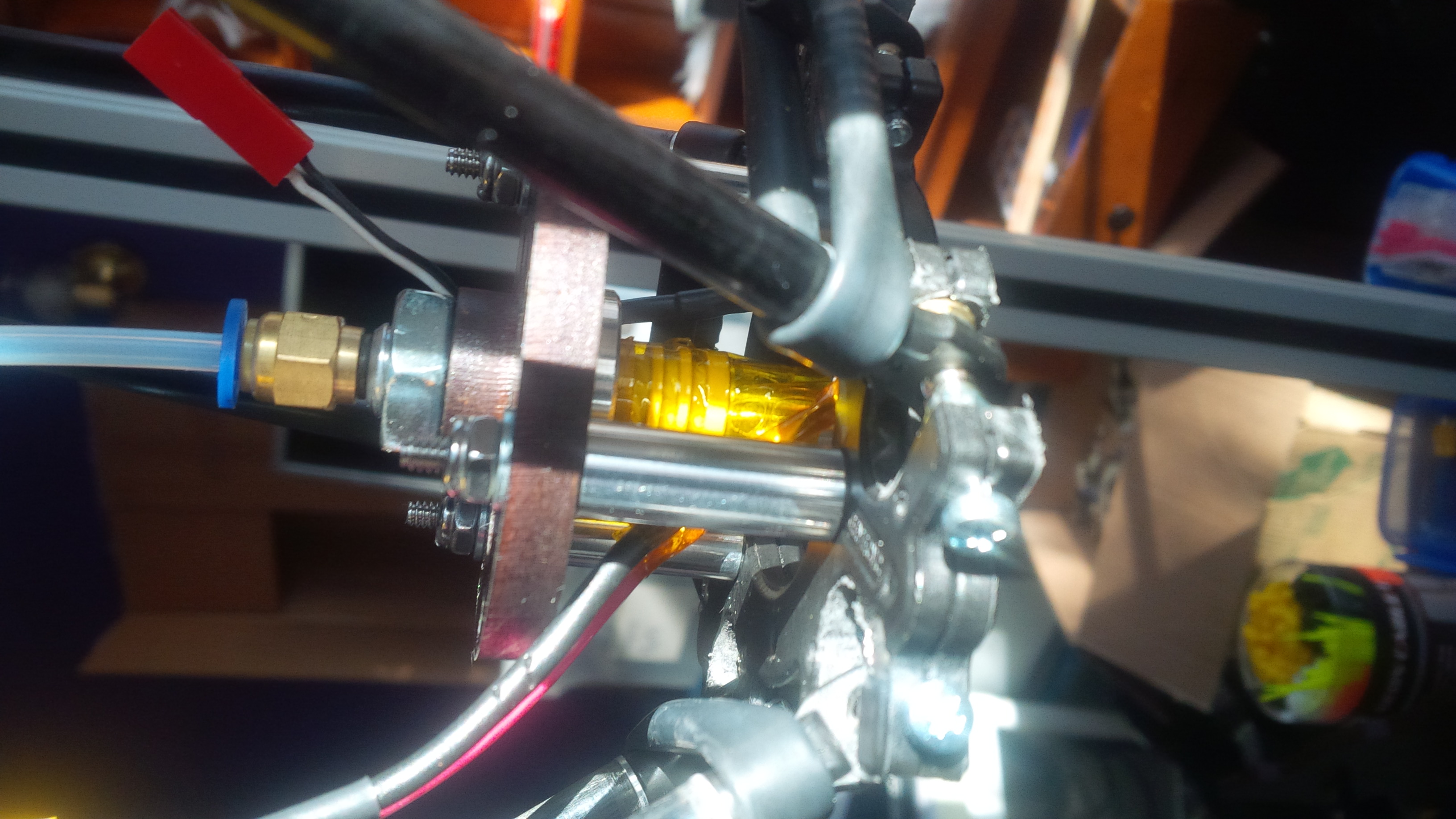

Got the XT 60 connector on the hot end, tomorrow ill install the thermistor with wires and the little red 2 prong connectors (can't remember what they were called). I have to go to the hardware store and grab a large square to erect the towers! I'm excited it is actually looking like something now! Tomorrow well today (its past midnight here) is my birthday and I was thinking of getting the Trick Laser carbon fiber arms or the ones on ebay that look like a long threaded rod from China, they have big kinda eye hook things on the ends. Are the ebay ones good or should I go all out and get the Trick Laser arms with my b day money?

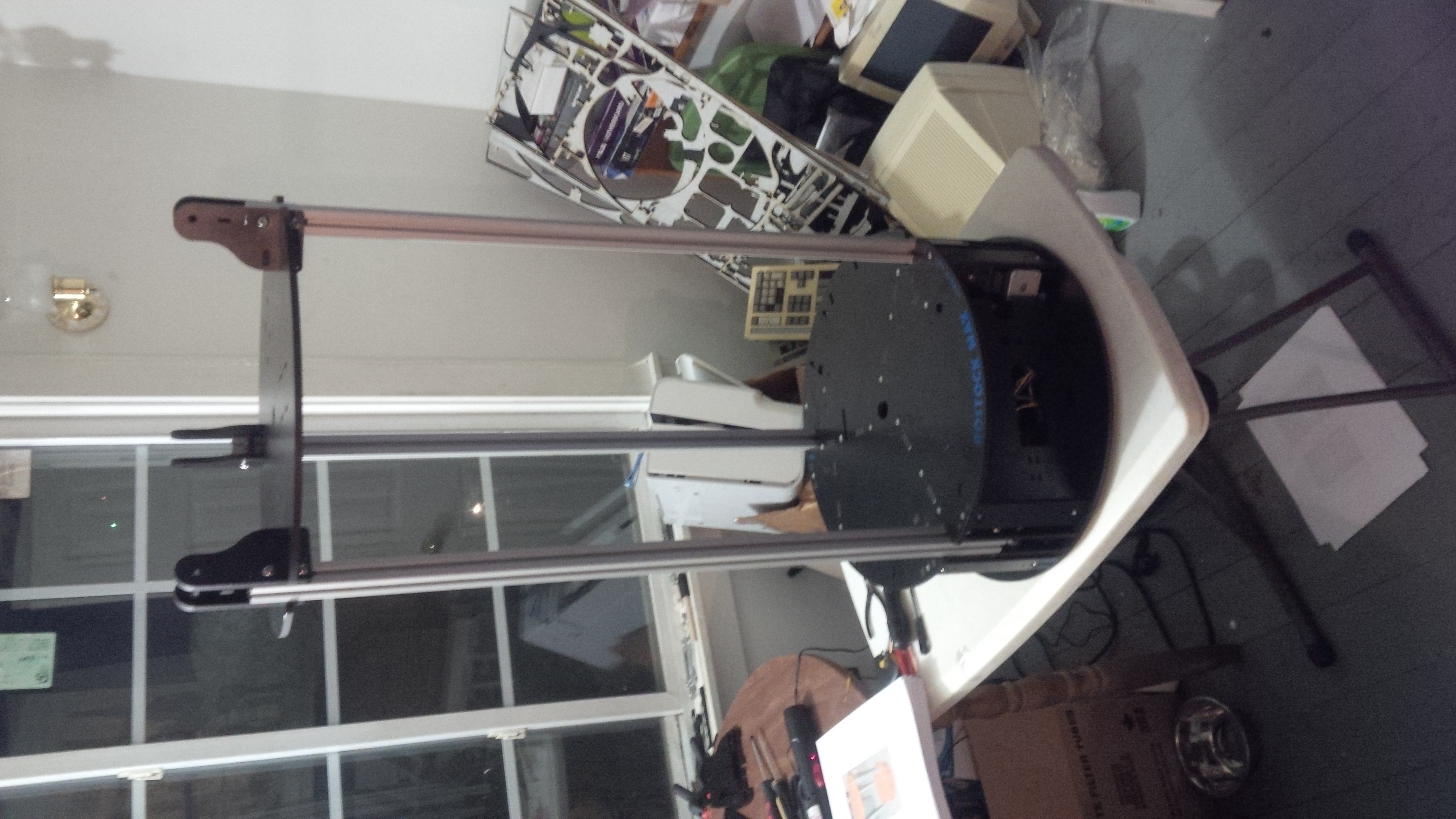

So I just bought the Trick Laser Carbon Fiber Tube Arms with Metal Ball Rod Ends! Hopefully I will get them fairly soon! Im excited about those, they will make my machine look so slick! Well I'm moving along with the build, I've got one of the extrusions up on the base.
Re: My first 3D Printer is a Rostock Max -- Build Log From M
Posted: Wed Nov 13, 2013 5:49 pm
by AndThenSome09
Just got th top on my Rostock!! Wow, it's starting to look like something now!! YEAH! I'm excited! :D

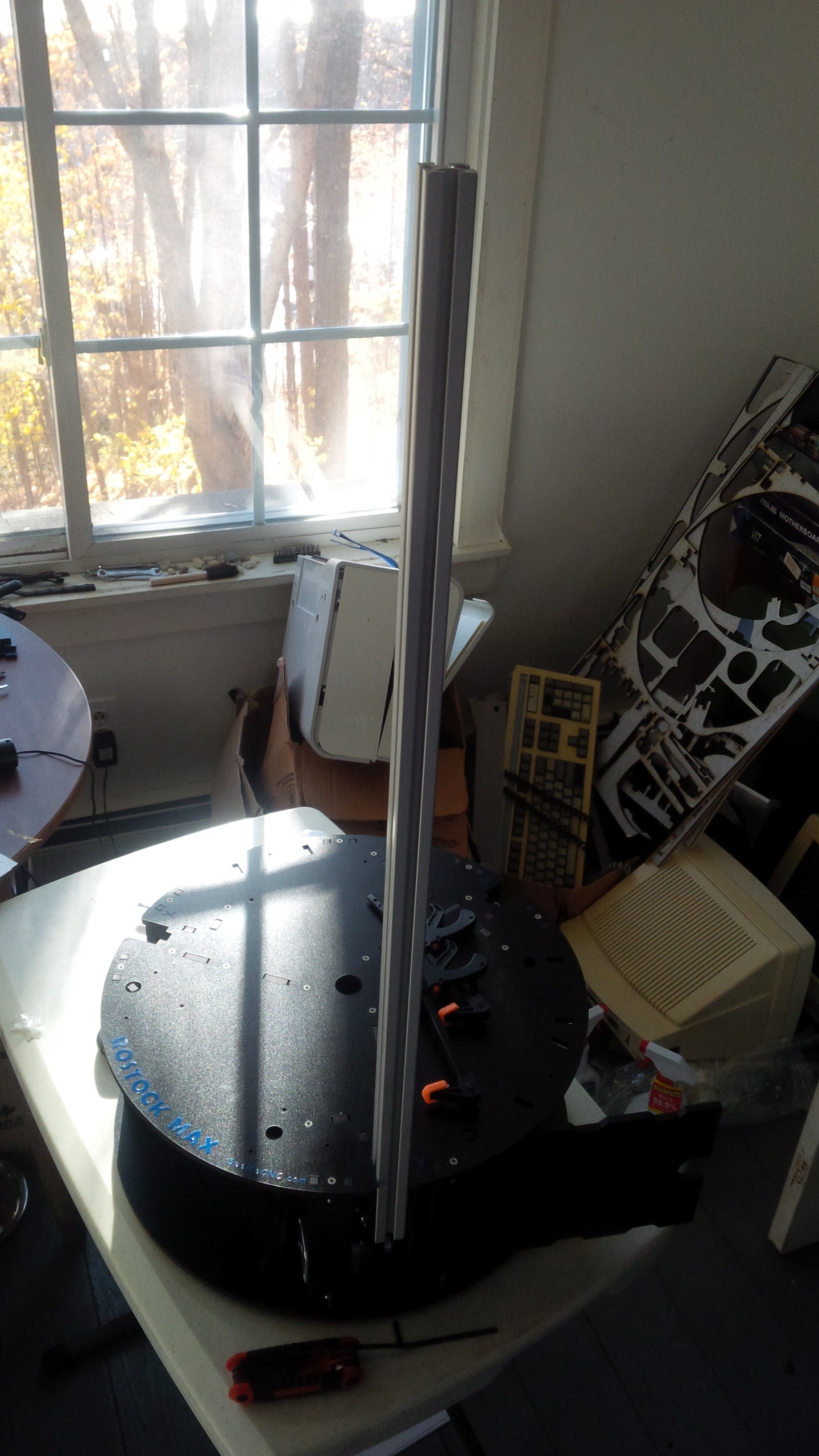

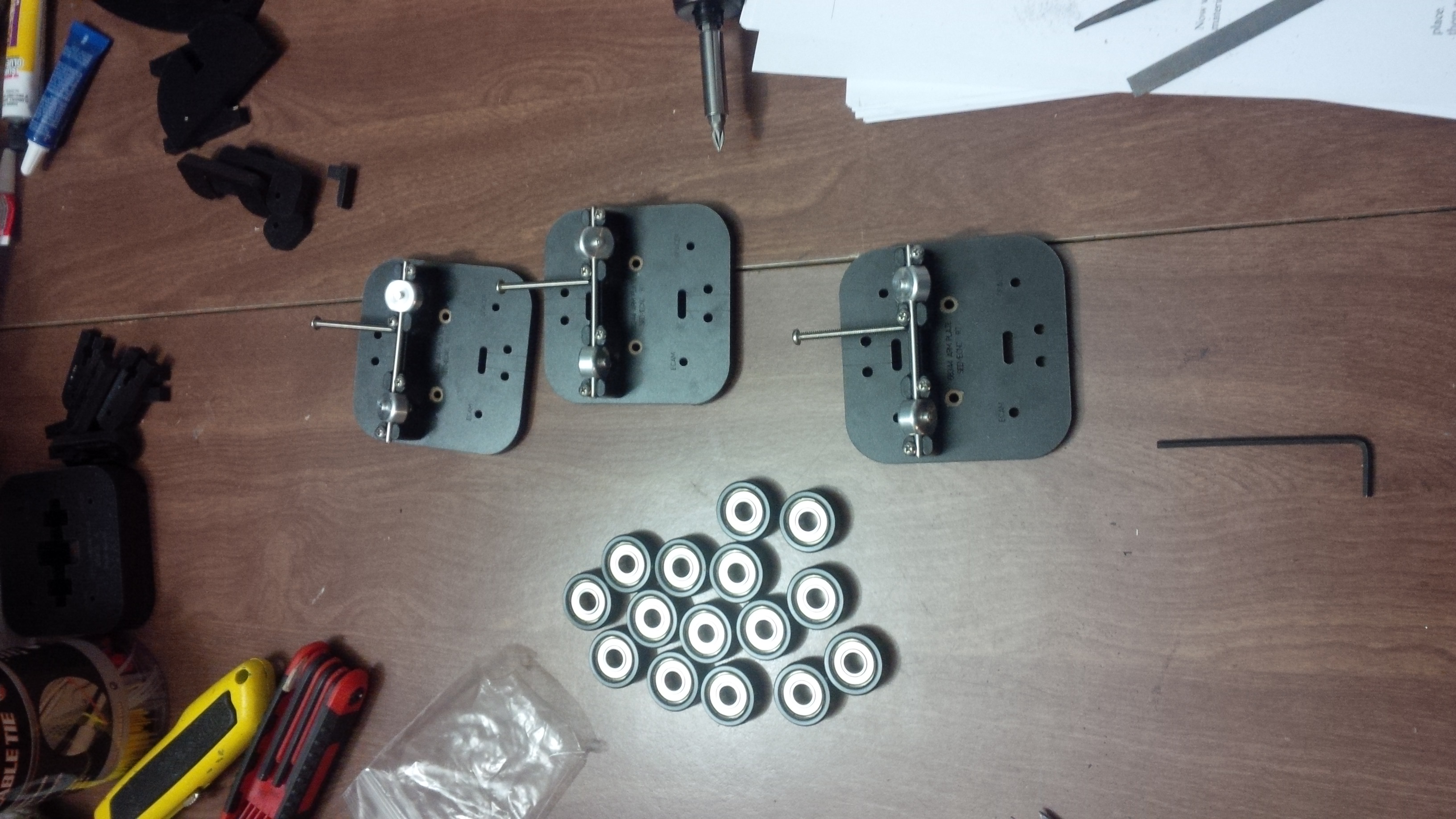

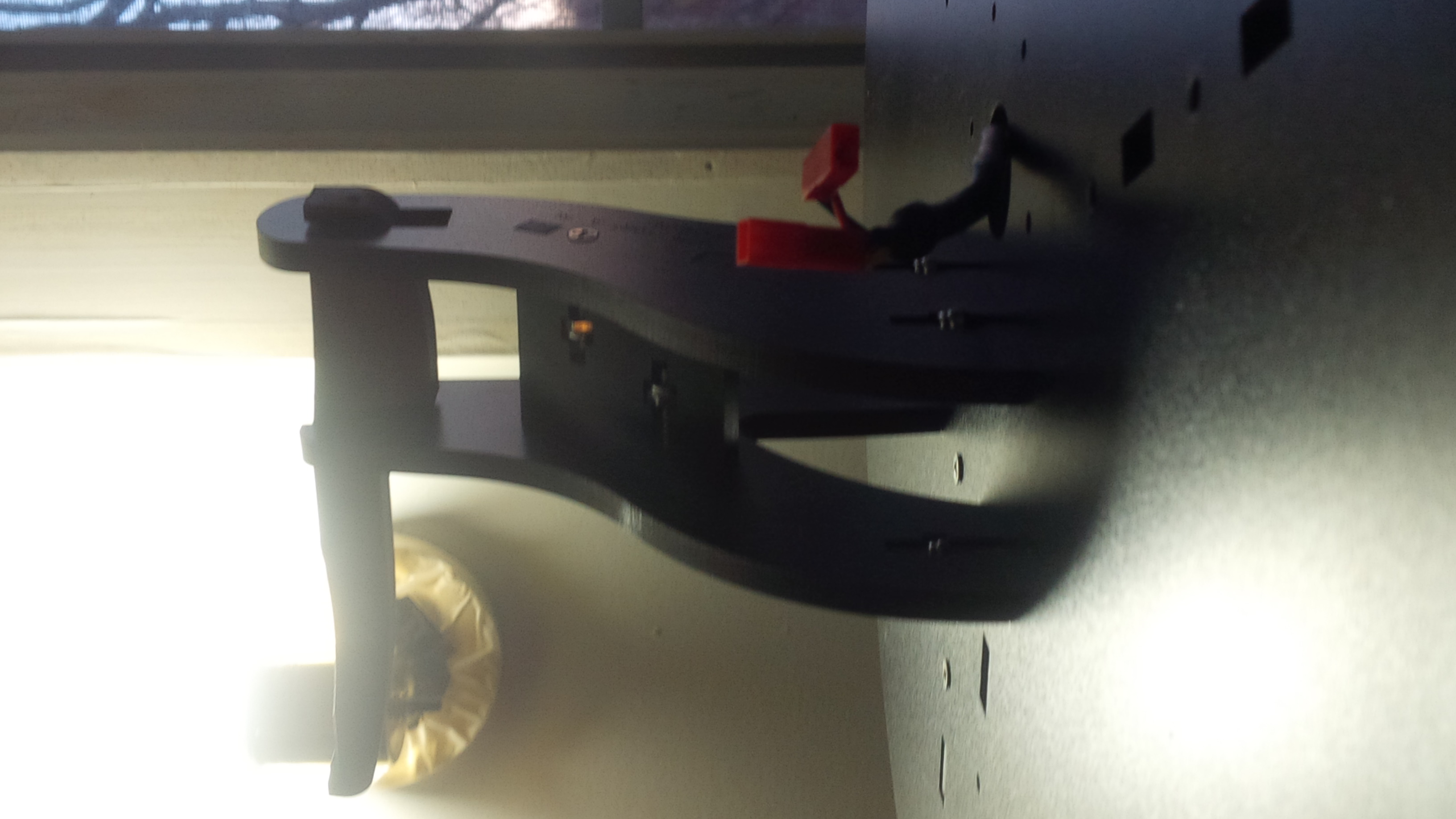

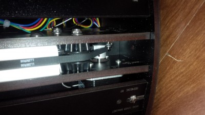

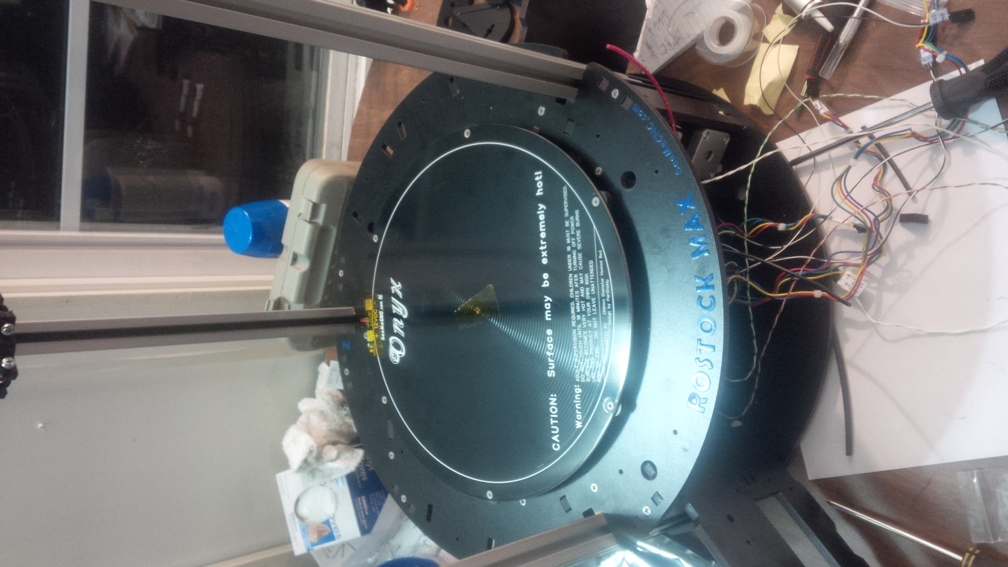

Posted: Sun Nov 17, 2013 6:40 pm
by AndThenSome09
Once I had the extrusions up and the top on I ensured both the top and table were square to the to extrusions, they were so I did that part correctly!
Next I started running the wires through the middle of the extrusions for the end stops, wasnt that fun! I ended up running a length of fishing line through the middle, tied a slip knot and tightened it around the ends of the end stop wires then proceeded to pull them through. Once I got all the wires through and routed to the electronics bay I took the end stops cut th middle pin off then plugged Em in and installed them in their location with the included hardware. Those little nuts were a pain in the @**!
Next it was time to file those u-joints. (I ordered the Trick Laser carbon fiber arms but they aren't here yet and I wanted to see how difficult it was) So filing those down wasn't necessarily hard but it was very tedious and time consuming! Once they were done screwed in and installed on the face of the cheapskates I ensured that they would pass the flick test it was now time to assemble the cheapskates!
The cheapskates went together pretty easily, no difficulties there, I adjusted the e-cams so they had the perfect grip on the extrusions. No play when I would try to move and twist them from side to side or up and down, only smooth motion going up and down the extrusions, no catching or anything, all 4 bearings rolling as it should.
Now it was time to route the timing belts! Routing them along their path was pretty easy, it was getting them through the little slot in the cheapskates and securing them with the included belt clips was the part I imagined to be very difficult! I decided to go with the little strip of plastic method in the manual since I wasn't able to get any forceps. Believe it or not all I had to do was route the plastic strip so it was running through the slot and along the middle of the extrusions and then just slide the belt along the plastic strip and the belt just followed that path and through the slot it went! So that ended up being simple as heck! at first I didn't pay close enough attention to the manual and wasn't judging the size of the slots in the belt clips and didn't place a washer on the screw, not noticing until I was on the second cheapskate I ended up having to go back and add the washers and re tighten the belt clips! Needless to say I felt pretty stupid at this point! But no matter, I continued until all the belts were in place and tension bearings were pulled tight.

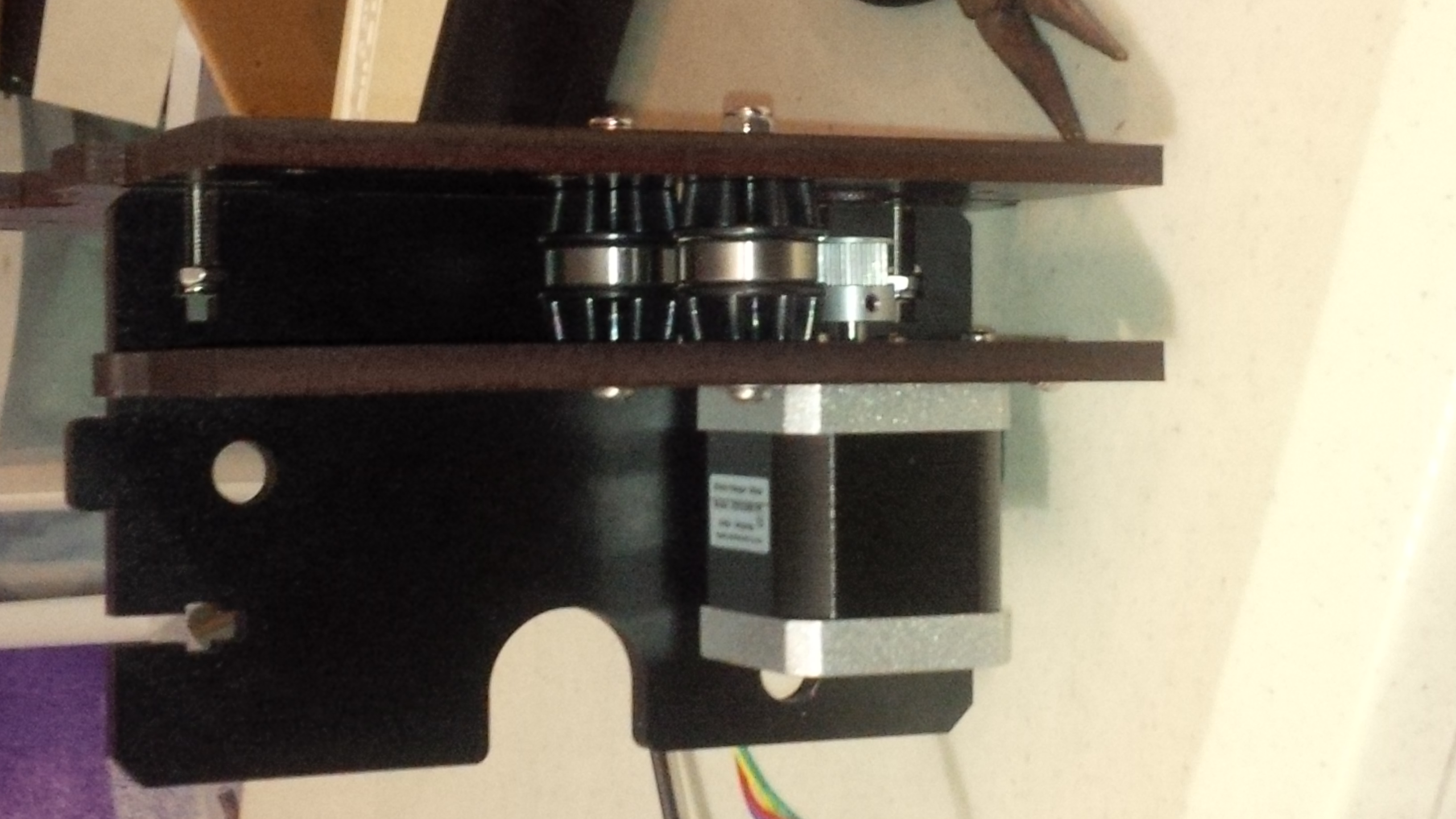

Posted: Mon Nov 18, 2013 7:08 pm
by AndThenSome09

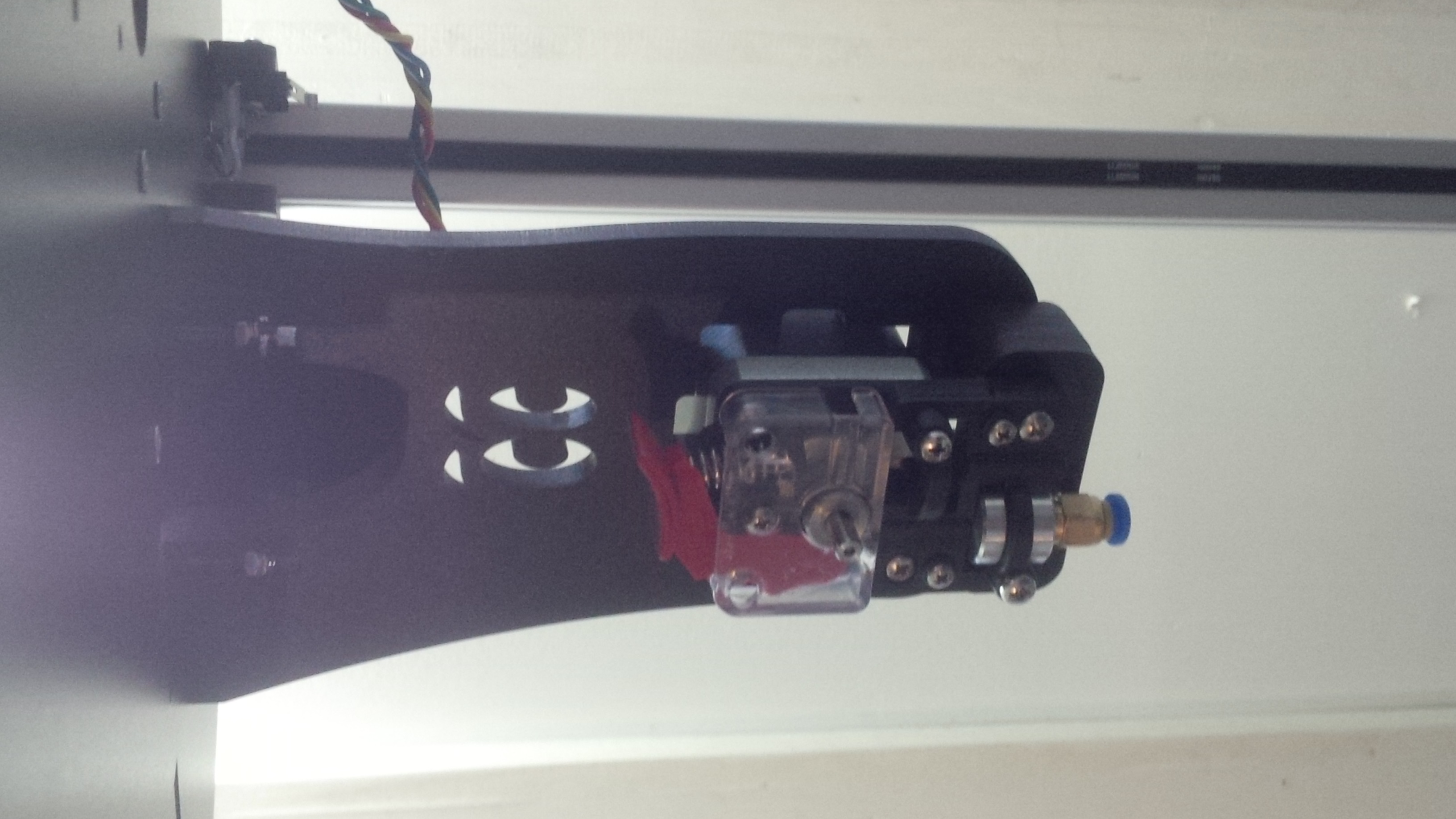

Got the extruder together, installed, and extension wire all done. Then the spool holder.

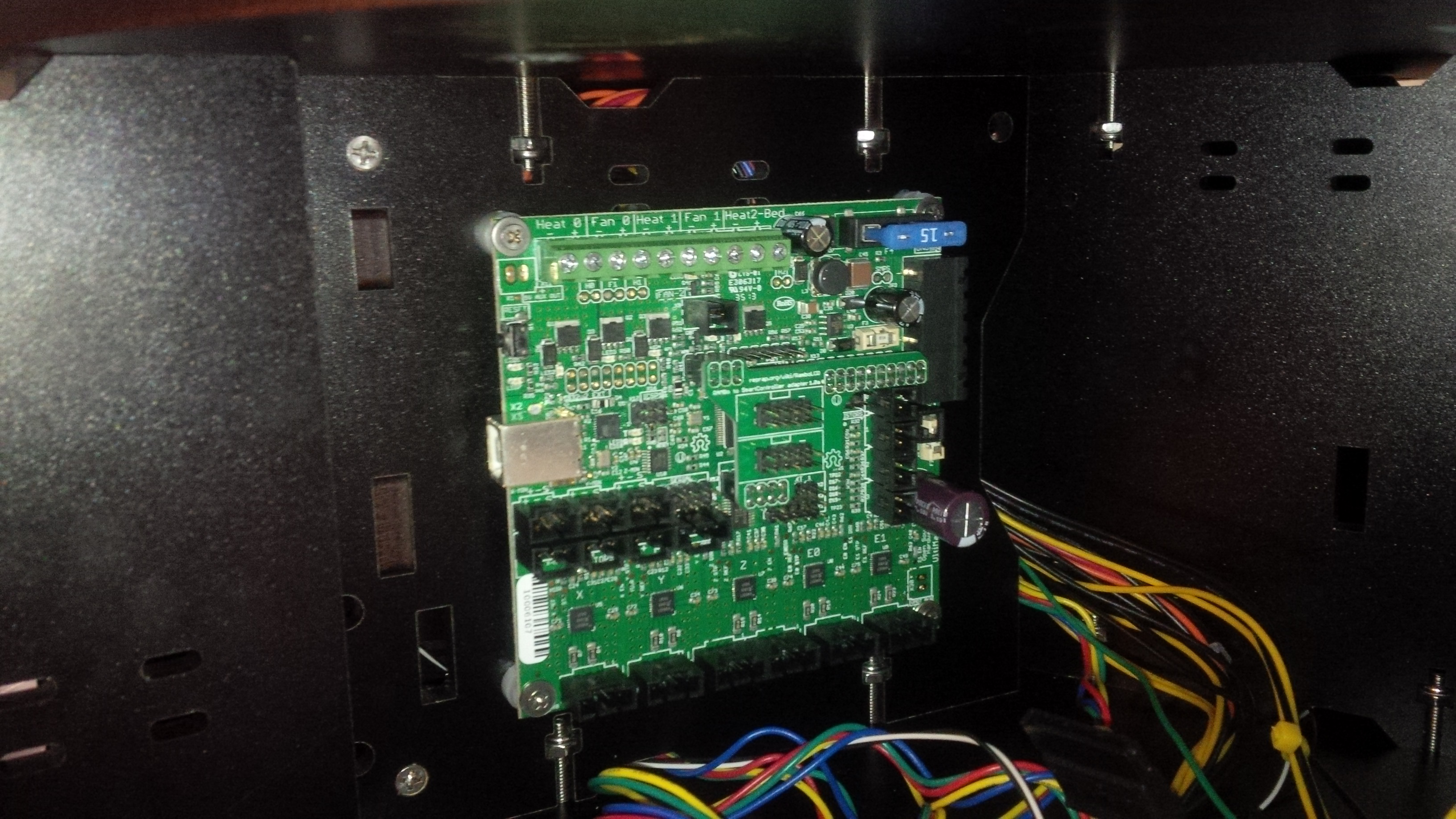

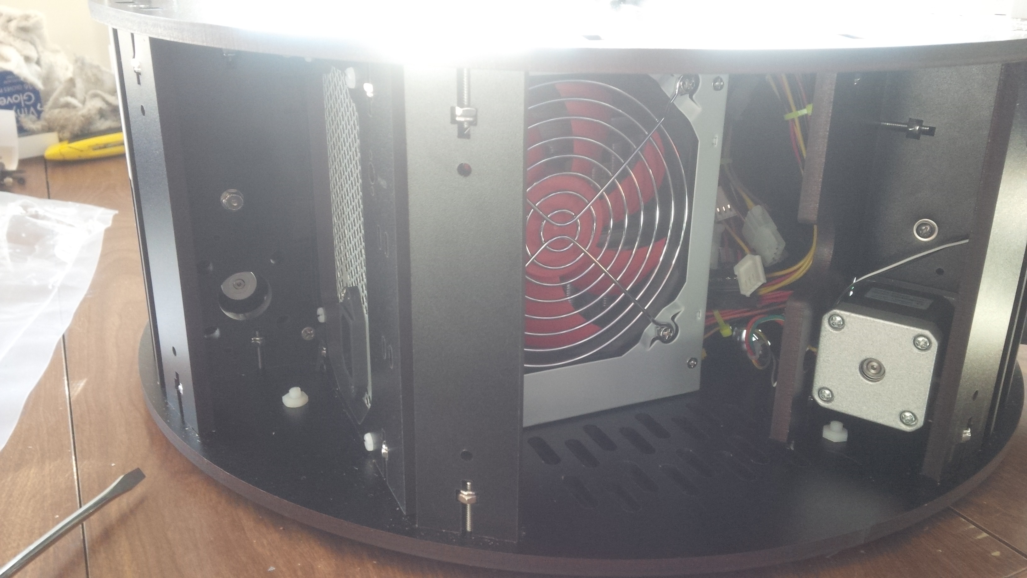

Then came the power supply, cut and grouped all my wires, extended the switch wires, mounted the PSU.
Got the Rambo power plug all setup.
Finally soldered up the LCD Rambo adapter and then installed the Rambo!

Last night I had put together the thermistor for the heated bed and placed in the center of the be bottom, left overnight to cure. One it had fully cured I soldered the thermistor leads to their respective pads and continued to also solder the thermistor wires to the Rambo, power leads, resistor, and LED to finally finish with the heated bed! Now it was time to install it onto the Rostock Max! I figured a little trick for myself when it came time to get everything lined up with the spacers and proceeded to use some super glue and stuck those spacers on the bottom side of the little snowflake in order to make lining things up a bit easier! As I lined up a hole I dropped a screw down thru and started the threads just enough so it would stay put but leaving plenty of room to line the rest up. I think it went wonderfully and I had no trouble with this part of my build. :D

Got the hot end all done and installed! Now all that's left is to finish with the wiring and install the LCD controller and ill be ready to start my calibration!!! I'm almost kinda sad that the build is about over, for me building the Rostock Max was half the fun! Sure I'm not alone there! :D

The fun is just beginning :D Don't forget to put strain relief(zip ties)on the hotend wiring or you will get an unpleasant surprise when the thermistor gets tugged out :o
Posted: Wed Nov 20, 2013 10:20 pm
by AndThenSome09
Yes, I am running all the wires for my hot end, thermistor, and peek fan along the bowden tube and they are zip tied every 5 or 6 inches or so, that way it looks clean following the same line and now I know it is providing strain relief as well. Learn something new every day! :D
