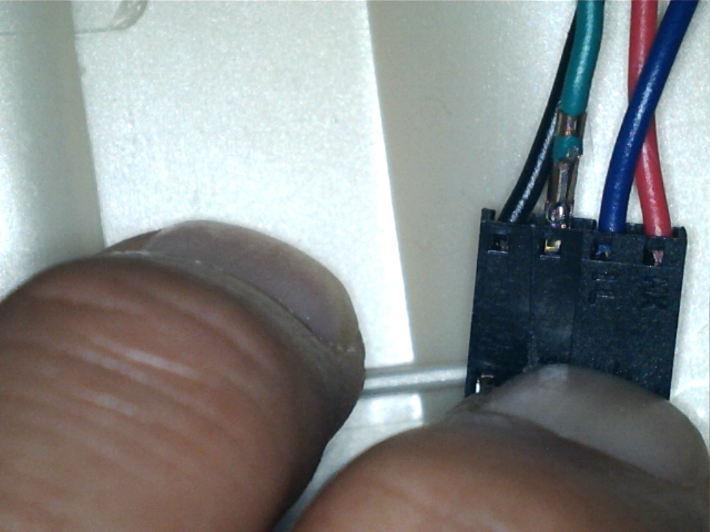

The stepper wiring is definitely in the right order. I get different results every time I open the electronics door, even if I don't change anything. So I think this might go back to the off/on switch having loose pins, or it could be the 4 pin connector sockets that are loose between the plugs and the rambo board. I'll try sticking tape on the bottom half to act like a shim; that should prevent them from wobbling so much.
Re: Default Rostock
Posted: Thu Jun 06, 2013 9:11 pm
by cambo3d
Generic Default wrote:The stepper wiring is definitely in the right order. I get different results every time I open the electronics door, even if I don't change anything. So I think this might go back to the off/on switch having loose pins, or it could be the 4 pin connector sockets that are loose between the plugs and the rambo board. I'll try sticking tape on the bottom half to act like a shim; that should prevent them from wobbling so much.
show me a pic of your connectors / crimps something isn't right here.

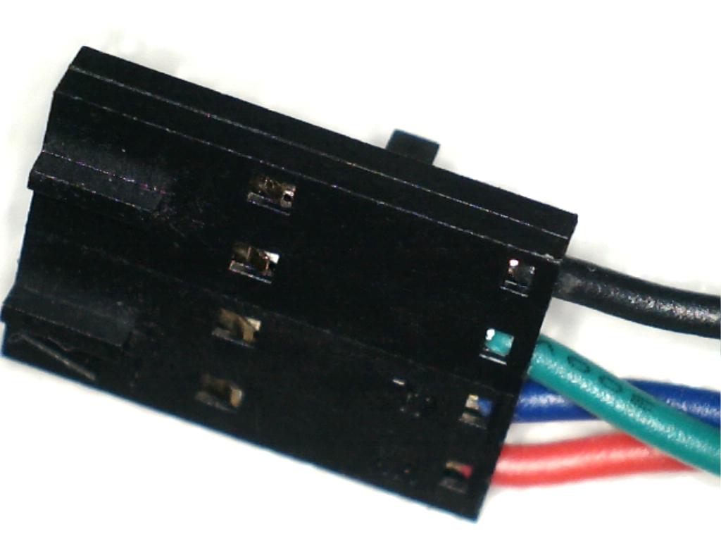

by Generic Default
Here are some pictures of the wiring.
Re: Default Rostock
Posted: Thu Jun 06, 2013 10:17 pm

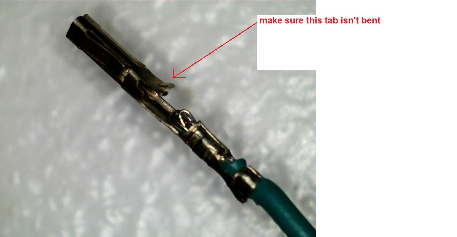

by cambo3d
from that second pic i can tell you thats your problem. your pins aren't crimped properly not allowing you to push them all the way in, doesn't even look like the locking tab is in the hole either.
you might want to get a new set of pins and recrimp them with a better tool. it should look like the photo i posted. I believe you may also be shorting some of those pins together, with them not being all the way in, they could come out and short (causing other problems)
also if your using blue tape to splice your wiring, its just a matter of time till something comes apart.
do it right the first time (or in your case the next time) and you might not have some of these issues.
pins are all the way in, locking tab protruding into locking hole

Here's a thread with photos on how to crimp with needle nose pliers, or better, you can get a crimper
http://forum.seemecnc.com/viewtopic.php ... mps#p12194
I didn't trust my crimping capabilities with pliers so I also soldered the connections a little after crimping, making sure it wasn't so much solder that the crimp wouldn't fit into the connector

Thanks for helping me through this guys. I just spent the last 3 hours un-crimping, crimp-fixing, and re-crimping every single bad crimp I made. So now they're correctly done and all four motors are spinning smoothly and quietly.
I also just extruded my first 10mm of nylon! Which is a big relief after 6 days of building and fixing.
