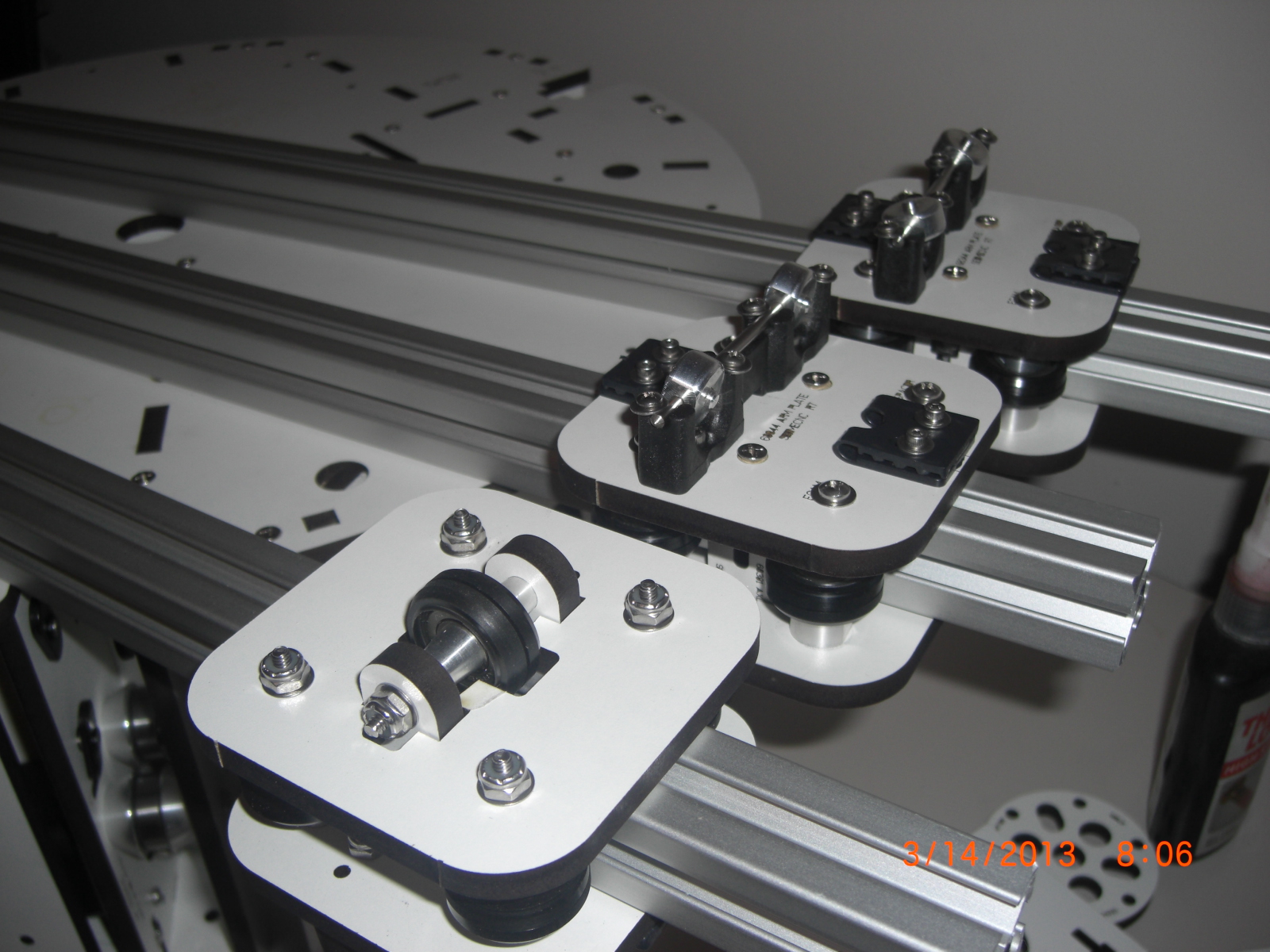

After a full day of fishing I came back and continued working on the rostock.
I caught two of these both over 20lbs which put up a mean fight for a good 20-30minutes.

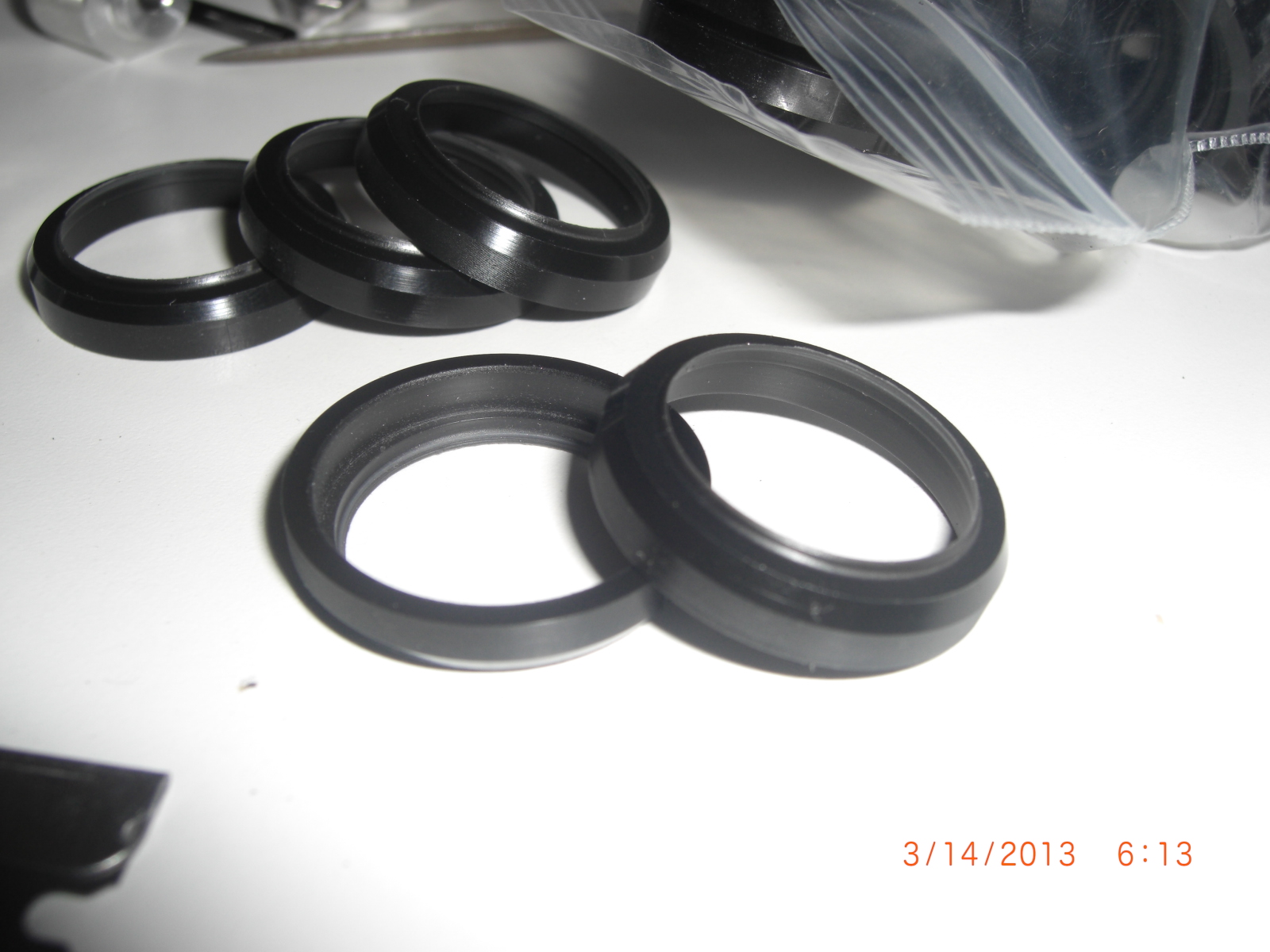

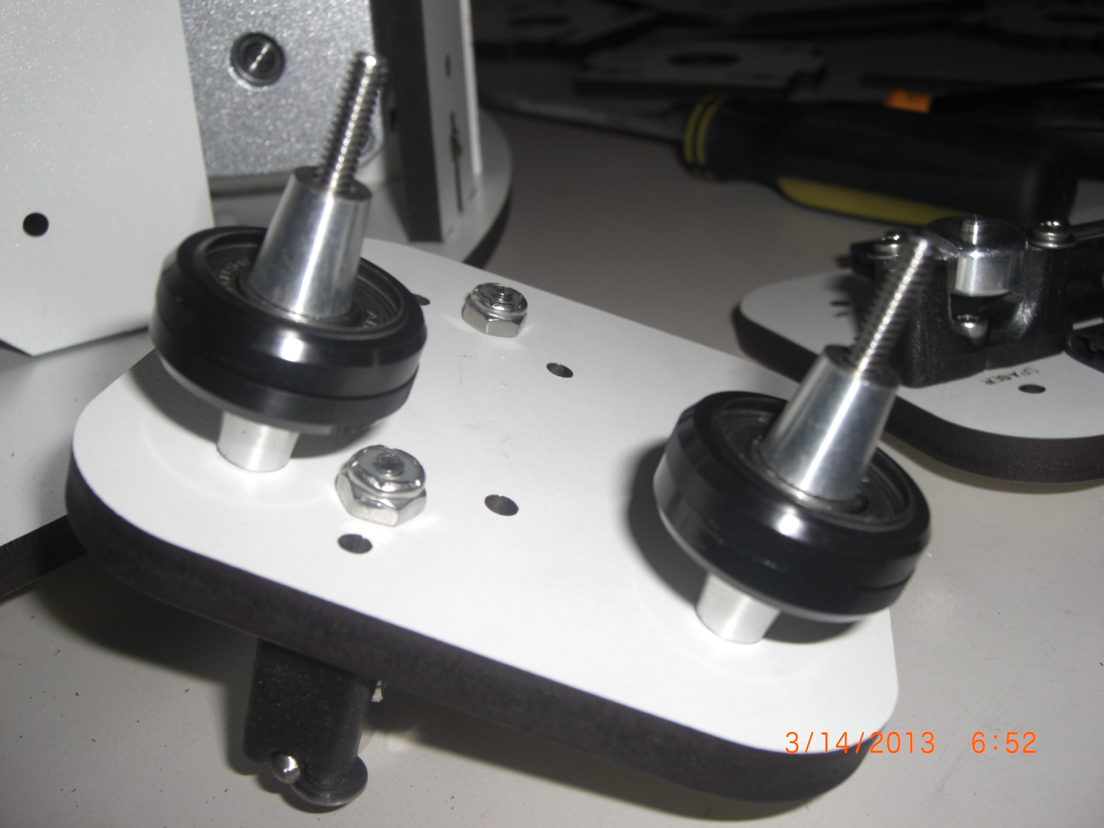

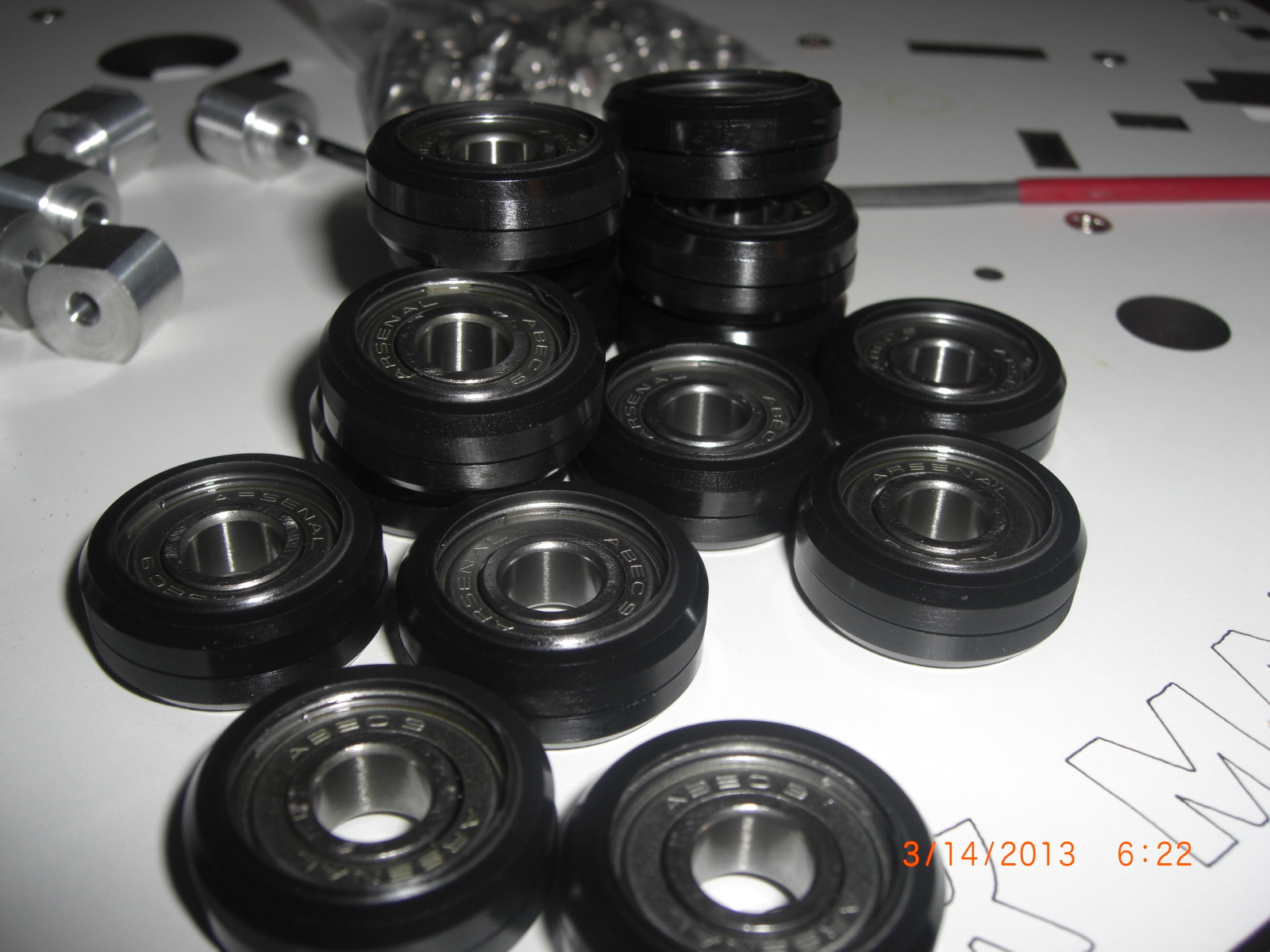

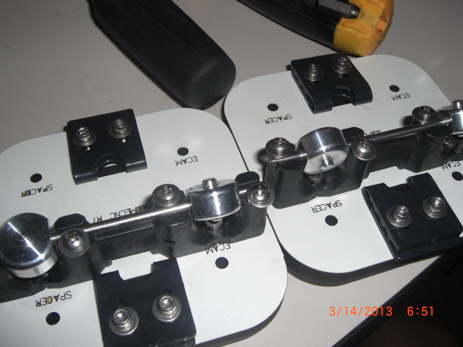

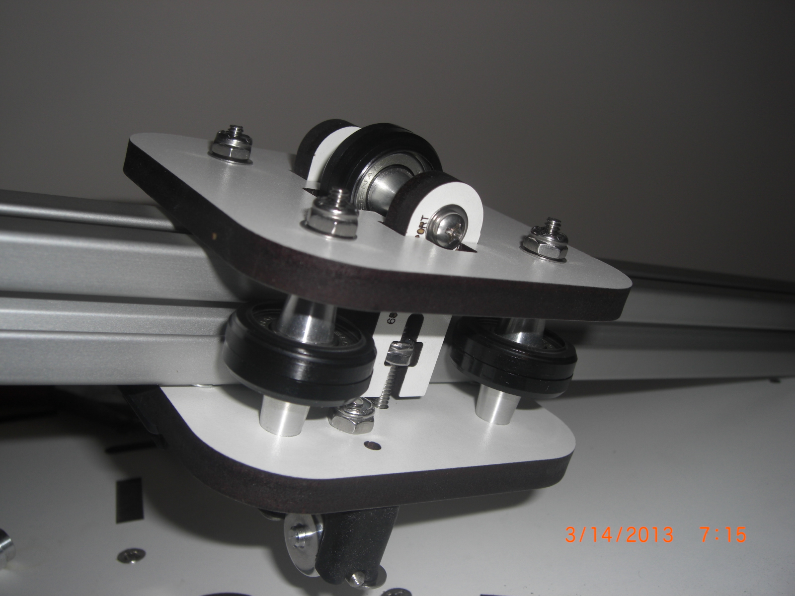

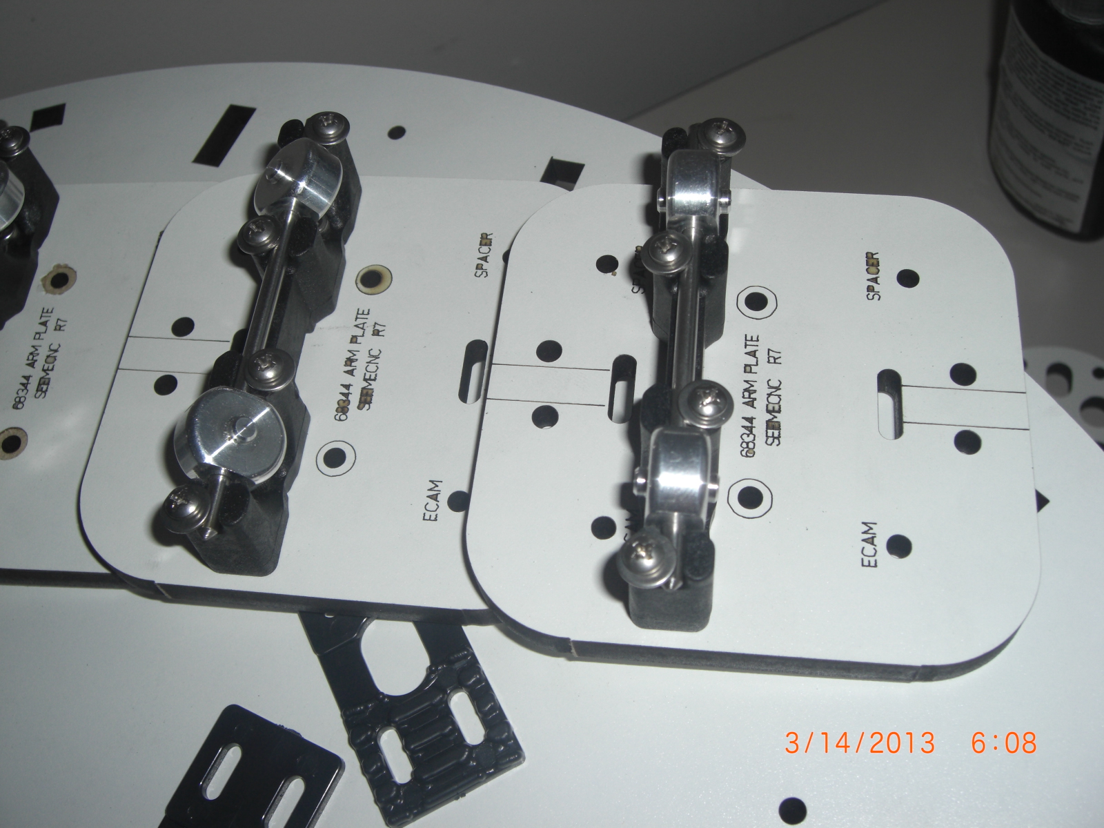

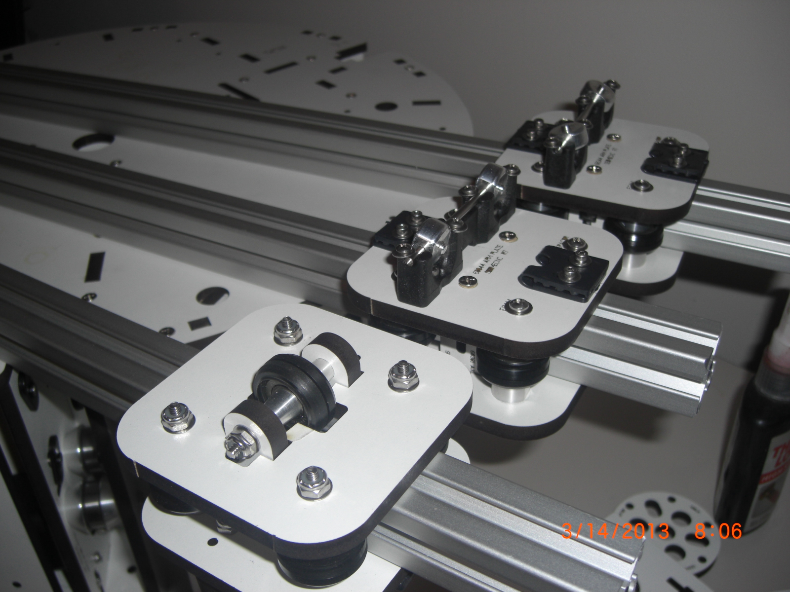

So on with the build. I finished up the cheap skate roller bearings. I had forgotten to put all the washers in place. so I went back in redid those too. Reminded me to look at the assembly pdfs again just to make sure I had everything installed correctly. Exploded diagram parts assembly helped a lot. bye the way, if you dont know where to find these here is the link http://seemecnc.org/download/RostockMAX/Assembly/
If you haven't noticed already, i'm not exactly following along in geneb's manual.

I like the black bearing covers. They would go good with my black machine.

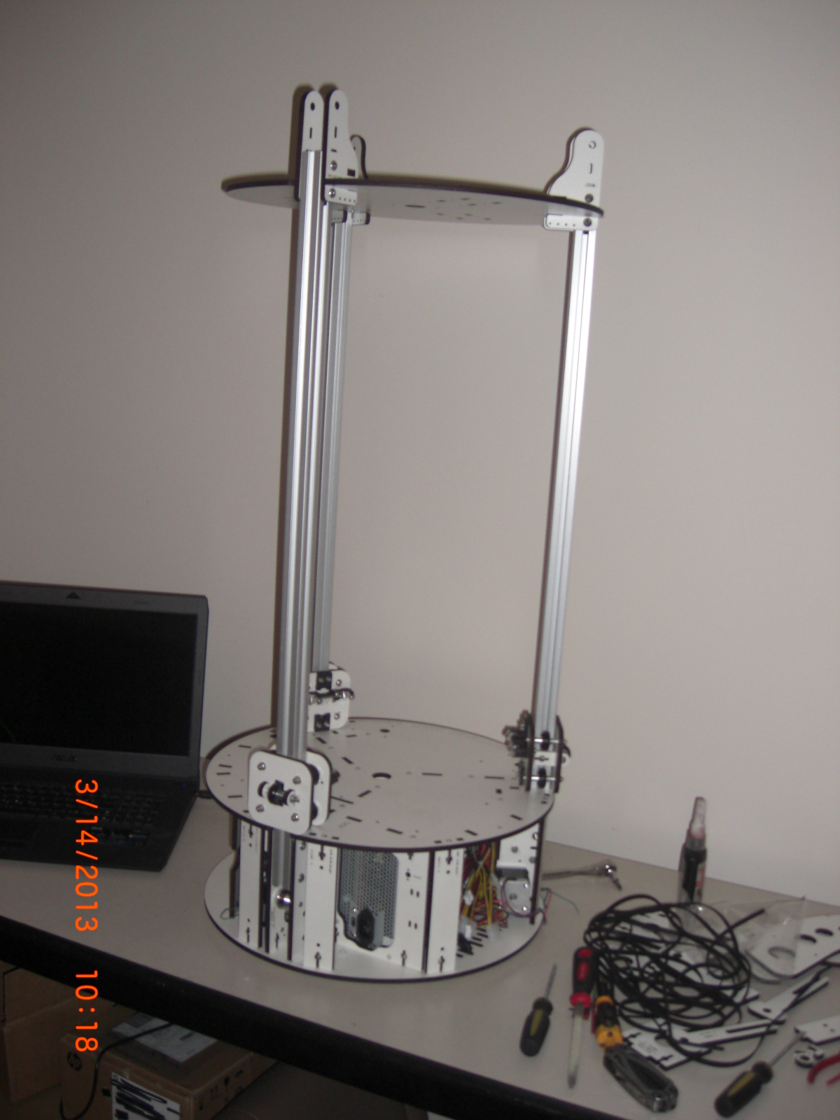

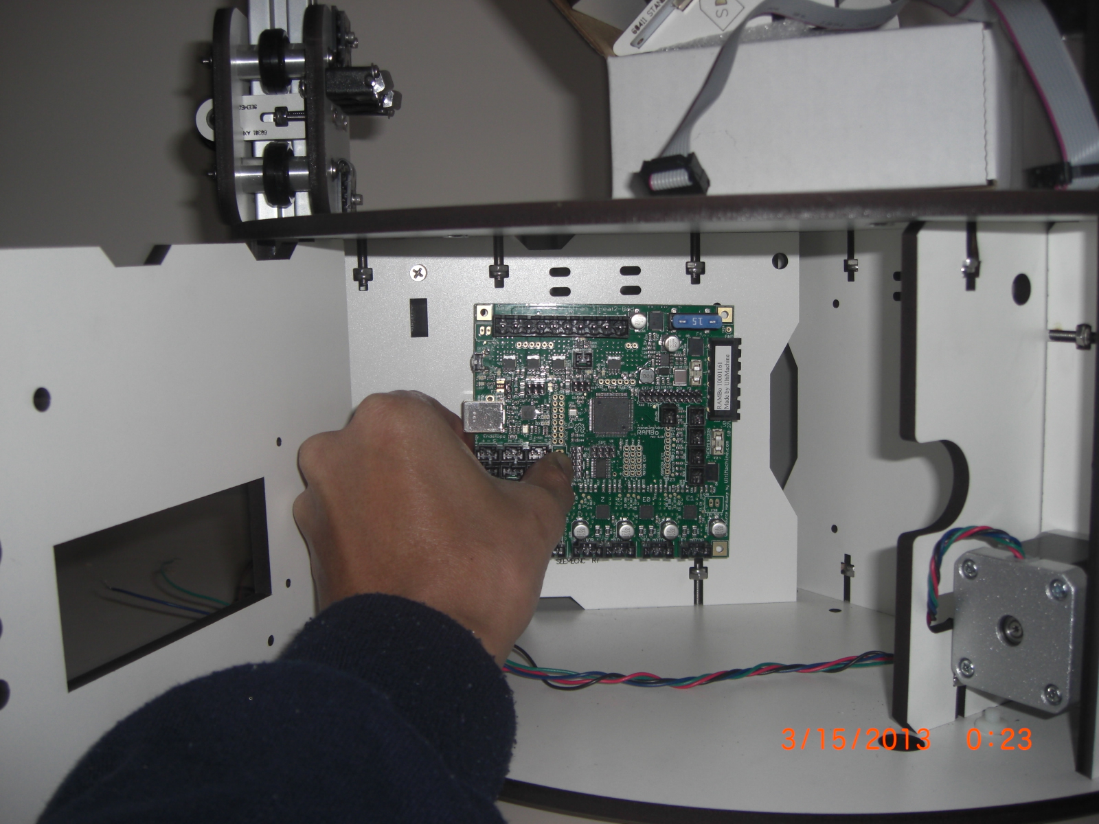

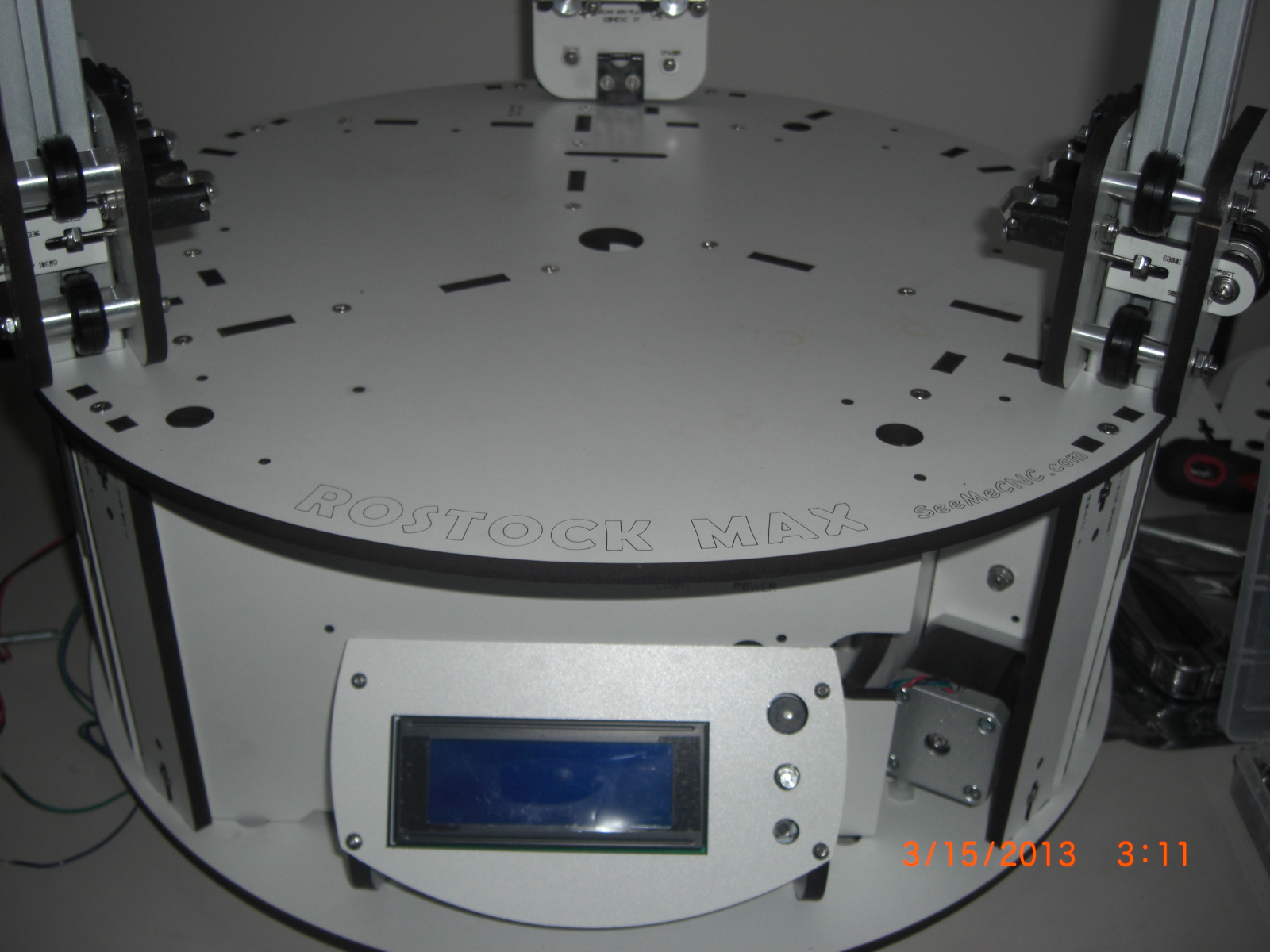

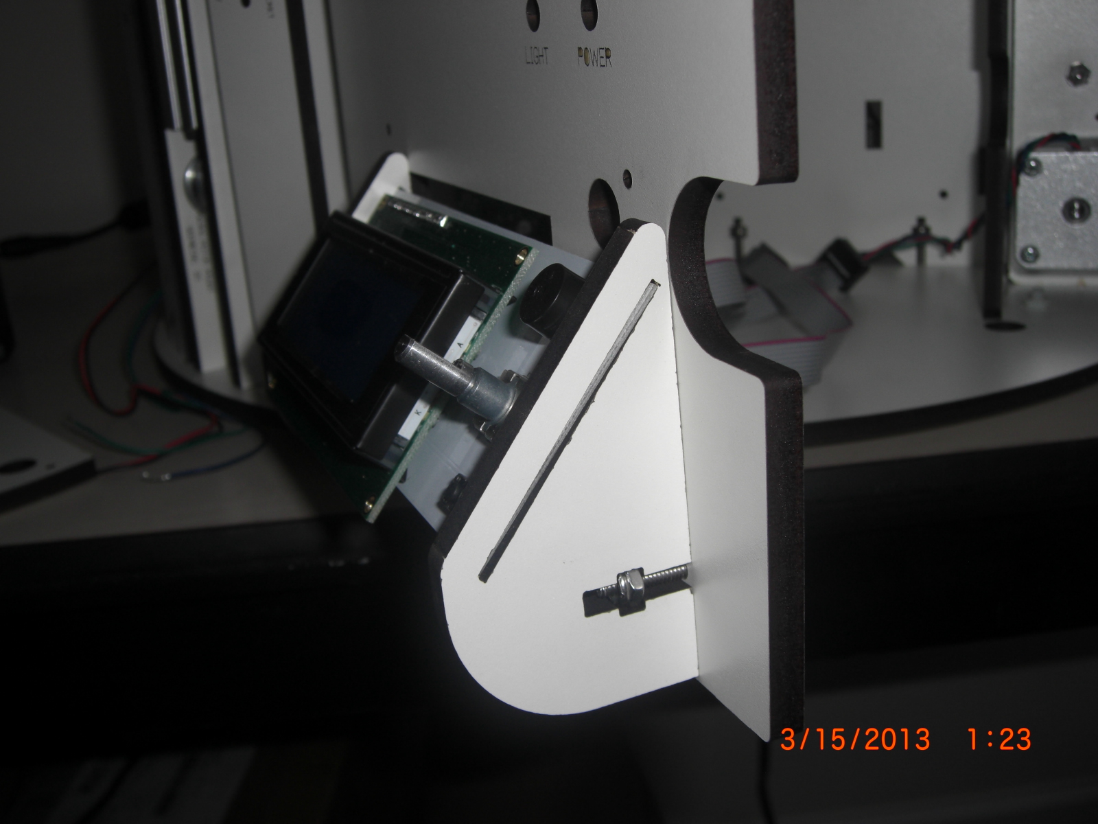

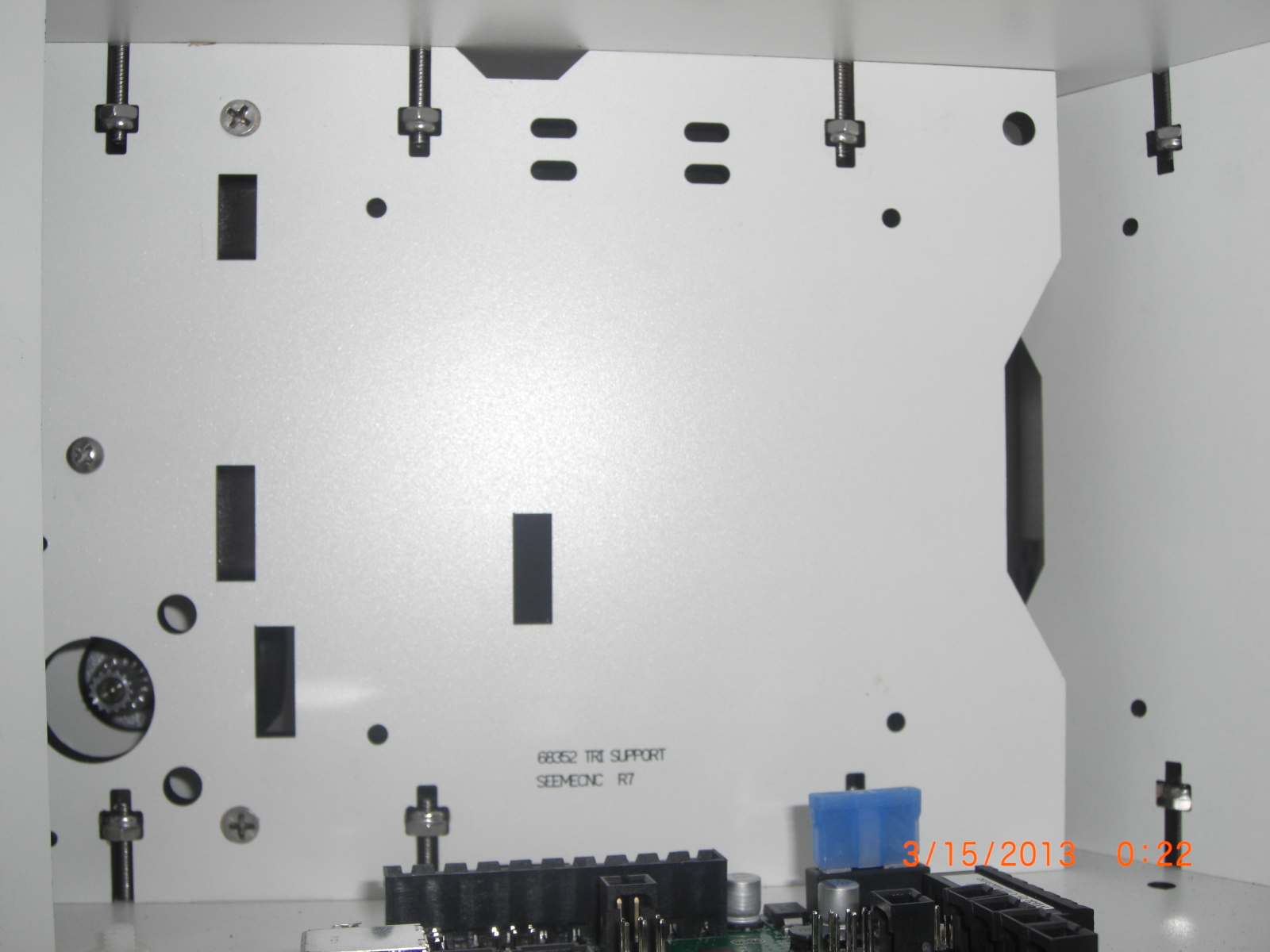

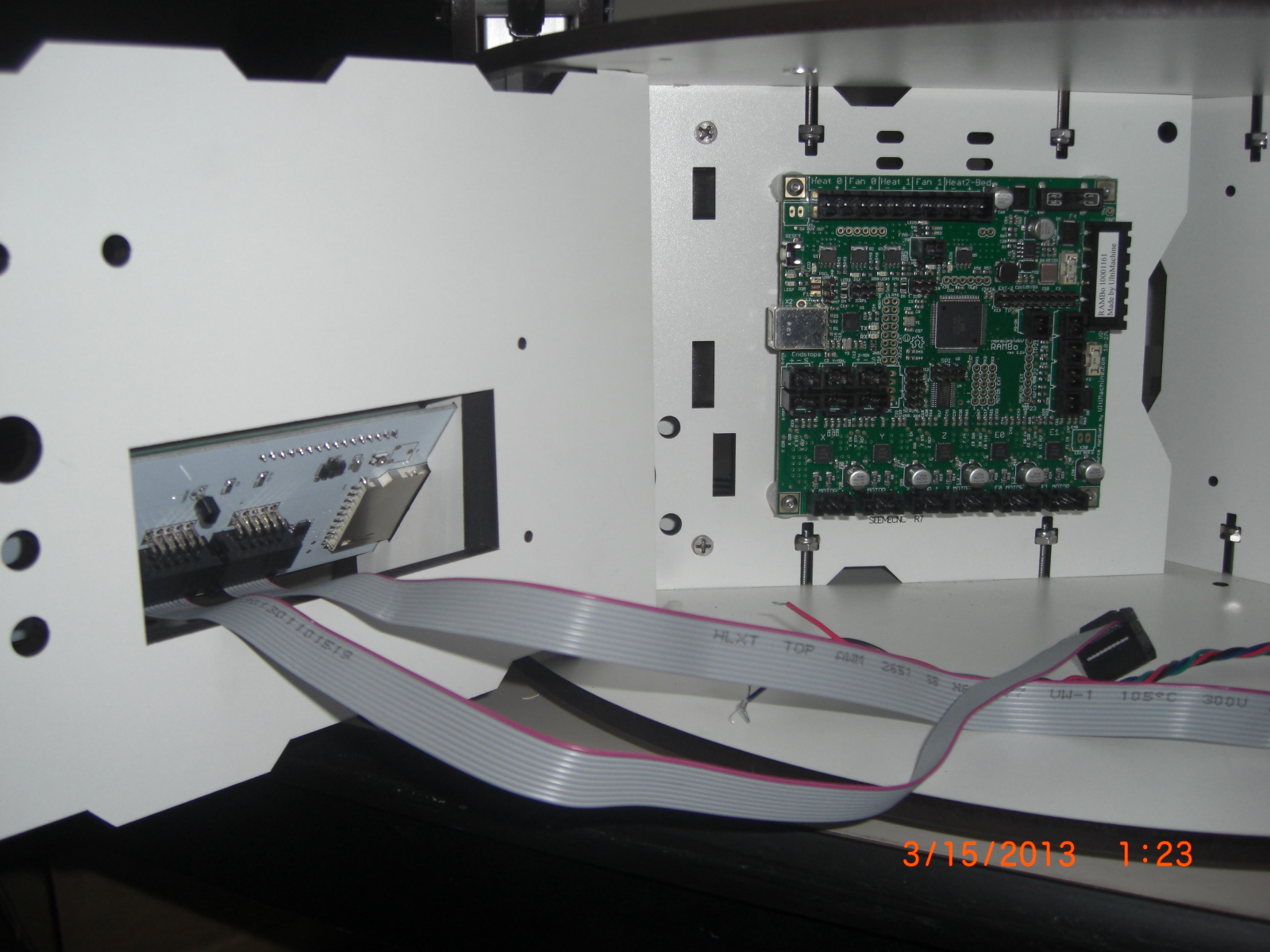

more progress today. Starting to look like a rostockmax.

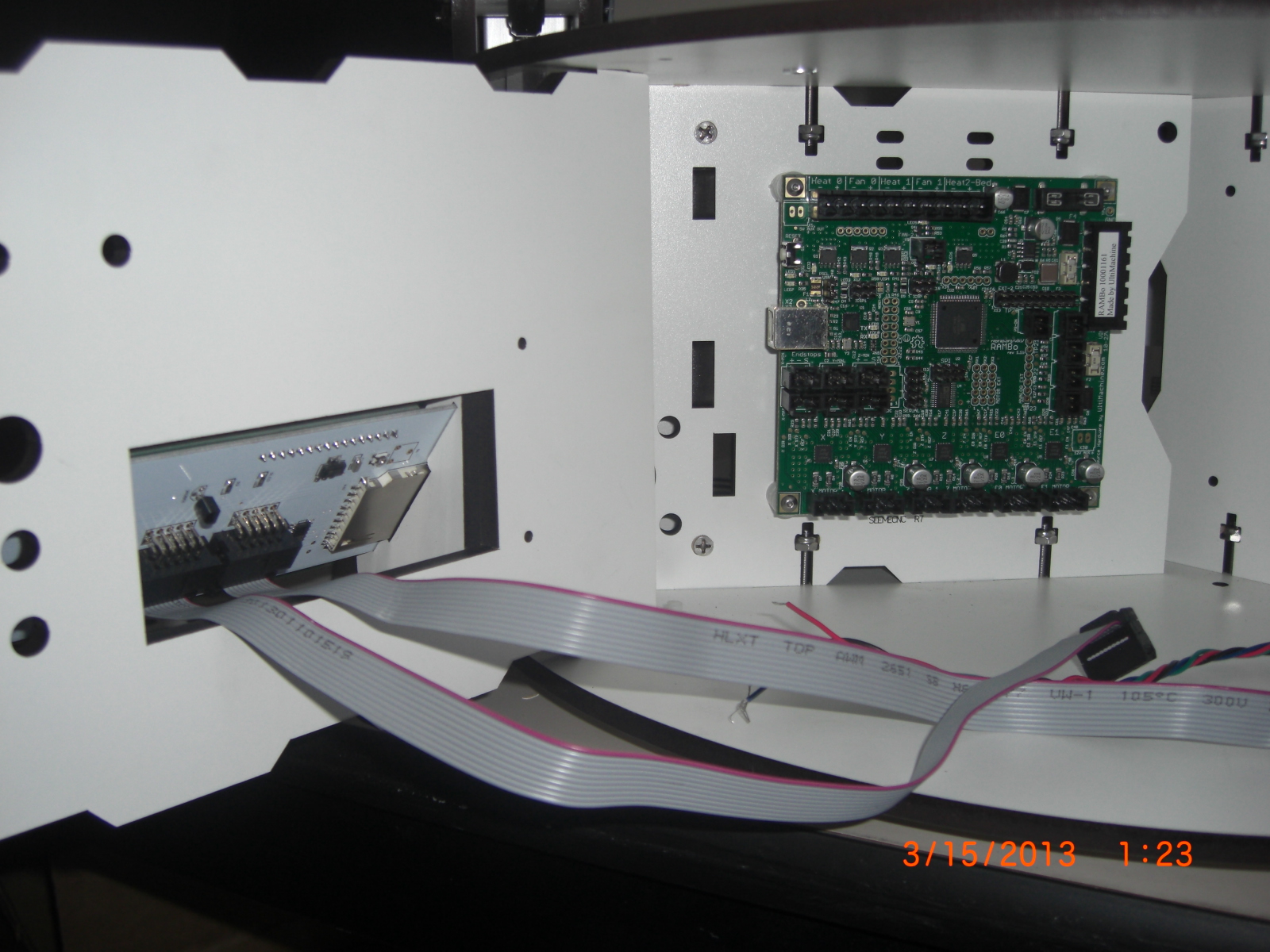

found a cozy spot to mount the rambo, the holes were already there. Actually You probably have to mount it here because the wires for the lcd aren't long enough to reach the other side.
Re: Another rostock max build
I like that. If you move the LCD door to the spot between the X and Y towers you will not have any problems putting the Add-A-Struder kit between the Y and Z towers since that door will not need to be accessed. Do all of the partitions have these mounting holes in your kit?
cambo3d
Posts: 1057
Location: Florida
Post by cambo3d »
mhackney wrote:I like that. If you move the LCD door to the spot between the X and Y towers you will not have any problems putting the Add-A-Struder kit between the Y and Z towers since that door will not need to be accessed. Do all of the partitions have these mounting holes in your kit?
looks like all of them have these holes. probably an update to the design. that needs updating in the manual also.

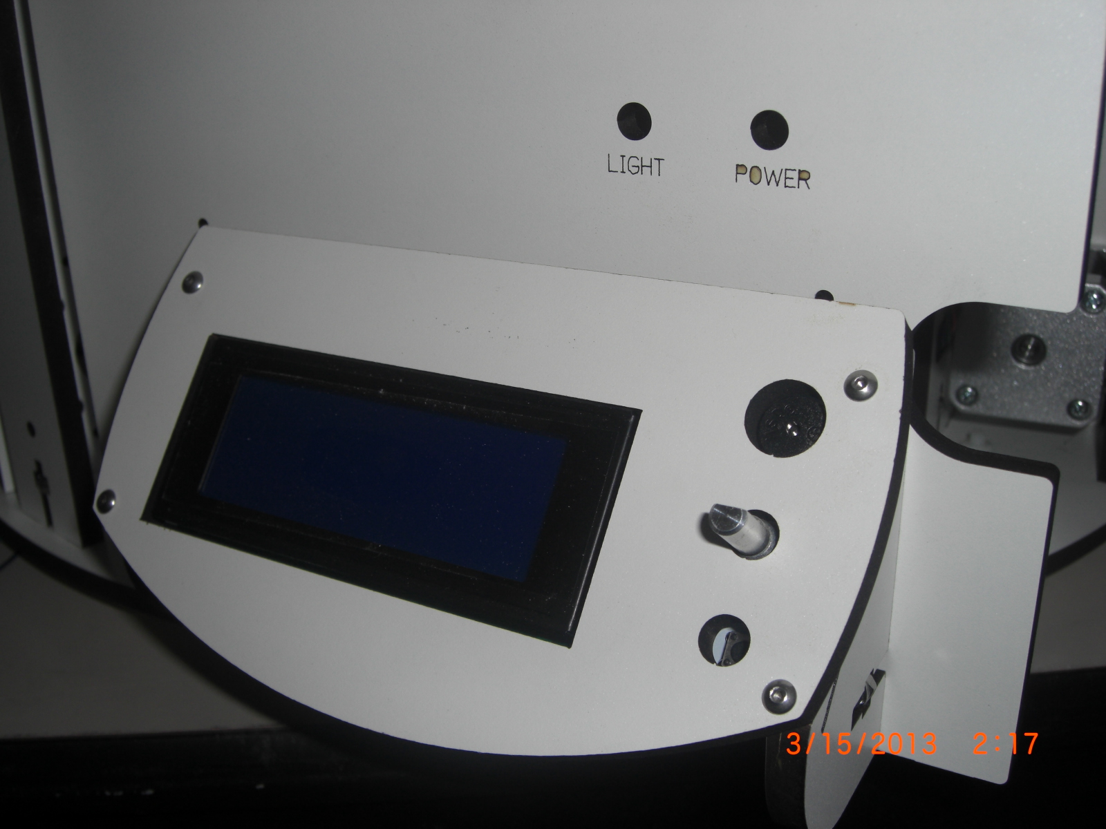

Post by cambo3d »

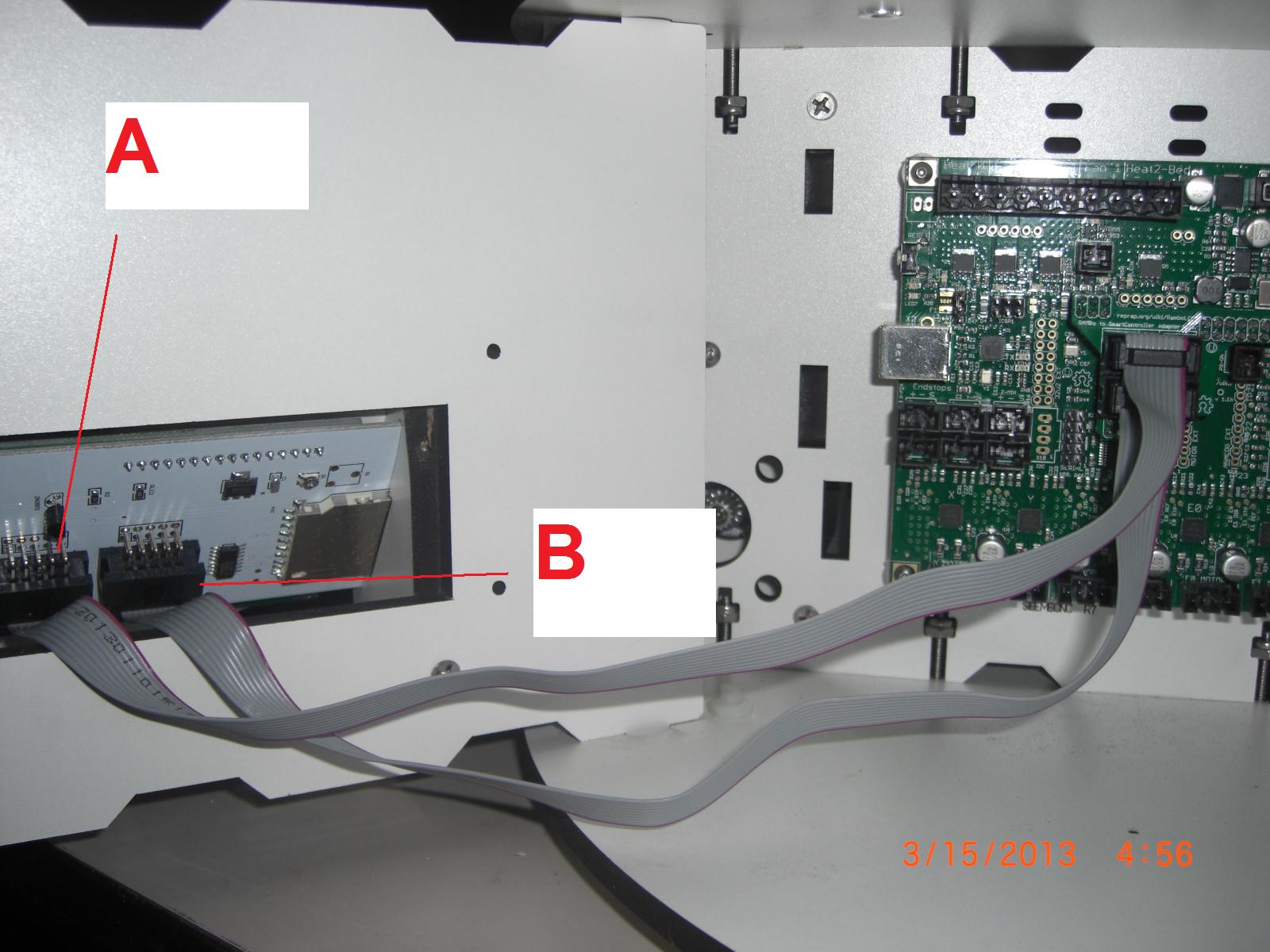

rambo mounted up and lcd installed. I used 4-40 socket cap pan head screws to mount lcd panel (not included, I did this because it looked better) to the angled mount. You will have to drill holes in the angle mount to mount the lcd panel cover. Do this carefully or you will split the melamine angle mounts or damage your lcd.
Yeah, I like that mounting location for the RAMBo - no wire flex and stress on connectors when opening/closing the access door.
That's exactly how i've mounted them. So everything is accessed in one location and second extruder kit wont be in the way.

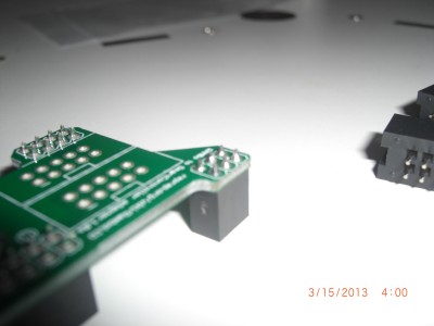

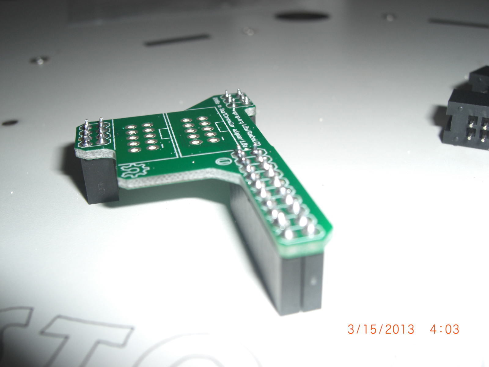

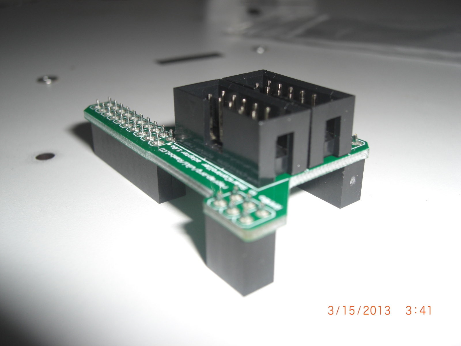

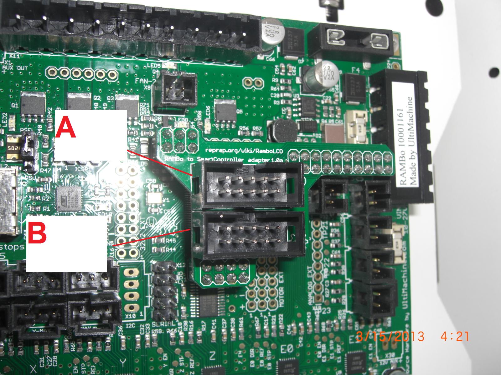

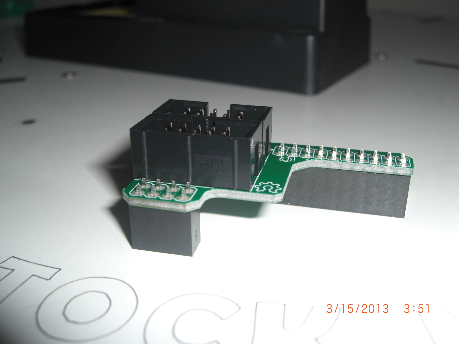

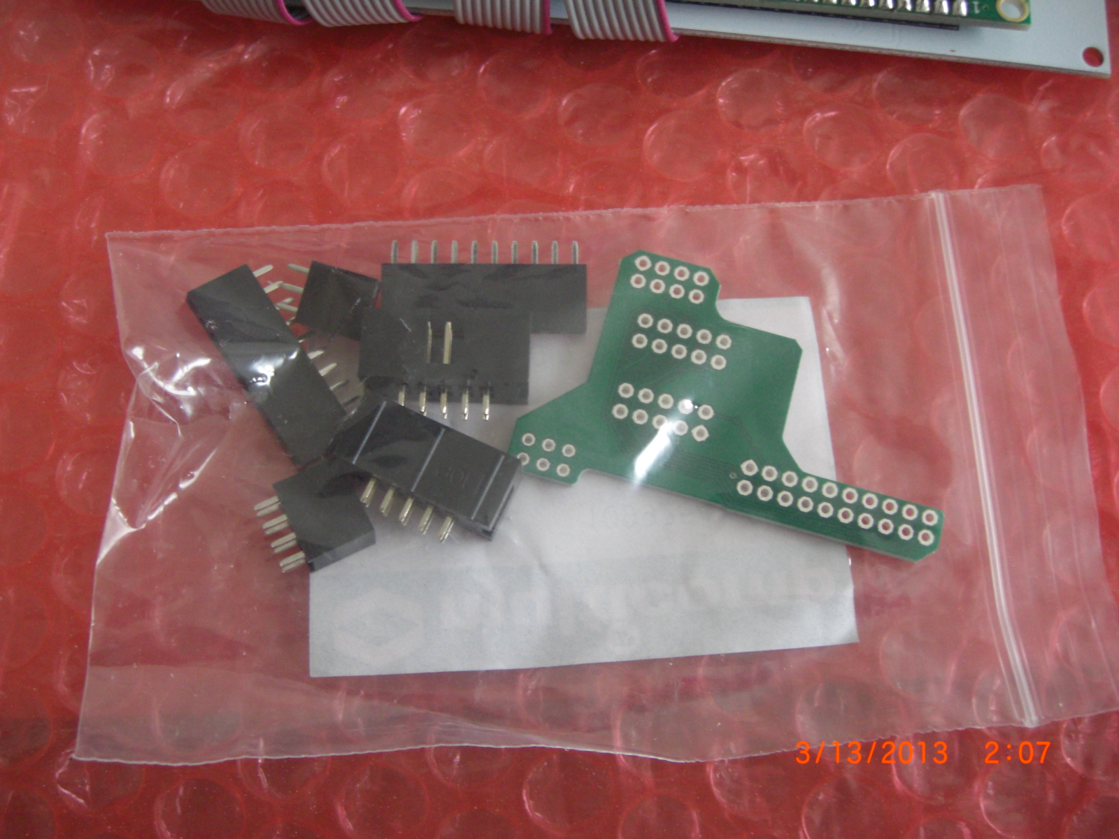

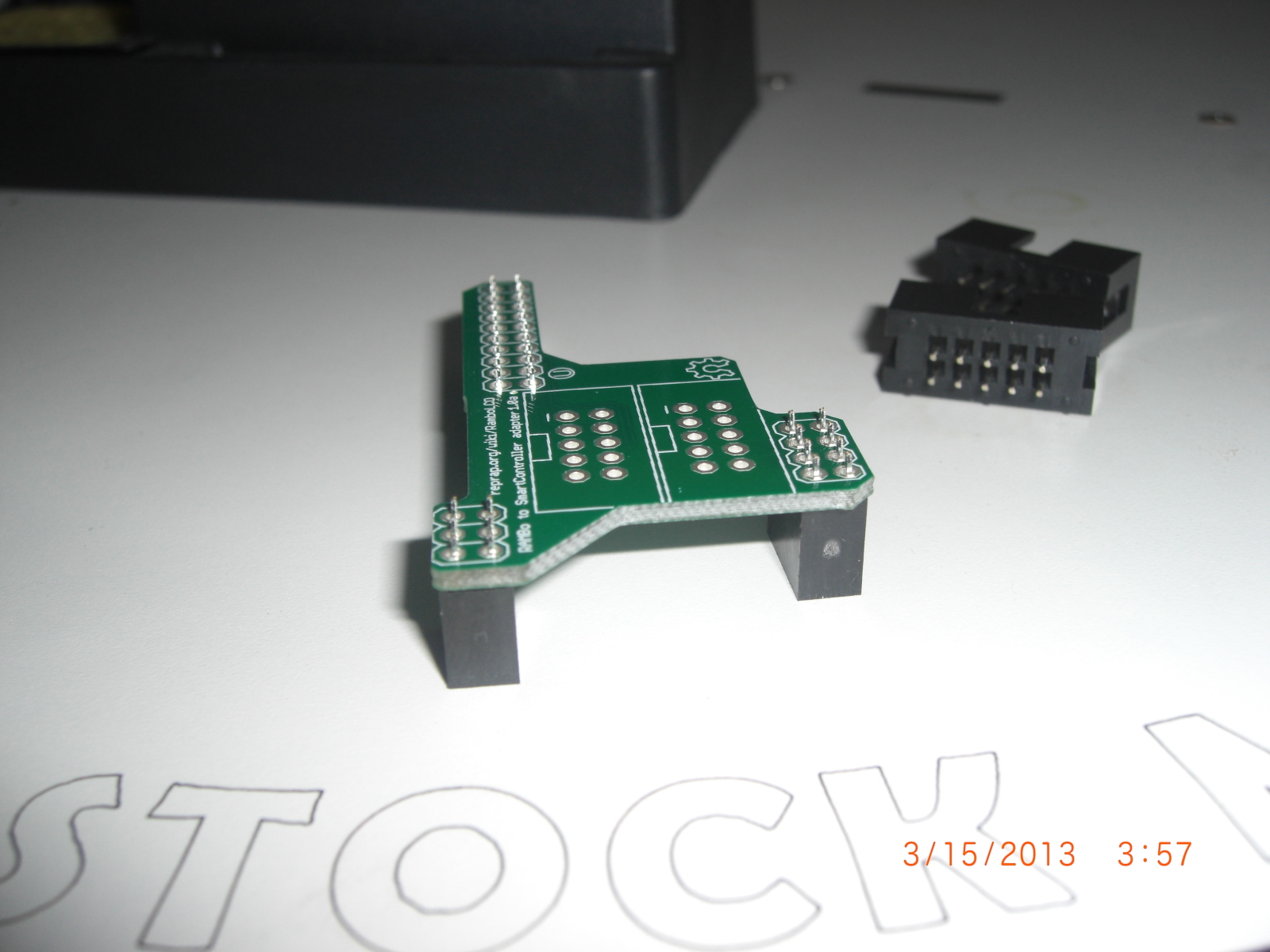

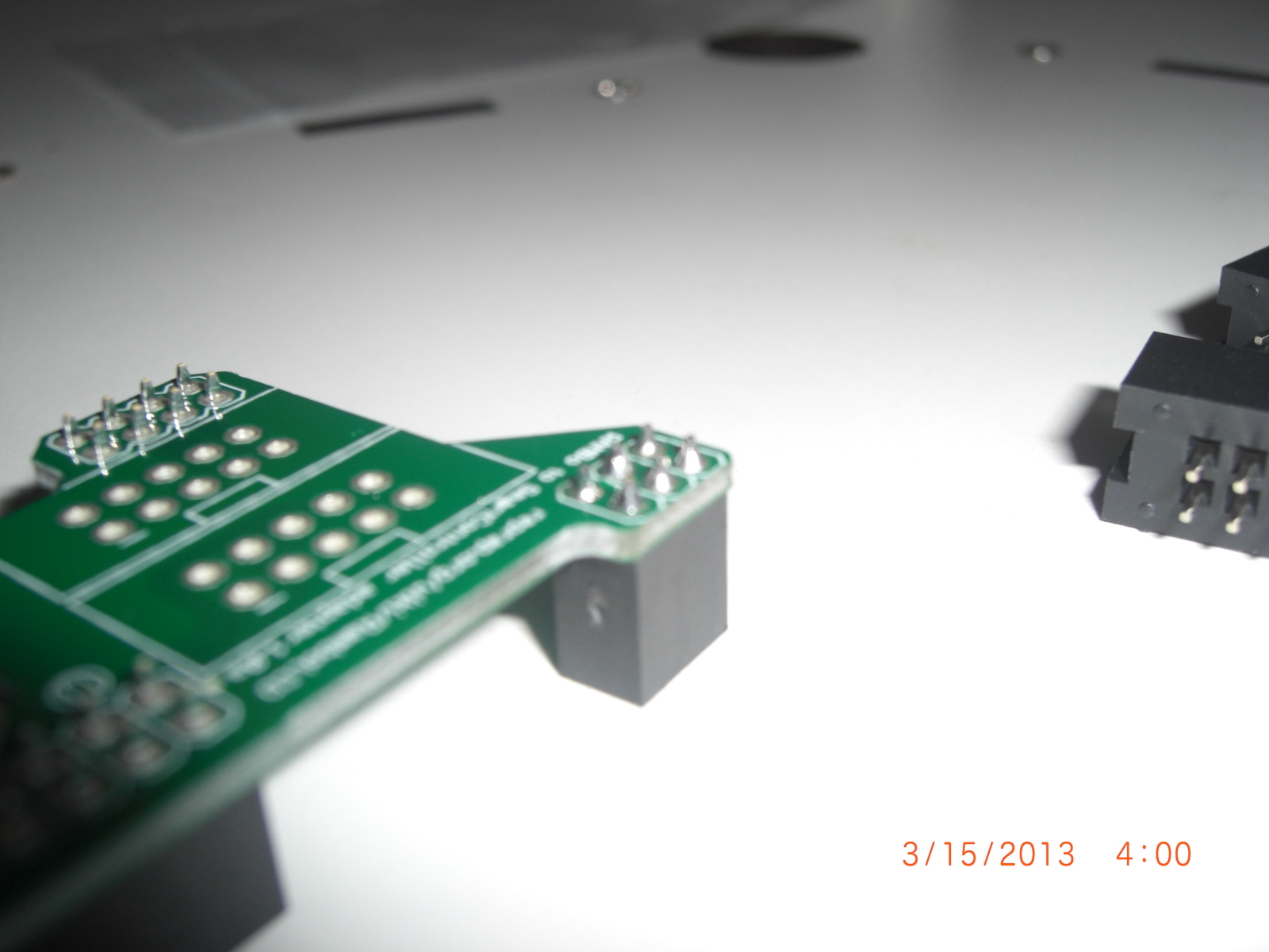

Mounted all the pcb headers in place to prep the new rambo lcd adapter for soldering. Would have been nice if these came soldered.
cambo3d
Posts: 1057
Location: Florida
Post by cambo3d »

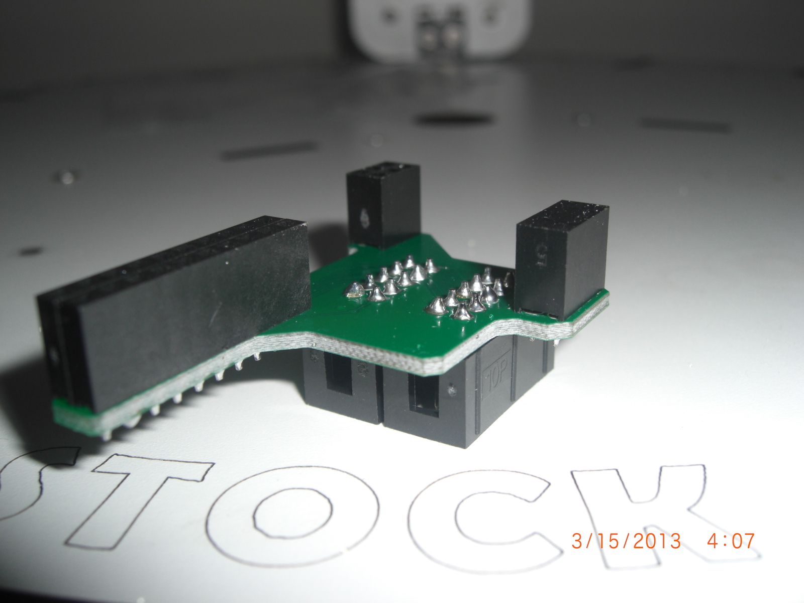

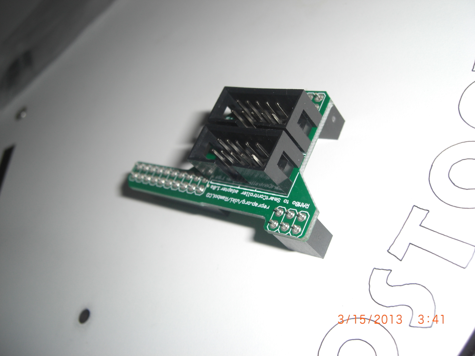

The final result. I recommend soldering the two 10 pin headers first. Then turn it over and solder the others. This will allow you more room to solder without the other headers in your way.
In the photos, I did it the other way and found that soldering the two 10 pin headers last makes it a little more difficult. Especially if you do not have steady hands
all soldered up ready to install.

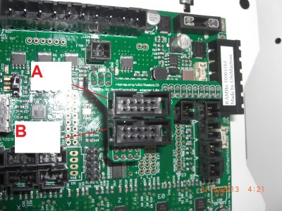

Installed and ready for cable connections. On the adapter as viewed from my photo. The top 10 pin header is your A connector from the lcd ( "A" connector meaning left connector on lcd) and the bottom is your B connector from the lcd. If you happen to reverse the cables, dont worry. All you have to do is swap them around. Your lcd will not power on if the cables are not in the correct spots

I'm not sure, if every soldering point is a good one..
Hard to say from the pictures. Maybe you want to doublecheck.
cambo3d
Posts: 1057
Location: Florida
Post by cambo3d »
aehM_Key wrote:I'm not sure, if every soldering point is a good one..
yeah its not perfect but they all metered good.

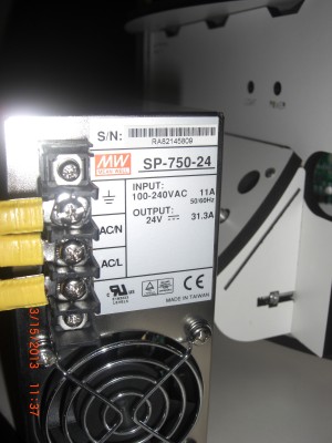

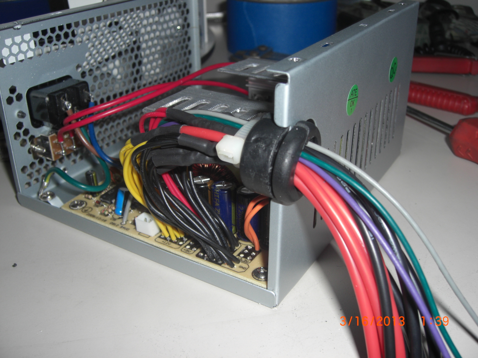

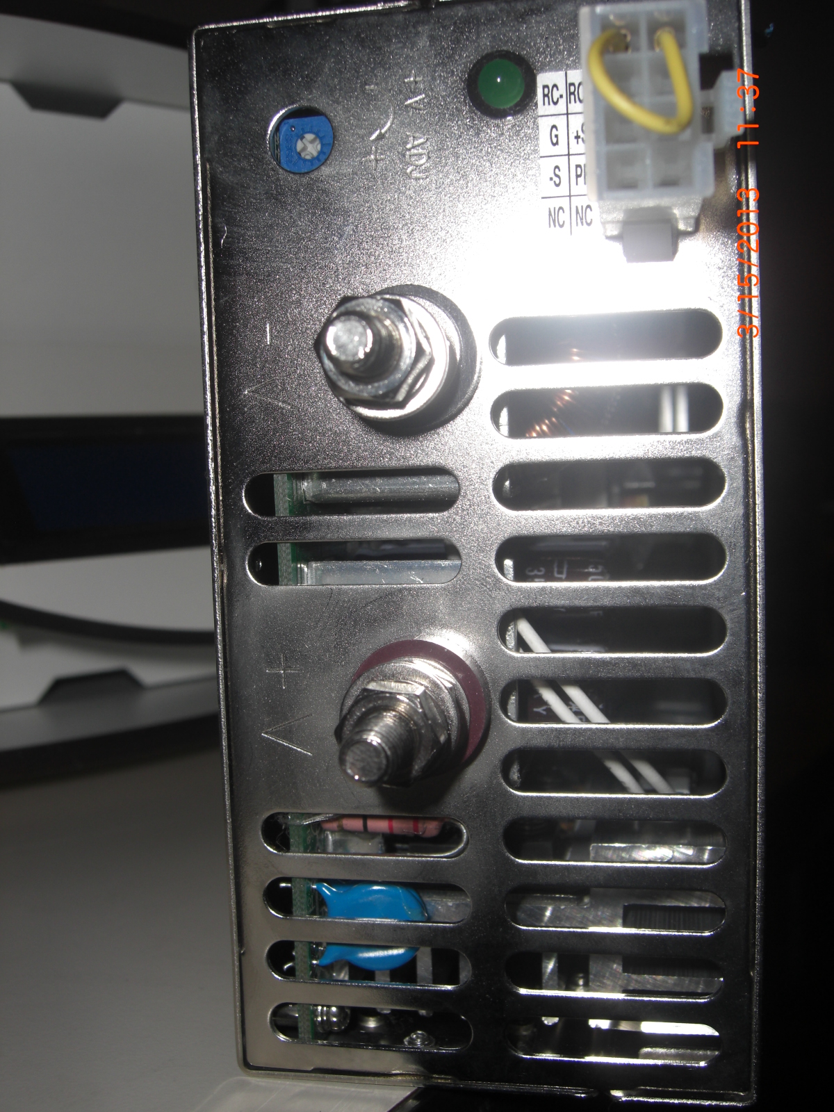

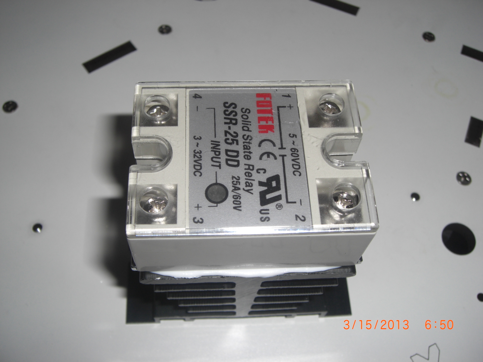

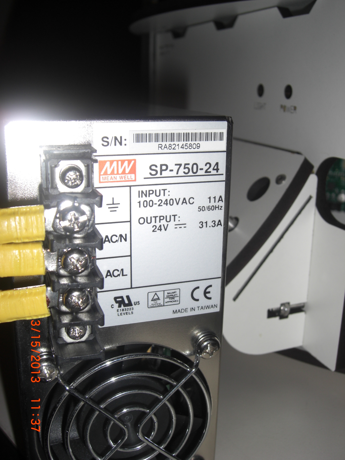

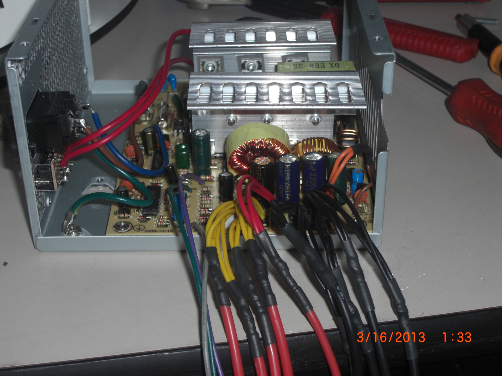

Continuing into the morning hours.. I decided to mod my voitek power supply a little. Just to clean some wiring up and add few things. Here is a sneak peak.
Dedicated 24v 31amp 750 watt Meanwell power supply and 25amp solid state relay for the Heated bed. To make sure my onyx gets to temp with the quickness. :mrgreen:
More to come later. I'm calling it a night.
cambo3d
Posts: 1057
Location: Florida
Post by cambo3d »

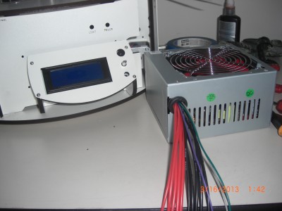

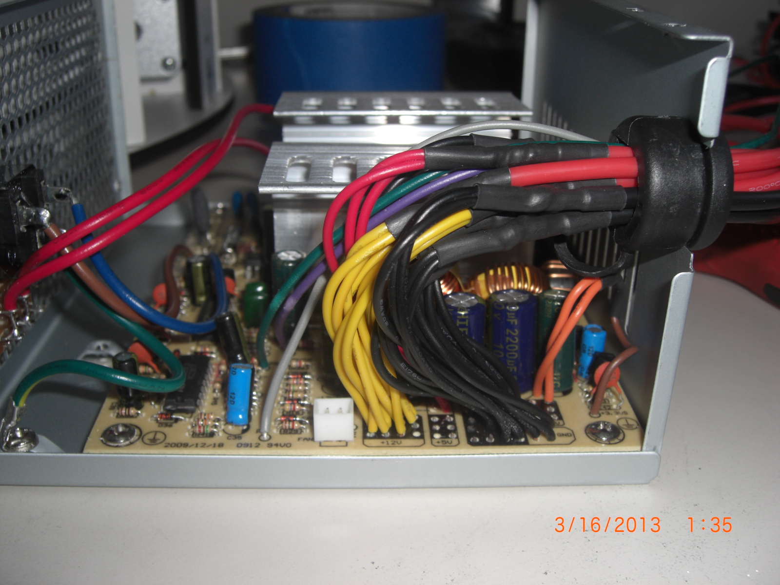

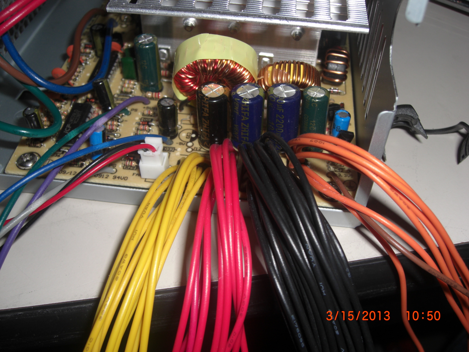

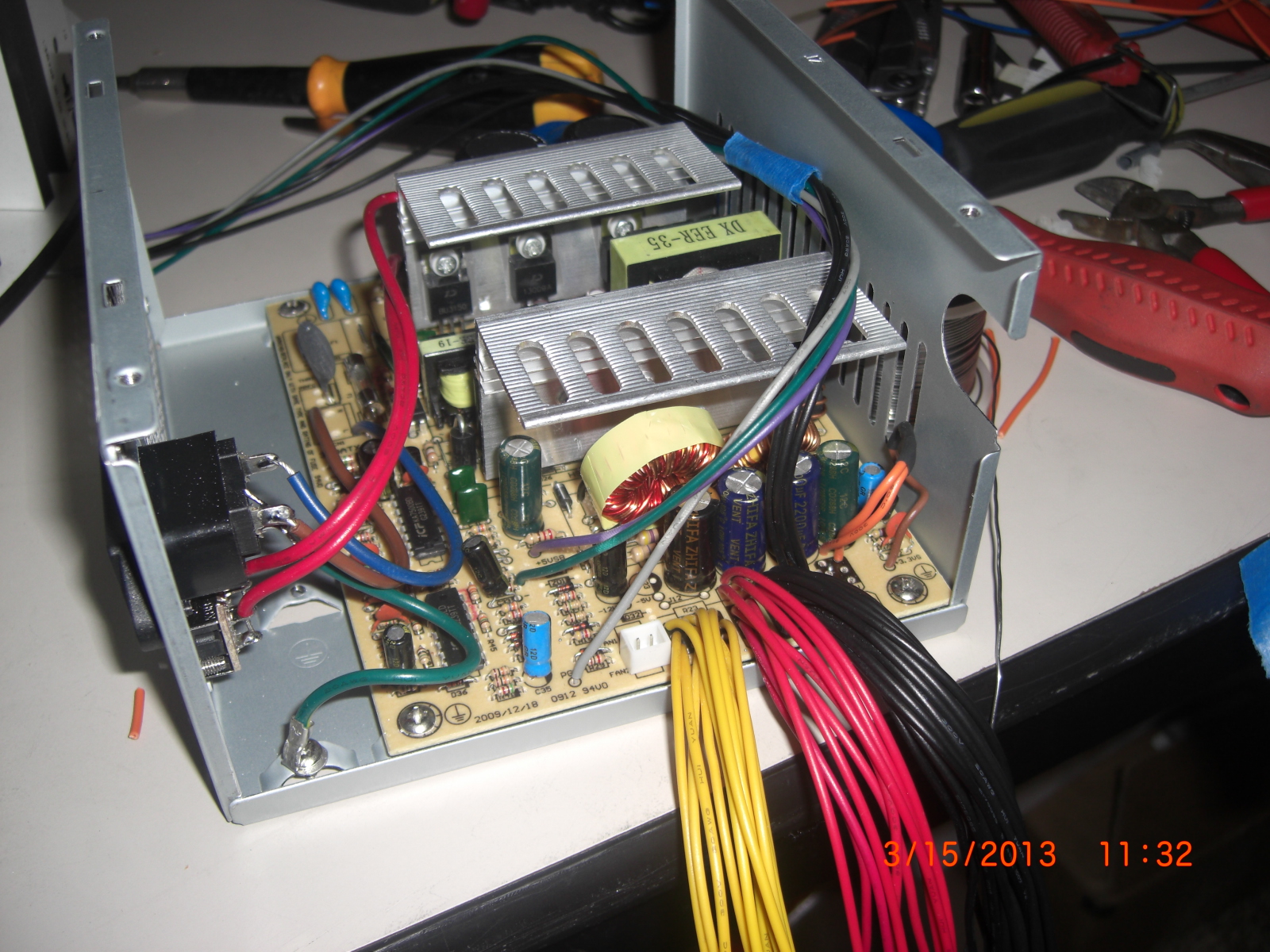

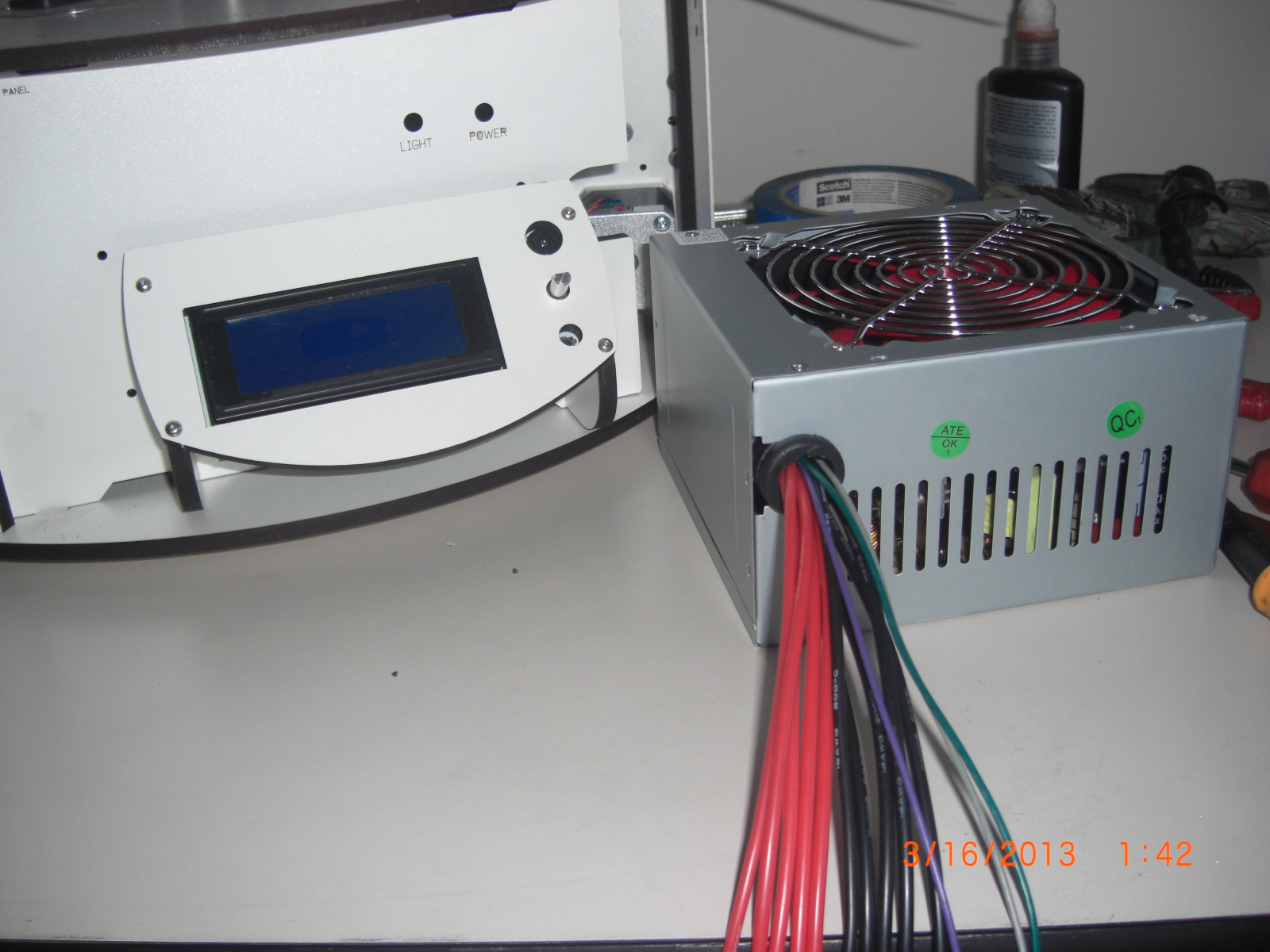

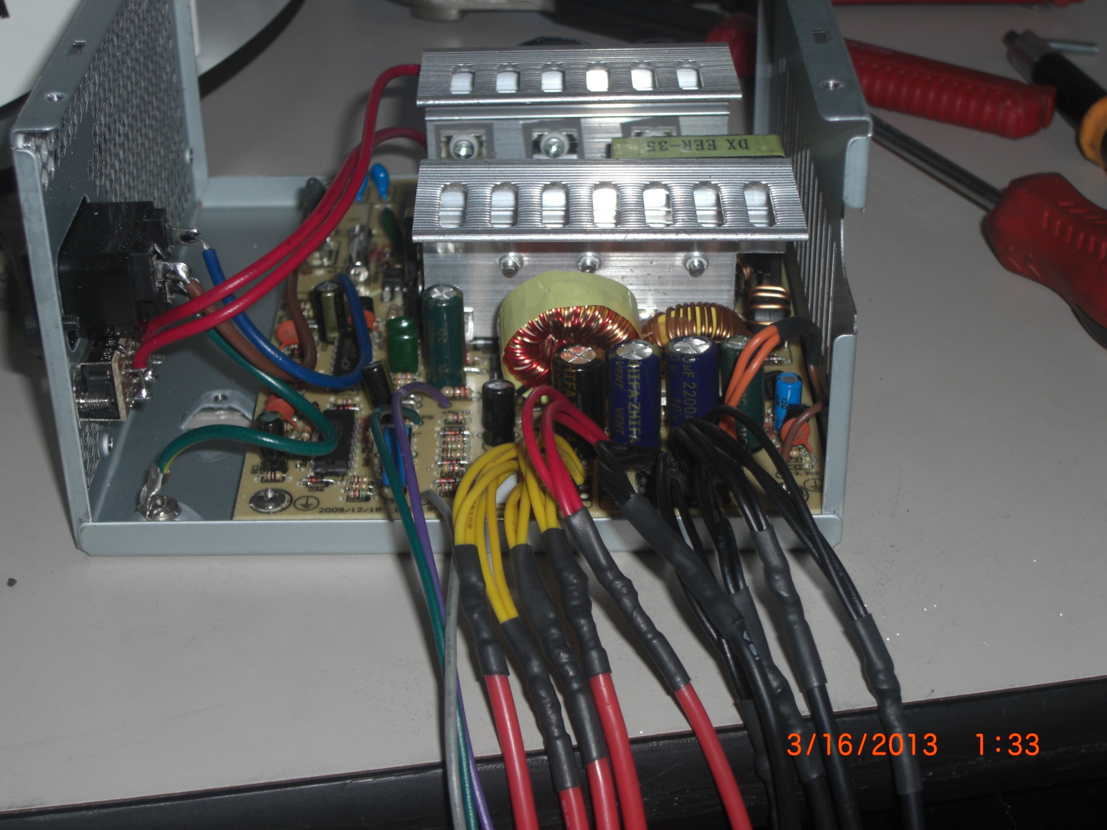

So after some surgery on my voitek power supply. Here is the result. Combined that bunch of messy wires into something more manageable and got rid of lines that weren't needed.
3 dedicated 12v sources for the rambo. Plus one extra 12v source connect to fuseblock for accessories, One 5v source just in case I needed it for something, also wired to fuseblock for accessories
I will be adding a standby led light, manual power switch for the power supply, and power on Indicator on the front of the rostock.
Of course all this is just something I wanted to do and its not required.
mess of wires
after surgery
On the last picture you posted I see red and black wires but I see no yellow (12V) wires.
I bet you hid them so I would ask..
Carl
cambo3d
Posts: 1057
Location: Florida
Post by cambo3d »
Eaglezsoar wrote:On the last picture you posted I see red and black wires but I see no yellow (12V) wires.
Carl
if you look at the photos above the yellow wires got spliced and soldered to the red wires. here's a better picture below. All my 12v wires are 14Gauge, and 5v wires are 16 guage. That's how I determine which is which. I removed the blue -12v wire, no use for it.
Good job, threw me a curve on that one.
Have you connected the Onyx to the 24v supply to make sure the traces can handle it without any problems?
cambo3d
Posts: 1057
Location: Florida
Post by cambo3d »
Eaglezsoar wrote:Good job, threw me a curve on that one.
Haven't finished the wiring yet, but John from seemecnc says its okay and aehM_key is also using 24v for the onyx.
