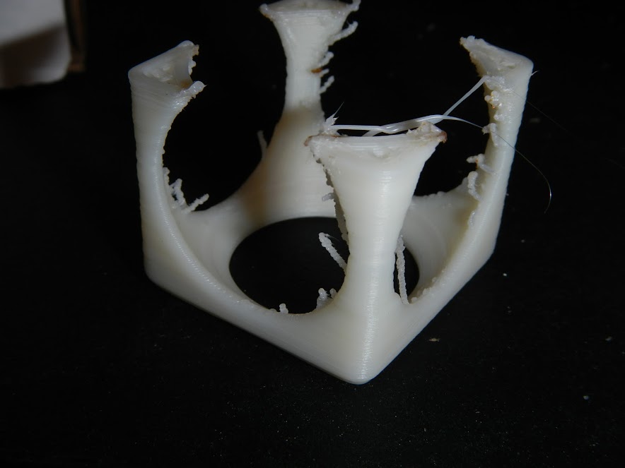

Unfortunately though it looks like it's stringing between the four corner towers :(
[img]https://lh3.googleusercontent.com/-PEhB ... CN9523.JPG[/img]
But over all I think it's leaps & bounds over what I had :D

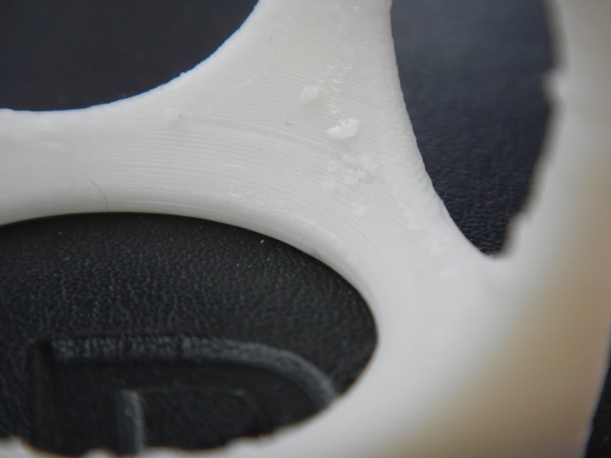

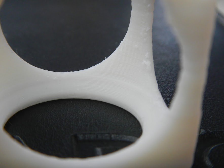

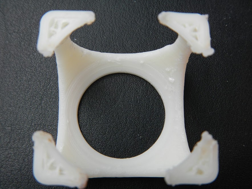

Tried to do a more complicated print with overhangs... It went pretty well until it got to the overhangs, lol
[img]https://lh6.googleusercontent.com/-fB2K ... CN9539.JPG[/img]
[img]https://lh4.googleusercontent.com/-Bmuw ... CN9540.JPG[/img]
Once it got to the overhangs it kept "bumping" into the extra plastic and eventually knocked it off of it's spot on the build plate & I had to kill the job

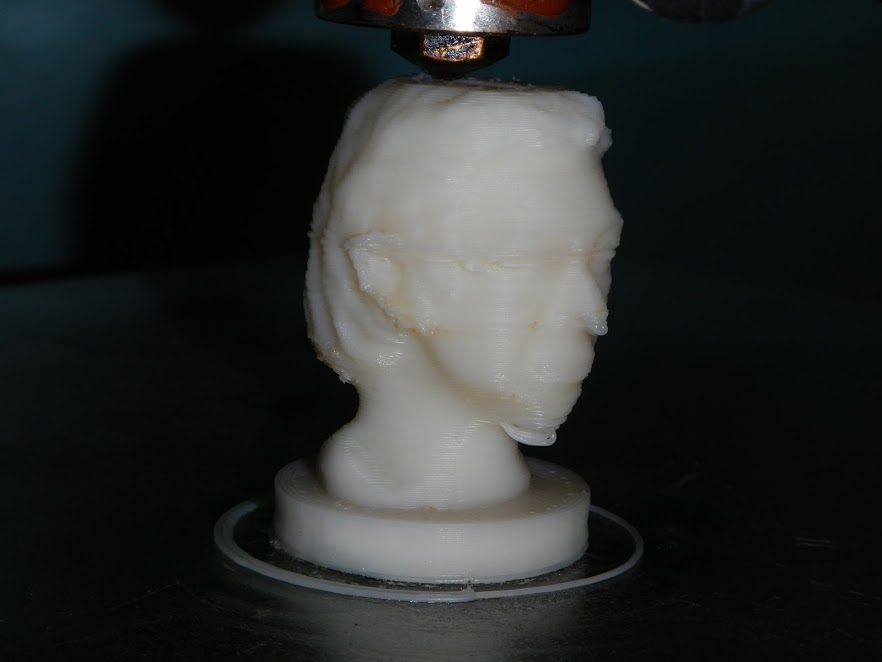

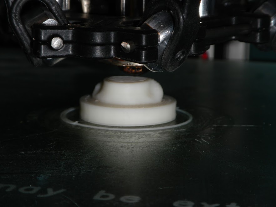

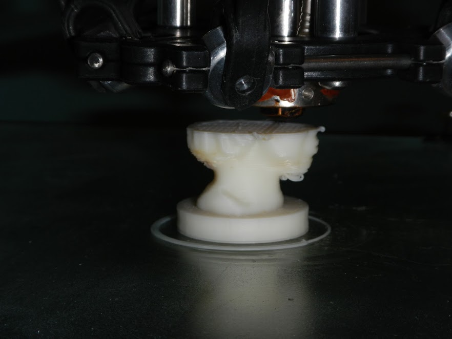

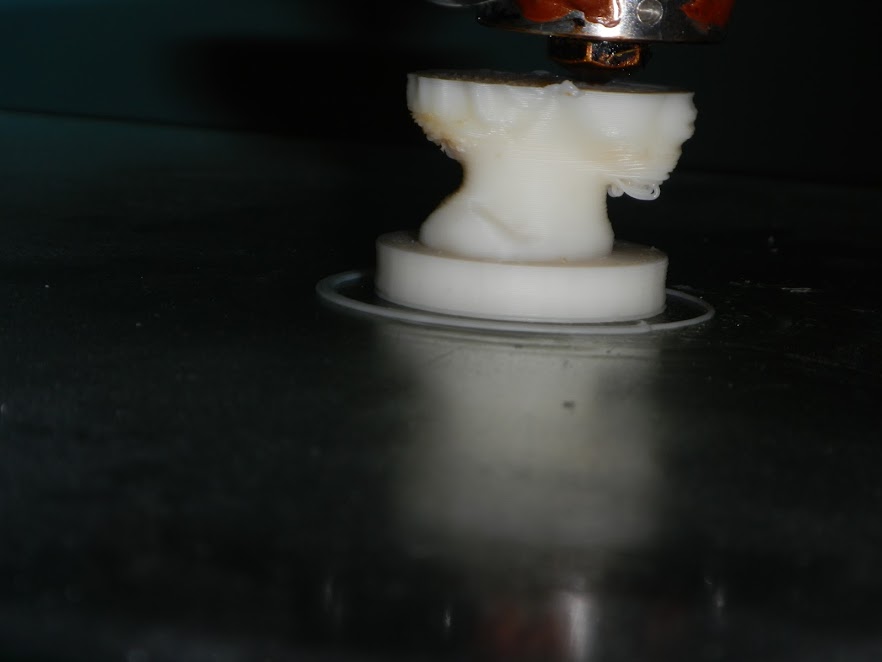

Using the z-lift at 1mm like mhackney suggested seems to have helped, thanks! With this next print I think I was being a little too ambitious, considering I'm still not "fully" calibrated... But it actually turned out ok. I printed Serge's head: http://www.thingiverse.com/thing:49690 from thingiverse just to see if it would do it. I didn't use support material, and printed *really* slow, like <10mm/sec, and at 255*C. I think it took about 3 hours to print, and I only printed it at 40% scale, lol.
About 60% the way through the print I accidentally knocked the laptop off the desk & killed the job. I imported the stl into sketchup, then sliced the head down to start at about where I thought it had left off. Re-imported it into repetier-host & had to do quite a few dry runs until I thought it was close to the correct size when trying to re-start the print. The bed had cooled down as well and the piece was no longer sticking... So I also had to make sure the rotation & placement on x/y was correct. After a lot of tweaking, I had it close enough and re-started it. It was the correct proportions I believe, but I did have it slightly misaligned on the y-axis. Here's some pics:

Here you can see the line of where I had to piece together re-starting the print right where the eyes are
[img]https://lh3.googleusercontent.com/-mScy ... CN9566.JPG[/img]
[img]https://lh4.googleusercontent.com/--QYa ... CN9569.JPG[/img]
Finished!

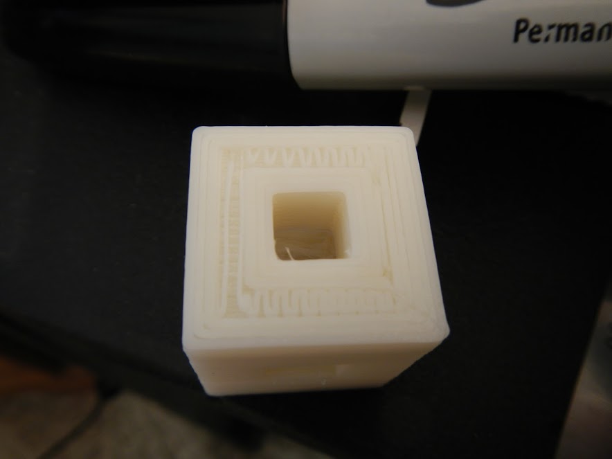

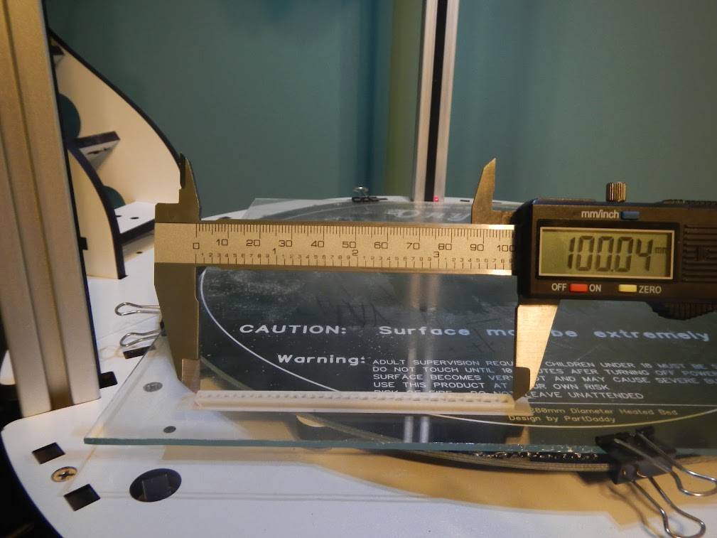

So after reading Polygonhell's post http://forum.seemecnc.com/viewtopic.php ... idth#p5452 I decided to go through these steps to see if my extrusion width was where it should be.... And of course it wasn't. I was over-extruding by a fair amount. I'm using the .5mm nozzle, and extrusion width set to .55. My first thin wall cube came out at .63. So in slic3r I modified my extrusion multiplier to .87 and printed again. This time I came up with an average width of .42. So one more adjustment of the extrusion multiplier to .93 and I came up with a .57mm print which I'm happy with. Not perfect, but at least closer!
[img]https://lh4.googleusercontent.com/-gbKc ... CN9610.JPG[/img]
I still need to go through some steps to determine my optimal temperature range for printing... I've just guesstimated based on how it looks while printing. I'm currently doing first layer at 260, and other layers at 255. I know this sounds crazy hot, but it seems to work ok for now.

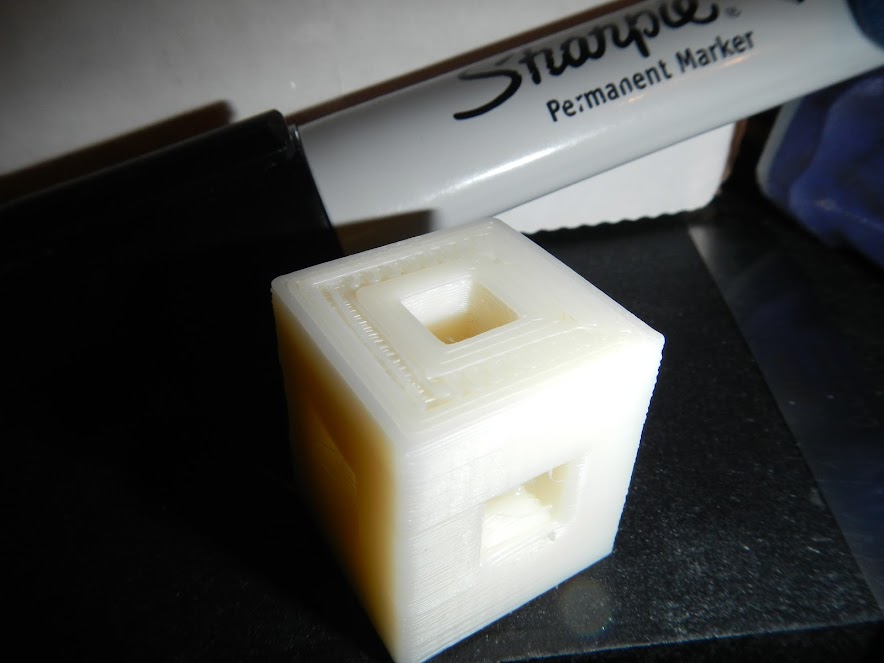

So after getting my extrusion with close I decided to see if I was printing properly to size... So I made a quick test block in openSCAD (http://www.thingiverse.com/thing:55887) of 100mm and printed it... Pretty darn close!! :D

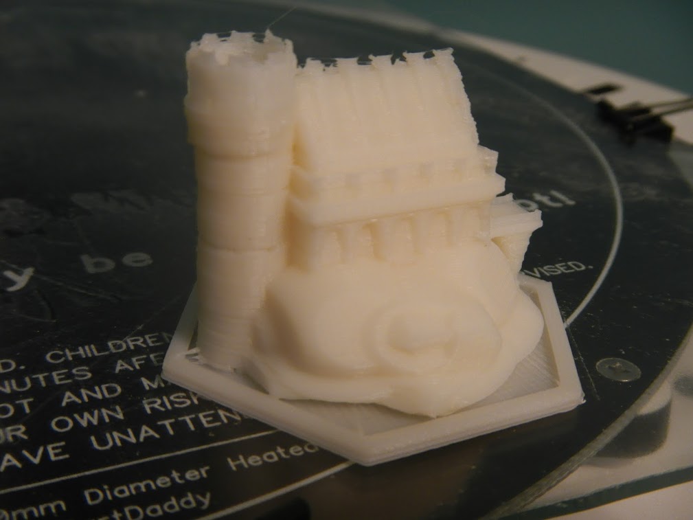

I decided to go brave again like with the Serge head I printed and print this keep from thingiverse http://www.thingiverse.com/thing:30463. I love how the base layers were printing, I was running it at 200% feedrate and it way laying down the plastic smooth as butter without infill issues!
[img]https://lh6.googleusercontent.com/-znoI ... CN9598.JPG[/img]
After the first 4 layers were layed down, I reduced the feed rate to 60% then went and watched some TV occasionally checking on it. I took some video I'll post in a bit, but here's some photos I have without any touchup
