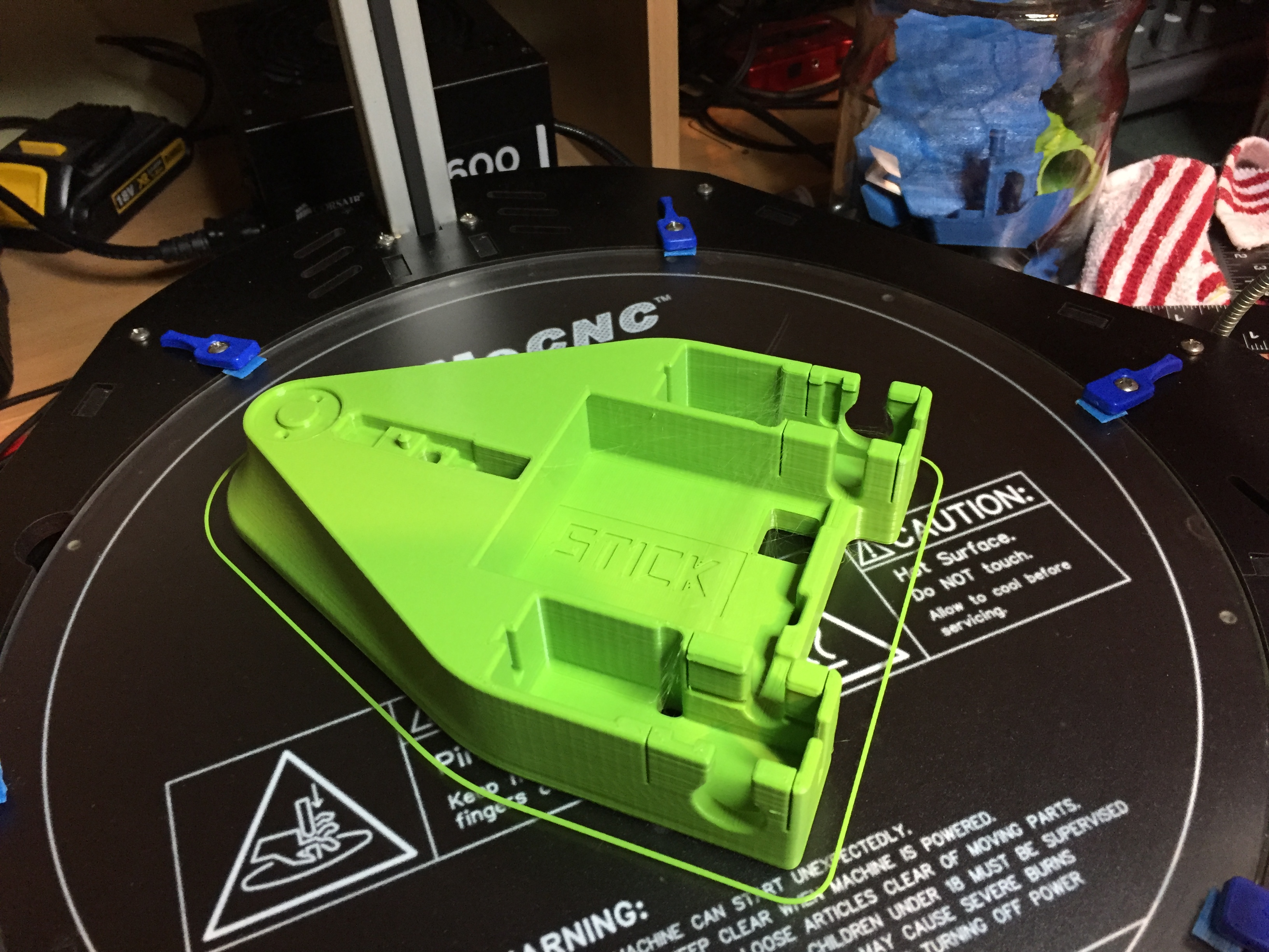

OK, after trying a heap of permutations with arms & hot end orientation, all fruitless, I came across a posting in the forums that vaguely implied that running G29 multiple times might be beneficial.
I ran a G29 five times followed by two iterations of the OctoPrint auto-calibrate. Now reading 0.9, which is, for now acceptable.
More to the point I can print a solid first layer across much of the bed!
The model I was trying to print came out OK first time.* OK, it has a few snots and some light stringing but dimensionally it's bang on.
Thanks to everyone that tried to help. It seems I was just being too thorough by resetting the EEPROM between attempts.
Zob
*well, second time, I forgot to remove the z-height adjustment in the slicer the on first run <hears mhackney saying "I told you so" ;-) >
