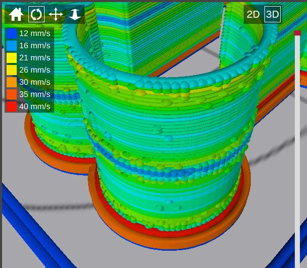

I'm curious as to if you have tried MatterControl 1.6
I've been using it since I built my V2 last year as I just haven't had much of a reason to use something else. However since the upgrade I am getting some strange results which make it rather unusable. Just wondering if it is me or if others are noticing as well. The picture below shows a print which would normally slice as a single perimeter after layer 5 but with the 1.6 upgrade it is plastering the print with a bunch of seemingly random extrusion dots and they are not consistent with the layers even though the part is consistent.

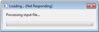

So I've been trying some of the recomended slicers and I'm really enjoying the cubic infil available with the Prusa Slic3r however I have an issue that makes it unusable. Whenever I try to load an STL of 1mb or larger it chokes and can't process the file. Some of these parts I am printing are admittedly large and complex but MatterControl, Cura and Kisslicer all handle them just fine.
Have you noticed any problems working with larger files?

Thanks guys, I don't think it's a resource issue. 12 Core 3.2 GHz Intel Xeon Processor, 24 GB Ram, 500 GB solid state hard drive, NVidia Quadro 5000, Win 7, Prusa Slic3r 1.31.2
I did find under Printer Settings > Advanced where you can set the number of threads and changing that helps load down the processor when generating G-code but it does not impact the initial loading of the file. The initial loading of the file is only registering about 8% CPU usage where as generating G-code I can get it up to 100% by changing the threads to > 12.
I did some more testing last night and I have found some files which are greater than 1mb and load quickly. The files still giving me trouble are ones which are larger than the build plate and would need to be scaled before being printed.

Ok, I was able to replicate the issue with something I could share.
The only difference with the two STL's is that the large one was scaled up 10x before creating the STL. The file size is the same, the amount of facets used to create the STL is the same. When I open the large one it is not able to process the file (error message shown in previous post). When I open the other one it loads in a few seconds.
If someone could confirm that they do or do not have the same problem I'd appreciate it.

I just tried the 'large' model, and it loaded and sliced fine for me.

Well, I figured out the problem and feel stupid at the same time. I was not using the latest version of Prusa_Slic3r. I was using the initial release 1.31.2 for some reason. I found the latest release on their github page (https://github.com/prusa3d/Slic3r/releases) and am now using 1.31.6 which is able to load the larger files just fine.
