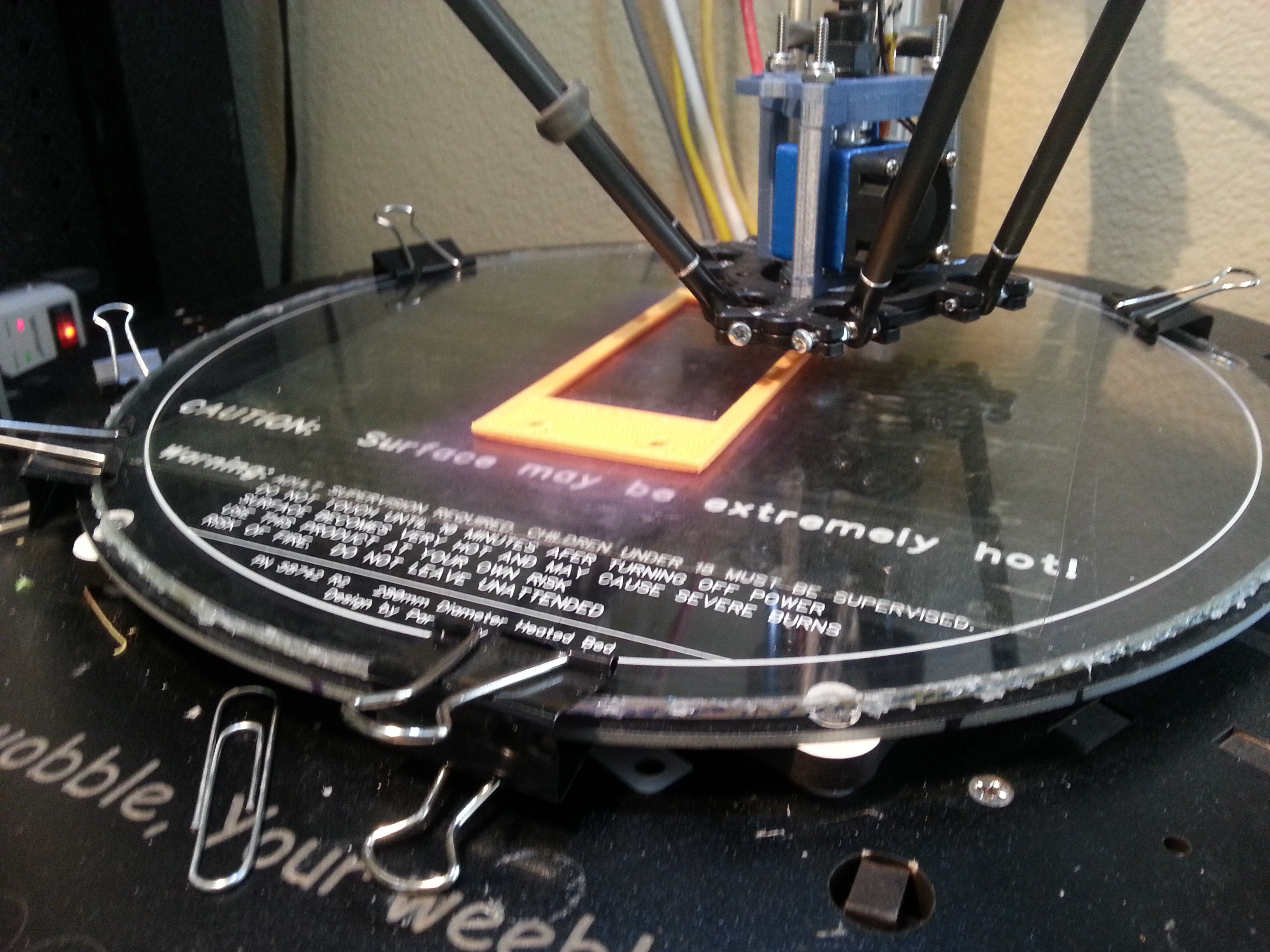

Adhesive-backed PEI trial.
I am printing JetPad's Top Mounted Ezstruder Holder Thingy.
First Print:
Glue Stick
70 C, .25 First Layer, .3 after
I got edge bad enough to stop the print. Mainly aesthetic curl, not structural.
Second Print:
85 C
Same settings.
I have about .5mm edge curl on one corner but not enough to stop the print.
I'll hang with this and see how long it lasts. Unless I want to really exact retribution on someone who parks really poorly, I don't have a good use for the other two sheets of adhesive-backed PEI...
Re: PEI print bed surface experiments
Posted: Wed Apr 09, 2014 2:56 pm
by mhackney
I'm confused - why are you using glue stick on PEI? You should be able to print directly to the PEI with nothing else and get fantastic stick and no curl. Are you printing ABS? If not, 85°C is too hot for the bed for PLA. I run 55° for PLA and 70° for ABS. Printing on hotter beds makes it very difficult to remove the part.
Posted: Wed Apr 09, 2014 3:03 pm
by JohnStack
I didn't have good adhesion at 70 with ABS.
I put glue stick on at 70 and had better adhesion.
I turned up the heat to 85 and had even better adhesion - but not perfect adhesion.
This is shiny side up...
