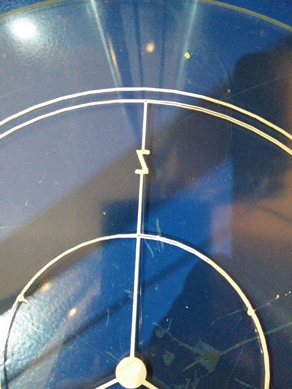

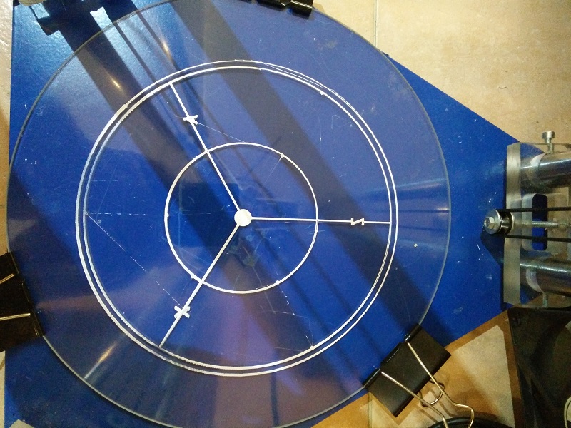

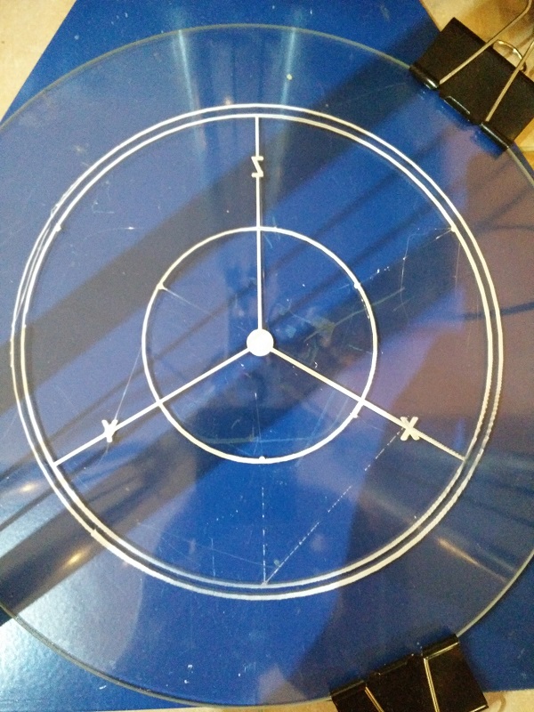

Here's a quick shot of the first layer of a full bed print at 200 microns. It is just about perfect, the first time.
I've been printing with the Rostock for about 2 years now, and full bed prints are always an issue.
Endstops and Z-Height can only get you so far unless your machine geometry is perfect, and mine has never been.
This print was started after using 626Pilot's custom calibration code, and it's about perfect on the first try.
Like "I wonder if my z-height is off by 25 microns, and would it make enough difference to restart the print" kinda perfect.

I had tested the g31 z three time with the same result.
I printed the test object with the frst layer with 0.3mm of heght and the result is that:
From the picture i the z axis there is the higher spot that became lower until the extruder touch the bed betwin the X and Y axis.
My bed is 260mm I used and calibrated only 200mm, my is a complete custom delta printer that is based to the original Jonathan Keep's project.
All part are made by iron and laser cutted, the carriage is built with ball bearing and there is not slack at all, the effector is printed and the arms is made by alluminium with traaxx joint
Please I need some help becouse I can't realy understand how is possible that the probe tell to me that there is only 0.031mm of error but when I print I have at the least 0.3mm of error, ten time the misured one!
I had tested also only the G32 and the G31 A with very similar result.
So I realy need to understand the origin of the problem, also because I need to know if had to destroy my printer :evil: !
Thank you

First, I noticed that the measured energy actually increased as a result of running the simulated annealing. That would result in a worse-than-default calibration. If you run it a few more times, it may eventually find a way to decrease the energy and get better. However, it might not. An energy of less than 0.1 is not too bad, really, and I would say 0.05 or less would be optimal. Yours was 0.66 - not too bad. There is a bias in the annealing process - it anneals each variable in a particular order, and I need to figure out a way to let it experiment until it finds the best order. Best way to reset everything is to run G32, which will do a GeneB-style calibration of the endstops and delta radius. That command dumps all the custom offsets that the simulated annealing tries to tune. In fact, I usually get better results from annealing if I run G32 first. It gives the algorithm a better starting point.
There is also some order-randomizer code I put in there, which is live on GitHub, but which should be commented out as the default order seems better than a random order: https://github.com/626Pilot/Smoothiewar ... .cpp#L1062
Put // at the beginning of lines 1062-1070 to turn off the randomizing code. Maybe that will help it run better on your printer. The randomizer will be removed in the next version so it won't be necessary to comment it out.
OK! Second. You calibrated out to 200mm, which is OK. But I have the .stl you're using (Onyx Bed Level Aid) and it's more like 260mm across. The firmware projects the measured depths from that 200mm circle outwards, so it thinks the depth at 250mm is the same as the depth at 200mm. (Which is the safest assumption I know how to make, as delta math is non-linear. Other guys' firmware just stops correcting if you go outside the radius!!!)
Ideally, you would calibrate out to 280mm or whatever your diameter is. But as the probing grid is only 5x5, this would be kind of rough. It makes it harder for the annealer to do its work when the sampling points are further apart, and it also makes the Z correction (G31 A) rougher. I do have an upgrade in the works that will increase the size to 7x7 or even 9x9, but it requires migrating a lot of stuff that uses memory to a secondary bus. (An annoying vagary of the processor they chose to use - the RAM is segmented into 3 pieces.) The migration is done, but there's a bug in the allocation of 2D arrays that I have to fix before I can publish the code. Therefore, at the moment, it is necessary to trade off between a smaller, better calibration that only works sort of OK for large pieces, or a larger, less precise calibration that will at least let you print big things sort of well.
