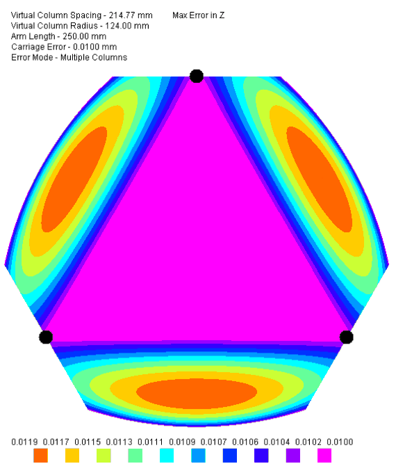

The image you posted is interesting. Is this something you created yourself? Or is this derived from mathematical computation? This does seem to be somewhat representative of the problem... though the perfect triangle shape in the center is interesting.

The image came from a mathematical analysis of positioning errors in delta printers. The author has since taken down the source material. He created a virtual delta printer in Mathematica and then had it raster-scan back and forth across the bed with various simulated problems with the printer's geometry. The inside of the triangle is nearly perfect because there, the math works out properly. When the effector is no longer between all three towers - when it has to go "outside the triangle" - you get this.

Oh yes, I found the paper. I've attached it to this post for easier reference.
I'm not sure if the paper is quite describing the problem you are having. The picture you posted shows only a 0.012mm error in the Z axis, with one of the setups. Also keep in mind those points that represent the towers are truly the center of the towers... [Edit: Hmm I'm not sure if those points are "virtual columns" and not the centers of the towers. Still... I'm not sure if this accounts for the magnitude of error required to prevent layer adhesion.]

The simulation is done on a generic virtual printer with different geometry and an arbitrary amount of error. Neither is accurate to a Rostock MAX, so there is no reason to expect the same level of deviation.

Okay so you are saying there is enough excess tolerance in the max design to account for increased error in the "hot" zones? That seems plausible... but what errors in tolerance, specifically, do you think would account for that manifestation?

My reading of that piece what's the error I that diagram isn't from simulated slop, it's from the fact that steppers have fixed resolution and as the arms move away from the towers basically Z accuracy suffers, by a small ammount, what's misleading is the big flat area in the middle wiphich is also curved, but the author is truncating to 4 decimal places.
