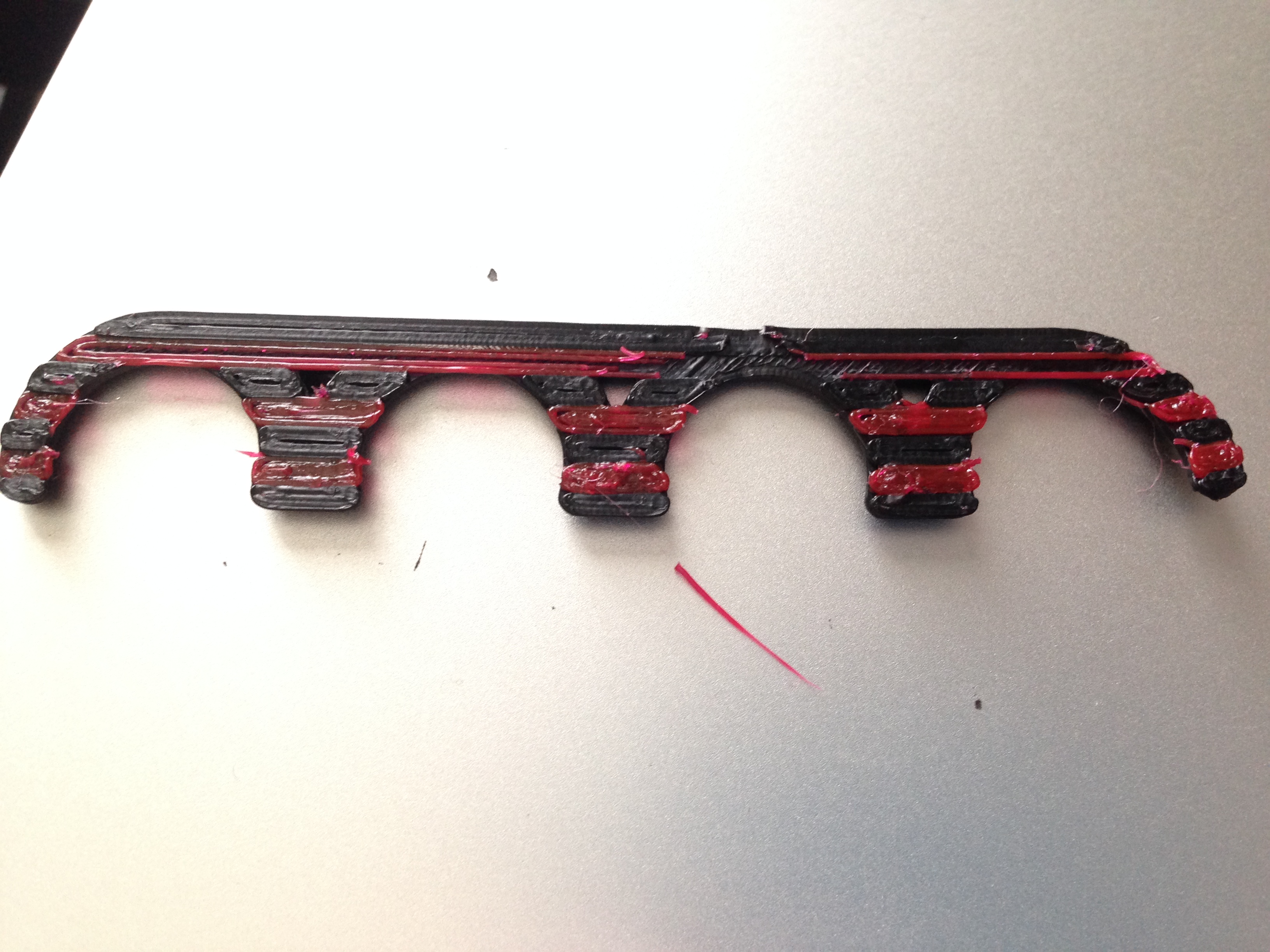

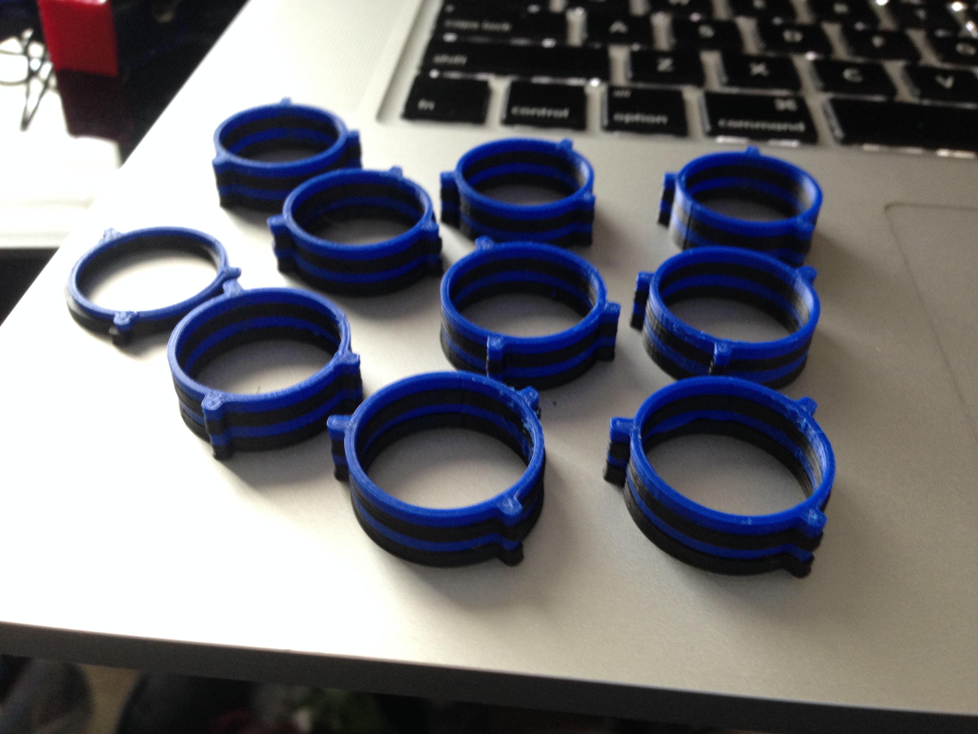

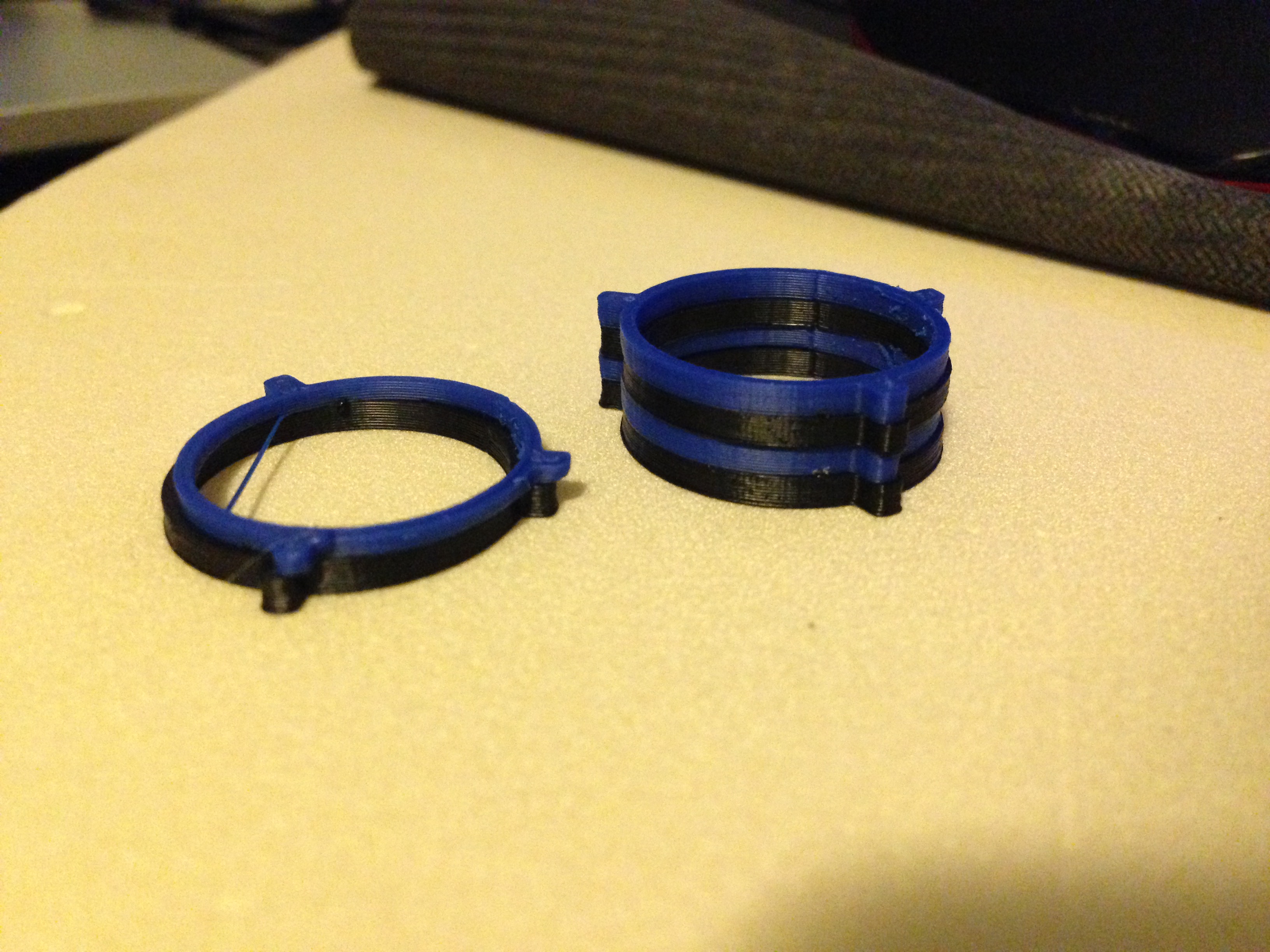

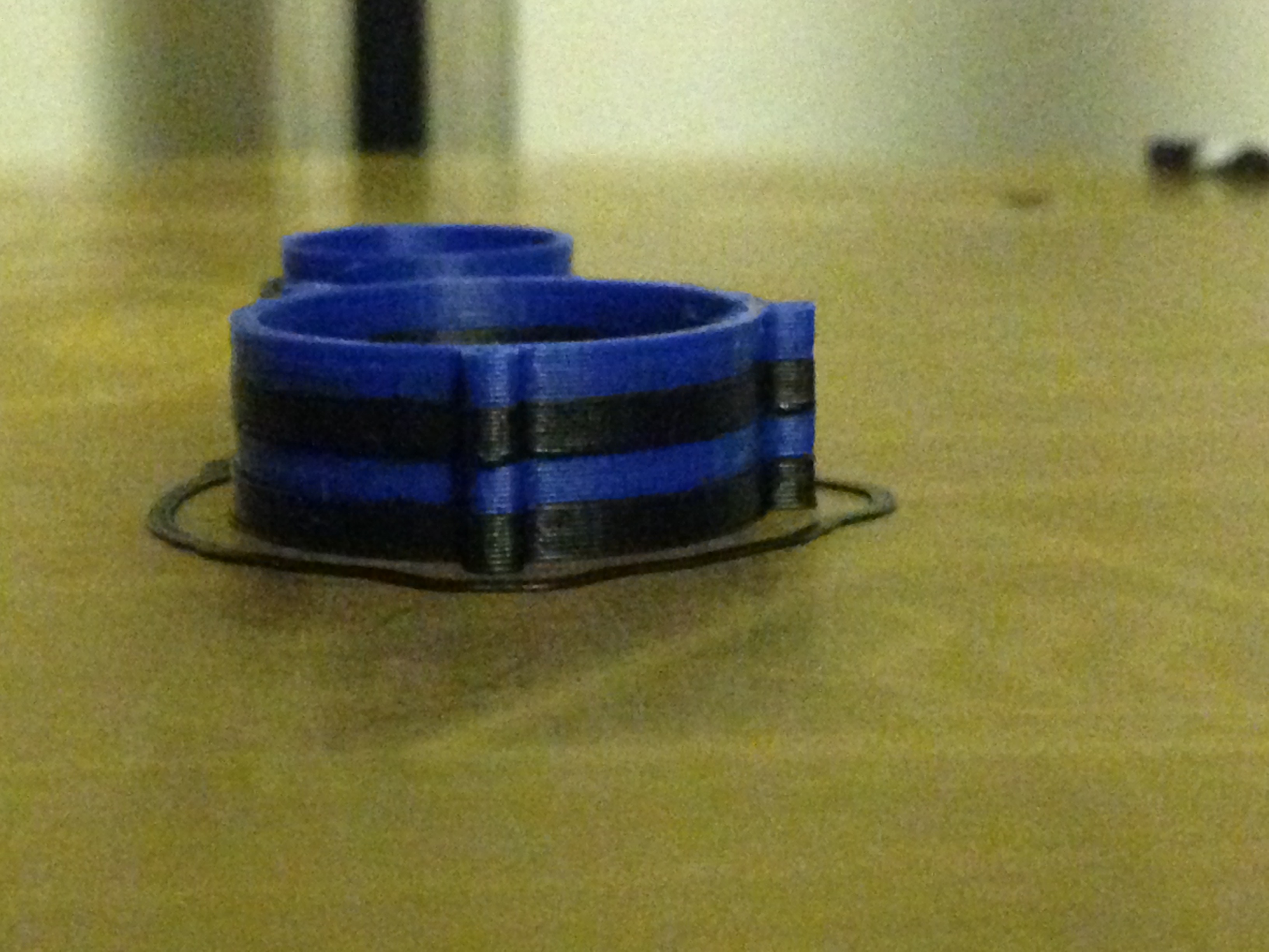

Getting some great results with dual color/material prints! Turns out, Ninjaflex sticks rather well to ABS, good news for myself and one of my clients.
First Attempt
First Attempt
I had two failed attempts (one being my fault) before it turned out. I had to turn off retraction on the Ninjaflex, even with the shortened tubes retract really doesn't work with Ninjaflex. It also oozes to hell, I was having it dribble all over during extruder changes. Good thing I updated KISS, it wouldn't have survived without the wall. Don't want to share the successful print pictures in case my client doesn't want this spread around too much.
These were from last night:
Tuning the offsets
