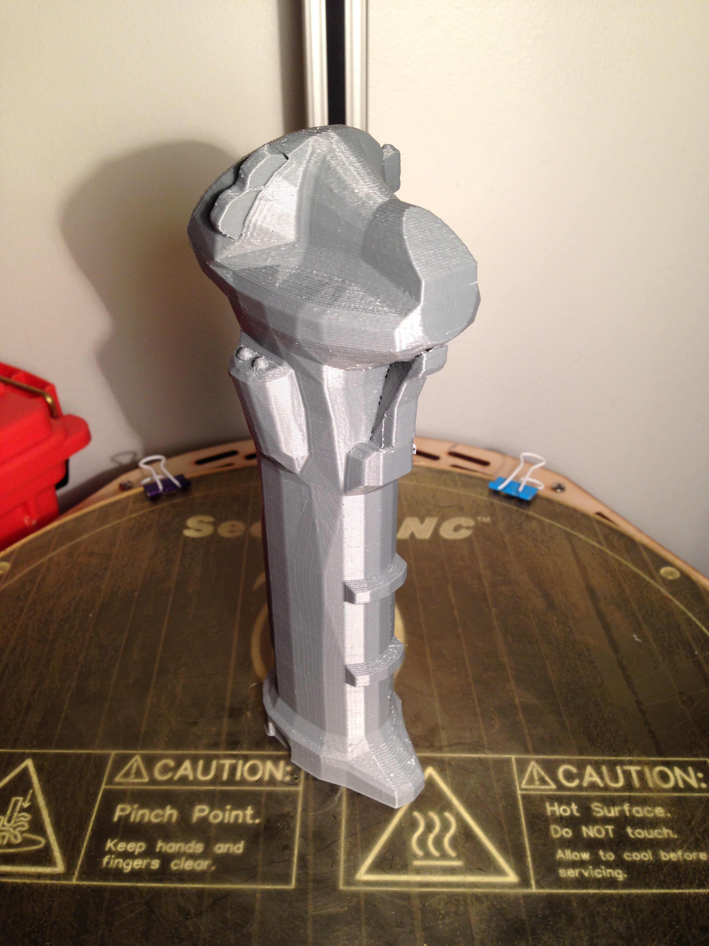

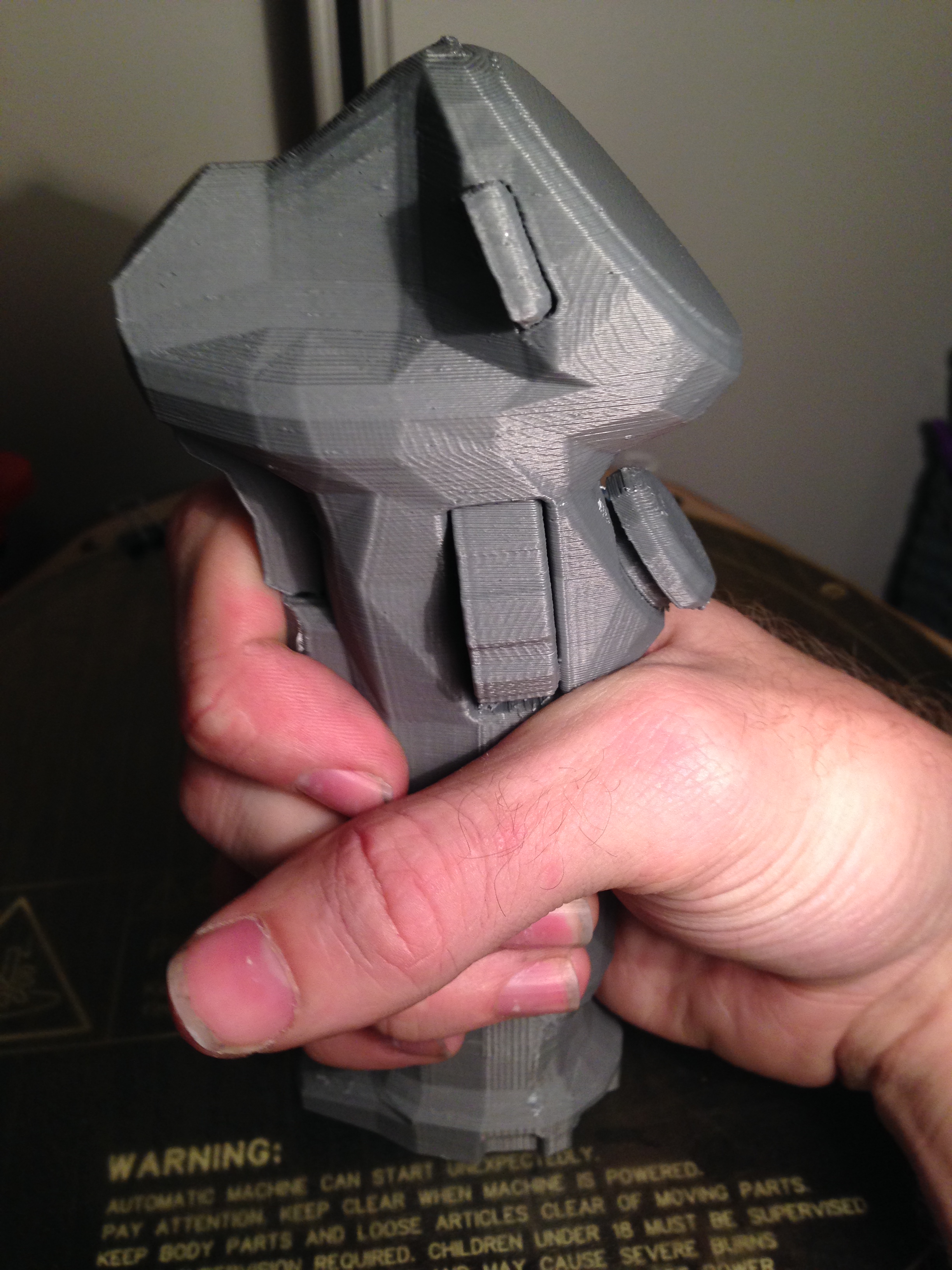

The new nozzle works great. Did my first money print with it, turned out awesome! I'm sure the customer will love it, I don't want to part with it tbh..
Took 11 hours. I slowed down the inner perimeter and infill speed to 45mm/sec and the temp was 250C. Probably could get away with a bit lower (one of the overhangs kinda sucks, but it looks good most everywhere else)

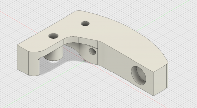

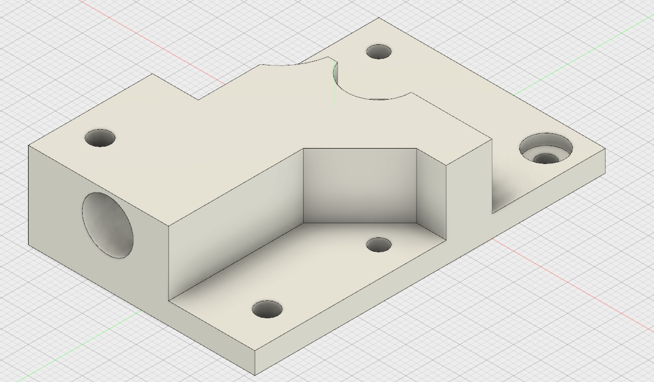

I'm working on an extruder design to fully constrain the filament from the drive gear to the hotend. I printed off a first prototype tonight and its working alright. Its going to use those BSPT fittings that everyone seems to have 15 of from all these E3d orders everyone makes (I have like 10 at least). Preliminary design allows the tube to come right up to the hobbed gear and the bearing. I'm designing it to use 608s, I have an excess of these, and I'd prefer to not repurpose the default SeeMe arm tensioner just to use it. I'll release the design on Repables or Youmagine when I gets it done. I'll include the 360 files for it too if someone wants to modify it to something.

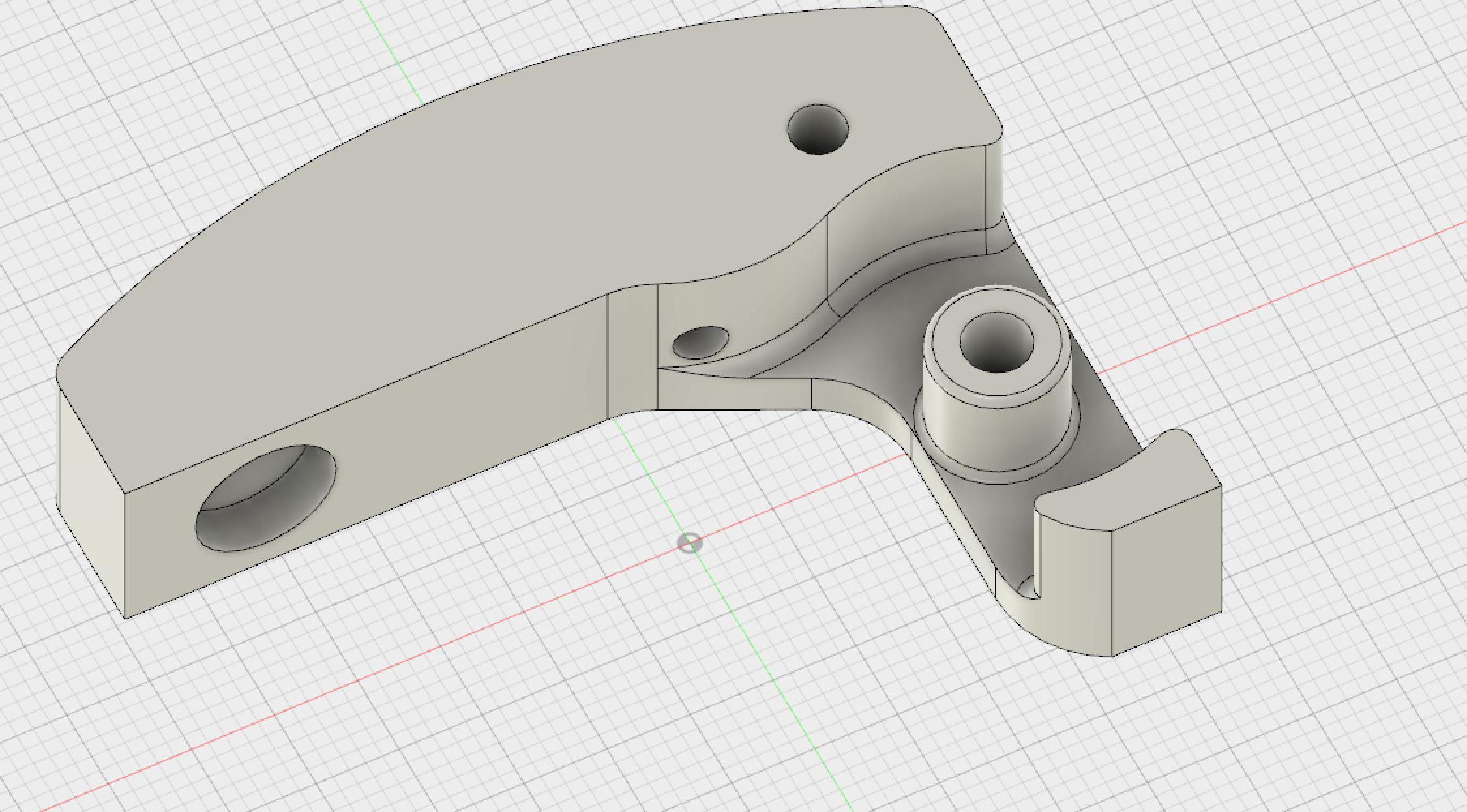

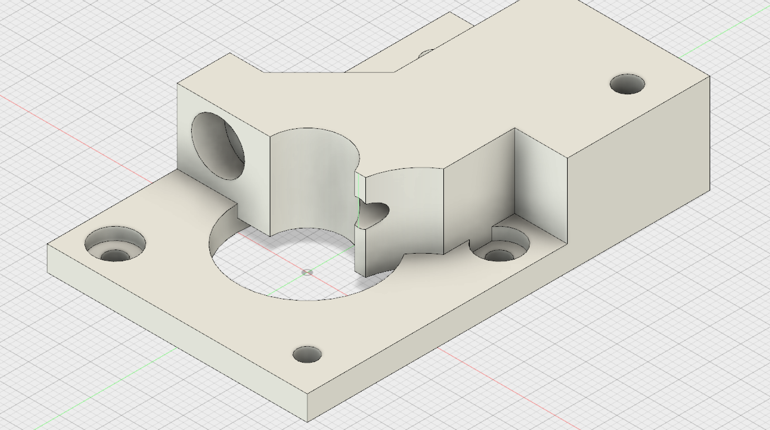

I was looking through thingiverse trying to find a good bowden extruder that even partially constricts the filament path up to the drive gear, and there wasn't really anything that I was impressed with, so I decided I should make my own. I'm on V3 of the body and V2 of the arm. They are printing right now, hoping that I get close enough with this version to actually use it, but I think I've got the spring compressed a bit too much still.

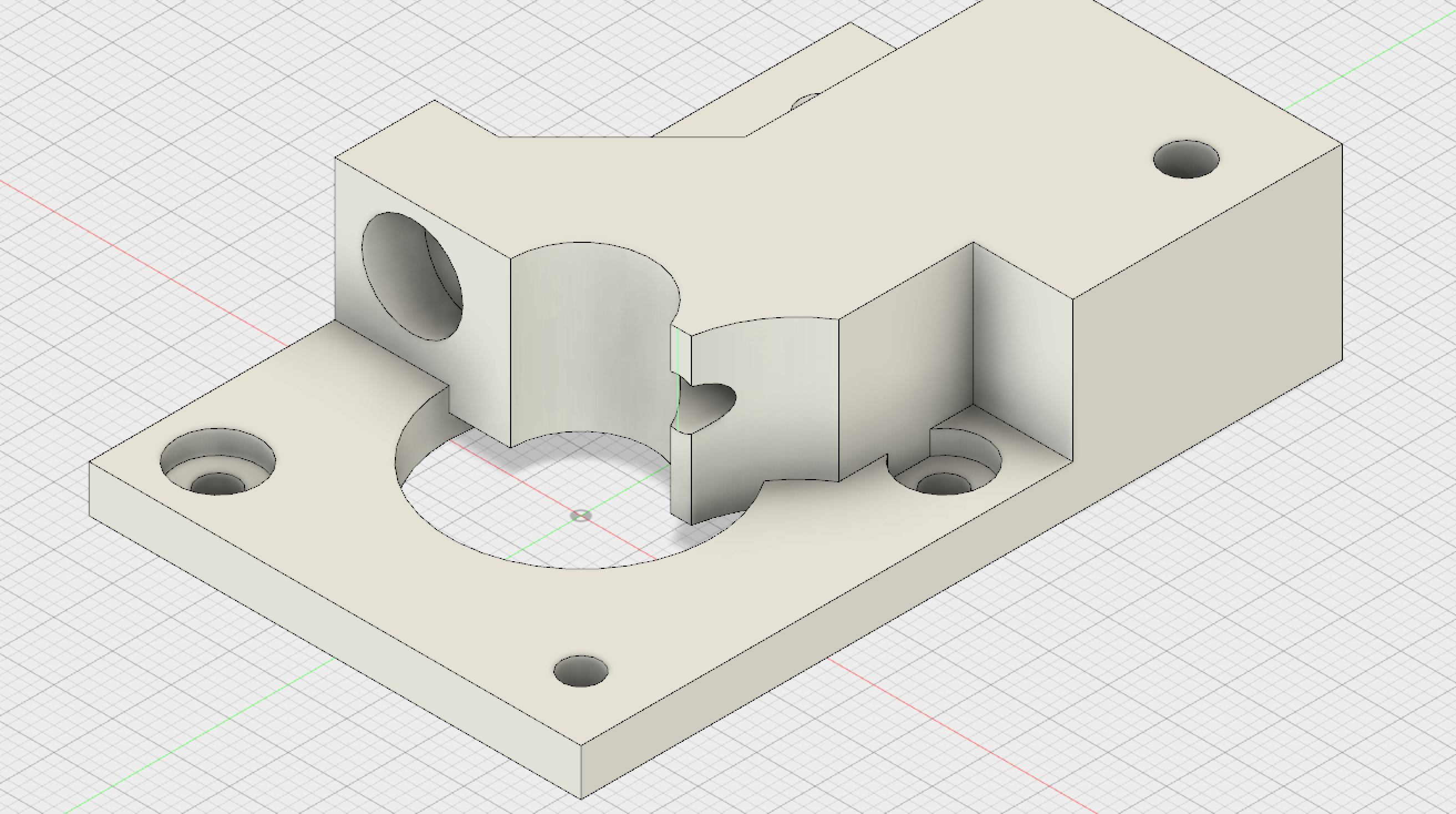

My main goals for the design are working out though. #1, the set screw on the drive gear is accessible even with the extruder on. #2, the filament is fully constrained up to the drive gear, and it is a straight shot of teflon from there to the hotend. #3, It uses the E3d couplings that they give you for any hotend order, so no need to buy anything too fancy (also helps with the tube passing through).
I have mine set up to use a 608 bearing, I have several of these from another printer I disassembled, and I'm mainly developing this for a Mini Kossel I'm making for my schools tech department (thats why I was searching thingiverse in the first place). The end design goal is to have 2 versions, one useable with a custom printed arm and 608 bearings, and one useable with the default stock arm with the stock bearing.
The version I have right now (V2 body V1 arm) has a really nice smooth filament path, but the arm is too weak and it broke when I tried to add the spring. I beefed up the arm a bit, changed the angle that the spring comes in, and made a few other minor tweaks for V3 and V2. When I first started work on the arm I accidentally made it inverted. I extruded something out one side instead of the another because I was too lazy to redraw everything, so currently the source file for the arm is inverted, and I doubt I'll get to fixing it since its so easy to change that in Cura.

I did know about Repables. The interface is a bit more clunky feeling than Youmagine from my experience but the content is pretty good. I know SeeMe is pretty close with the host/creator person/people, does SeeMe actually help host it or is it separate?
Back to the extruder, I'm thinking of naming it the EZFlexstruder, since it is inspired by the EZstruder. I'm going to go with the title V3 since V3 body and V2 arm is a bit confusing. V3 just printed, I still need to adjust the spring positioning and angle (I angled it out instead of in so I loose some tension) but it works! I have it set up on my second extruder, V4 (or 5 or 6 or whichever one I like the best) will go on my primary extruder and then work its way down the line. I may need to completely redesign the arm, I'm a bit worried about it holding up over time, but it should work for now.
I'll upload an stl of both files in the correct orientation if anyone want to give it a try. Its pretty easy to set up, you will have to do what I call a "high school student ream" or a "poor man's ream" with a 3/8" drill bit in reverse at the highest speed for your drill for the E3d coupler to not crack the part. Also the 4mm hole for the bowden tube that goes up to the drive gear and bearing should also be reamed. Thread the E3d coupling on straight (make sure its straight or it will break your part) and get it most of the way in. If it start getting to the end with only a mm or 2 left and you start to hear cracking of the part then its probably good enough. It likely won't wiggle itself loose over time. Then you'll need to shove the teflon tube up a bit past the end of the hole (the end that the drive gear is on) and use a razor or exacto blade to trim the tube at an angle, flush with the curves of the extruder body. I trimmed a tiny bit off of the top so I wouldn't run into any issues with the tube buckling against the drive gear or bearing, and also to make feeding filament into the extruder easier.

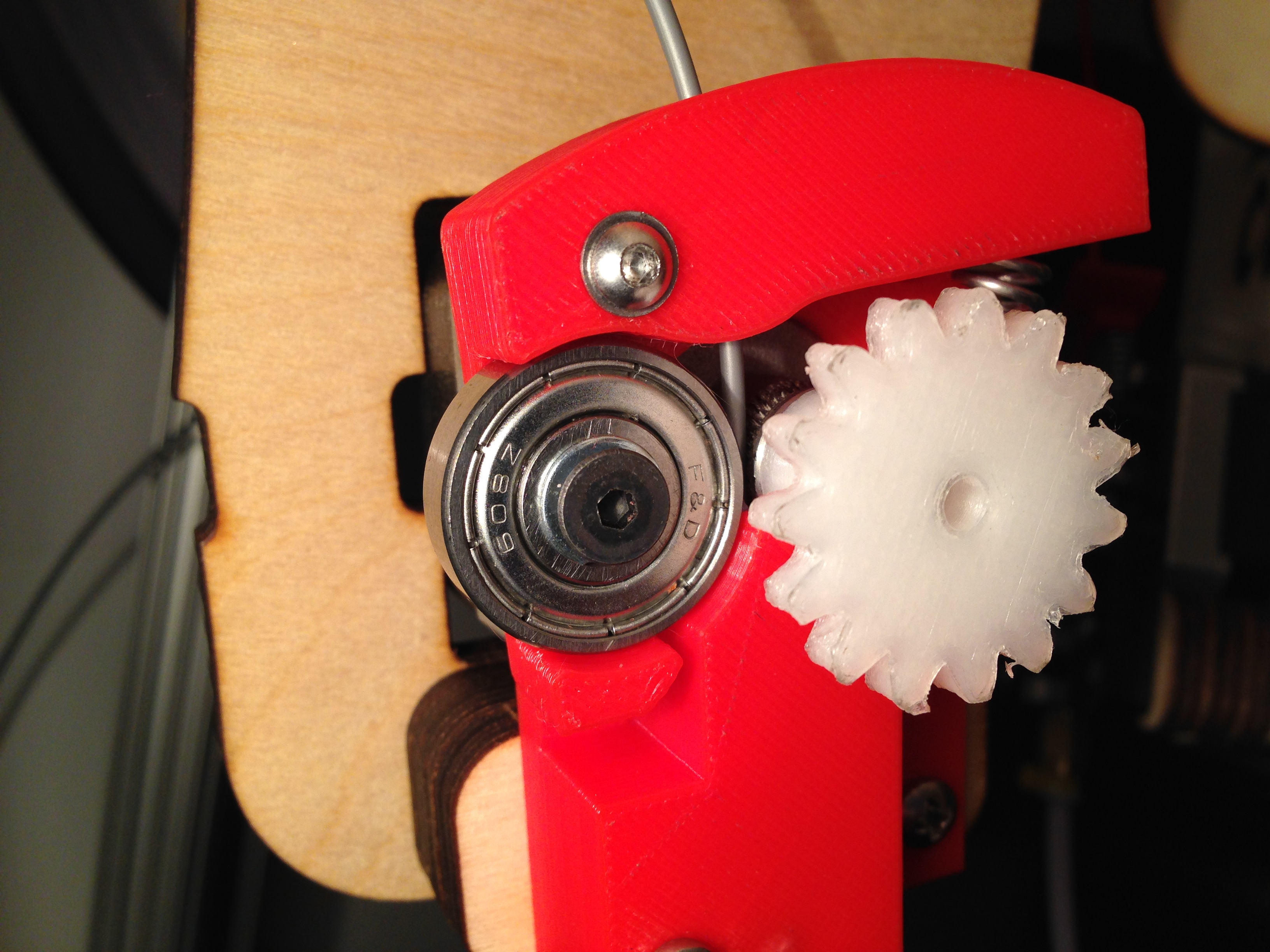

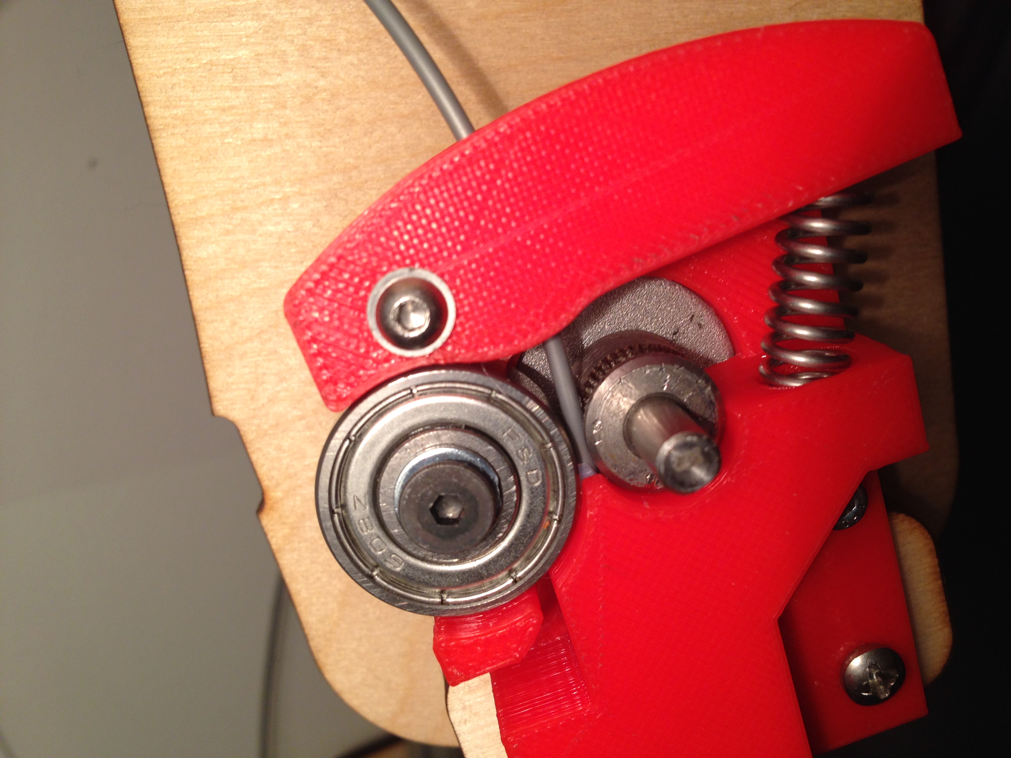

Feeding filament into the extruder is actually really easy. You simply slide it through the hole in the arm and it goes pretty well right in between the drive gear and bearing. I powered the stepper and both hand spun the motor and ran it via software and it runs the filament pretty nicely through. If I correct the spring angle and positioning it should be able to apply more force, but even as is it doesn't slip very easy. Keep in mind there is basically zero testing with this so if you do use it use it at your own risk.
I have the bearing attach to the arm via a 10mm M4 bolt. A washer goes over it and it keeps things nice and tidy. The whole thing is designed as a drop in replacement for the EZstruder, so it does fit the same profile. I only have the body attached via 2 M3 bolts. One is a 10mm with a washer, since the body is just to small for the 10mm bolt to work by itself. The other 2 mount holes need something like a 6-8mm M3 bolt, which I don't have. The arm (and other corner) are held on with a 20 or 25mm M3 bolt, I'm not exactly sure on size. There are 2 washers, one in-between the bolt head and the arm, and one in-between the arm and body. When attaching the arm to the body, you'll want to make sure you're putting the spring at the same time or else you will break it trying to put in on after. This does lead to some funky positioning to try to get it on, but it will work eventually, and you'll end up with a nice looking extruder like shown.

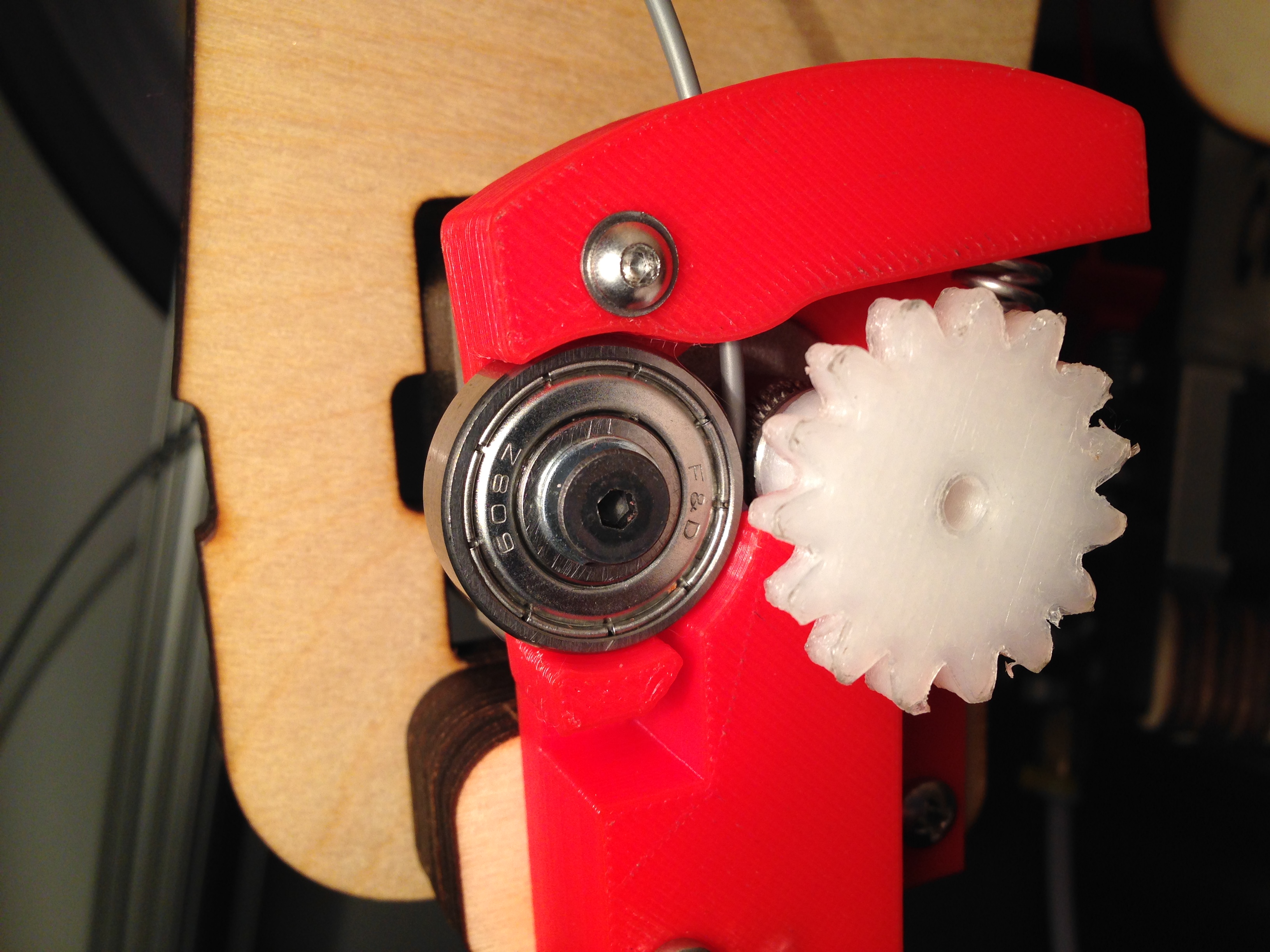

I'm going to swap it over to my other extruder and try it out today. So far it seems promising. Ive got a 10 hour print in ABS that would be a good test for it.

2 hours into the 10 hour print and things are going A-Okay. Its 6 objects spaced out so there are plenty of retracts. Its feeding pretty smooth. When I get done with this print and another I'll get to V4, changing the angle of the spring and beefing up the arm yet again (not that its weak or anything, just figured I have more space so why not)

Really the extruder is working flawlessly. Just did 17 hours of prints for a customer, and even printed a new extruder set. Everything it turning out real nice. I'm starting 13 hour print now, confident it will turn out fine. I think I might re angle a the spring hole on the arm and beef it up a tiny bit more but its working pretty great. Sometime this weekend I'll get to making a version that works with the EZstruder arm.

The extruder is still working great. Ive had almost 40 hours of prints on it and no issues. It actually takes quite a bit of torque for it to slip. I really am liking it quite a bit. Going to put it up on Youmagine and Repables.
