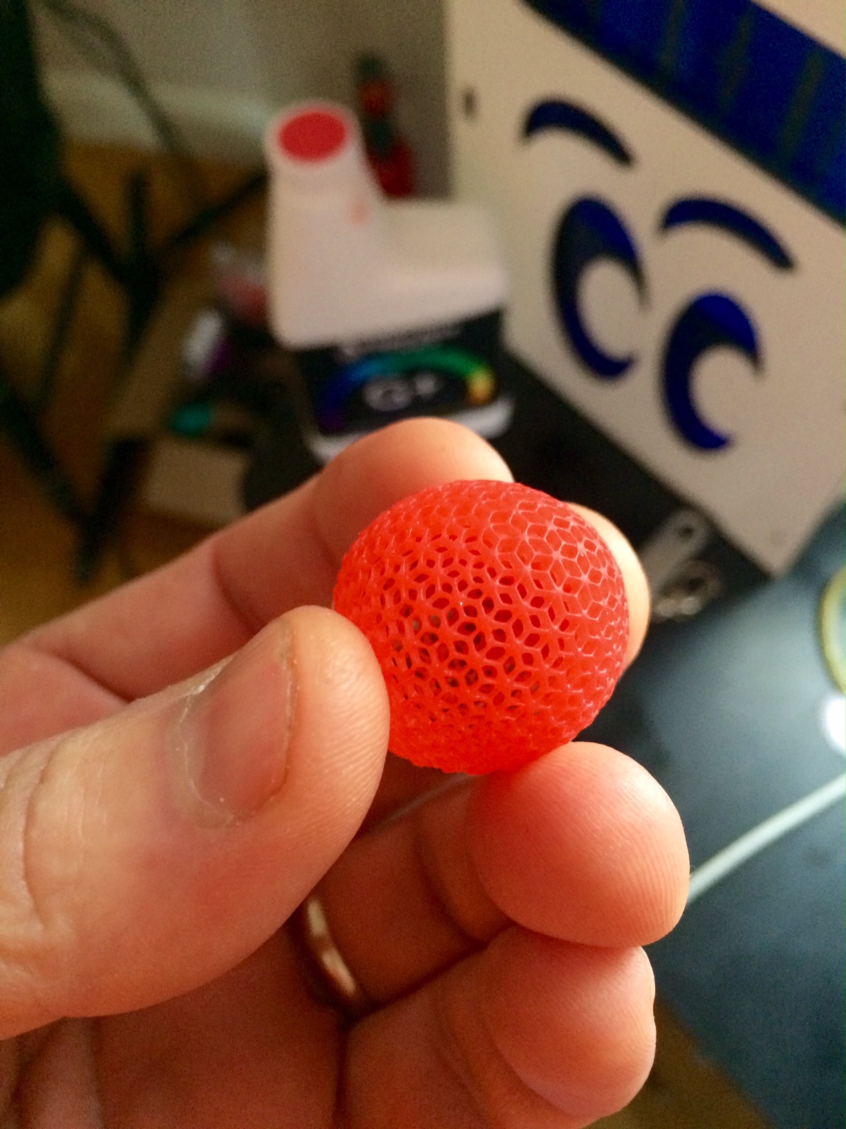

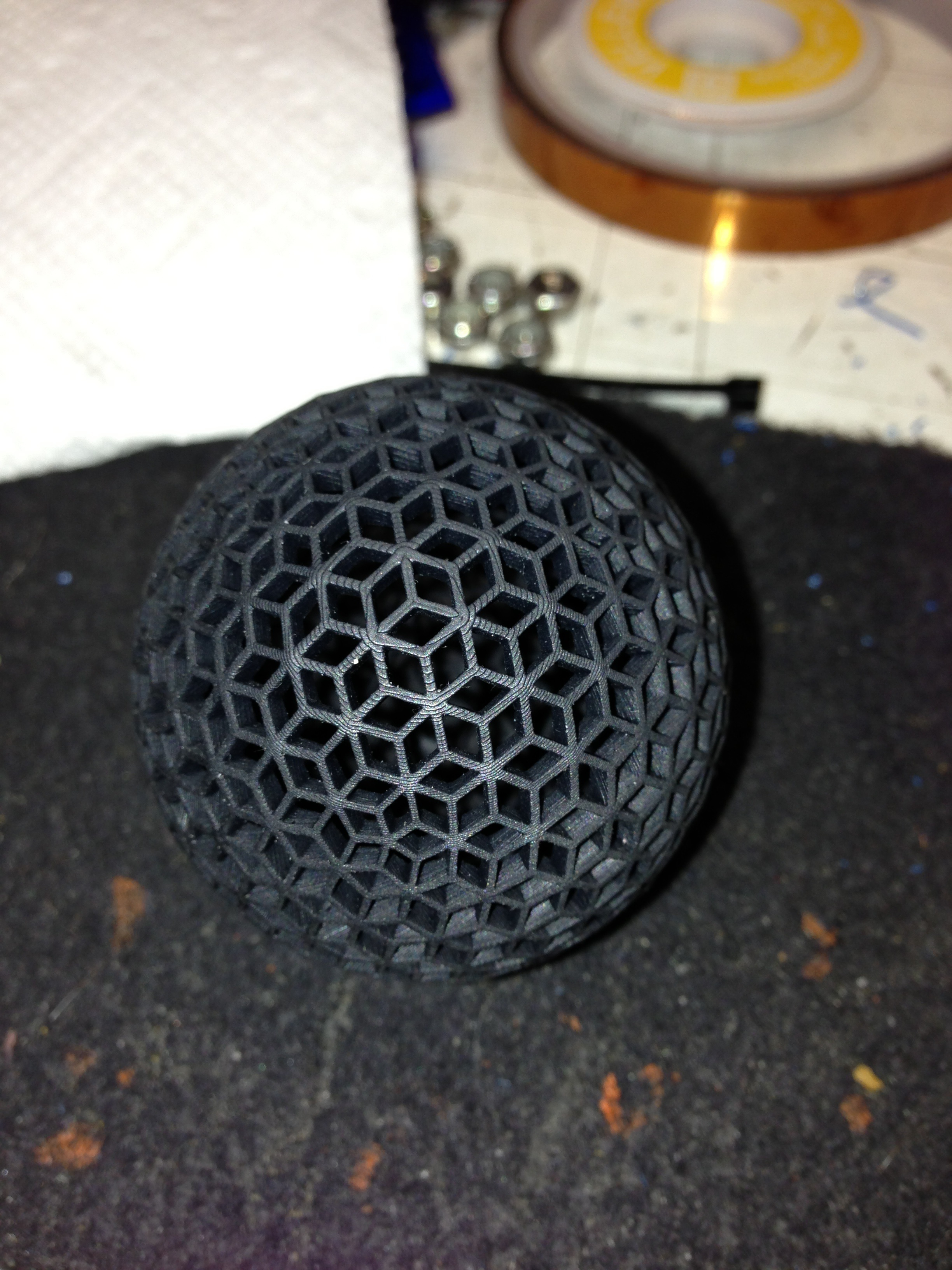

gettin there... fyi blue is the hardest color to print, I've found that it either doesnt expose, or it over exposes, and there really is no in between... they may have changed formulas up some since last I got some, but pretty much any other color I've had better results with.
Heres the last thing I printed on the droplit, which I believe is the same model you are printing..
Guanu
Re: mhackney's Beta DropLit build
Thanks and yes I got feedback that blue is more difficult. If course that would be the color I started with! I am going to print in red today with the same settings and see what comes out.
Yes, that is the same model, pretty cool looking, that's a nice print.

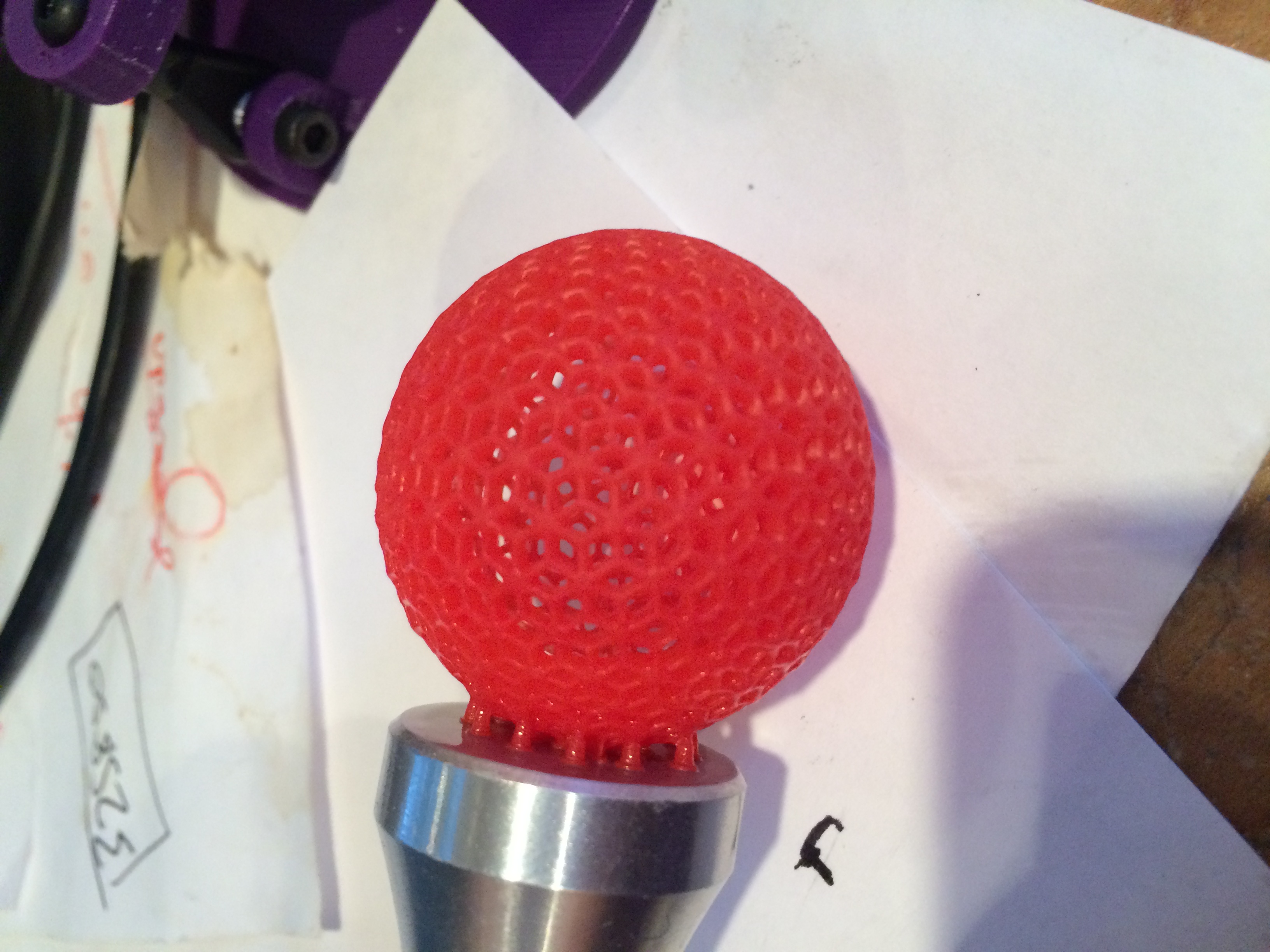

Yes, the red is easier to print! I didn't change any of the exposure or projector brightness and this part came out pretty nice. I'm printing a bigger one now.

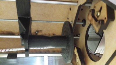

Time for some DropLit mods!
Now that my DropLit is printing of course my mind turns to ways to improve it! First up is that tiny little platform, it's about 1" diameter. I realize that as print surface area increases, the part sticks to the bed material and may separate from the platter. All sorts of interesting mechanisms are used to break the part free from the bed non-stick surface, like the tilting vat. The other item that seemed a bit challenging was making sure the movable print platter is perfectly parallel to the non-stick surface. If it isn't, parts may not stick or partially stick. So I had an idea to address all three of these in one mod! And here it is...
The Hackney Passive Tilt, Manual Auto Build Platform Aligner, Large Platform Thing (THPTMABPALPT for short, pronounced thptmabpalpt). If it works or partially works, I take full credit for it.
The device is printed in PLA, here it is in lovely purple (I was going to name it the Purple Plater Placer but like THPTMABPALPT better).
[img]http://mhackney.zenfolio.com/img/s10/v1 ... 0195-4.jpg[/img]
As you can see, it is a drop in replacement for the stock aluminum dumbbell:
[img]http://mhackney.zenfolio.com/img/s5/v13 ... 0416-3.jpg[/img]
How does this device do all of that (THPTMABPALPT) in such a small package you ask? Here's how...
Lets start from the bottom up. I started with a piece of 64mm x 48mm x 2mm aluminum as the new platter. This is glued to the base (purple block in photo). Altogether, they are about 10mm tall so they can submerge into the vat of resin.
Next up is the manual-auto adjusting leveler. I used 3 Traxxis universal joints - the exact type folks use for mini kossel arms. These are mounted to the round sub platform at their u-joint end. They have about 10° of freedom all around. Above this is the mounting base. It has three holes for the Traxis arms to pass. A spring under each keeps the whole unit "pushed down". The cap screws and washers at the top of each Traxxis keep the device from spontaneously disassembling. The magic is the three Nylon thumbscrews. You can clearly see one but each arm has one. This entire unit is affixed to the DropLit with a stunning purple "short dumbbell".
To use you simply loosen the three magic thumbscrews. Then lower the Z down until the aluminum plate touches the non-stick bed surface. At that point you go down in small increments (.1mm) until all three springs are slightly compressed. Lock the Traxxis units in place with the thumbscrews and you now have a completely aligned/parallel aluminum build plate.
In operation, after the exposure, the unit raises on Z. The solid plastic ticking between the bed and platter cause the springs to compress as it platter unit rises. The bed tilts ever so slightly, resulting in breaking the part free from the non-stick surface (that's the theory I'm going with). This repeats over and over and over again as the part prints.
I am running my first print with it now, I have no idea if it will work. I'm mostly concerned about the sticking to the non-stick surface and not sticking to the aluminum bed.

DropLit Adjustable Platform STLs
Ok, I've made 6 prints on the new platform and call it ready! Large surface area prints are a problem - but that's the Achilles heal with SLA printing. Sort of the opposite of the FFF problem of getting the first layer to actually stick.
Here, without further fanfare, are the files:
DropLit Adjustable Platform.zip
(295.84 KiB) Downloaded 467 times
You'll need three of these Traxxis Rod Ends: https://traxxas.com/products/parts/5525
They are the same part used for Mini Kossel arms.
