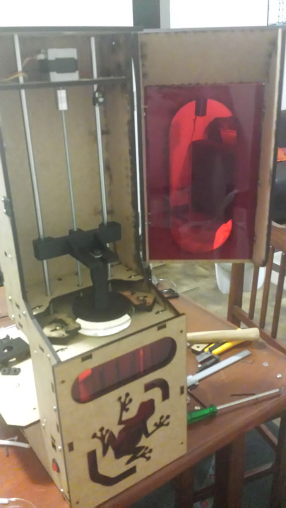

Re: mhackney's Beta DropLit build
Posted: Sun Feb 15, 2015 1:57 pm
by vonhellsing
i change UniversalGcodesender per Grbl Controller 3.6.1 from zapmaker, i did some configs and now motor works smooth (i hope) kkkk
now i need a stella artois ( when i travel to USA i need paid some beers to u :mrgreen: )
than back step motor to my FrogLIT kkk
cheers!
