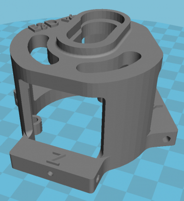

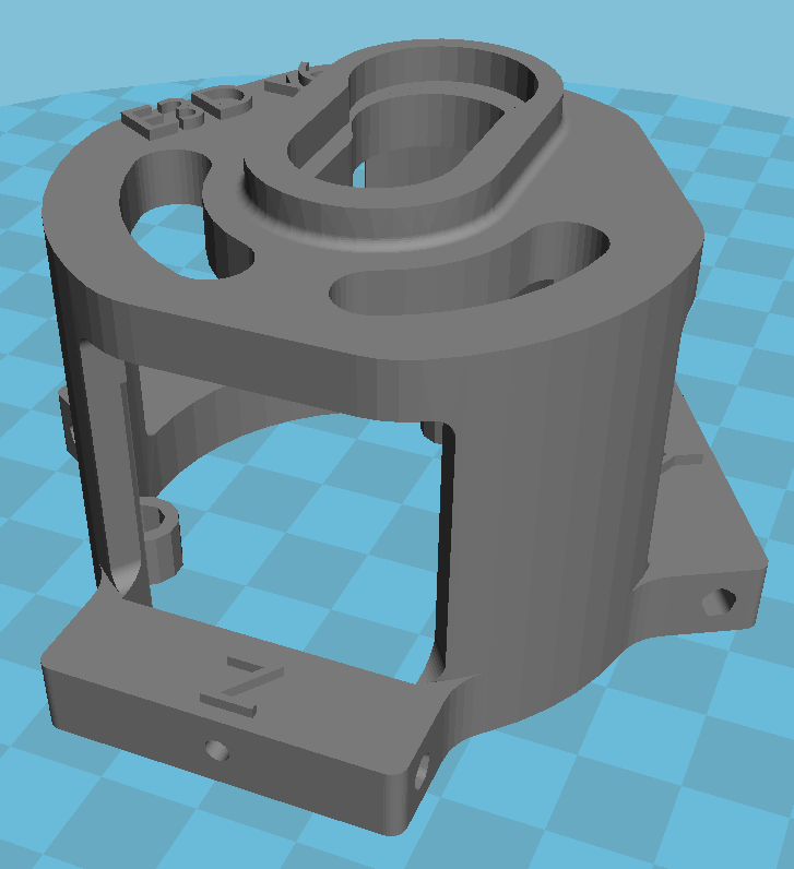

BONE wrote:Here's my latest one. Going to print tomorrow or this weekend and try it out. The model is rough and I just hacked it together to get a prototype made and fit up all the parts. I plan on cleaning up the fillets on top of fillets and making the styling smoother at a later date. Dimensions are on the tight side, so some filing and fitting up of components may be needed.
On the outside.
- Rod holes are 2.80mm, so drilling and reaming needs to be done ensure a proper fit and clean out rough edges. Suggested not to print support inside those holes.
- 37mm dimension between flat to maintain the distance needed for stock joints or Trick Lasers.
- 30mm layer fan mounts to the outside.
- Use the Yellow Jacket E3D v6 mount for holding the hotend in place. Yellow Jacket Board can sit on top of the mount.
On the inside:
- Mount the layer fan duct to the inside using the screws that mount the fan. (Duct yet to be designed or design your own)
- Use the 3 holes on the bottom inside to mount the Trick Laser LED ring. Un-solder the wires and flip them to the inside for a cleaner look.

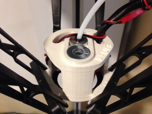

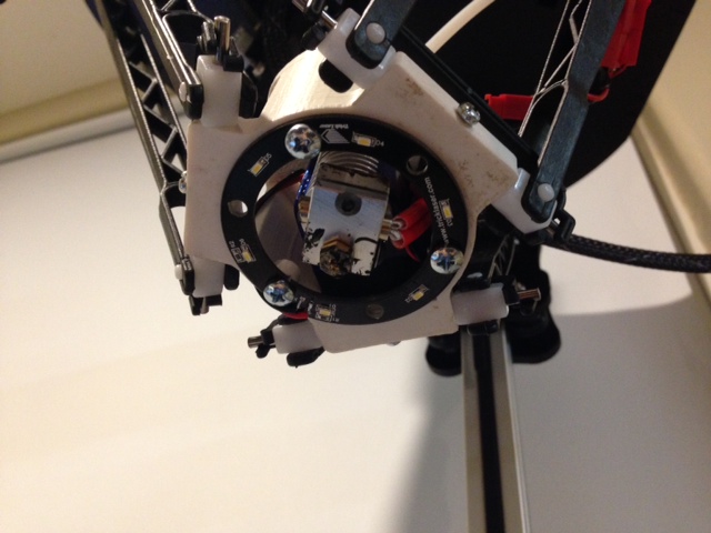

e3dv6mount.stl
(408.38 KiB) Downloaded 492 times
Thanks to the original files posted by eatoutmikey, we were able to modify it just a bit to fit our needs. We're printing Bridge Nylon with an E3D v6. We modified eatoutmikey's original file to include screw mounts on the bottom for TrickLaser's light ring, notched out a bit more space for the blue fan mount on the E3D v6, dropped in some washers on top to hold the hot end in place, and also put in a couple set screw holes along the effector axles since they were never quite as tight as with the injection molded stock effector. Thanks eatoutmikey! It's working great.

Brendon, nice job with that light ring.
Lot's going on here, I need to jump back into it. My new job has been slowing me down this week, so I need to get back into some design work for the platform.
