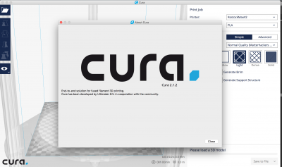

New version: 2.1.2
New version: 2.1.2
This new version looks really nice, and it has a TON of settings. I just downloaded it tonight but I will be trying it out pretty soon here with 2-3 printers. With Jonathan from KISS going AWOL again, Cura seems like the next best thing to me, and this new release has a lot of potential. Over 200 configureable settings and several really cool experimental features make this quite exciting. I'll spend a good while working with it to see what all it can do. If Michael or someone else has any advice on what to try to print while dialing in settings it would be appreciated.
Re: New version: 2.1.2
Its still essentially a beta release. The pathing looks nice and most features work, but the support for multi extrusion isnt yet implemented (looking on forums and github its in the works) and there is no support for custom printer sizes (only pre defined printers, like the ultimaker lines and a few random ones) or delta printers as of now. I found a forum post explaining why, no one at ultimaker has one (deltas were implememted by an outsider for earlier versions), so they cant test, but one of the leads is willing to work with delta owners to develop support.

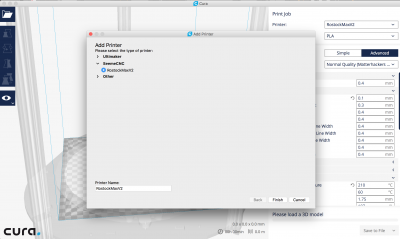

I have been playing around with the latest release of Cura and I agree there are a lot of great settings to play with and a lot of potential. I am fairly new to 3d printing but have a programming background so I wasn't afraid to take a stab at the json files and configuration to make the Max v2 work with cura since it seems support for delta printers was removed in the last few updates. I actually got it so I could add a custom printer profle, and slice and start a print, but that is where I ran into some issues. I'm working on a mac so I'm not sure the path for windows but if you want to add your Rostock to Cura follow these steps:
- Open Finder and navigate to applications
Right click on the Cura app and select "Show Package Contents"
Navigate to Contents->Resources->cura->resources->machines (this is where the json files for each printer are stored)
Add the RostockMaxV2.json (attached) file to the machines folder.
Navigate to the meshes folder. (should be just below machines)
Add the rostockmaxv2.stl to this folder. (this loads the printer image into the cura preview, well part of it. I put just enough so you could get a good perspective.)
Now open up cura and add a new printer. You should see the option to add your Rostock now.

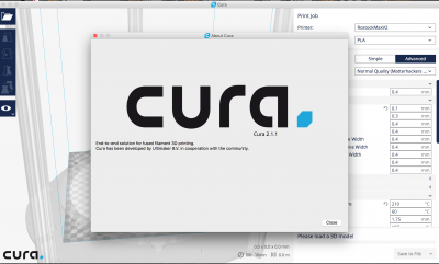

I'm also on OS X so I'll try messing around with it. I'm pretty sure I know whats wrong and I can check it out soon.
edit: which version are you using? I have 2.1.2 and I put the .json file in the correct spot (new location is Content/Resources/cura/resources/...) and I edited it so the center is 0,0 (main mistake in your config that was causing the printer to move off to the corner), but the printer won't show up in Cura when I go to add a new printer.
I'm running 2.1.1, and you are right I forgot to add the extra resources folder in the path. I just updated to 2.1.2 and if you use the json file and stl I provided you should still be able to add the printer. Where and how do you set the center to 0,0?Nylocke wrote:I'm also on OS X so I'll try messing around with it. I'm pretty sure I know whats wrong and I can check it out soon.

I've found that the printer not showing is usually due to an error in the json structure. Also make sure you remove the .txt extension. I only added it so I could upload the file. For example the machine_start_gcode and end_gcode have to all be on one line. If you multiline it the printer won't show up. You can use jsonlint to check that. I use sublime text 3 so to make changes what I typically do is multiselct all the \n on the machine_start_gcode settings and put them all on their own line. Then I reselected and fn delete which puts everything back on one line.
I also have found that getting cura to recognize the printer has been kind of a challenge. I usually have to turn on the printer, plugin usb, insert sd card in printer, remove sd card then the print to usb will show up. Also I find the print window very lacking. I'm guessing this is due to lack of support. It basically shows the element and bed temps and that's it. I'd love to have more info and the gcode is suppose to generate it but I'm not sure why it isn't showing up.
Resources:
https://ultimaker.com/en/resources/2051 ... e-settings - goes over the parts of the json file to edit and what each does
https://gist.github.com/onitake/78a3529 ... ab5dede1db - calculates the area to exclude so you have a nice circular bed
http://jsonlint.com/ - checks your json structure for errors
http://quillford.github.io/CuraProfileMaker/ - makes a printer profile for you. Haven't tried it yet but it looks like it would work.

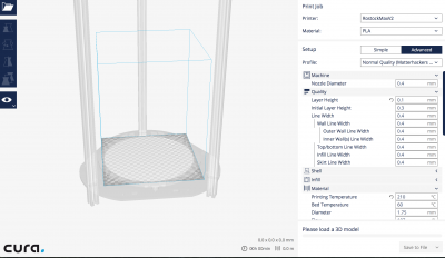

Thanks for the code. I tried it and it still heads over to between the y z towers. I've attached the gcode since it should give better insight as to what is going on. I'm still new to the gcode so I'm not totally sure all that is happeing up until line 47 or so.Nylocke wrote:I got it working, can't test right now though. Should work, you can check out what I changed.
RostockMaxV2.json.zip
A couple other things I noticed. The code waits for the bed to heat before heating the hot end. This is different from matter control as it heats them together. Not sure if other slicers are that way or if it just the gcode. For some reason once I hit my target temps the targets got set back to 0 so the print doesn't start. I had to manually set the print temps and then the printer started to print. It homes the towers, goes down center above the bed and then heads over between y and z towers. The x tower arm goes all the way to the down and if I don't shut it off it keeps trying to go lower. I pulled line 47 of the gcode and plugged it into matter control which reproduced the same result. I'll test some more tonight but if anyone can give some more insight it would be great to get it working.
R2_TrentWords cura.gcode- (555.31 KiB) Downloaded 954 times
Comparing your Gcode to mine, mine moves based around the center of the delta printer (center is X=0, Y=0, instead of being half of the max values of each axes like on a cartesian printer), while yours is moving way off in the upper right corner
Mine:
Yours:
The problems with resetting the temps comes from you taking the gcode from matterslice, Some of the format doesn't match the Cura format (the whole {IFEXT0}M109 S{TEMP1} or whatever bit) so Cura doesn't replace these with values, and the firmware interprets these at M109 S0, etc etc etc, which just sets the extruder/bed to 0C. Cura by default inserts this code:
in before all the start Gcode in the json file. Its a peculiar order though, it should be
so something might still be up in Cura. I'll check it out.
I have not tested this, but could a workaround be putting a G92 offset in your start code?
G92 X-140 Y-140
Then just use the Cartesian gcode generated by cura.
at least until zero center configuration is figured out.
G92 X-140 Y-140
