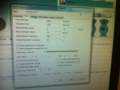

Ok, lots of posts from my last one! Firstly, no I was;t referring to Duet, etc simply the baud rate setting. So let's draw a line in the sand here and start with what we know:
1) you DO have a RAMPS board and it is now showing up properly in the device manager on COM14
2) now we need to figure out what baud rate to set in Repetier to get it to connect. Unfortunately, this is embedded in the firmware (most likely Marlin) on the RAMPS board so you basically have to guess! Here's what I recommend:
  1. launch repetier host
  2. open the Printers file option as I had you do yesterday
  3. Make sure COM14 is selected.
  4. Then, select 115200 for baud rate as Gene mentioned and try to connect (first save the and close the dialog then click the connect button). Make sure you clear the console window (there is a menu option to do this) before connecting so we can see what's going on.
If the printer connects it will print a message to the console with the firmware name and probably a build date or version #. If you see this, we are golden. If not, you need to repeat step 4 selecting a different baud rate. Start with the 9600 baud option and try each one in turn until you either connect or run out of options. Let us know what you find.

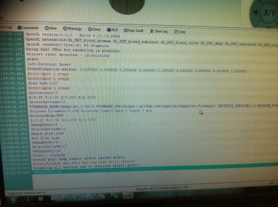

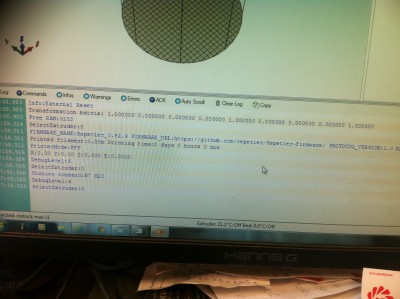

entered at 115200
connected ok
log is in the pic.
also extruder does heat up to temp ok
bed doesnt

@mcdarren23: SUCCESS! And you are running Repetier so life will be easier. It is very possible that the firmware was not configured for a heated bed. I vaguely recall that the Onyx was not included.
Now can you move and home?

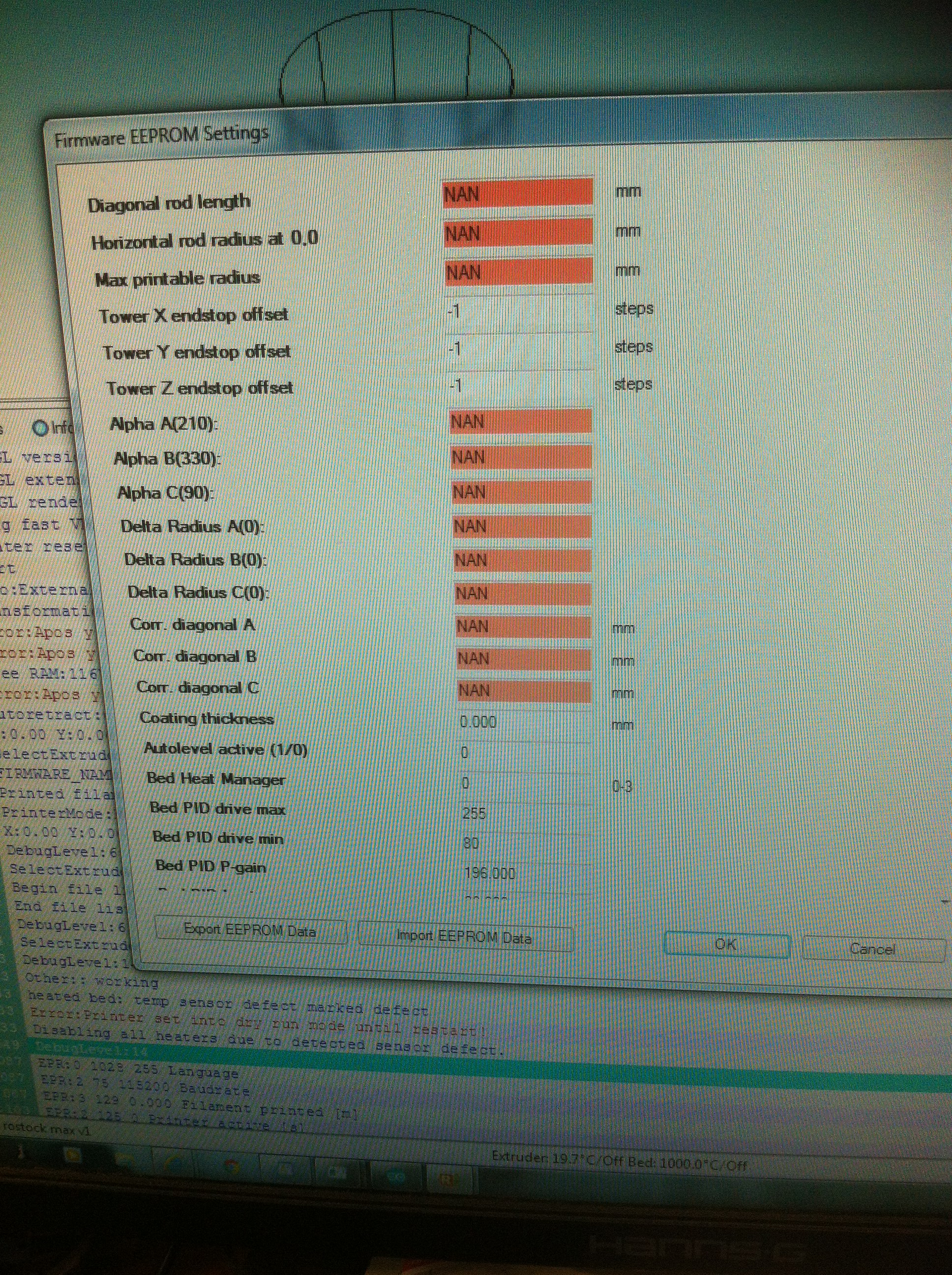

i reinstalled driver etc and downloaded and uploaded the repit program supplied to me. the lcd now works
althou i can no longer manually move the arms. also feed back is that there is a
heater bed : temp sensor defect
error : printer set into dry run mode.
thanks everyone

would this mean the thermoister has a fault and needs changing ? rep host is saying its 1000 deg also extruder wont heat up which i guess is because of the bed issue cheerz

some info off rep host that might help also
Posts: 1561
Re: Rostock max v1
Post by Xenocrates »
It can mean that the thermistor is faulty, that it's reading a temperature too low for it to like (Although I doubt it's really at ~-10C), that it's got the wrong sensor selected, or that the wiring/plug is non-contiguous. In short, it means somewhere in the assembly there is a fault which causes it to not pass the sanity checks of the firmware.

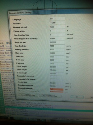

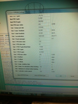

I'm not sure what is up with the thermistor. All the supplied thermistors should be 100k at room temp, its pretty typical, so they should all read 20-30C even when switched around. I wouldn't recommend soldering a thermistor, generally they are sensitive to solder temperatures and small ferrules are best used.
Also to fix the axis movements you need to upload the EEPROM clear program from the Arduino IDE (it should be in file->examples->EEPROM->EEPROM_Clear or something like that) and then reupload the correct firmware. For some reason the old version of the firmware you had messed up EEPROM variables (the big red UNDEF in the EEPROM config)

Disconnect the thermistor from the board and check the resistance, it's more likely to be a wiring issue than a broken thermistor.
At room temperature it should be about 100K Ohms.
The things it can be are as follows
Bad wiring (IME this is the most common, usually a short or partial short in the wiring).
A bad thermistor, I've broken the legs off them but I have never in 5+ years of printing with 5+ printers actually seen one fail.
Damaged controller board - If the resistance of the thermistor disconnected from the board is in the 100K ohm range, the board is likely damaged, and most likely the arduino pin that's used to measure the resistance is fried. If this is the case you really want to check your wiring with a fine tooth comb before you replace it, because usually it's caused by a thermistor pin shorted to a pin with some voltage on it.
