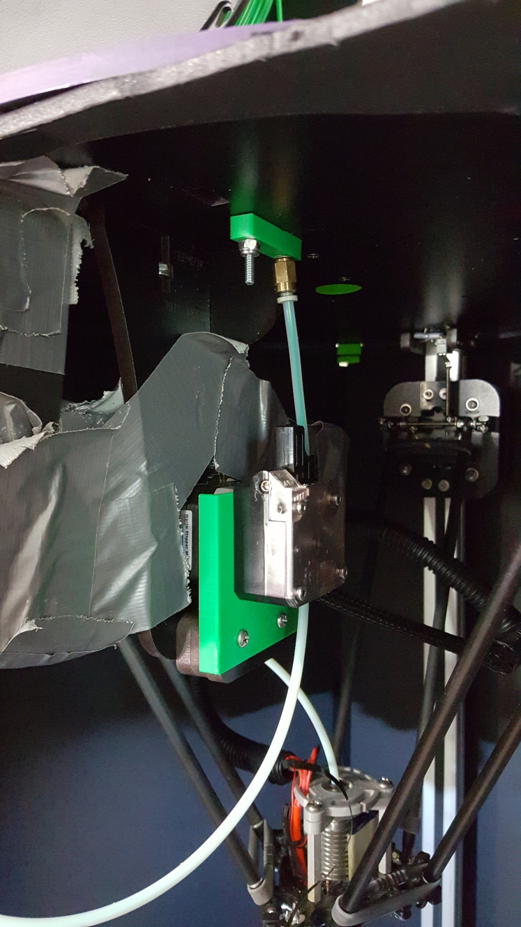

I have my Titan installed now and so far so good, haven't tried any difficult to extrude filament yet though, just some ABS.
One thing to point out is definitely calibrate your extruder steps/mm as the 456 steps/mm that E3D's install guide was way off for me, I ended up with 403 steps/mm

Duct Tape?Shizuma wrote:I have my Titan installed now and so far so good, haven't tried any difficult to extrude filament yet though, just some ABS.

It's a valid part of the engineering process. If it moves and it shouldn't add duct tape. If it doesn't move and it should, WD40.Holy1 wrote:Duct Tape?Shizuma wrote:I have my Titan installed now and so far so good, haven't tried any difficult to extrude filament yet though, just some ABS.
Re: E3D Titan Extruder
Not familiar with the extruder mount of the V2, but if it's the same as the later model V1 then I can upload the one I made for mine.kraegar wrote:Anyone got a mount print that'll work for the titan to the standard rostock max v2 mount? E3D doesn't have anything up yet.
Yeah, that was my "temporary" air duct to cool my extruder motor cause I was having issues with it getting extremely hot to the touch inside my enclosed build chamber, so I made an air duct with foam board, hot glue, and duct tape with an 80mm fan pulling air though the duct. Some day i'll replace it with a nice printed one, but not till I get around to building a new nicer enclosure around the printerHoly1 wrote:Duct Tape?Shizuma wrote:I have my Titan installed now and so far so good, haven't tried any difficult to extrude filament yet though, just some ABS.

I believe it's the same, if you can upload I'll print and give it a shot. The bracket that e3d has would be a pain to use, I'd rather just bolt on in place of the ezstruder.Shizuma wrote: Not familiar with the extruder mount of the V2, but if it's the same as the later model V1 then I can upload the one I made for mine.
Here you gokraegar wrote:I believe it's the same, if you can upload I'll print and give it a shot. The bracket that e3d has would be a pain to use, I'd rather just bolt on in place of the ezstruder.Shizuma wrote: Not familiar with the extruder mount of the V2, but if it's the same as the later model V1 then I can upload the one I made for mine.
- E3D titan mounting plate.STL
- (208.29 KiB) Downloaded 381 times
I can confirm this bolts right up to a v2, thanks!Shizuma wrote:Here you gokraegar wrote:I believe it's the same, if you can upload I'll print and give it a shot. The bracket that e3d has would be a pain to use, I'd rather just bolt on in place of the ezstruder.Shizuma wrote: Not familiar with the extruder mount of the V2, but if it's the same as the later model V1 then I can upload the one I made for mine.
