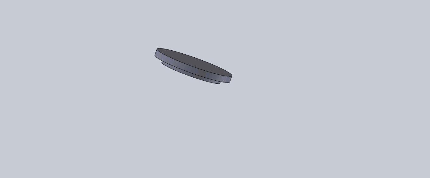

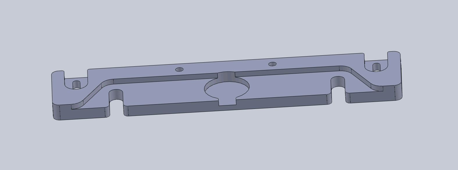

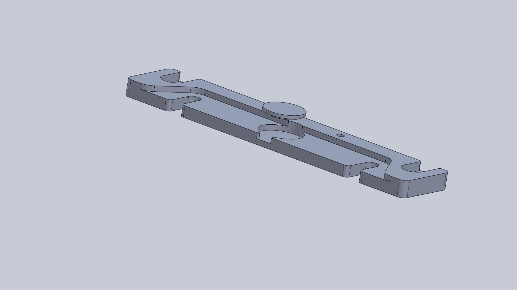

Speaking of FSR's... We get 100% perfect repeatability every single time with a cold bed, and no more than 1 step error with a heated bed.
I designed and machined them in 6061 to within 0.0005" tolerance for the puck to slide. Had them black anodized to prevent aluminum oxidization (aluminum dust = sticky), then assembled together with FSR kit. Works amazing!
