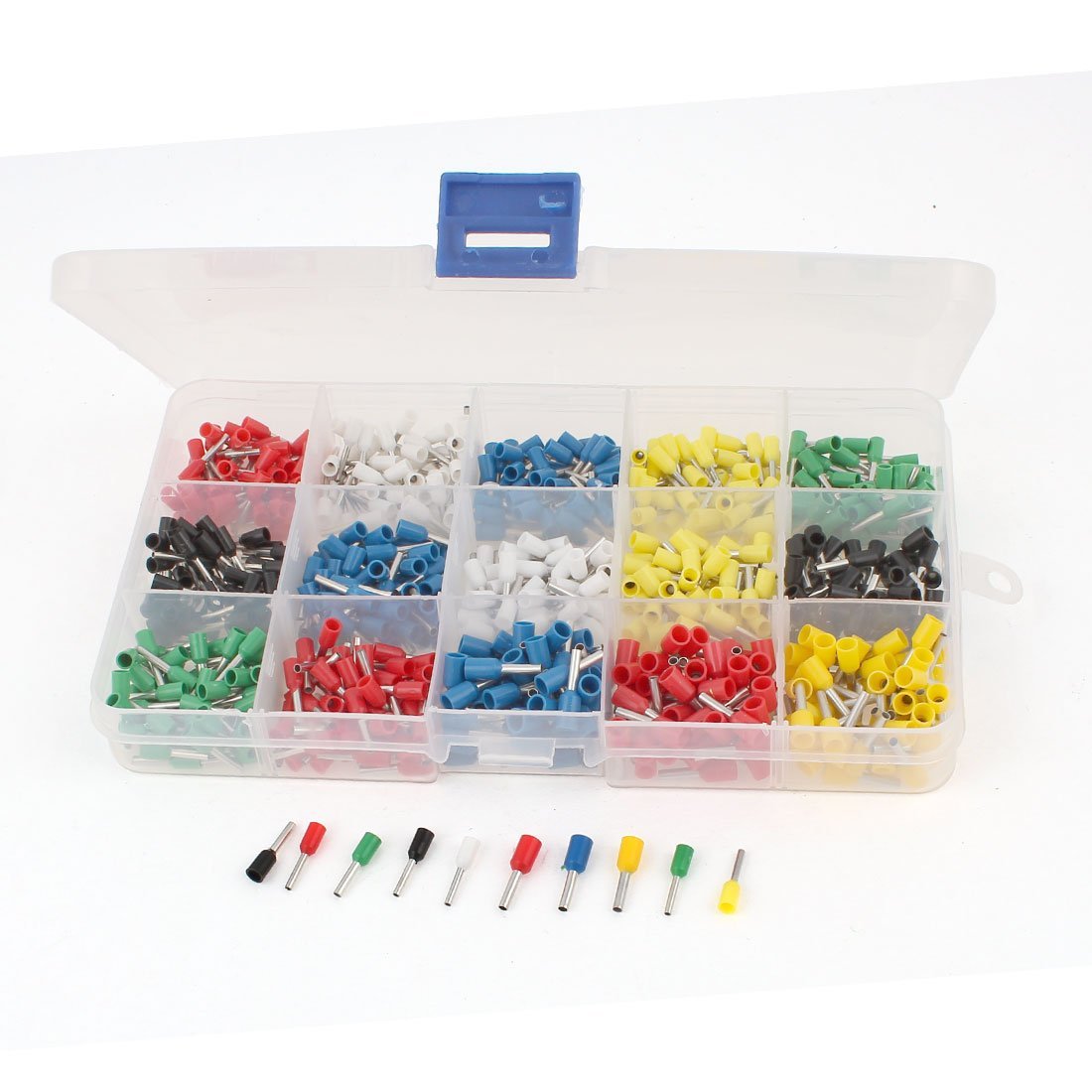

The best way to terminate wires connected to the Phoenix connectors like what is used on the Rambo is to terminate the wire with pin connectors that are
crimped to the wires with special crimpers.
The pin connectors.........
Search Amazon.com for the pins you need......Wire Crimp Insulated Ferrule Pin

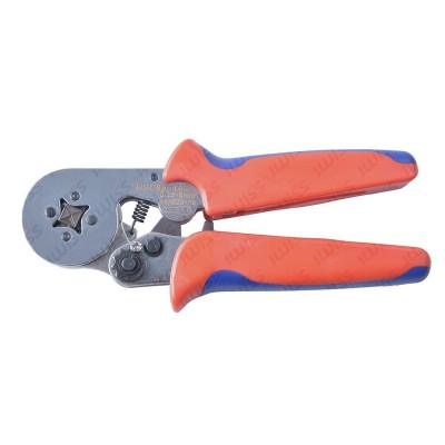

The crimpers........
http://www.amazon.com/gp/product/B00ODS ... _i=desktop
These type of pins were covered by MHackney in a different thread but the idea is to insert the stripped wire through the insulated part of the crimper and the stripped part into the metal portion then crimp the metal portion with the crimpers.
No more wire "hairs" that don't end up under the screw. Works well and was designed for the phoenix screw type of connector. The pins are sized to the AWG of the wire, the crimpers will handle to 10AWG.
One other benefit is that the added colors help your printer to look pretty.

Commonly known as "bootlaces" in the game.
We use them for multistrand wire into screw connectors in automation systems where things need to be quickly changed. When done right, they are pretty good, but you can get them wrong too: crimp onto the insulation, don't crimp tight enough, crimp too tight and crack the tube etc etc can all lead to intermittent connections. And now that you're relaxed and confident in your bootlaces, they become the last thing you check - so it can lead to a long and frustrating bug hunt.
Note the quickly changed bit: they are mostly about constraining the wire strands and providing a rigid insert into screw blocks and so on. I'm not sure I'd be using them in the back of a connector myself - especially when things are tight because they make it even tighter (wall thickness of the tube, bell size of the insulated back).

Agreed but if you have the room they are better then just putting the stranded wire under the screw. Thanks for passing on your knowledge Captain.

Personally I think they introduce extra steps (ie chances of stuffing it up), time and expense without much advantage for permanent connections like this. I'd rather take a little longer making sure my Phoenix screw connection onto twisted wire was solid, without strays or exposed wire because I'd stripped it correctly, twisted it correctly, installed it correctly and tightened it correctly than spend the same amount of time ginning around with bootlaces. Particularly on the thicker connections.
