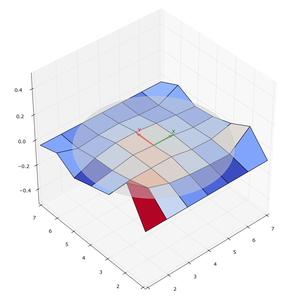

626Pilot
Posts: 1716
Re: Heuristic (AI) calibration for delta printers on Smoothi
Post by 626Pilot »
pyjamasam -
I'm including your excellent dm_surface_transform visualizer in my next release. I've put in instructions on how to install matplotlib for python, and modified the script so that it automatically looks for dm_surface_transform in the current directory. You have been credited, and a link has been included to your source on gist. If you don't want me to include the script (so people have to go to your gist to get it), let me know and I'll remove it.
For anyone curious, this is what the visualizer looks like. It lets you pan around!
I saw you've been having a few issues with your fork of my fork. Thanks for figuring out the new way to hand arrays to the FK/IK methods. Copying the array subscripts into a new array that those methods understand is alright. However, you forgot to copy the output back into the main array after the first call you modified. I fixed this on my side. I also noticed one of your commit comments is that you've disabled stuff because you're crashing. This is because you have enlarged the probing grid from 7x7 to 9x9. It may not seem like a large increase, but doing that requires significantly more memory. There are places where this can be addressed. For example, right now, we have some 2D arrays that contain XYZ coordinates (XY for bed position, Z for vertical deflection relative to bed center). The bed position subscripts of these arrays can be dropped in favor of calculating the coordinates every time we need them. This is a little slower than reading them out of an array, but not much. It requires a few adds, subs, and muls, but that's it. The relevant code is in ComprehensiveDeltaStrategy::init_test_points(). I will look into that in a future release.

  • Added pyjamasam's dm_surface_transform visualizer to the Smoothie root directory. Drop dm_surface_transform into the same directory and run: python dm_surface_analyzer.py. You need to have python and matplotlib installed. Instructions are in the comments at the top of the script.

PyjamaSam
Posts: 20
Joined: Wed Dec 23, 2015 4:55 pm
Post by PyjamaSam »
626Pilot wrote:...You have been credited, and a link has been included to your source on gist. If you don't want me to include the script (so people have to go to your gist to get it), let me know and I'll remove it...
No probs. Include it away. It's all good.
626Pilot wrote:...I saw you've been having a few issues with your fork of my fork....
Ya I also didn't actually activate the ComprehensiveDeltaStrategy at one point and slammed my probe into the bed a few more times that I really liked to... Hahaha.
I think I'll sync up with your edge and just keep the fork around for bug fixes and contributions now that your synced with upstream. Nice stuff. Glad for the little help I could provide.
Also that ConfigComparator script is great. Thanks for that.
