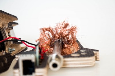

Re: RJ45 ethernet connector for hotdend
wasp Delta italy use hot end connect RJ45
[img]http://www.personalfab.it/wp-content/up ... G_9901.jpg[/img]
maybe use this system ???
[img]http://i.ebayimg.com/00/s/OTA1WDkzOA==/ ... J/$_57.JPG[/img]
down hotend Wasp old
