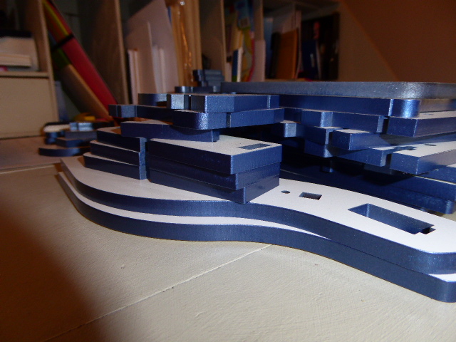

Right then..... all the parts are here.
Edges are all painted (I am sure I have painted a whole load that didn't need doing... but that doesn't matter).
They are a nice metallic blue.
Looked at the E3d v6 hotend. Looks a lot easier to assemble than the stock RoStock one. I think I will assemble the stock one anyway - as a backup.
Let the building commence :D
