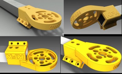

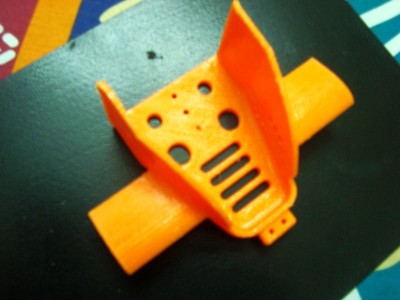

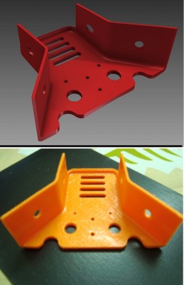

I am currently making my Quadcopter using 19.05mm square Aluminum tubing as frame. I shall post my progress as it goes on. I am new to this hobby. Today i designed Motor mount that will be installed on Aluminum Arms. I am printing this motor mount in Horizontal position. Also the link of thingiverse:

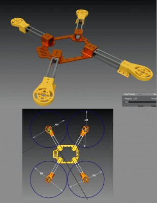

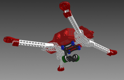

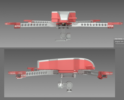

Meanwhile my 3D model is for your review.

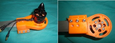

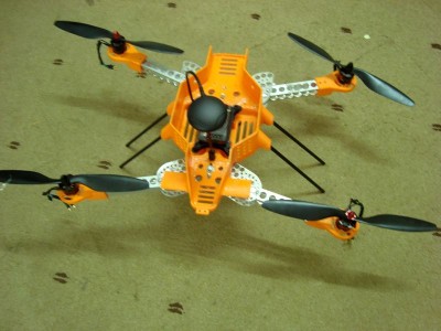

After lot of design iterations i came up with this fantastic design. 1- The arms of this quadcopter can be set at any angle. Even you can fold it.
2- The body can be extended or reduced.
3- This can turn into Square and H configuration.
4- The Aluminum machining was done on CNC and the motor mounts were 3D printed.
Now I have to make the body of this quadcopter i.e. the center piece that will act as a bridge between the arms.
So far the weight of Quadcopter as shown in following picture came out around 600gm.
he centre Aluminum square piece is just kept to hold the forearm and back. Its not the part of Qadcopter. 930KV motors with 10inch propeller

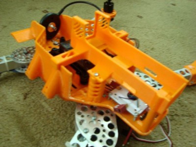

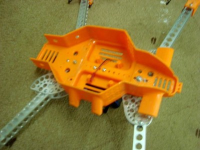

Re: My H-Frame Quadcopter Build

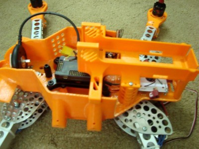

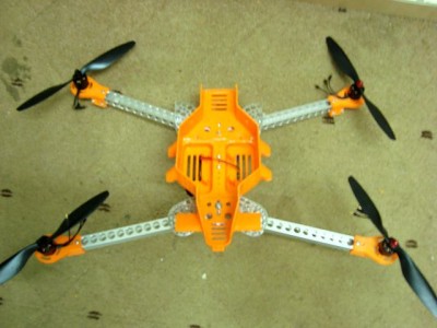

Finally.. Found some improvement during assembling. Once electronics complete i will revise the 3D model and post in thingiverse.
- Posts: 276

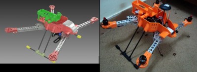

Re: My Quadcopter Build

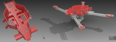

Shortened the arms. The landing gear are crude, the printing will be soon done. However i will use the Carbon Fiber rods for landing gear as shown in picture.... Now its look good to me

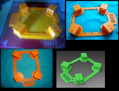

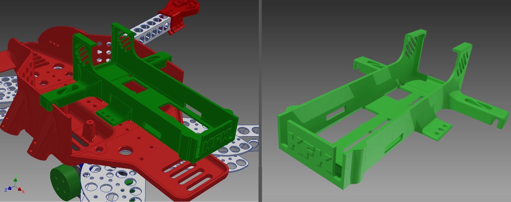

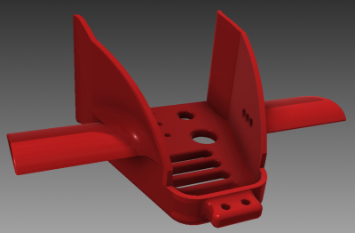

Still Work in Progress for the quadcopter. Modified the body a little bit. Here is the snapshot of Lipo Battery Holder (Lipo battery 14.8V 5000mah) Dimensions of the battery is: 136mm x 44mm x 39mm (LWH). The printing in progress.

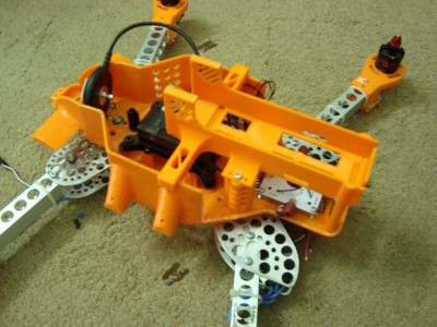

Man, I miss my quad.
It tried to drill for oil. Was a kickstarter quad that the developer ran right after shipping all the quads. The brains never did work quite right, even after a couple firmware upgrades.
The wires that hook to nothing on the right of the frame used to connect to the radio, it went for it's own flight after the quad did an uncommanded barrel roll while hovering. Radio came loose and hit a prop I think, never did find it.
Hopefully the next kickstarter I supported works out better. I do know there has been much more developer communication with this one.

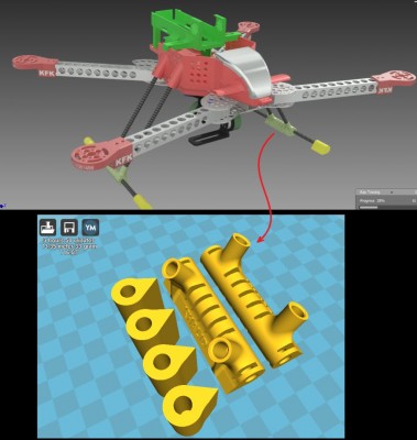

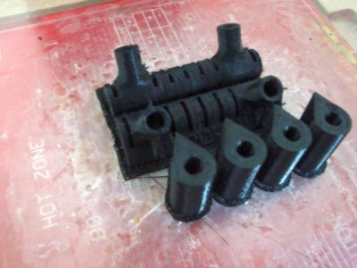

Got some time to design and print the landing gears. The plastic parts can take load upto 2Kg and shock load upto 5Kg.
- Posts: 276
What are the teardrop shaped extrusions for? Just "bumpers" or caps for the landing skids?
- Posts: 276
Bumpers, Caps yes, but, i designed them to keep the whole thing levelled. Otherwise it may have a chance to tip-over...
