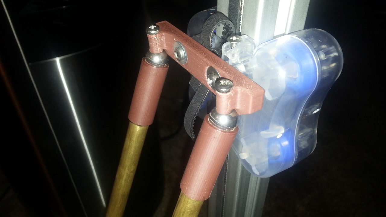

2- U joint mounts
geneb was right about reading up before purchasing, not to mention the pictures themselves. Either way, if you were running stock, you could just print your own. I have magnetic arms so when i got my new carriages, i went strait for the calipers, and by the end of the night I had custom mounts for my setup. (picture below)
3- Compatibility with other mods like Fly-N-Strude, etc
see tip number 2

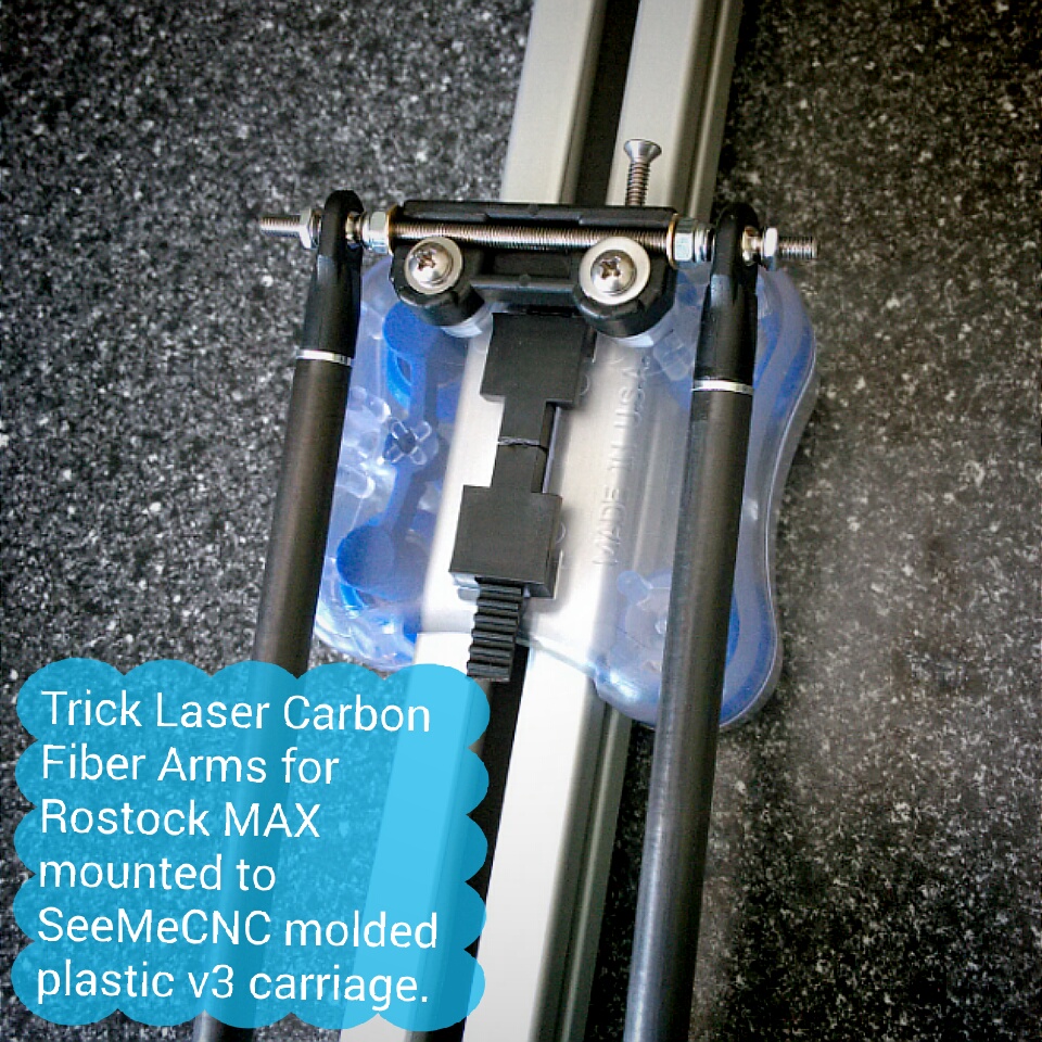

Post by bvandiepenbos »
The Trick Laser CF Arms work fine with new molded carriage.
As far as Flyn-N-Strude, simply loop elastic cord around axle holder and tie off, or use miniature bungee cords and place hooks over axle holder. Simple.
You can print your own hanging extruder mount http://repables.com/r/531/
I agree, that it is best to build and run machine bone stock before making changes/mods/upgrades.
The new molded carriages are a big improvement over original cheapskate design. If you already have them, go ahead and install them, it will be worth the effort.
