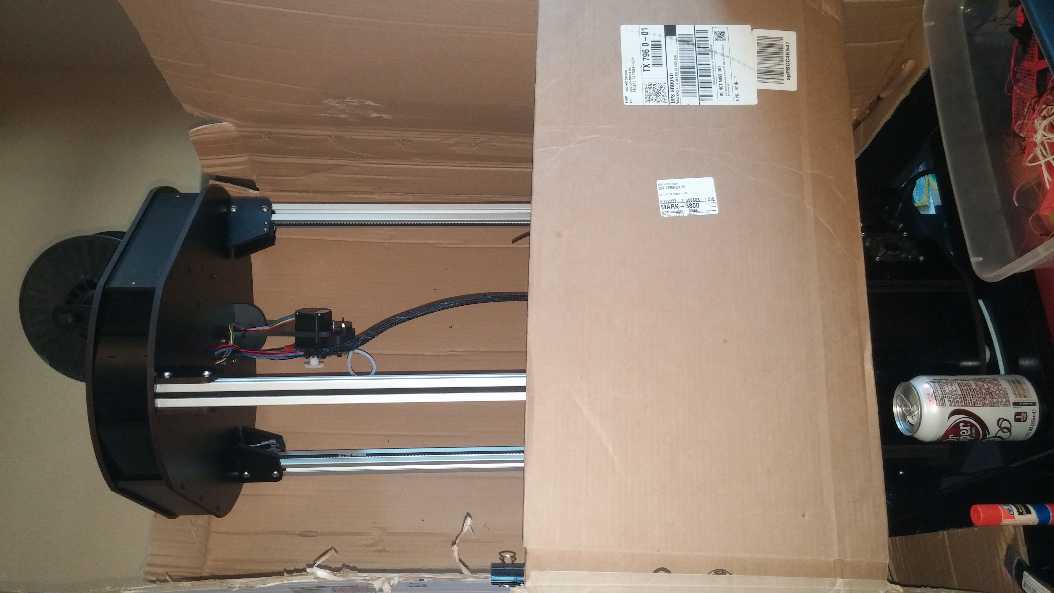

Trying to print this enclosure, had to construct a draft blocking apparatus in the mean time. Poor guy looks homeless.

e_hutch wrote:Trying to print this enclosure, had to construct a draft blocking apparatus in the mean time. Poor guy looks homeless.
Ha. Do what works. We had something similar while we were printing the enclosure pieces.
Re: V2 Enclosure
It looks like it belongs on the Beverly Hillbillies! But hey it worked for what you were doing for the moment!
That is a fine example of recycling!
