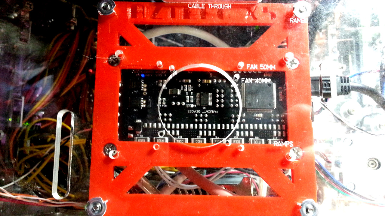

Solder connectors to your Smoothieboard so that the existing connectors for the RAMBo can be reused. Order the Smoothieboard with the connections unsoldered so you don't have to make adapters like I did. Follow the same layout as the photo.

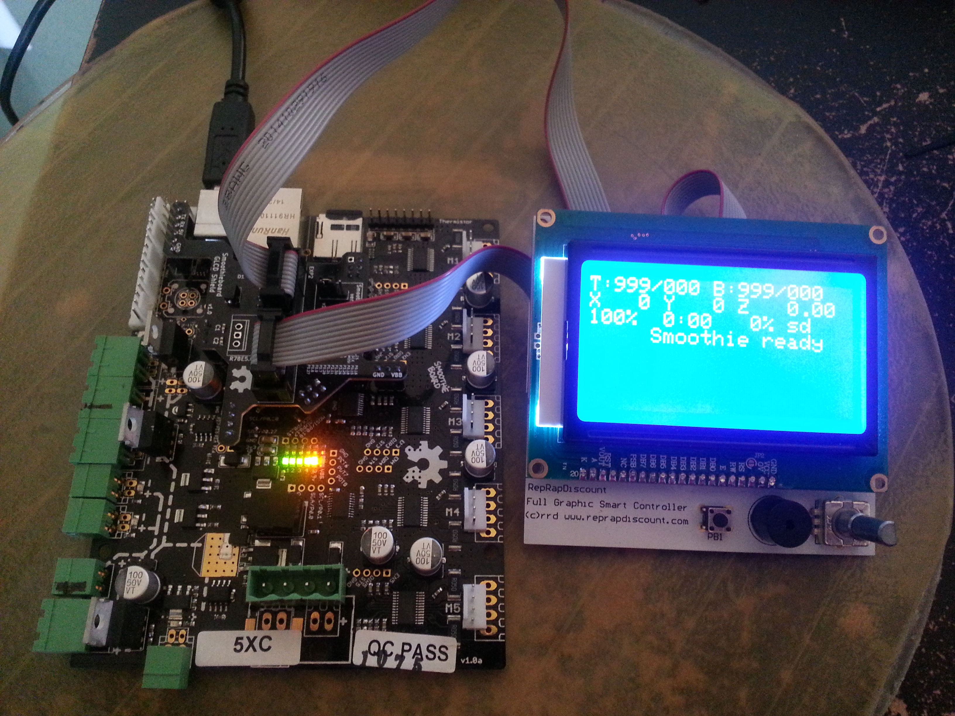

Plug in the components into the Smoothieboard while it's powered OFF.
[img]http://i.imgur.com/yMHSD6R.png[/img]
[img]http://i.imgur.com/WNqJTiQ.jpg[/img]
There are three power connectors that must be connected. If you are using an ATX power supply, you probably already have three yellow and three black wires connected to the RAMBo.

I spoke about doing an Azteeg X5 mount a while back, and here it is!

If anyone has a Smoothie 5X mount please post it
626Pilot
Posts: 1716
Re: Rostock Max Smoothieboard Tutorial
Post by 626Pilot »
The X5 is specifically an Azteeg board. You're probably looking for a Smoothieboard mount. I haven't got one of those :(

626Pilot wrote:The X5 is specifically an Azteeg board. You're probably looking for a Smoothieboard mount. I haven't got one of those :(
X5 is the Azteeg. Smoothie calls their boards 3X, 4X, 5X based on how many drivers are populated.
Just do a search for smoothieboard on Thingiverse - there are a few options there, including a couple from seemecnc folks (mhackney and cope411, I think)

Are there any guides like this that are newb friendly? I understand the basics of upgrading but I still have a lot of questions. I'm thinking of getting a smoothieboard but the main thing holding me back is I'm not sure how to install it.
Basically my questions are:
1) Does the LCD work with the smoothieboard as is or do you need a daughterboard like the RAMBo?
2) The instructions have one of the power ins as three wires twisted together. Is this what you plug into the big mosfet power in?
3) On the software side is there anything other than using that config file (tweaked to my machine) that I need to do? I'm still not 100% sure what a repietier host is. I'm using a mattercontrol tablet for slicing and printing if that helps.
4) If I never plan on running more than 1 extruder would I be better off just going with the Azteeg 5x?

A lot of the answers are on the smoothie wiki. You can use your current LCD controller, but you need some extra stuff. The Wiki has more info on this.
Repetier Host is a host application that runs on a computer. It just connects to the printer and let's you control it. Pronterface, Mattercontrol (tablet or application), Cura, or any other host application can do it too. Updating the firmware is simple, just put the latest .bin on the SD card and restart the board.
Yes, the Azteeg X5 can do what you want, but 626Pilot probably would advise against going that route, he's gone through 3 of them, they don't seem super reliable, and the 4X isn't much pricier that the X5 Mini

I have a GLCD, see my post in the marketplace. I'm also installing the VBB regulators. They recommend the 1.0Amp unit

I bought two of them in preparation to install one on each. I think someone pointed out that the latest adapters have one installed on the pcb already, I'm not sure. The GLCD I have is the larger, full graphic unit.

I installed the regulator on the smoothieboard only, not the GLCD Shield. It was redundant and not needed. The GLCD (Full Graphic Smart LCD Controller) with 1a regulator will work off the single +12v VBB, or the +5v VBB. You can also power the GLCD using just a USB 3.0 port.
See the attached image, no regulator on the GLCD Shield , 1a regulator on the smoothieboard, everything running off USB 3.0 with no other power wires attached:

KAS wrote:I installed the regulator on the smoothieboard only, not the GLCD Shield. It was redundant and not needed. The GLCD (Full Graphic Smart LCD Controller) with 1a regulator will work off the single +12v VBB, or the +5v VBB. You can also power the GLCD using just a USB 3.0 port.
The reason I'm installing the regulator is so that the machine will self power from the power supplies and any usb cable is for communication only.
KAS
Posts: 1157
Post by KAS »
I think we have a break in the communication somewhere. You do not need two regulators on a smoothieboard for the GLCD to work. You only need one.
As for using USB for communication only, You'll find out that it wont work like that.
For example, when you have the power supply switched on and connected to the USB at the same time. If the Head was crashing off the plate and you shut the power supply off at the switch. Then turn it back on thinking everything is fine. You'll find that the stepper re-engage right away and keep crashing off the plate. The connected USB provides enough power to keep the smoothieboard running and processing data like it never missed a beat. You have to remove the USB and turn the power supply off to actually shutdown the controller.
That's the one thing I don't like about the USB connection. If the smoothieboard is connected to the USB, it's always on with no way to turn it off unless you remove the cable. I ended up using a USB hub with individual switches to turn off the printer without removing the cable.
