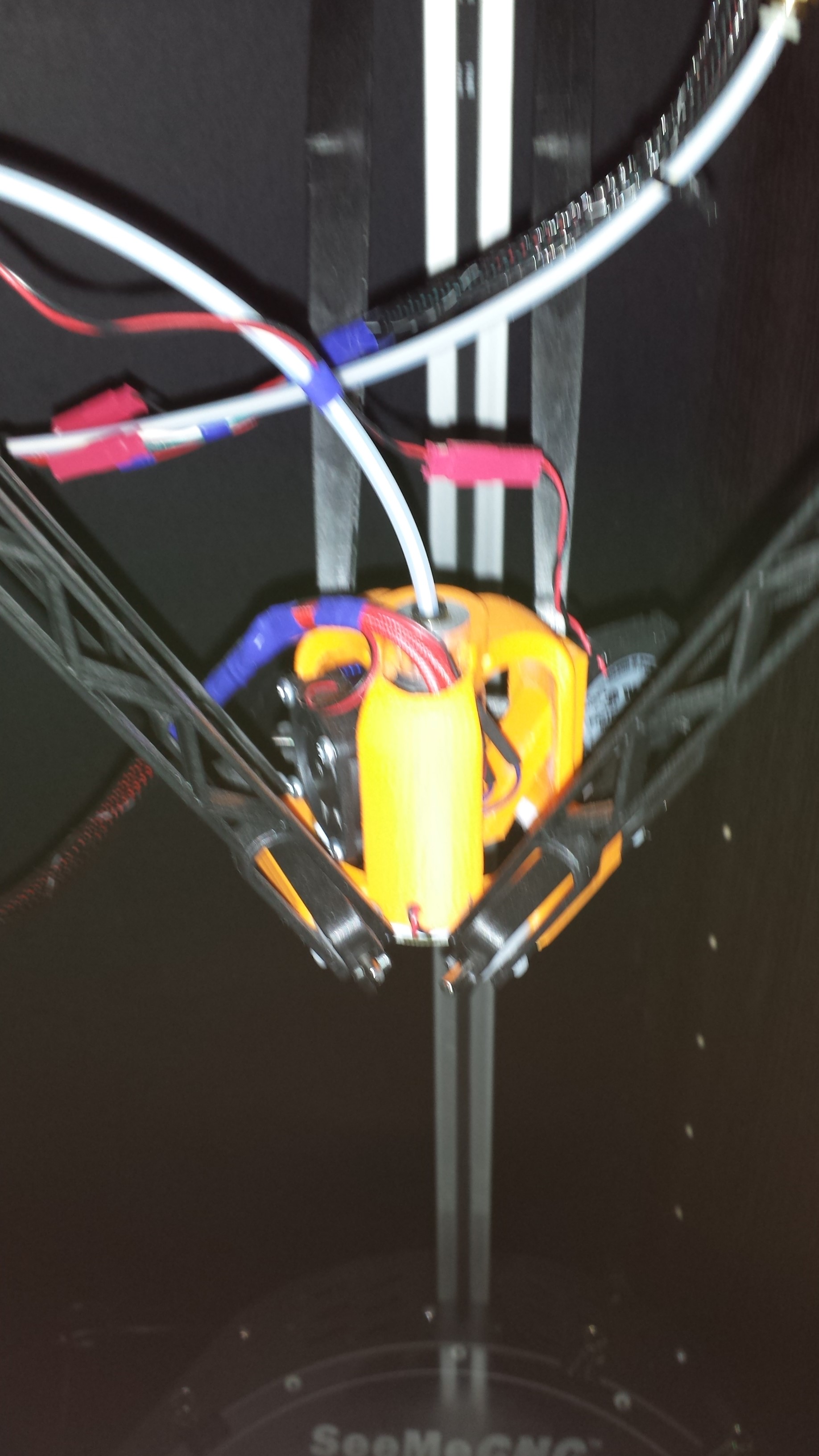

got my e3d and did the mods

Anyone find it a pain to print the mount?
The huge accel on the Rostock causes it to lift up the first layer, usually on those inside bolt holes, my only solution so far is to reduce the travel speed, but not really a fan of doing that!!
And does anyone know if we can get those white bits for the arms, the metal rod that goes through and the plastic bit that goes around it (as the pic above), that would make swapping hotends way easier!
Ideally in the UK, shipping from US takes forever and is expensive :]
edit: Solved the adhesion issue by making some ABS juice :)

Predawnsky, that looks sweet! Good job.
Alright, I'm back!
I have my latest model of the platform installed, but it just missing a few things. I print mine out of PLA and they work great if you only print PLA with it. I tried printing ABS for one job and warped the paltform with the high temps in the enclosure. Not good. Have a find print me a ABS version soon.
I installed the stepper dampers which makes a difference, but it's not as huge that I though it would be. The GF can sleep with it running overnight, so that enough for me. I took decibel reads and they were the same near the machine and in the room next to it. The coarseness of the sound is reduced, so thats nice.
The Trick Laser arms are installed and they look so much better then the old fat ones. Used the hardware that came with it for the cheapskates, used M3 machine screws for mounting to the platform. Putting the locking nuts on the M3 rods that come with the arms are a pain to put on.
Still have to install the LED ring and the Yellow Jacket Board.
