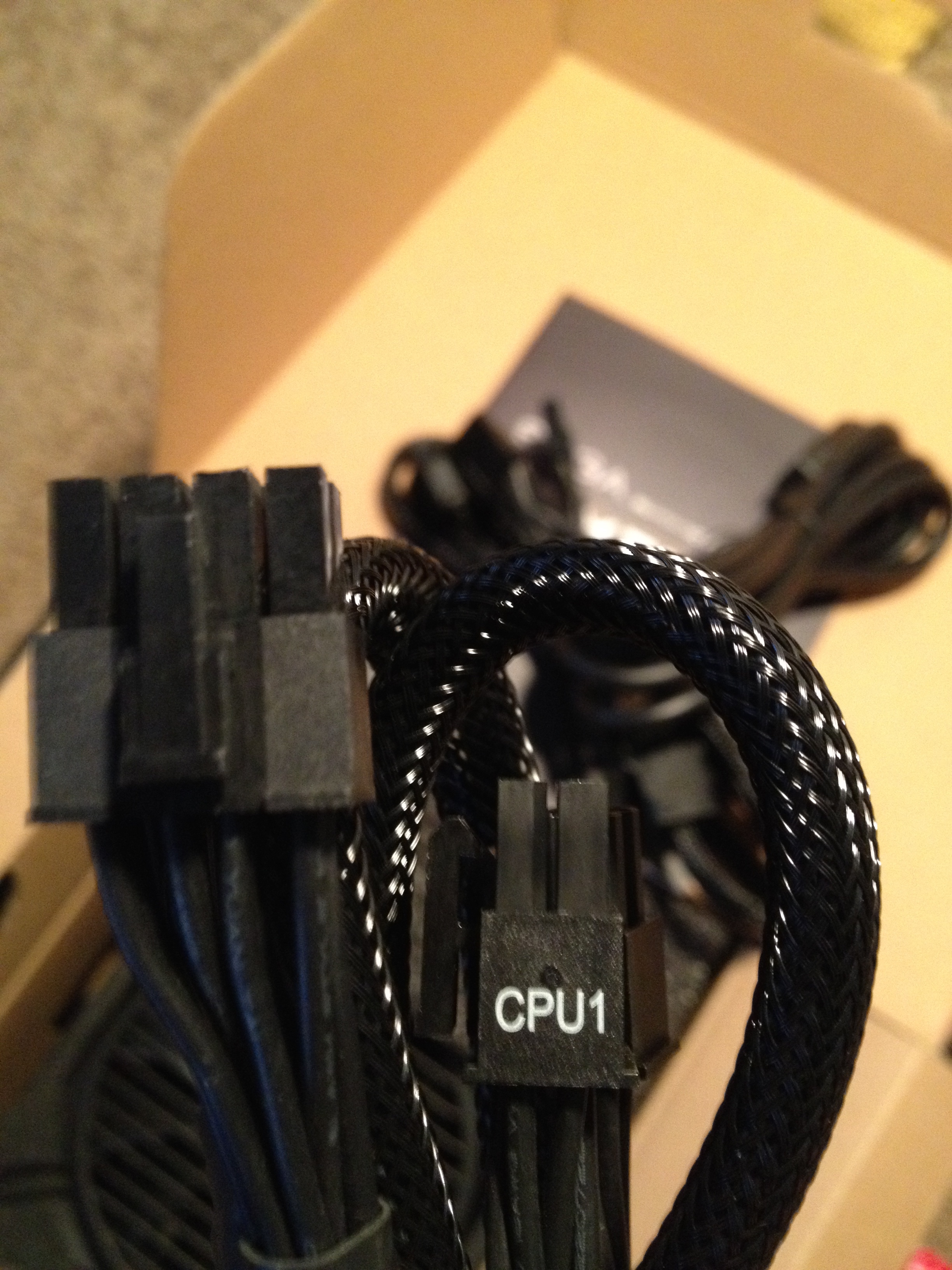

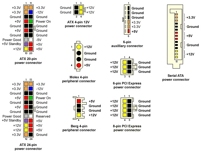

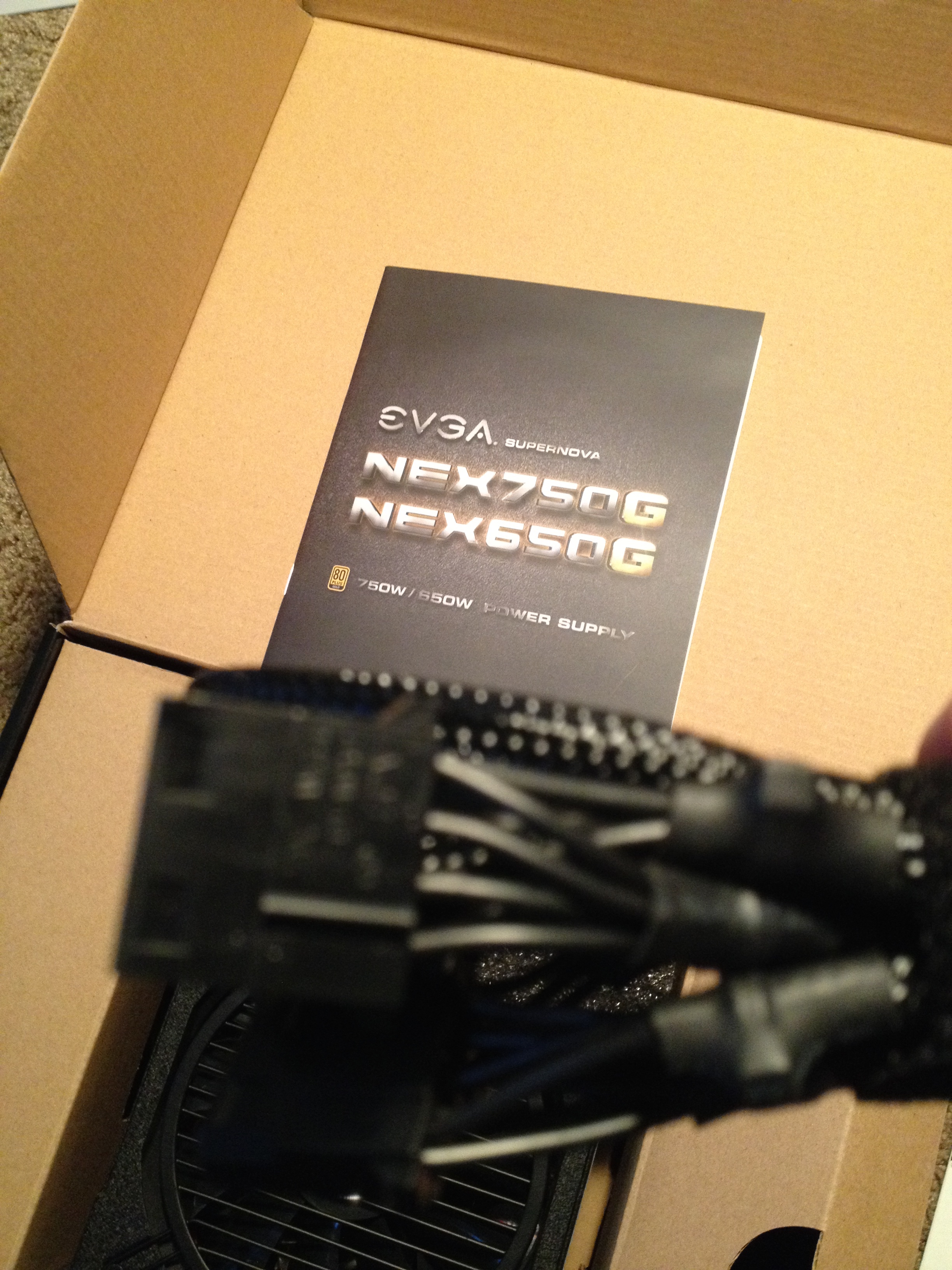

I just bought an EVGA supernova NEX650G to power my Max v2, the included diablotek crapped out during calibration. Support is great, they are sending a new Viotek but I'll use that one as a backup. I'm wondering how I go about wiring this?(I'm a noobie when it comes to wiring and I want to be sure to not fry the machine! I have attached a few images, the wires are all black and there are no other colors so I'm a bit confused. Also, do I still bundle 4 together like I did with the Diablotek?(once I find out which 4 to bundle

If you have the connector you cut from the other psu, you could use it as a guide. The wires may be all black on the new one, but the pin positions are the same.
