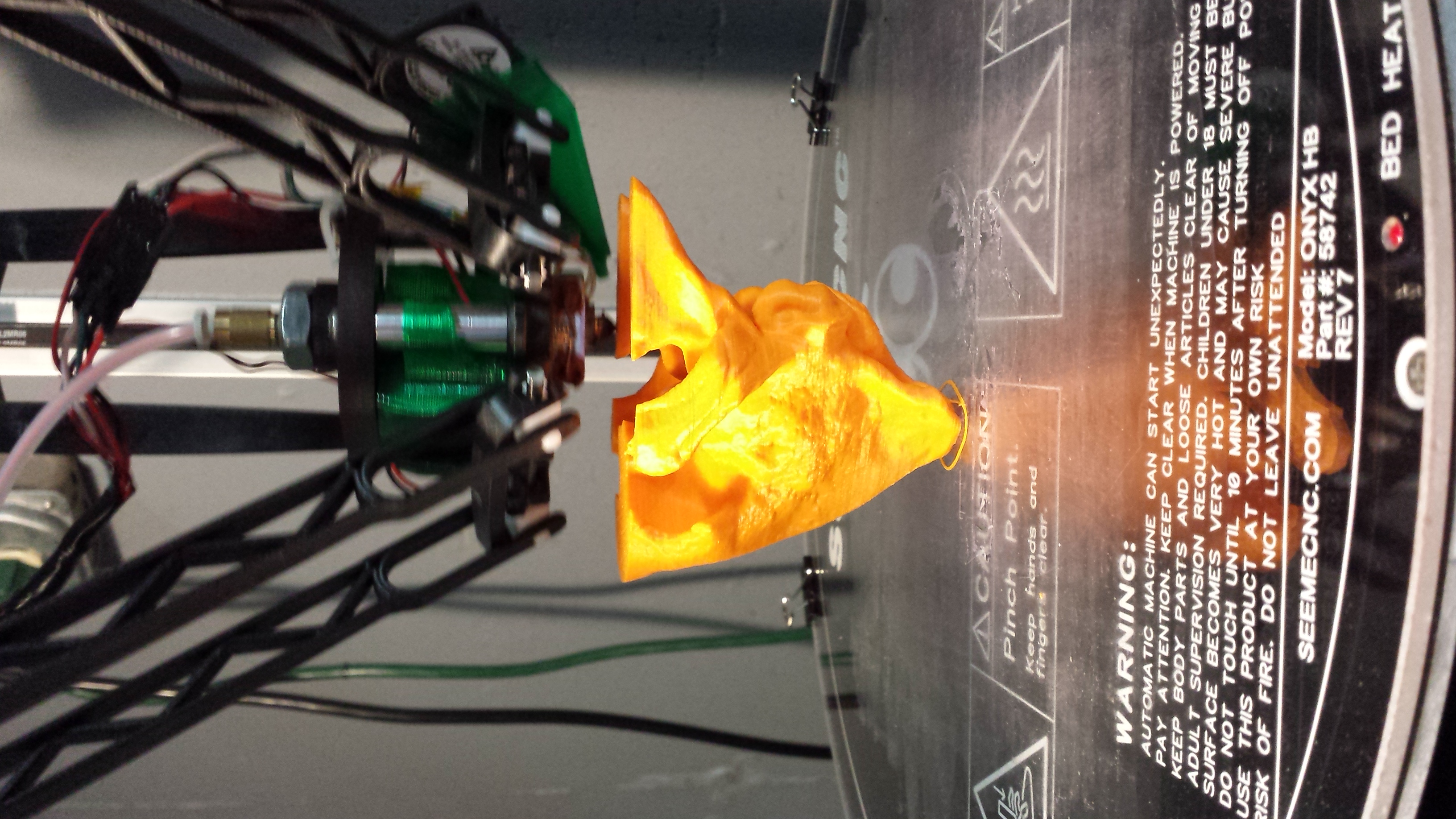

I was making a saber tooth cat skull and half way through it lost its adhesion to the bed is there anyway I can start from were it left off or do I have to start over and whats the best way to get proper adhesion because a the glue stick method seems to work on and off for me

Try printing with a raft for better adhesion on small points like that. You may also try printing with supports.

It's not a raft he needs, but a brim. The surface area that's actually in contact with the bed is way too small for that large of a part. The drag friction of the plastic coming out of the nozzle is going to treat that part like a huge lever and will eventually overcome the adhesion of that tiny area.

thanks for the advise guys I was wonder what you think is the best temp for abs im running at 240 currently
