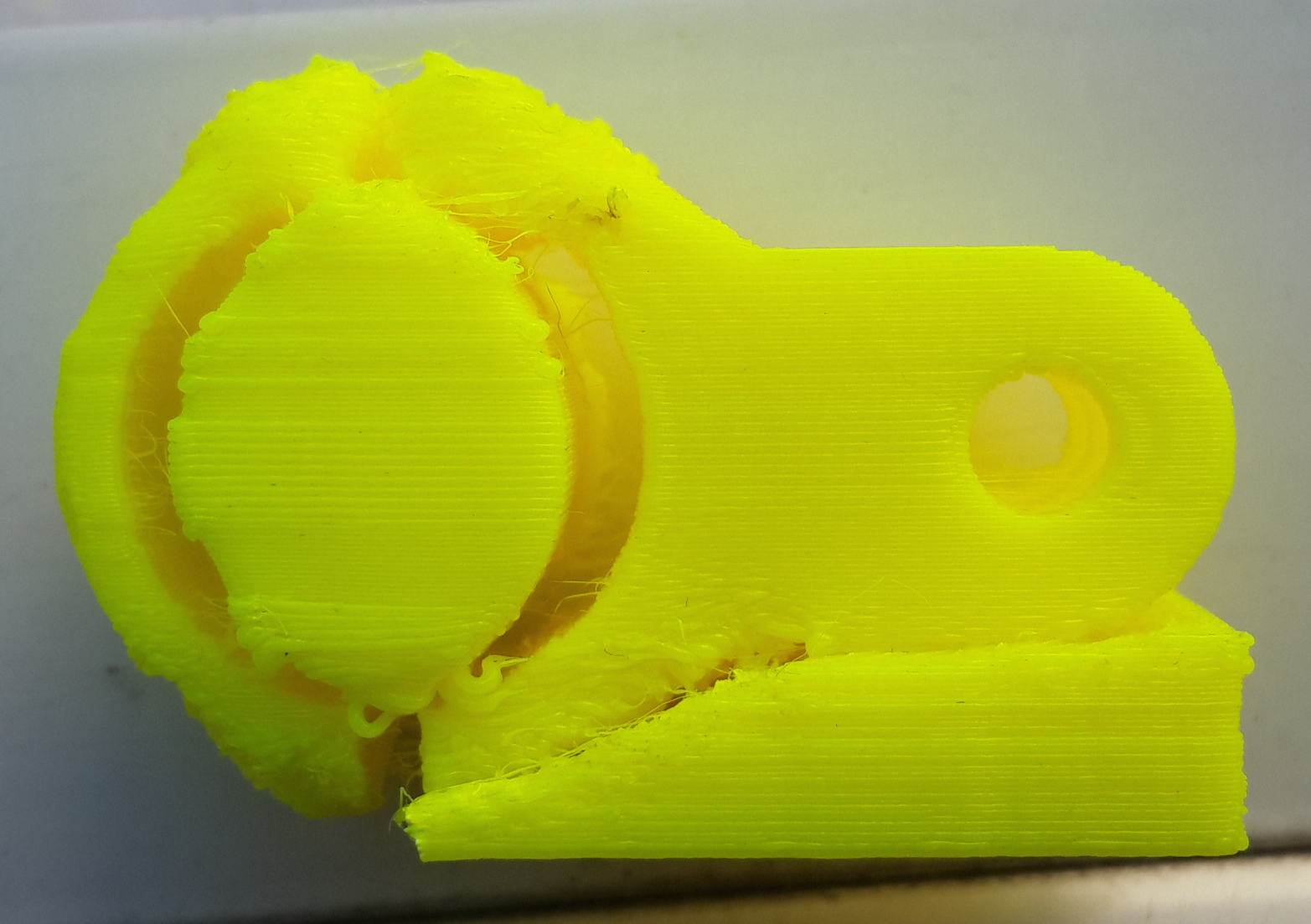

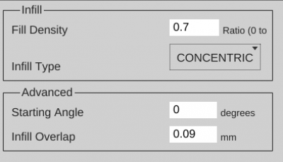

I was trying to make this:
http://www.thingiverse.com/thing:451116/#files
But somehow it did not turn out quite to be as nice as i wanted. Hot end temp is 232 degs. Heated bed is 90 degs.
Printed with raft. Filament is Octave. I removed a the raft and a bit of the support before i thought of taking pics and posting.

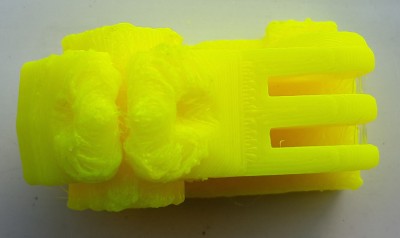

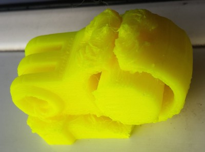

Side veiw
Side veiw
Bottom view
Bottom view

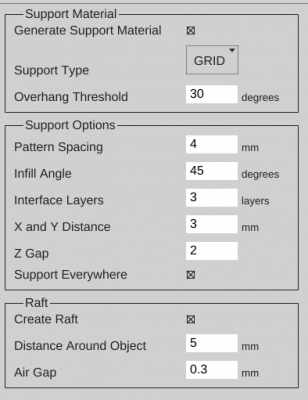

Settings
Settings
Settings
Settings

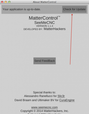

What slicing program is that?
teoman
Posts: 1770
Re: Gopro Mount
Post by teoman »
Matter control 1.1.3.

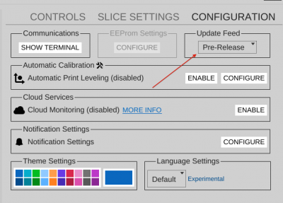

I updated to the latest version because it was mentioned that it had an extra configuration (interface layers) for support material.
And before you ask...
Getting the latest

teoman wrote:I was trying to make this:
Which Speed you are printing?
Seems that when it Comes higher there is not enough cooling time for the ABS before the next Layer is printed.
In Matter Control there is a Option to set the min. Layer time. Try to set it higher and/or reduce Speed and Head-Temperature.
I often have this printing small Parts running Speed to high. Slow it down, take a coffee ;-)
