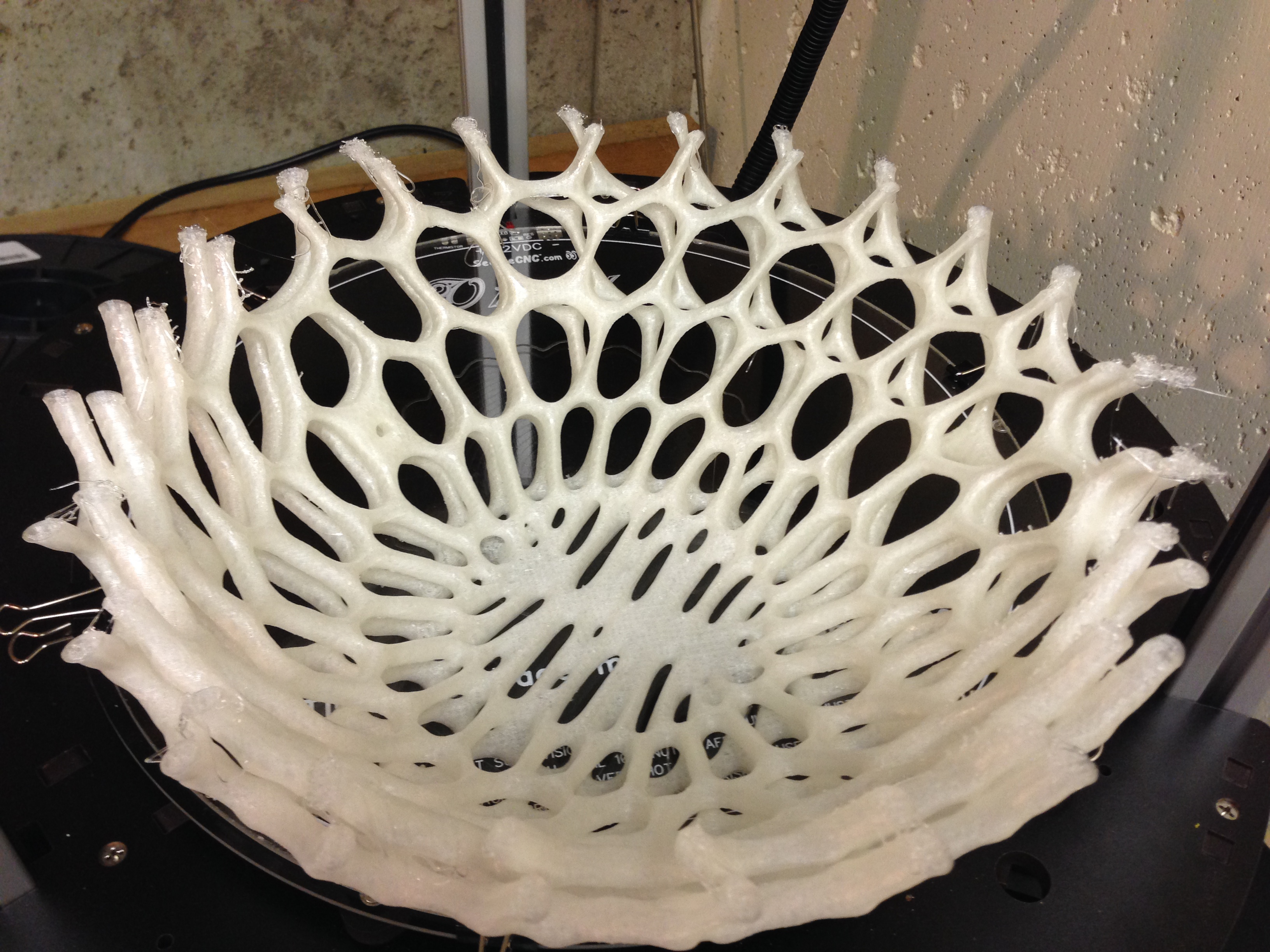

Next came the Orion upgrade. I had printed this Dizingof Klein bottle on my Rep2 on my first try about a year ago. I had tried a good 20 times to print the same model on my Orion with complete failure. While I had many issues the stock hot end was definitely one of them, it would just start air printing after a while. With the E3D V6 this is what I got an attempt #2 (attempt 1 had a slicing mistake).
This in general is a brutal print with the retracting/overhangs and I was very pleased how it came out, especially without a layer fan. This print took 20 hours so no heat creep issues.
Final example is a failed print but not because of the hot end but because of it detaching from the build plate (was supposed to be a mega Dizingof sized cell bowl).
This print had been going for over 24 hours when it detached. Again a very challenging print that was printing great, and with natural which tends to be a little more difficult to print.
