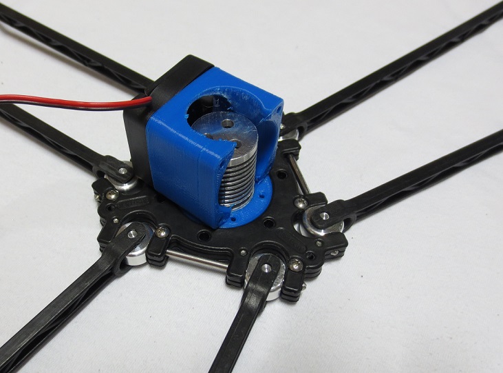

Here's what the 40mm fan looks like on it;
It looks kind of bulky on the Rostock V1 effector plate, but it fits. The blue circular adapter part fits right into the rostock effector plate, then the fan shroud fits over it all. Nothing is loose and nothing rattles. The nice thing about printing this with trimmer line is that you can actually bend the entire fan shroud almost inside-out without breaking it. Plus it won't melt or distort from heat! I was messing with retraction settings when I printed the fan shroud so it has some blobs on it.Check out the Tri hotend!

Well if you like quiet fans you'll love these ones. I think they might be rated at a much higher voltage or something because I've been running these 40mm 12v fans on a 24v power supply to cool the smoothieboards controlling my 4 axis mill and 2 axis lathe for two months now. They're still going!
I'll make several mounts available for various needs. The one in the picture can mount two 40mm fans if needed, and it's designed to clamp around the heat sink if you mount the fan on the open side. I'll do a 30mm fan mount and a 30/40 fan mount too.

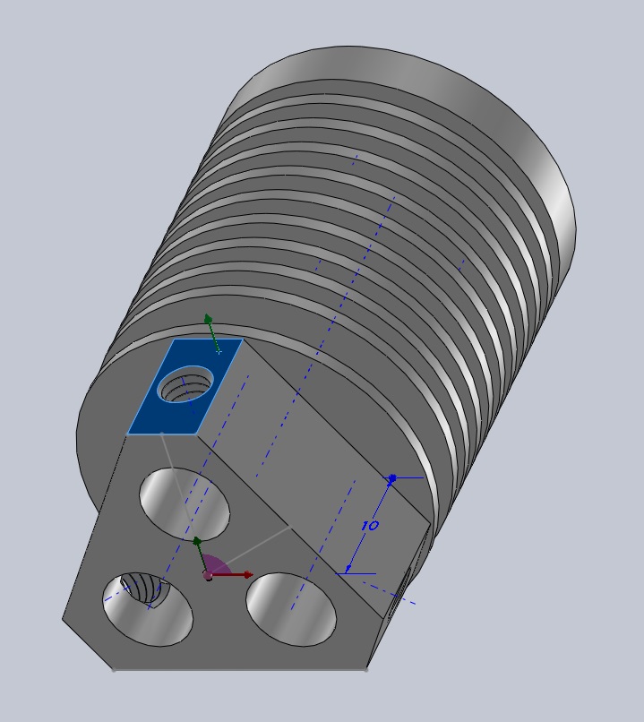

I'll post the mounting dimensions so anyone can make their own effector for the Tri hotend. I'm shipping the Tri hotend with a mounting adapter for the SeeMeCNC Rostock plate, but people with different or modified printers need to know this stuff to design their own mounts.
There are two mounting parts of the hotend. The preferred one is the triangular part at the bottom, since it is ultra rigid and easy to press fit without fasteners.
The second one is a groove mount above the triangular part. Both are shown below.

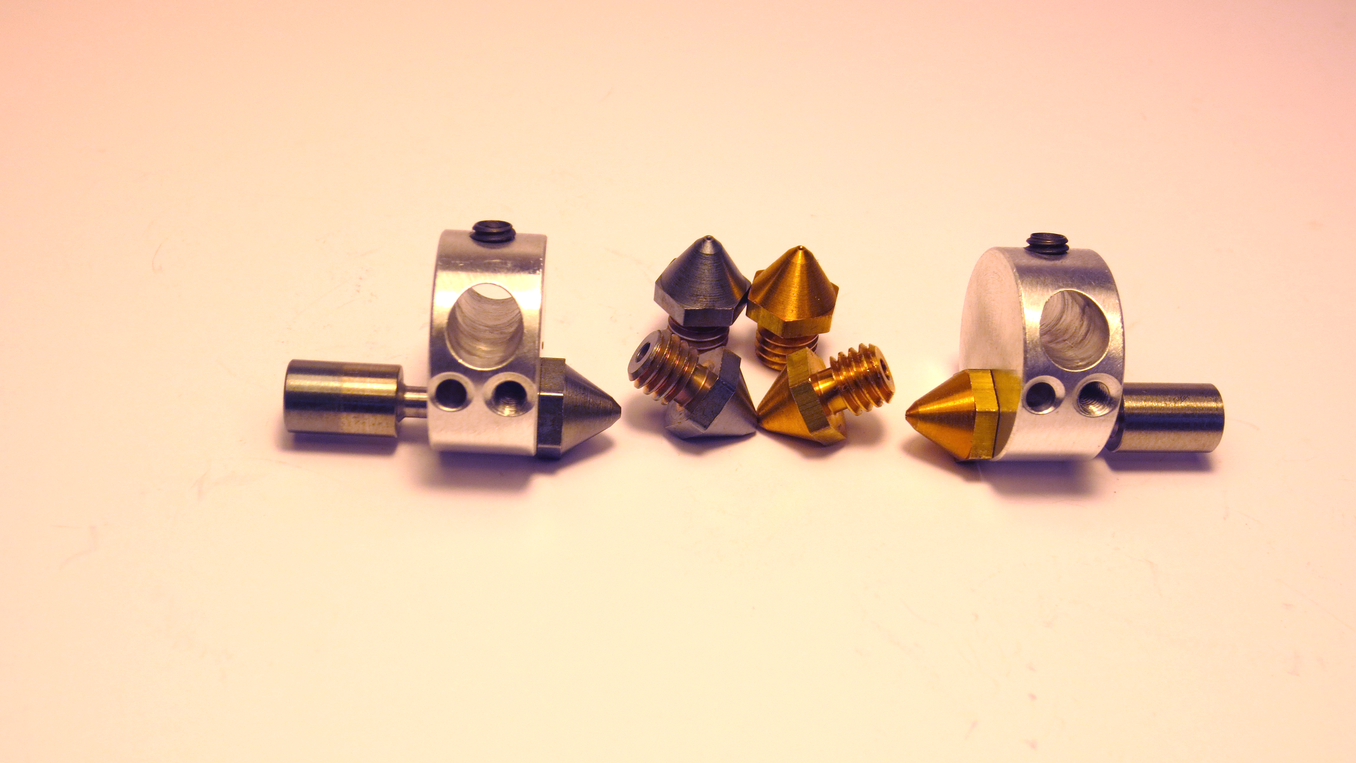

I'll let you guys speculate about the picture below. This is my permanent solution that will (hopefully) end all jamming problems with metal hotends for the future of 3d printing.
I will say that I filed for a patent on a few things related to this hotend, and just hotend technology in general. Some of you may remember a thread I started a few months ago about patents and open source stuff; I wanted to avoid IP earlier this year. The combination of aggressive patent trolls in the US and rampant [Chinese] copying of recent U.S developed 3d printer related stuff has convinced me to get patents on the things I invent. So while I'll go the traditional route with patents, I still intend to make my stuff open source for reprappers and makers in general.
Stuff is coming together and I'll give more details once I have some free time. For tonight this is all you get!
PS- I hope you like the results of my seven dollar product photoshoot! More pictures in the next few days.

Yes, this is looking very nice!
And don't be afraid to patent, patents aren't evil, it's just what people do with them
Telsa is a great example of people being awesome with patents... Trolls are the worst.
Looking very nice all up. You got a total weight on that yet?
