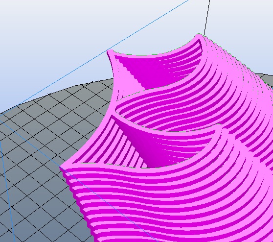

This Popup appears when loading the original STL file Above:

I assume this is your impellor,,,,, What setttings are you using for perimeters? What type of infill are you using? What is your infill density set at?

Got a question on INFILL...I do not need any infill in the part I am doing now...what do I set to eliminate infill?Mac The Knife wrote:I assume this is your impellor,,,,, What setttings are you using for perimeters? What type of infill are you using? What is your infill density set at?
As you can see in the part the "blades" are hollow and I do not want to infill them. My first attempt filled them in and this part was going to take 26 hours.

With slic3r, I would try setting the infill percentage to 0. I haven't tried Cura.
