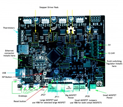

Based on reading your threads, I decided to upgrade from a RAMBo 1.1 board to a Smoothieboard 5X. Would someone please post their firmware and configuration? Did you cut off the RAMBo connectors for the motors and max end stops?
I ordered the ethernet port which needs to be soldered. I also ordered the 5V device but I'm not sure what it does and where it goes.

Jesse, here's a photo I put together that should help you.
The 5V regulator goes on the right side where I marked. It allows the board to run on 5V without being connected to the USB port. If you don't use it and want to print detached from the computer you would need to provide 5V at the connector on the right side of the photo.

The schematic shows 5v on the endstop pin, could you power the logic with a jumper from one of the unused endstop pins?
or just above is a row of 5 pins for serial connection, I pulled 5v from the 4th pin from the left to power my GLCD panel, how about using that power source for logic?
I really want to run smoothie standalone like the Rambo.
Seems silly that the board designer did not make a simple jumper like rambo for self powering logic. It already has 5v on board.

I run my Smoothie standalone. You need a 5v regulator where it shows on my photograph (on the right). I think the 5V pins you've identified do not have sufficient current to drive the board.

The documentation makes me believe you can either supply external 5v power via the power header, or just run a 12v input and put an on-board regulator for the 5v. If you've already got 5v available via an ATX power supply, I'd just use that and not install the regulator. This way you can keep any heat from a linear regulator, or noise from a switcher, away from the board. Do they even call out regulator requirements to use on there? Doesn't look like much room for a heatsink if you use a linear regulator such as a 7805. They can get pretty warm if you start pushing them. Could use one of EzSBC's switchers which are sized to fit in place of a linear TO-220 regulator.

Specs are this: switching regulator - they are VERY specific with the components.
