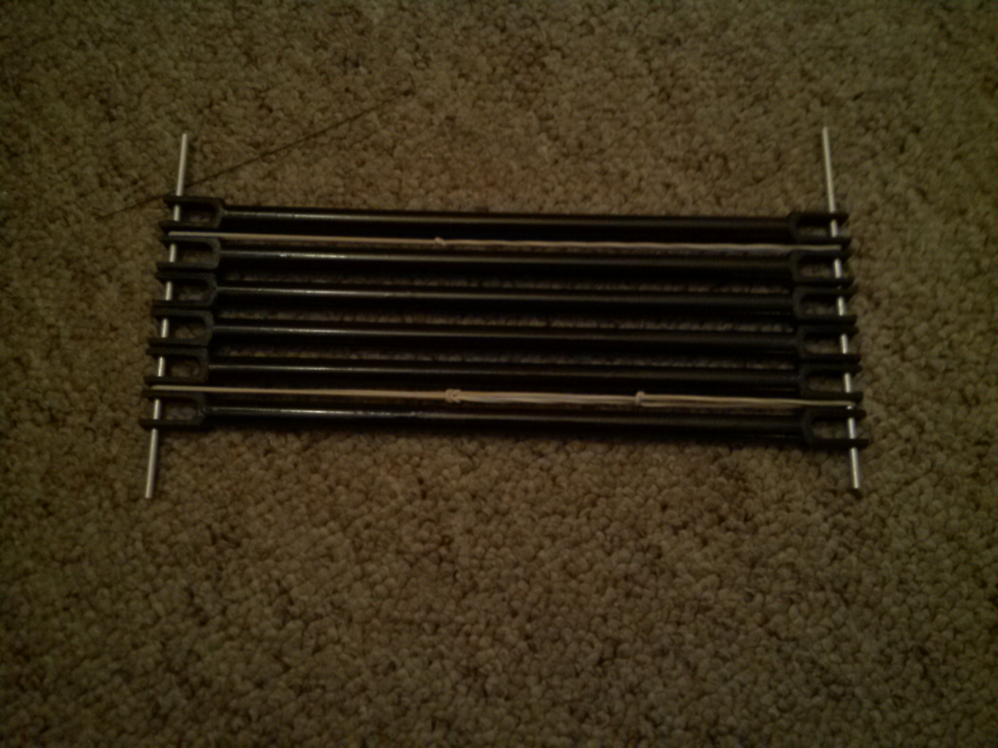

The diagonal arms are all assembled and drying before installation.
nathanstenzel
Posts: 82
Joined: Thu Jul 11, 2013 1:11 pm
Re: simple old style diagonal arm fix
Post by nathanstenzel »
The rods are on. It is different putting them on when there is no flex, but not too hard. I had to put some rubber bands on because the U-Joints have some wiggle room side to side. It is not totally perfect, but I am pleased. I will be doing calibration sometime tonight or next week. My next prints will probably be a few more rod ends just to have spares, but I am sure the axle will die before the diagonal arms do. My friend reminded me of sacrificial points of failure and now that seems to be the axle for which my only local replacement is aluminum hobby rods from Lowes.
